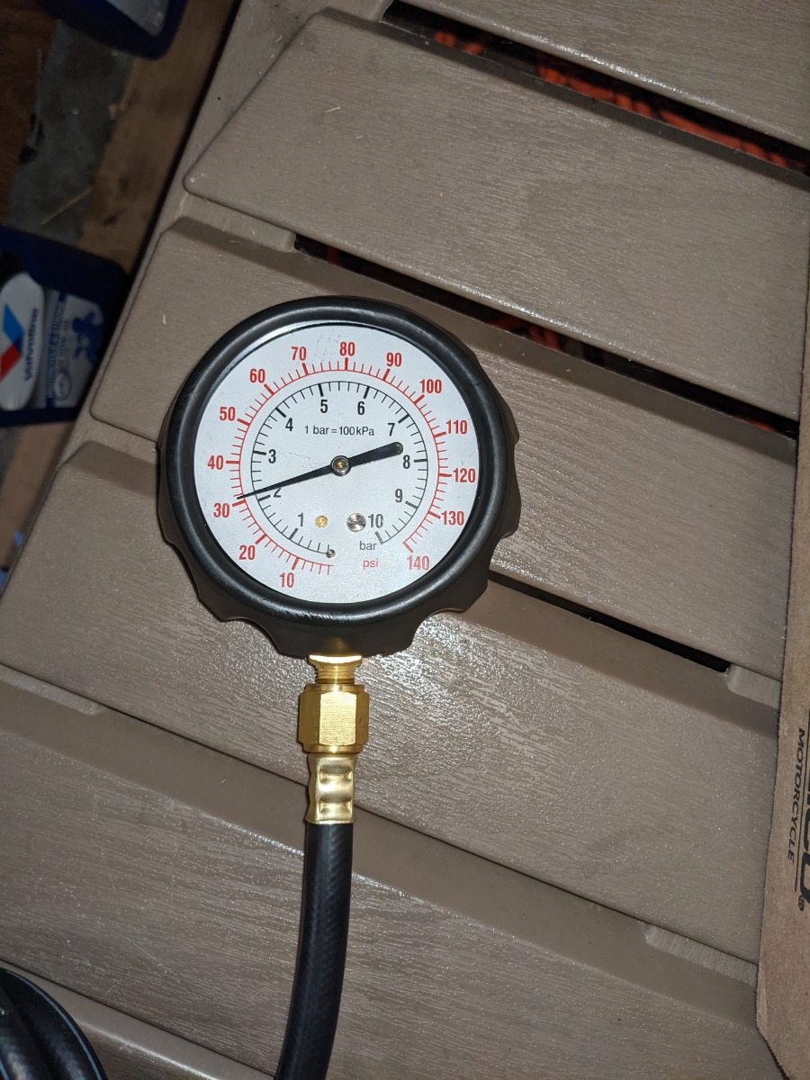

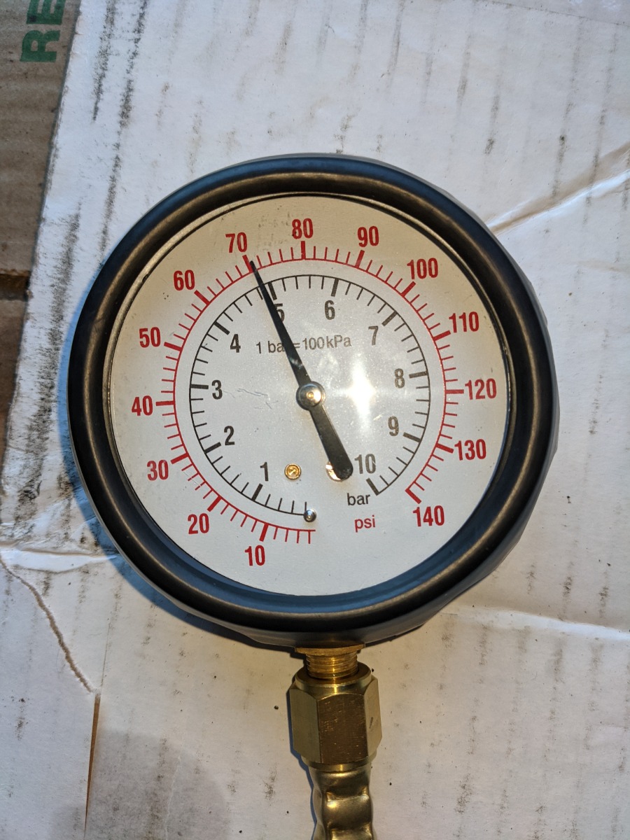

Do you think this kit will give me a more accurate reading? It tops out at 140psi vs 300 on the one I was using before.
www.harborfreight.com/engine-oil-pressur...fnmOmqRoC7D0QAvD_BwE

Based on your earlier testing, it seems like the relief valve and pump are working when the oil is cold. The focus should now be to measure the pressure when the engine is warm, when the light is coming on, and make sure it's in the 28-36 psi range. This is the range you really care about, so I would find a gauge that would give very accurate readings over this range. For this task a 50 or 60 psi gauge would be better than a 140 psi gauge, even if you wouldn't be able to use it to measure the cold pressure.

30 Sep 2021 14:22
No eBay APP ID and/or Cert ID defined in Kunena configurationIf your a minimalist, who dosent want to aquire many tools. Replace the pressure switch and see if that keeps the light off.
On the other hand, If you like to experiment and like having tools, Get the HF gage set, but add a 0-60 gage.
You can ride with the gage attached and verify the pressure the light comes on at.

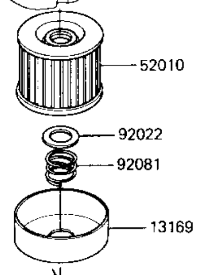

I took apart my oil filter assembly yesterday and realized that it's missing a washer (92022). Could this be contributing to my issue?

Doubtful. I think it’s only mission in life is to protect the rubber seal on the filter from getting gnawed on by the spring. I inadvertently ran without one with no ill effects.

Replaced the oil filter and checked pressure with my new gauge, which read 70psi cold. Went for a 30 minute ride and the oil light did not come on. Got back to my garage and checked pressure again, came out to about 30psi warm. Still no oil light. Looks like I'm in the clear, I guess the filter was the culprit. Thank you everyone for all your help!
