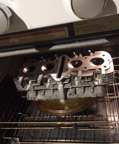

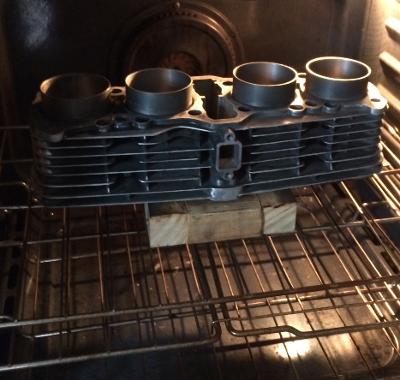

Yep!!! Heat the head up in an oven. I use the family oven myself. Unlike a propane torch, the oven heats the head up evenly. When I go to put the new guides in, I put them in the freezer for a few hours before I go to install them. That way with the heated head and the frozen guides, they almost fall into place!!!! No need to BEAT them into place!!!! I would order some aftermarket silicon bronze valve guides instead of those O.E.M. steel guides. After you install new guides, 99 times out of a 100 you will new to cut some new seats.

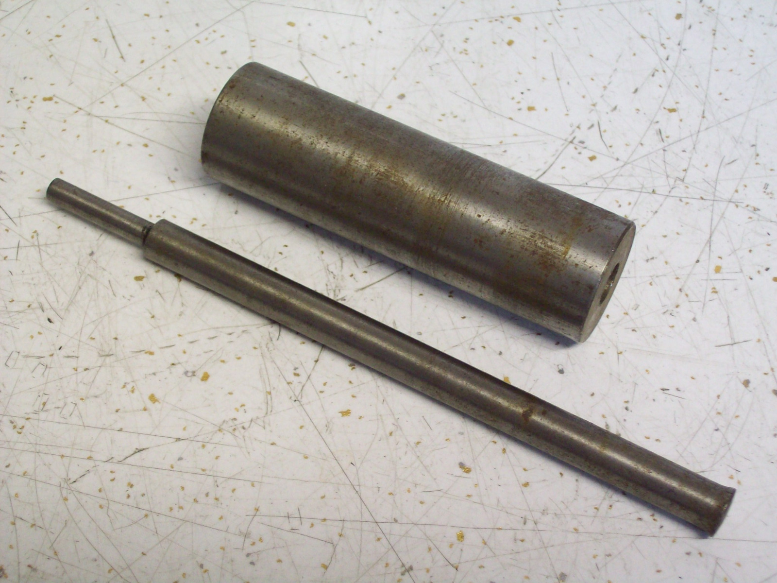

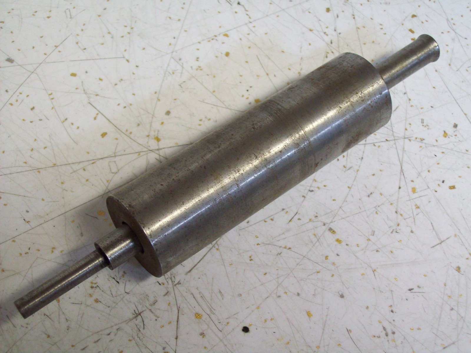

I made up a tool that fits snugly into the bucket cavity and the guide installer tool fits through the tool in the bucket cavity. That way there is NO WAY I can install the new valve guide anyway but perpendicular to the valve seat.

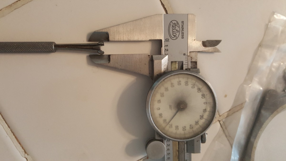

My calipers have the stems at 9.77. 0.22 out of limit.
That would indicate there's more wobble than my fingers feeling.
Eyeballing it, I'd guess it's more than a couple thousandths
My dial indicator has the wrong needle orientation to fit in there.
Time to get another set I guess.

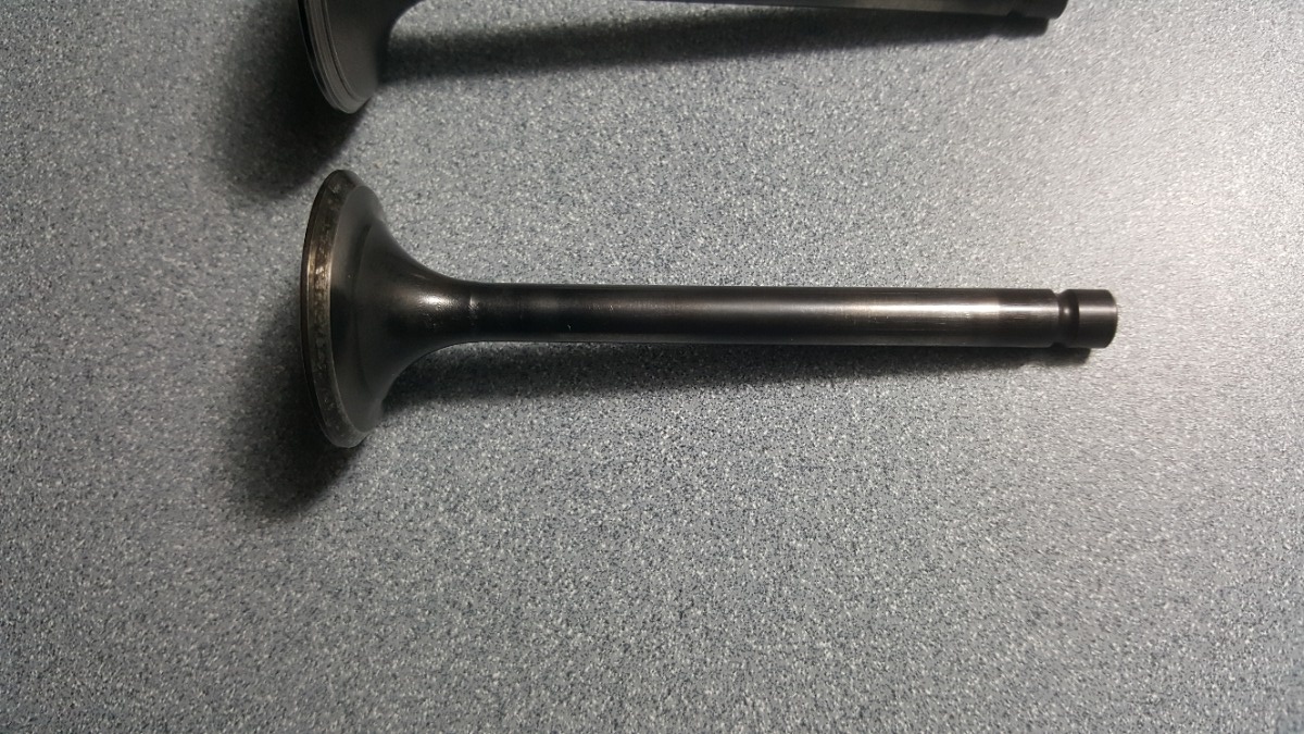

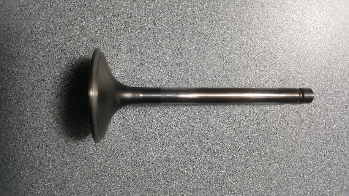

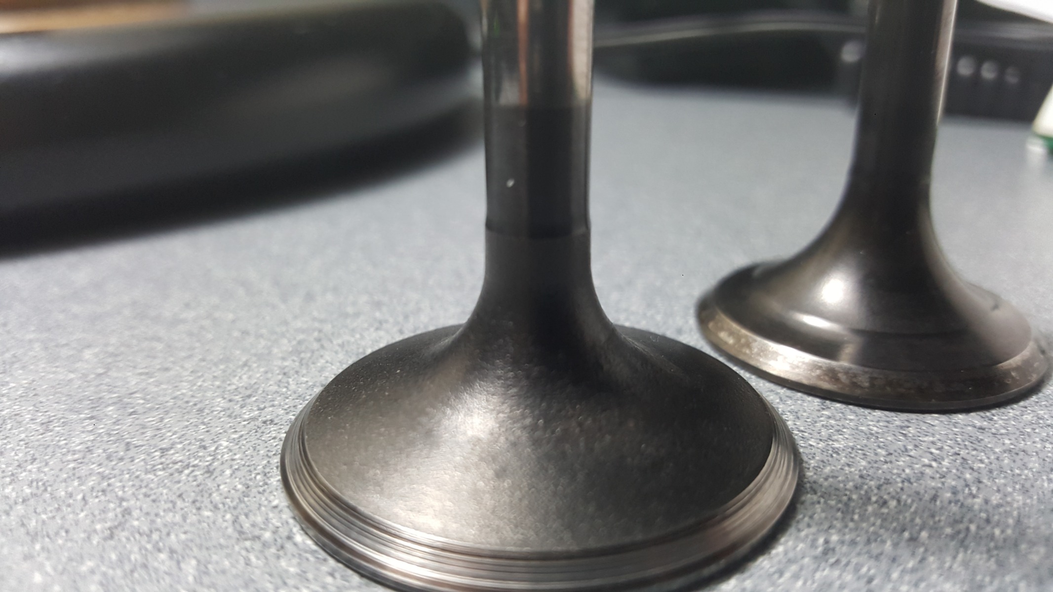

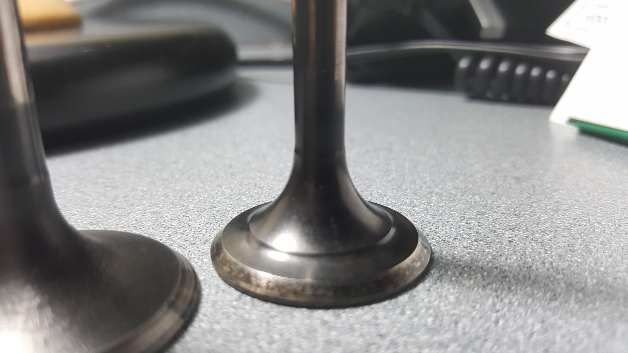

What do the valve stems look like? KHI went to steel valve guides for a time and oil burning was a problem. They said one quart every 200 miles was acceptable. That didn't fly so they had to change them under warranty after being sued. It could be the stems are worn and the guides are still in spec. If they're steel I'd replace them.
- Greybeard
- Posts: 113
- Thanks: 26
Re: Top end time
11 May 2020 08:42
What a coincidence, I was burning about a quart every 200 miles...
I'll post a picture of the stems.
I'm actually skeptical they're that worn as they measured about 9.77 from the tip all the way to the flare of the valve.
I'll try to round up a Micrometer and remeasure.

Yes, oven! As long as the little woman goes to work! House smells of burnt oil/carbon for a few hours.
I always go 350° Have welding gloves handy. Do your pounding close to oven because aluminum cools real fast.
You'll have to put back in oven a few times if you do all 8 guides.

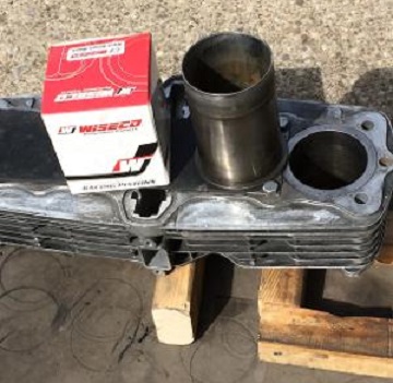

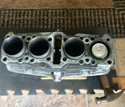

This was in only 4 days ago. I put a can of frozen soda in liner I took out. Plus I made a steel plate to hold the 3 good liners in place, as I was only changing 1 liner. As Dr G says, put new parts in freezer, guides, cyl. liners and bearings also. warm aluminum and frozen parts drop right in most of time.

Valve guides are 7mm inside both exhaust and intake. Intake is a thousandth or 2 tighter, but both well within spec.
Just got my Starrett bore gauges in the mail today. Metric micrometers arrive tomorrow., but calipers have the gauge at 7mm or 0.275ish inches.
