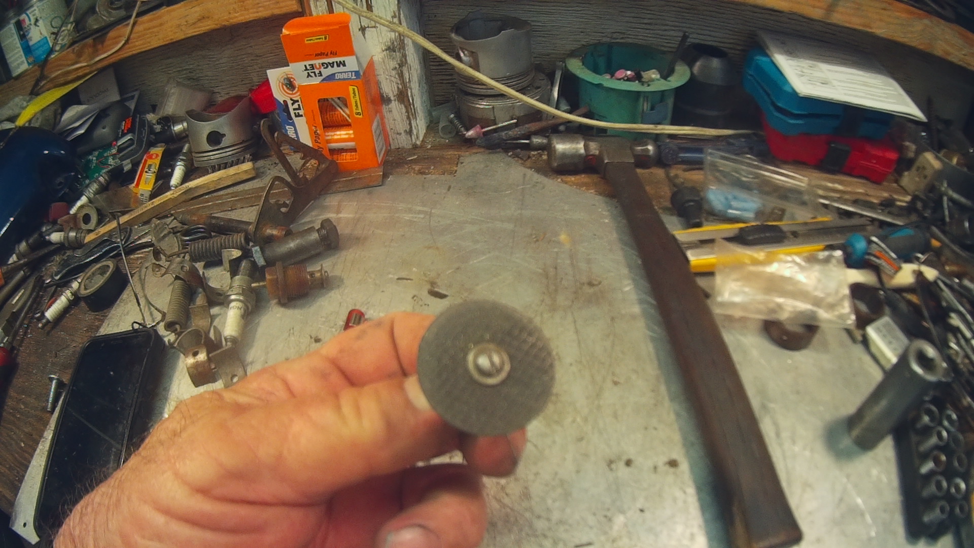

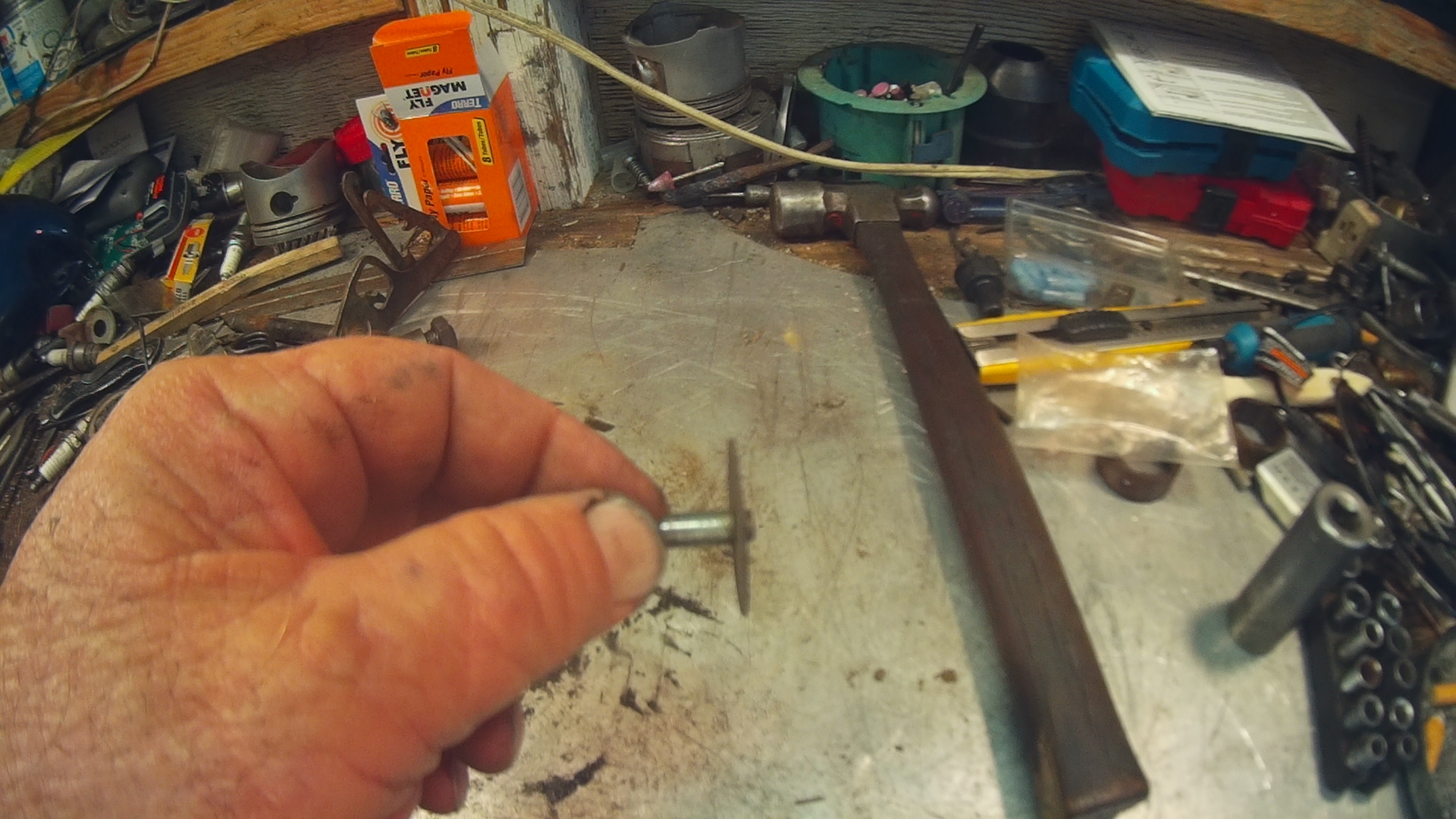

I guess you could use a small file but I would use this in my cordless. It can be had at a hardware store for $5. Never had to do it with Wiseco rings.

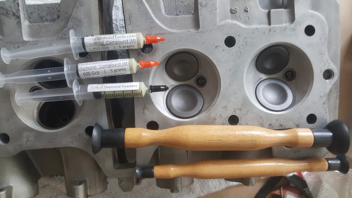

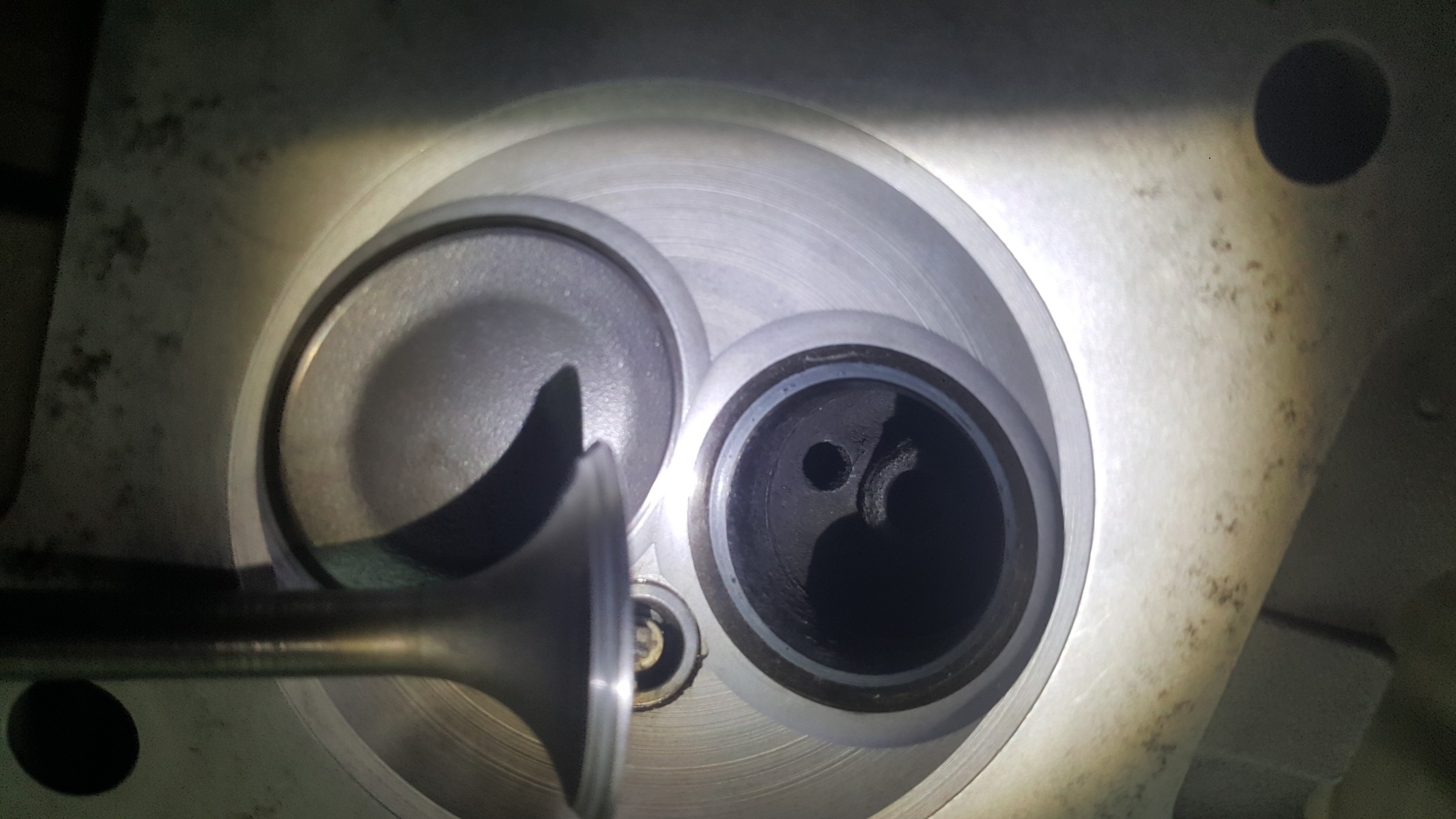

Lapping valves. Seats are cleaning up better than I expected. Slow work, but progress.

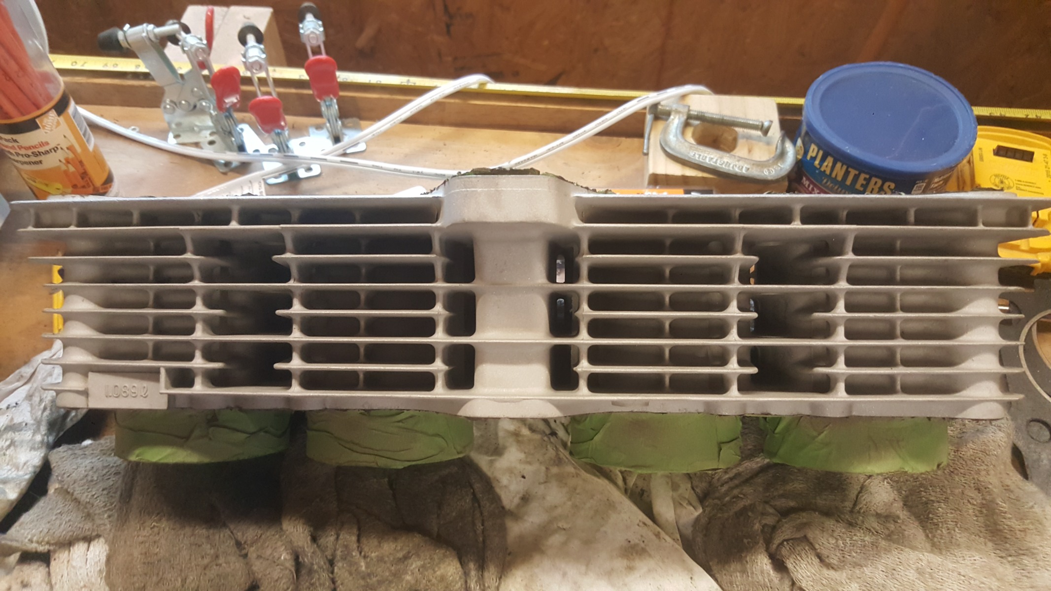

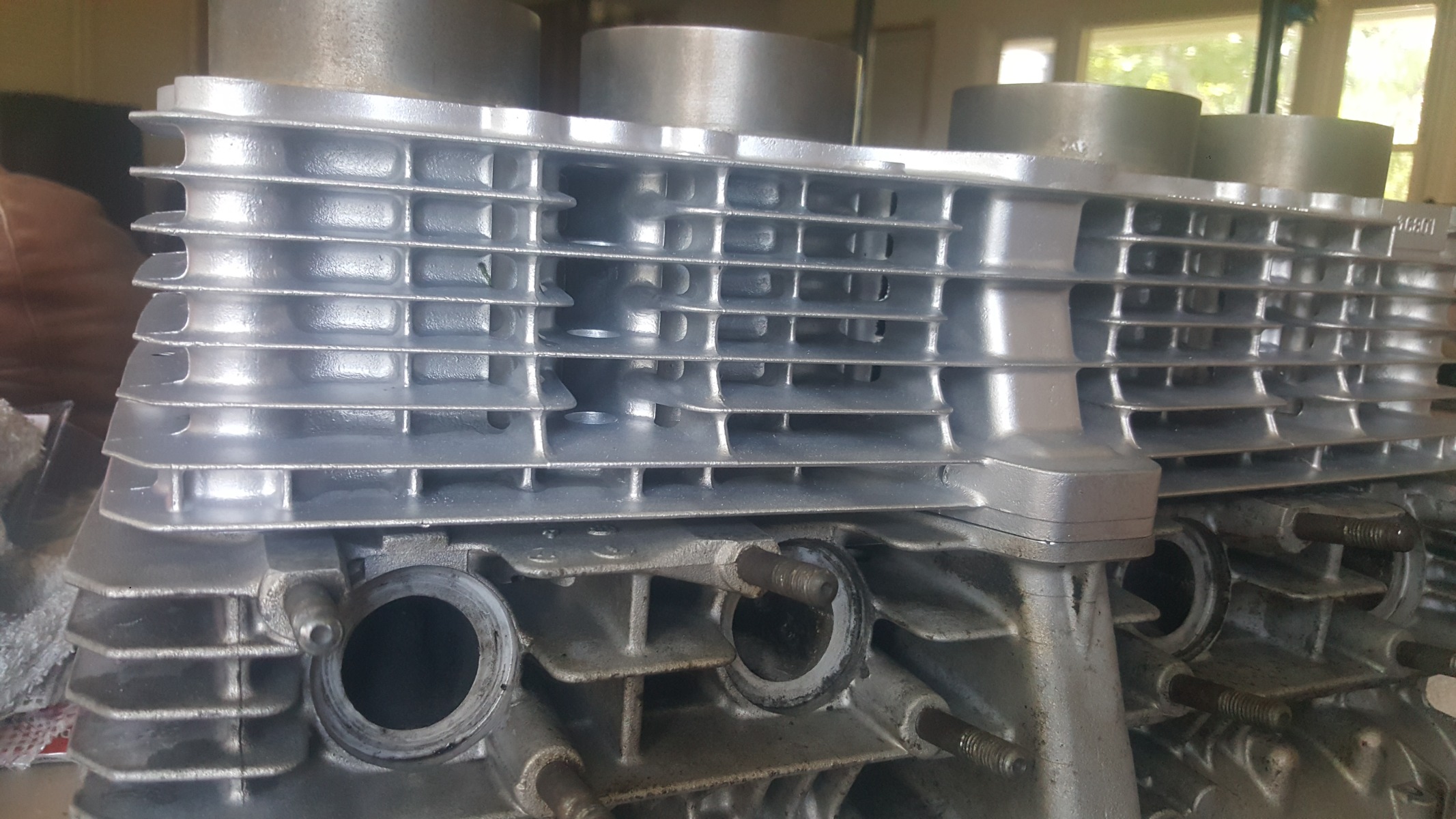

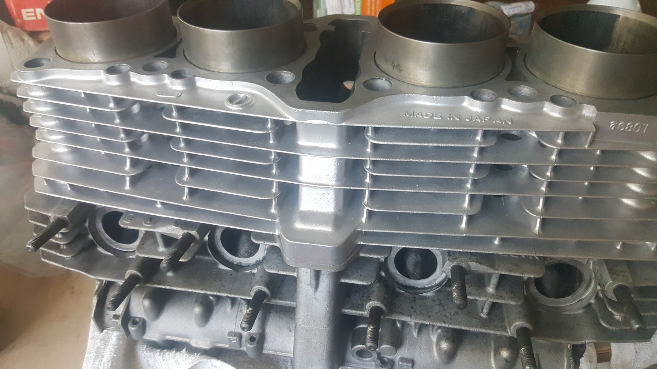

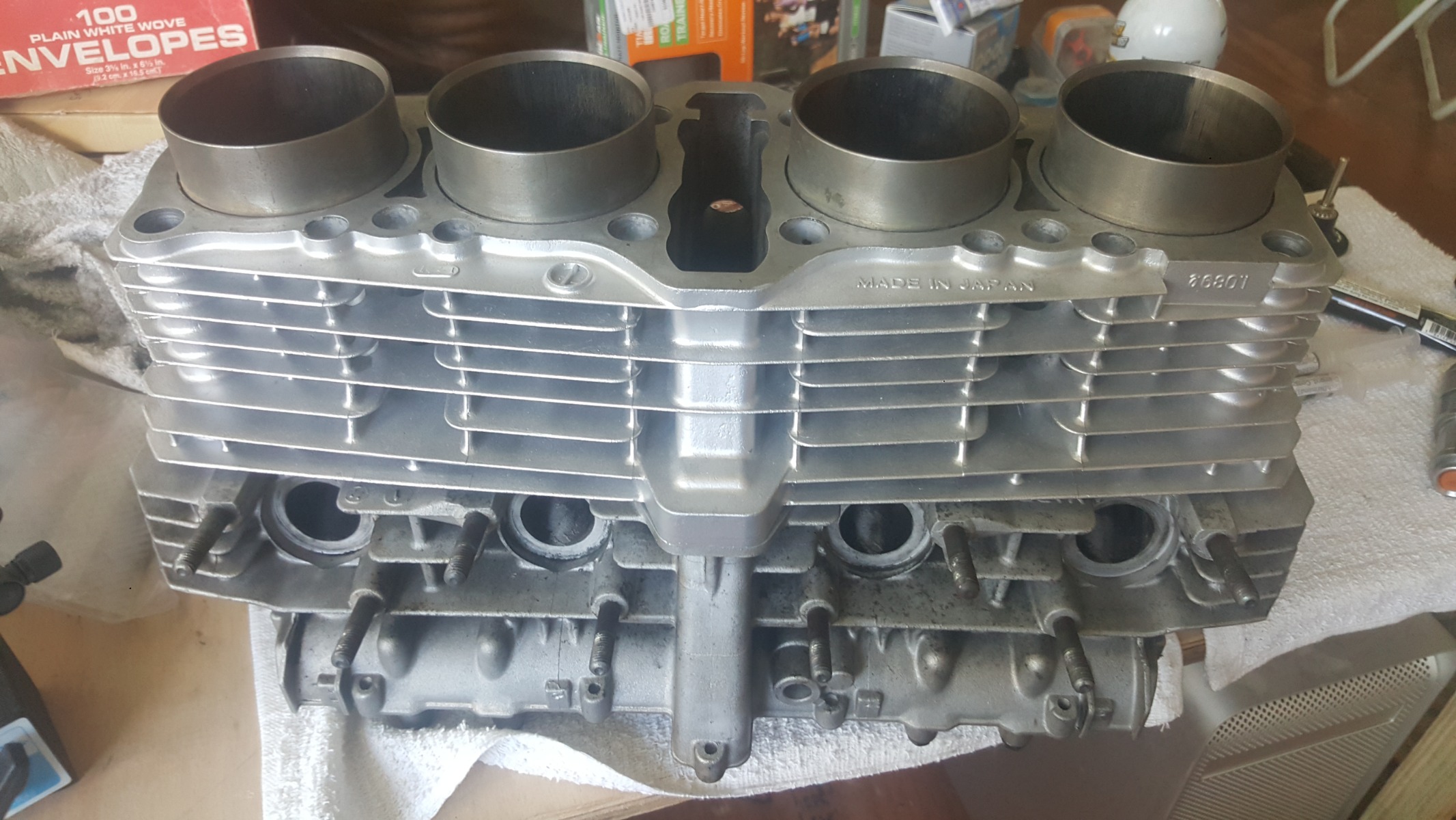

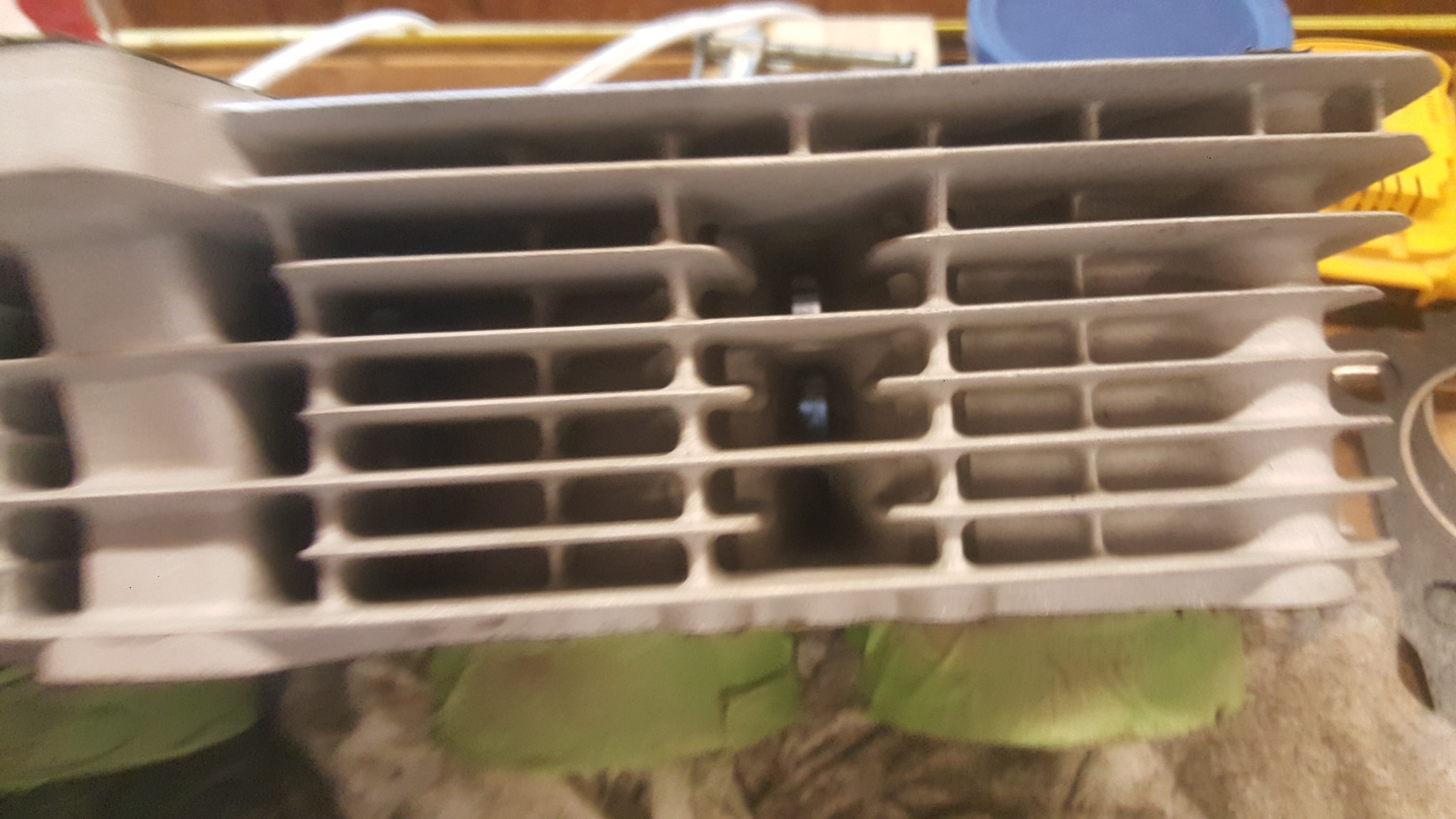

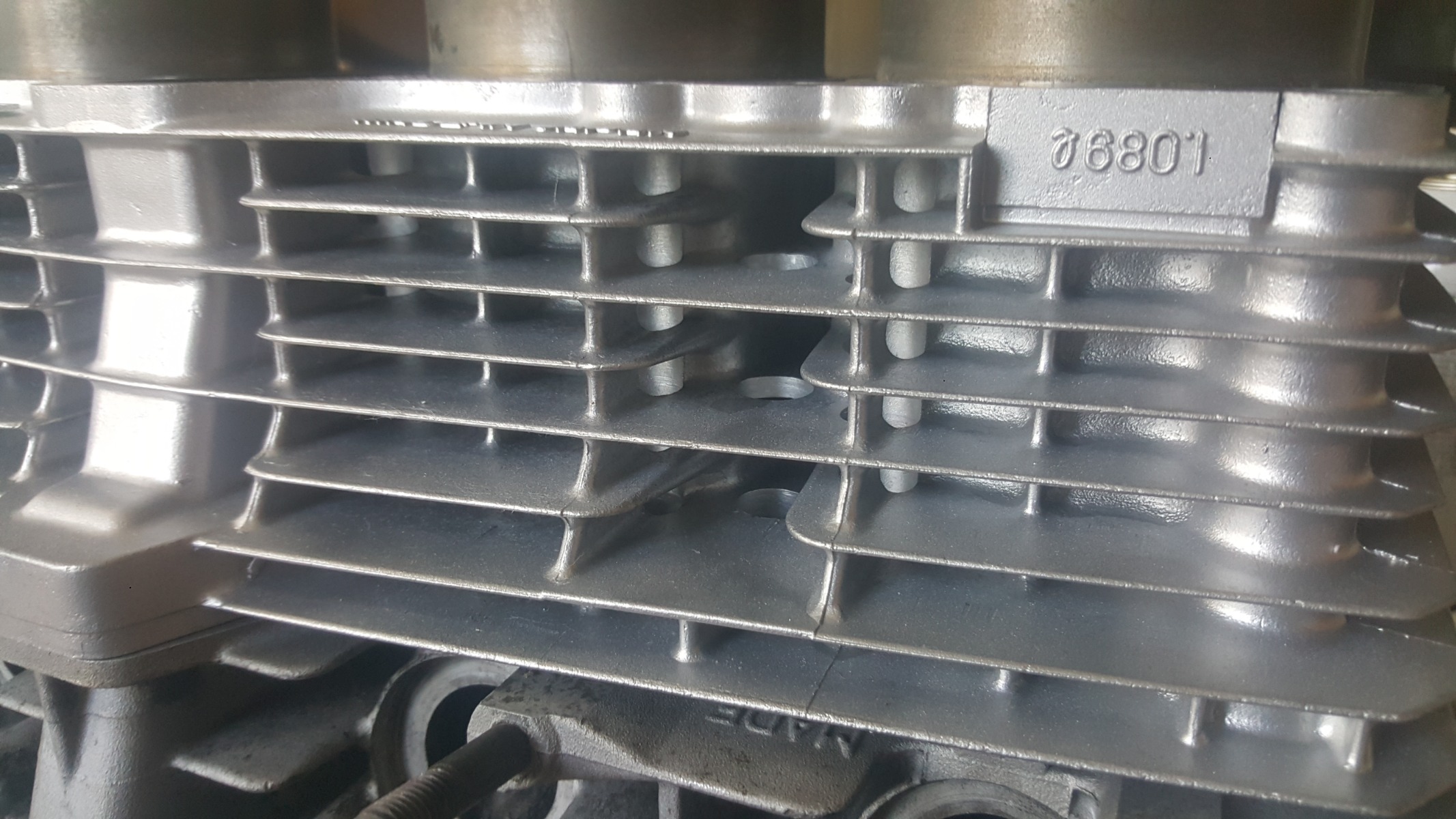

Black, Silver, Clear, Naked? What's the usual finish?
1982 KZ1100 D-1
Last edit: 10 Jun 2020 04:38 by Greybeard.

Re: Top end time
10 Jun 2020 05:16
#827743
That looks like it was dry blasted. When I do mine I aqua blast them.
The following user(s) said Thank You: Greybeard

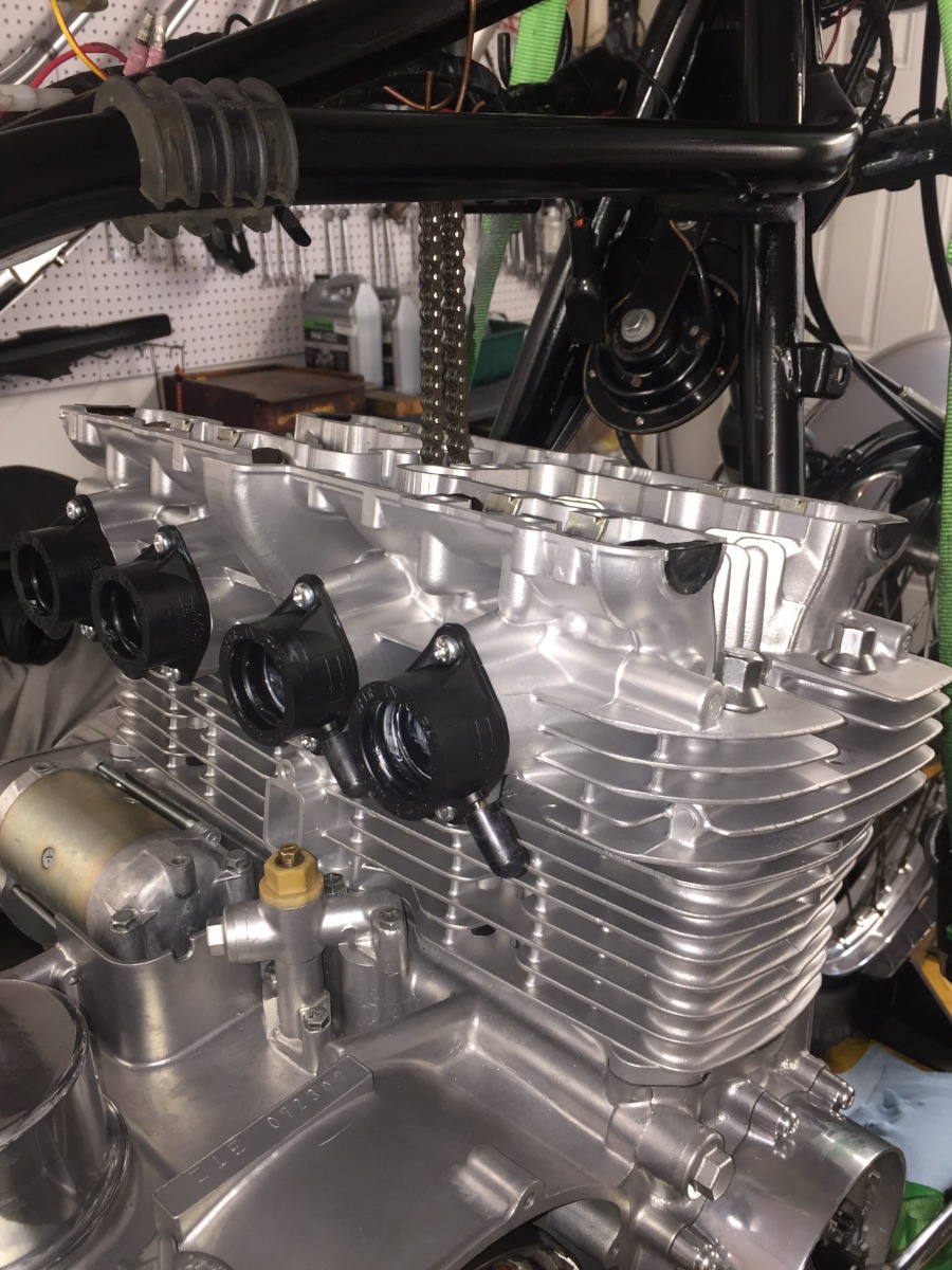

Re: Top end time
10 Jun 2020 05:34

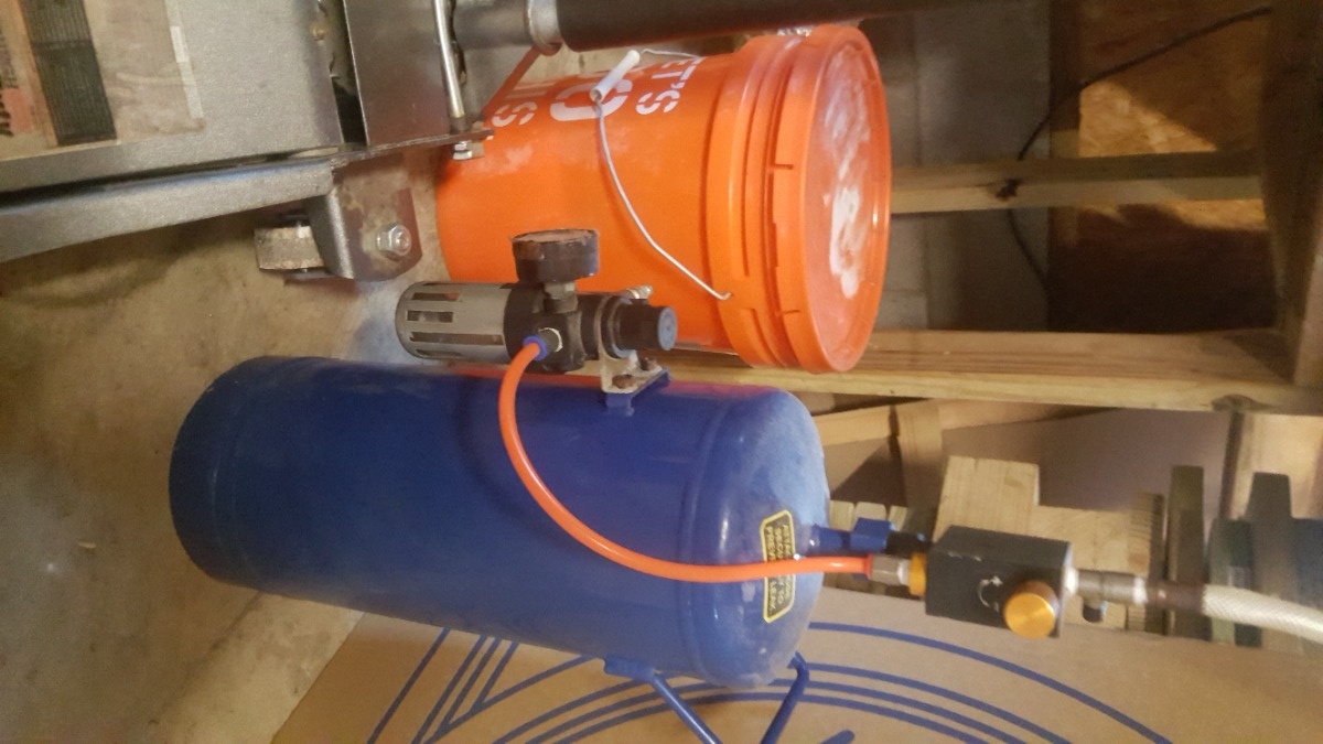

#827745
Looks awesome. What kind of vapor blasting rig do you have? What kind of media do you run in it?
Got a used harbor freight cabinet and fine black media in it. Have a small pot with baking soda I'm using to clean up the head with.
1982 KZ1100 D-1

Re: Top end time
15 Jun 2020 10:04

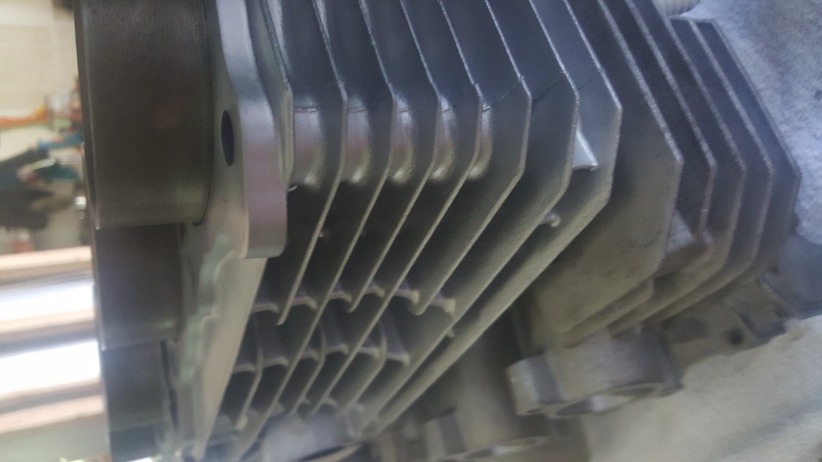

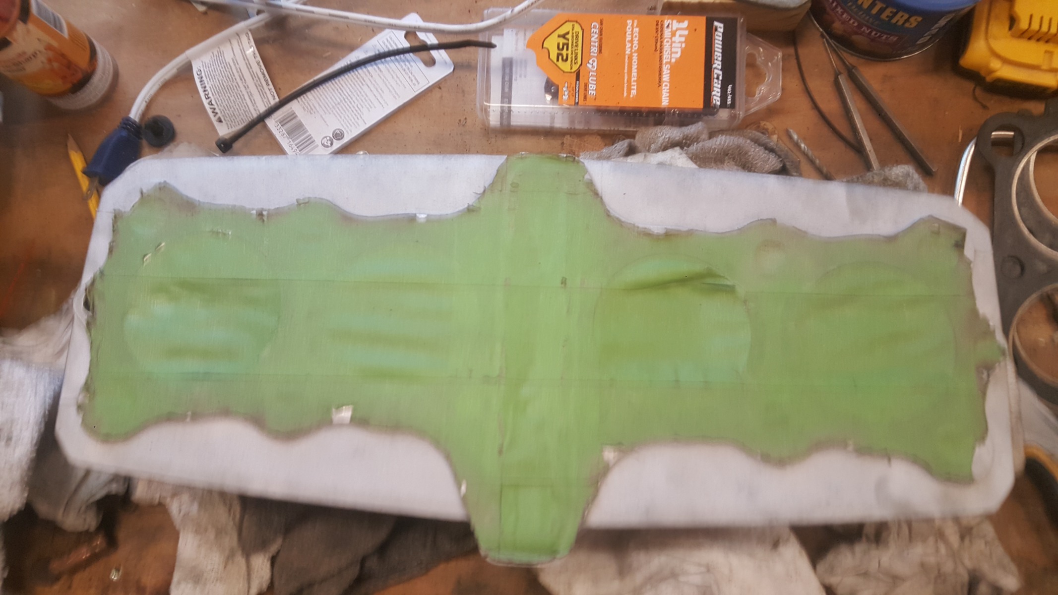

#828250

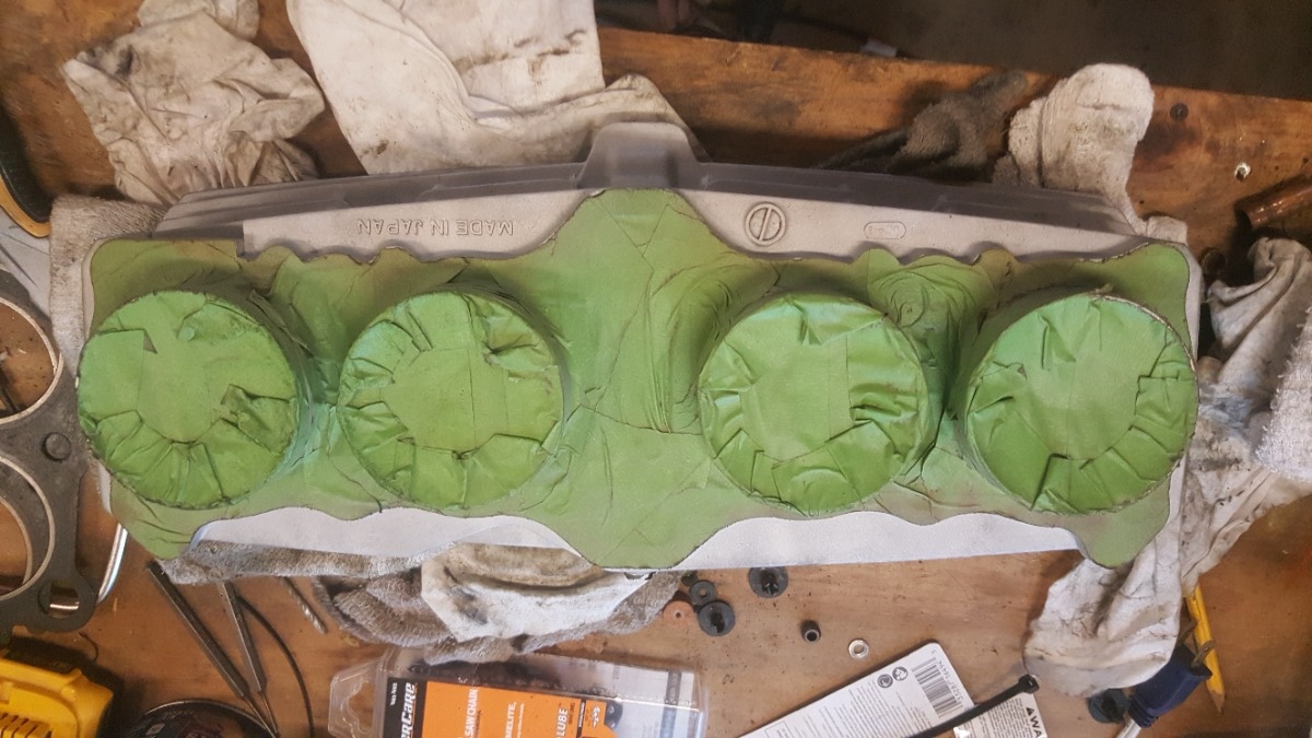

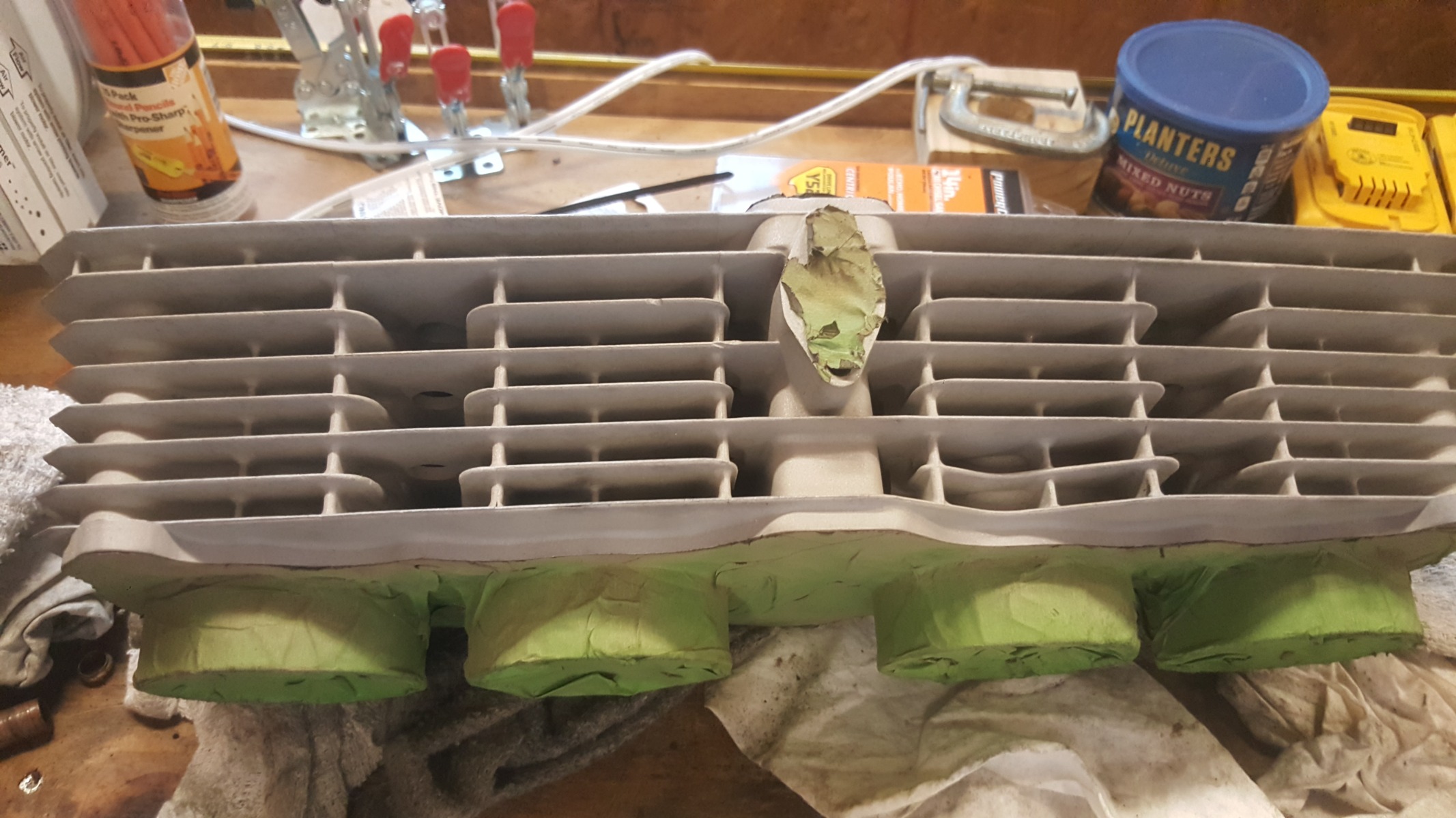

Aqua blasting does leave it shinier. Using an electric pressure washer with Angela&Alex Pressure Washer Sandblasting Kit, with 70-140 glass bead media.
Going to take lots of tape to seal the head to keep grit out.
1982 KZ1100 D-1

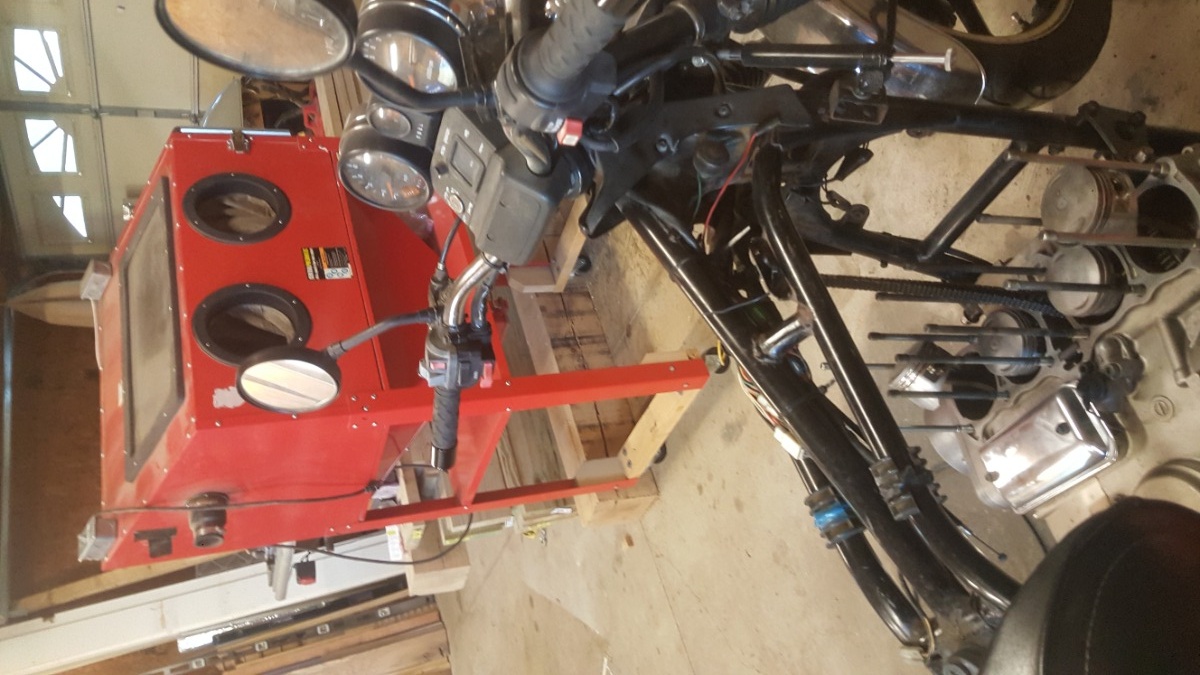

Think it's a 2 person job

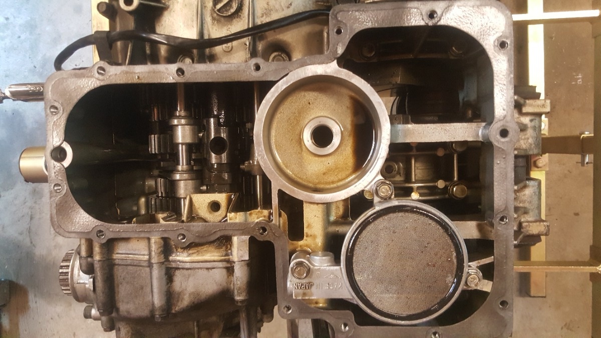

Re: Top end time
17 Jun 2020 10:34
#828333

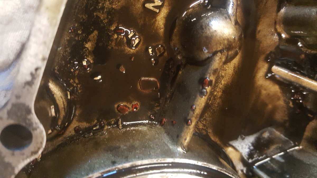

Small red chips in pan behind filter majority on clutch side.
Any help identifying?
1982 KZ1100 D-1

Re: Top end time
17 Jun 2020 11:08
#828337
Looks like silicon. Check your oil pump screen.

Re: Top end time
17 Jun 2020 11:12 - 17 Jun 2020 11:14
#828338
Screen is spotless.
Red chips are really hard and brittle.
Guess it could be, but this is the first sight of anything not black in the entire tear down.
1982 KZ1100 D-1
