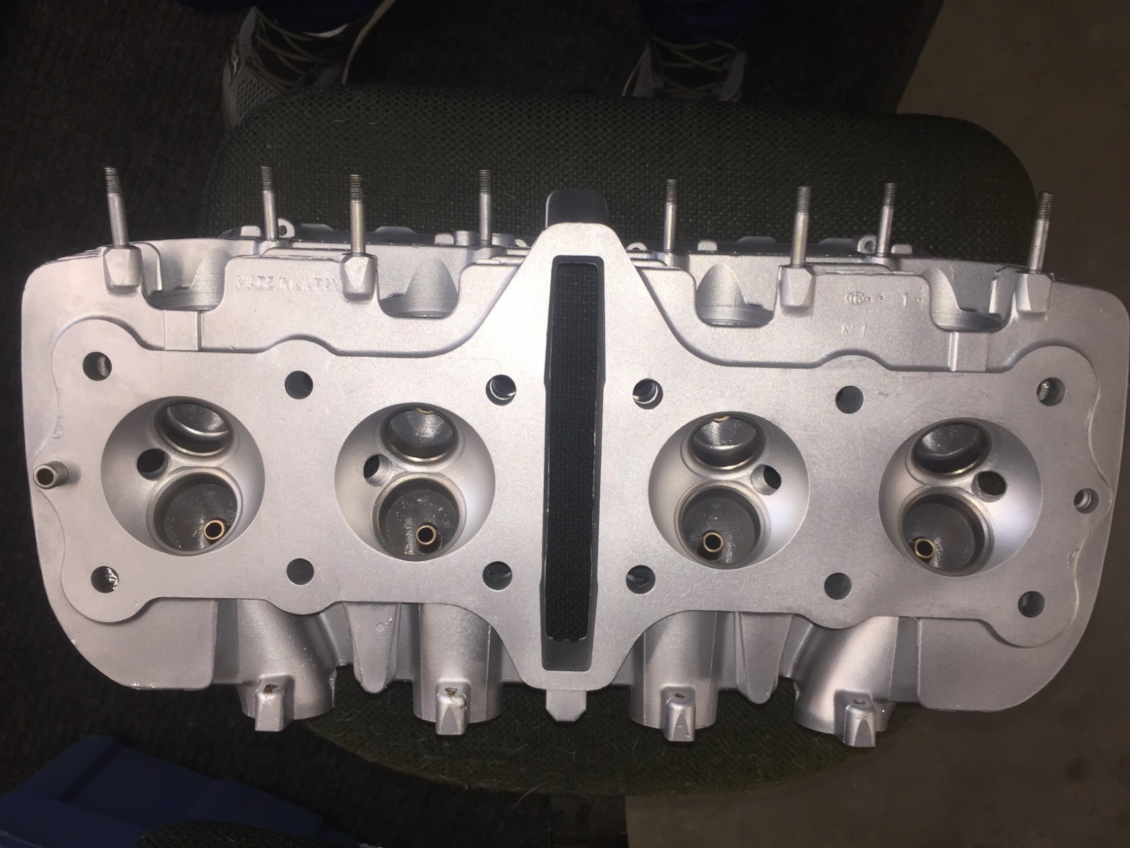

Bead blasting is best. It can get into all the crevasses on the cylinders and the head. Here is an example of what it will look like.

Gotta be careful with glass bead because it can get into the blind oil passages. My preference is soda for that reason. Or maybe get it hydro blasted from that sponsor of ours. That looks pretty killer when done.

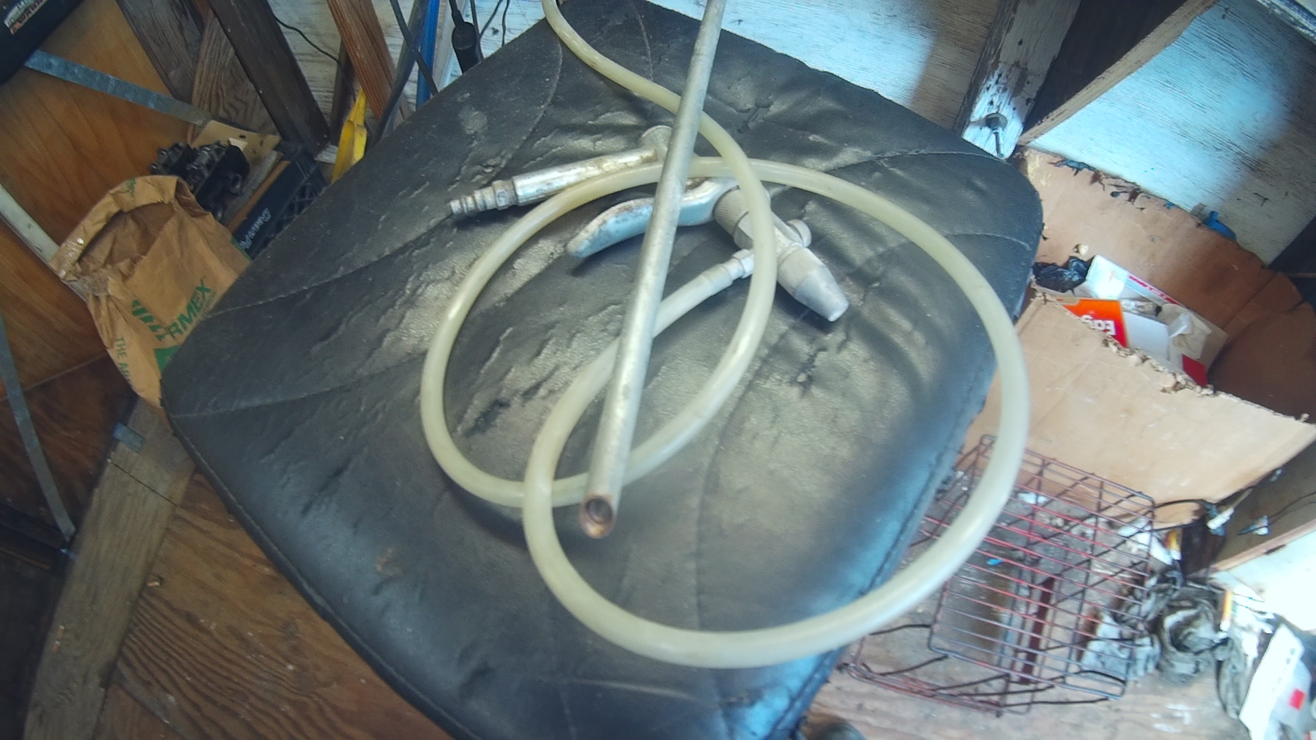

A 50lb bag of soda cost just under $50 at HF. Good thing it's water soluble. Does a great job of cleaning aluminum.

What do you use to shoot your soda media with Steve?

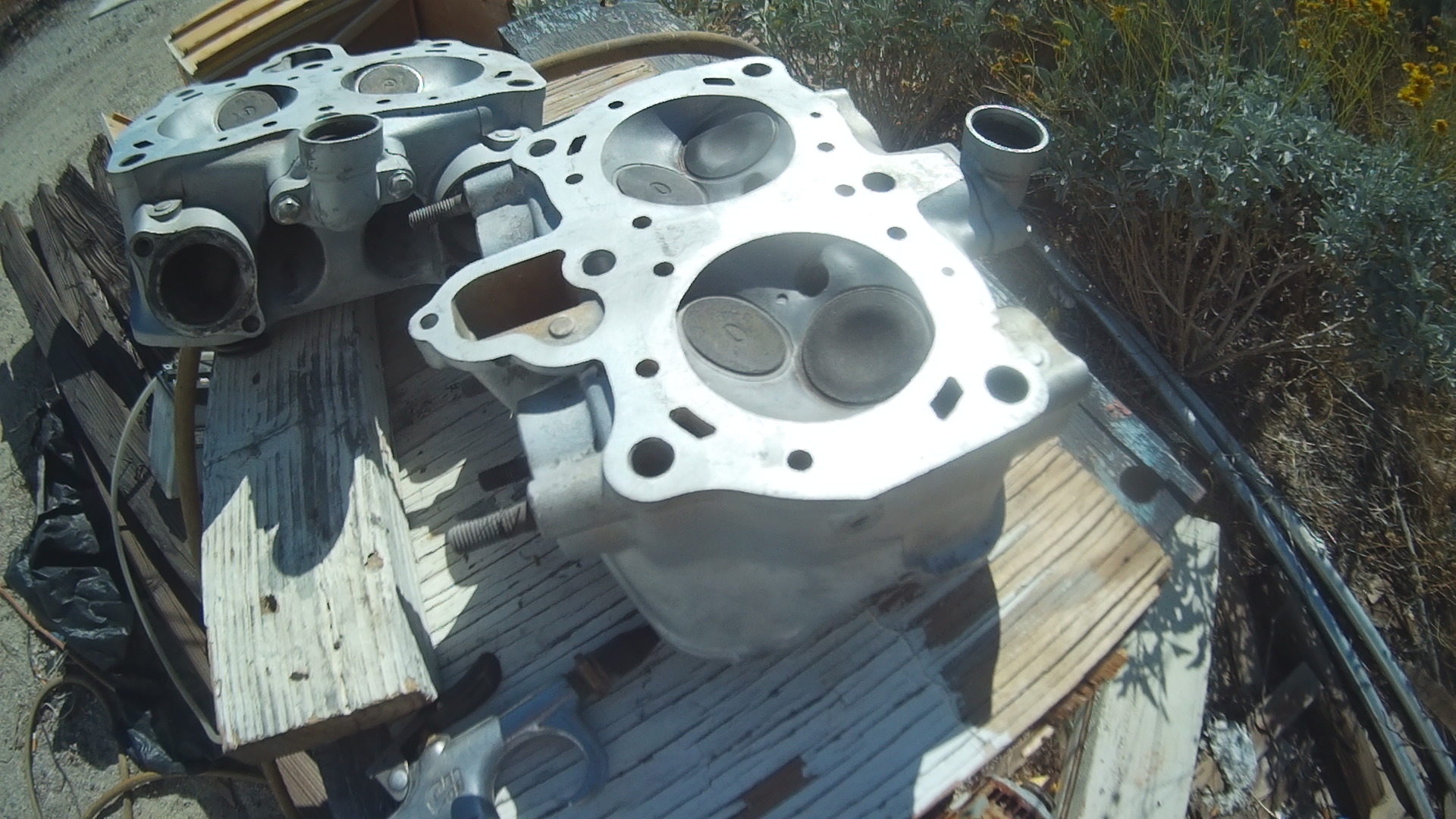

Looks pretty close to flat what's the tolerance on the surface?
The jug is still stuck on to the cases pretty firmly. Pull it and replace the base gasket?> Yes, or no?
Not looking forward to trying to compress the rings and reset the pistons if I don't have too.....

I have a cheap sand blaster attachment. It works great. How many miles on the bike? If you disturbed the base gasket it will leak. You MUST get all the carbon out of the cylinders. The tolerance is .004 using a straight edge across the deck and head surfaces measuring in an X and cross pattern.

That was me. It looks like he disturbed the carbon on the pistons and it seems the rings are leaking. Could wash the bores with diesel by filling them then vacuuming them out but it has to be done until all of it is gone.

Don't blast the valve seats. I leave the valves in until I'm ready to lap them. At that point a little cleaning can be done being careful to not hit the seats. Maybe if the compression comes up the rings will seal.
