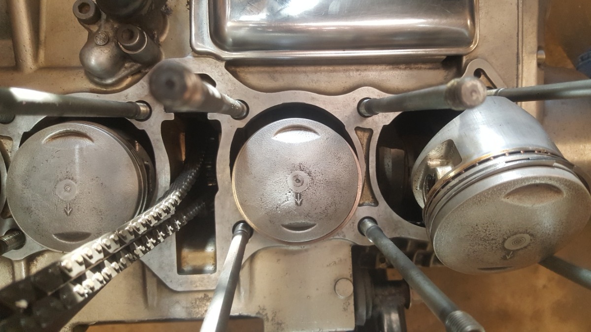

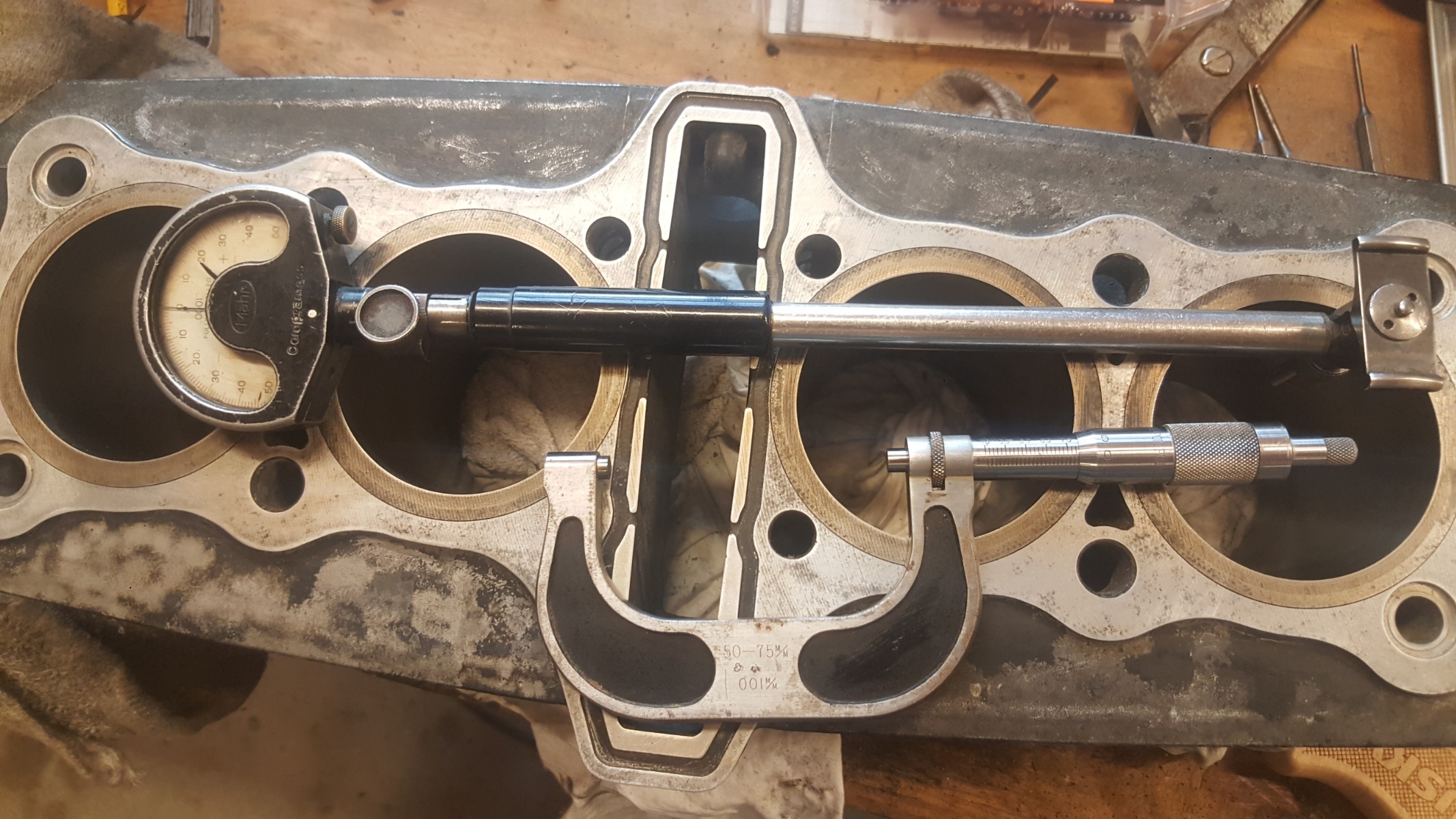

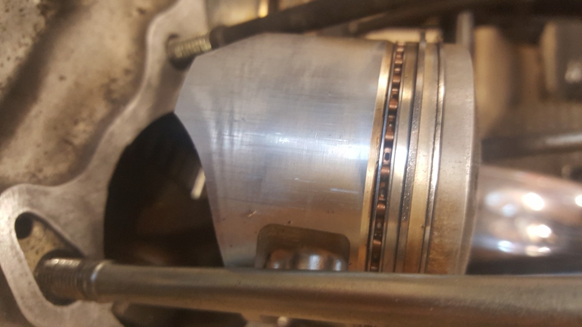

Cylinders are well within tolerance.
Bores need crosshatch hone.
Need new rings.
Pistons scuffed.
One has a strange light shading bands though.
Never seen that.
Thinking stock rings will still fit.
Only have 20 to 40 ten thousandths variance anywhere. 0.002 - 0.004 Spec is 0.05
Never seen that.

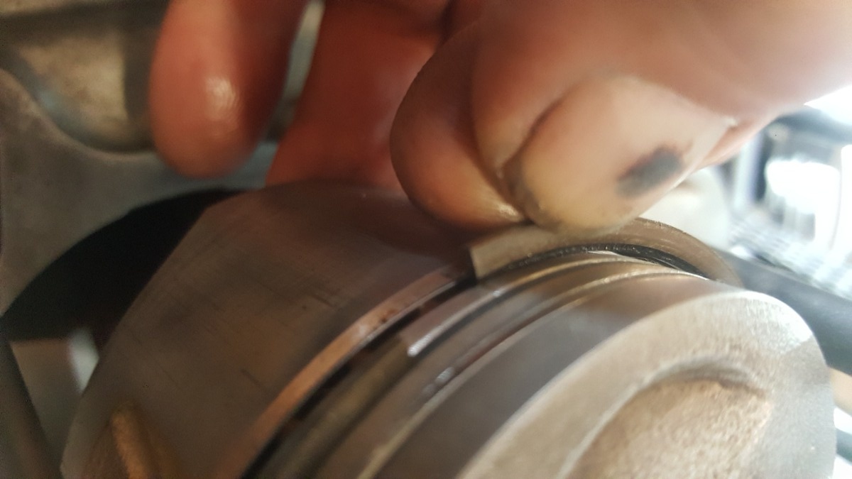

Look closely for an "N" near the end of the ring. You may need a magnifying glass.

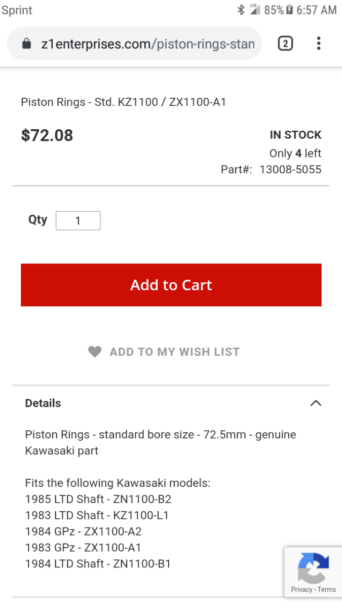

No marks on those. Probably why they were still around after 40 years.Z1 has them for $300 for all 4. Seems a little excessive.

It's an 83 shaft drive. Bike doesn't have the value to justify the kind of money I'm putting it at 40 bucks a valve and 75 bucks for a ringset. Rethinking this.

Did you already buy the parts? As I remember some rings have a bevel and others a step in them. They face down.

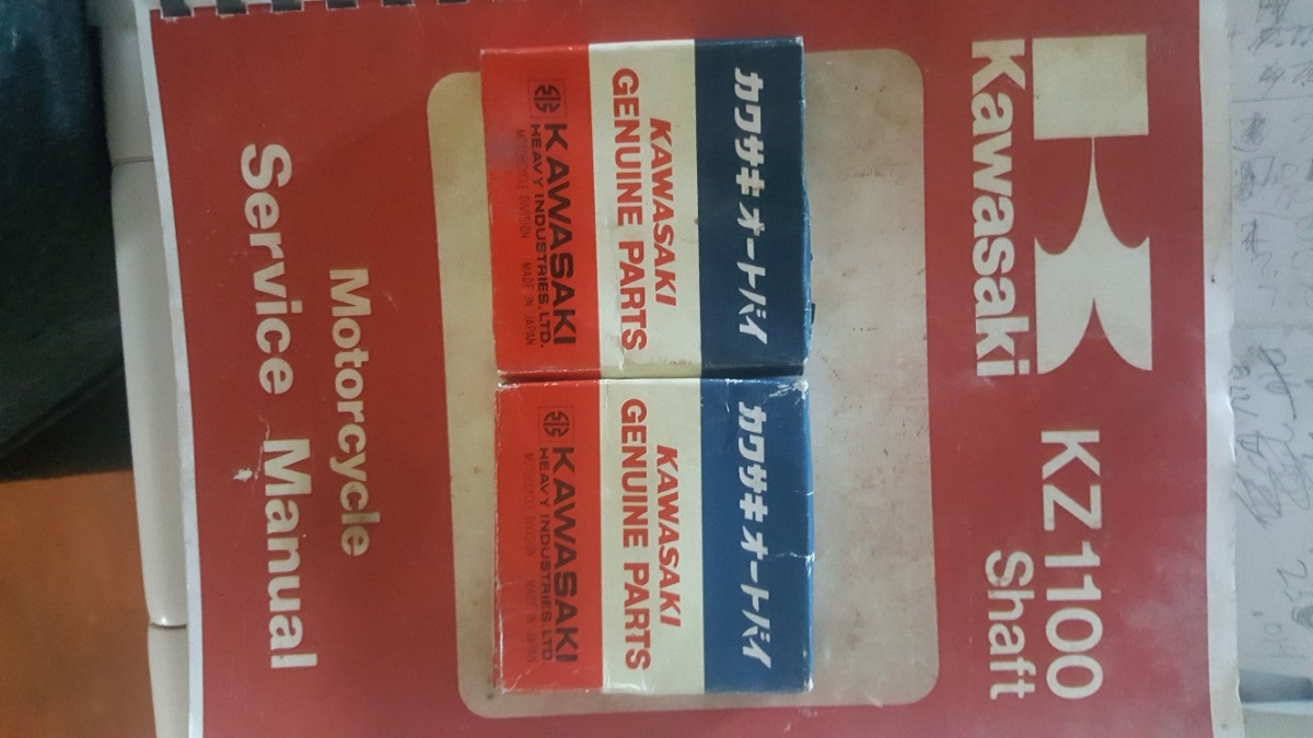

Last of the valves and rings came today. And a 71-73mm ball hone.
I looked under magnification and only saw any stamp on the one with the outer groove in it. N is up and groove is up on old set still on piston.
All the others look to be able to go either direction. No markings, no bevels, flush ends.
Second ring has groove and facing down.
Going to remeasure bores one more time and make a record so I remember later and doubt myself.
