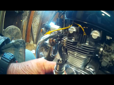

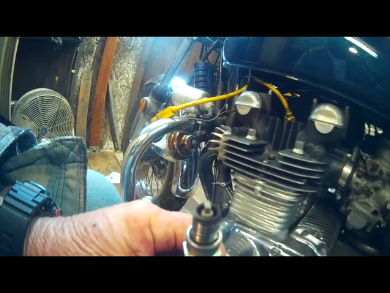

After100+ mile ride on new plugs burning 93 octane premium E10 fuel:

  • Street Fighter LTD
  • Street Fighter LTD's Avatar
  • Moderator
  • Moderator
  • Posts: 5184
  • Thanks: 2339
Re: Top-End Redo
28 Oct 2019 08:10 - 29 Oct 2019 05:28
#813157
Let Her RIPPPPPP !!!!

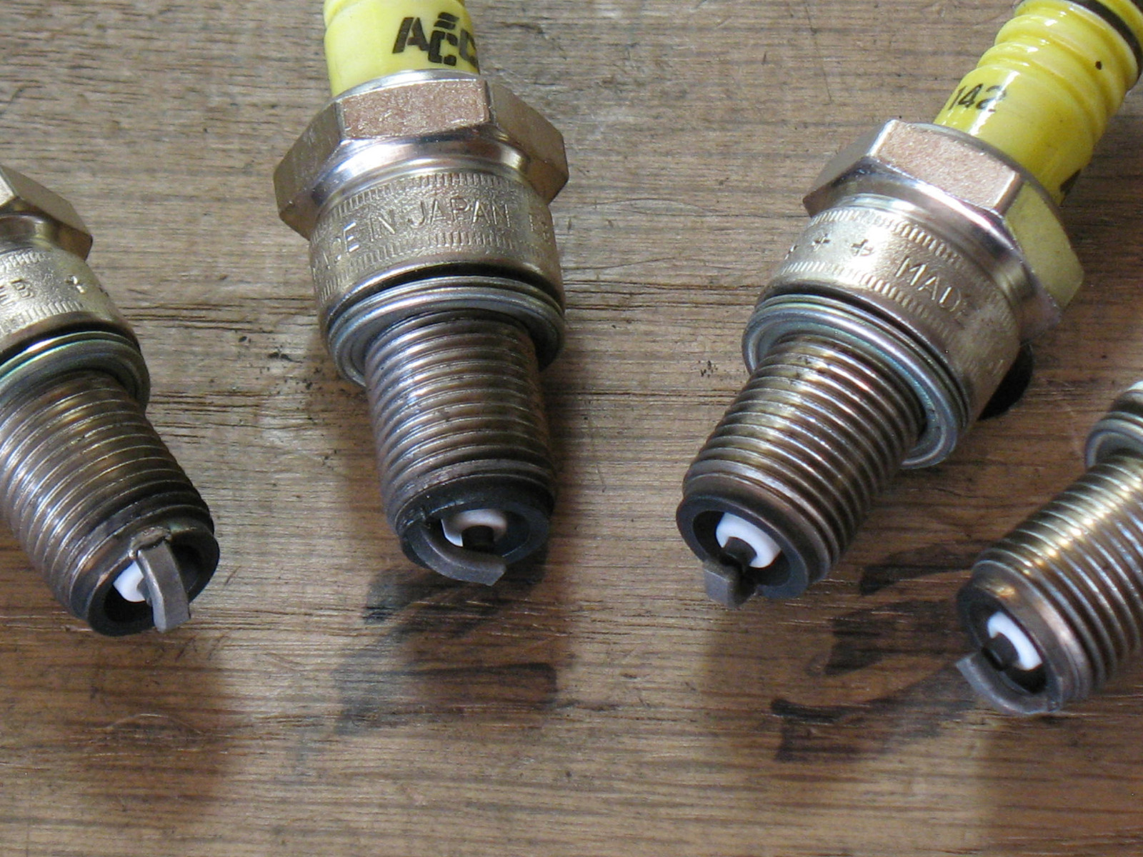

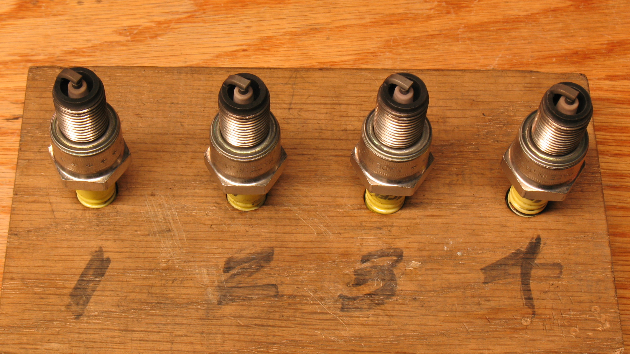

Spark plugs
800 miles since new. Wire brushed at 500 +/-
E10 Regular Gas
Thanks Joe
1982 KZ1100-A2/1170 sleeper πŸ˜€

  • SWest's Avatar
  • 10 22 2014
  • Posts: 23779
  • Thanks: 3045
Re: Top-End Redo
19 Mar 2020 10:02
#821222
They look better. Not as lean. B) Maybe I should relax about mine and RIDE THE PISS OUT OF IT. :woohoo:
