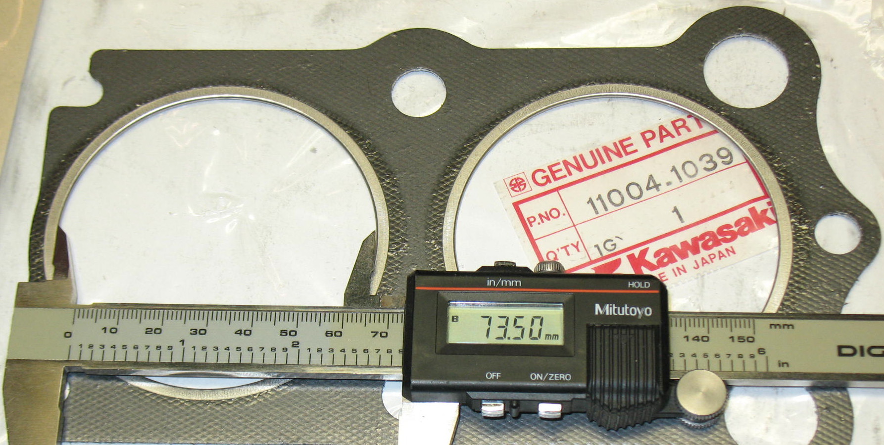

Would someone please explain why the Genuine Kawasaki two-piece gasket will not work with the MTC 1135 (74mm bore) piston kit, considering it would likely be the gasket used with Genuine Kawasaki oversize pistons?

18 Aug 2019 18:53Dave
If your head gasket hangs into the cylinder by even a small amount as your mic shows the gasket metal surround wont be
in the proper space to be clamped down for a proper seal. Next the gasket will be more exposed to combustion heat and premature failure.
Next the gasket will be exposed to carbon buildup which cant be good, for detonation

Thanks Dave. So a gasket made for a 74mm bore will be larger than that after it gets compressed.
That means the Kawasaki piston oversize bores must max out close to 73mm. to work with that Kaw gasket...:huh:
Got it!
