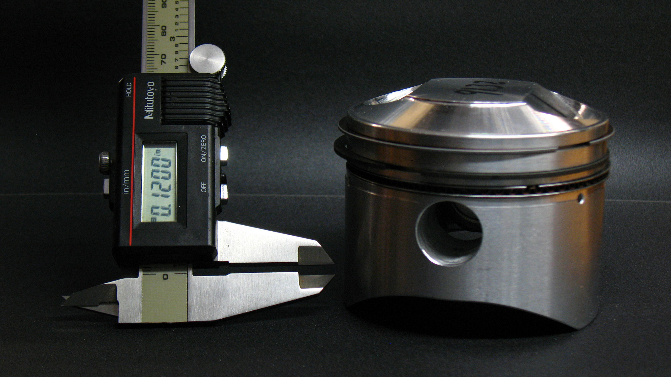

Don't have piston pictures as the engine is built.it's the 1135 10.5 -1 compression kit for the unitrack motor.Maybe Joe recommended taking a bit off the crown because you skimmed the head.I'll post a couple pictures of the bike for you in a couple of days, need to use my wife's phone as mine is from the stone age.

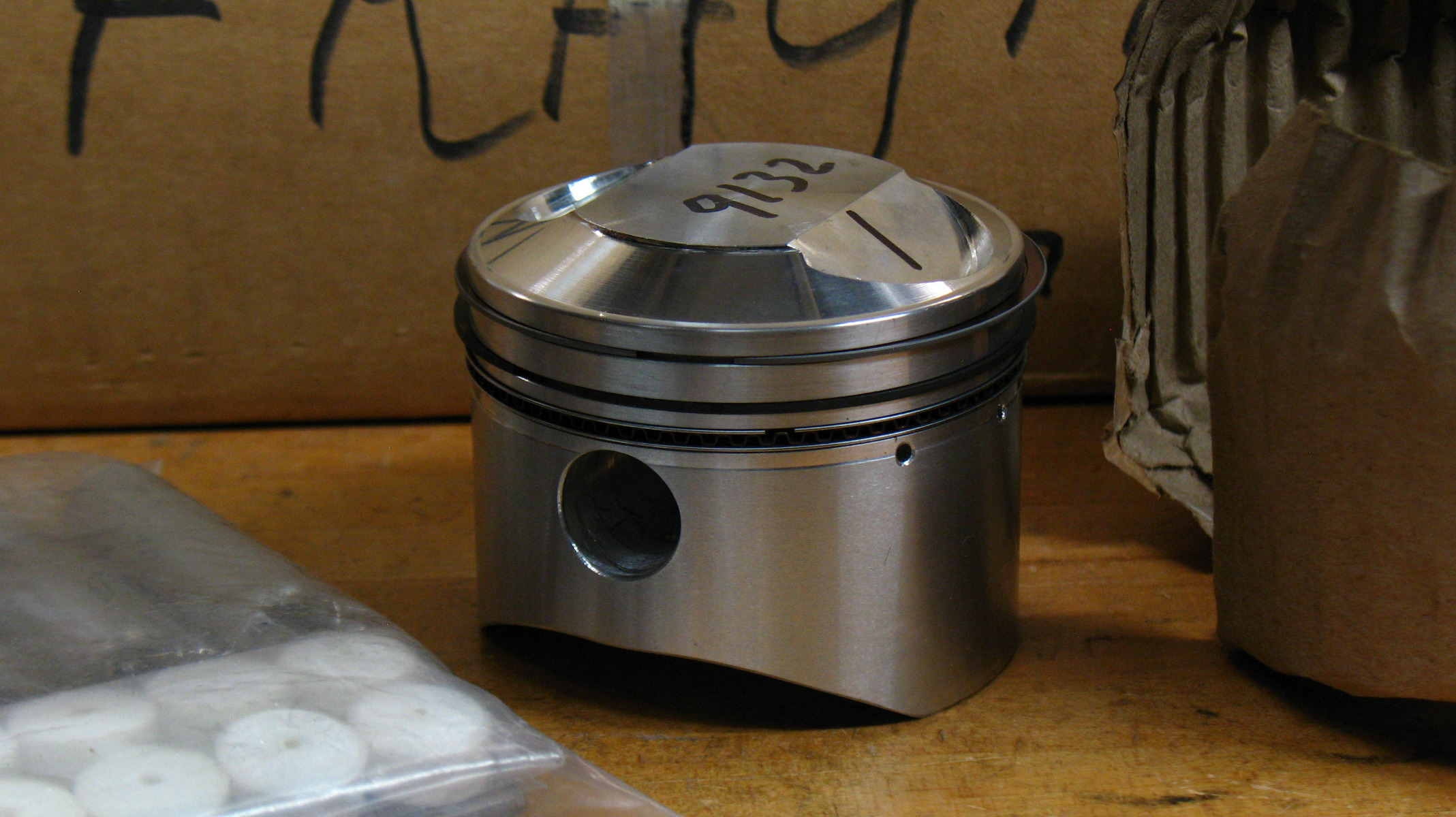

MTC G1135-3 Piston as provided:

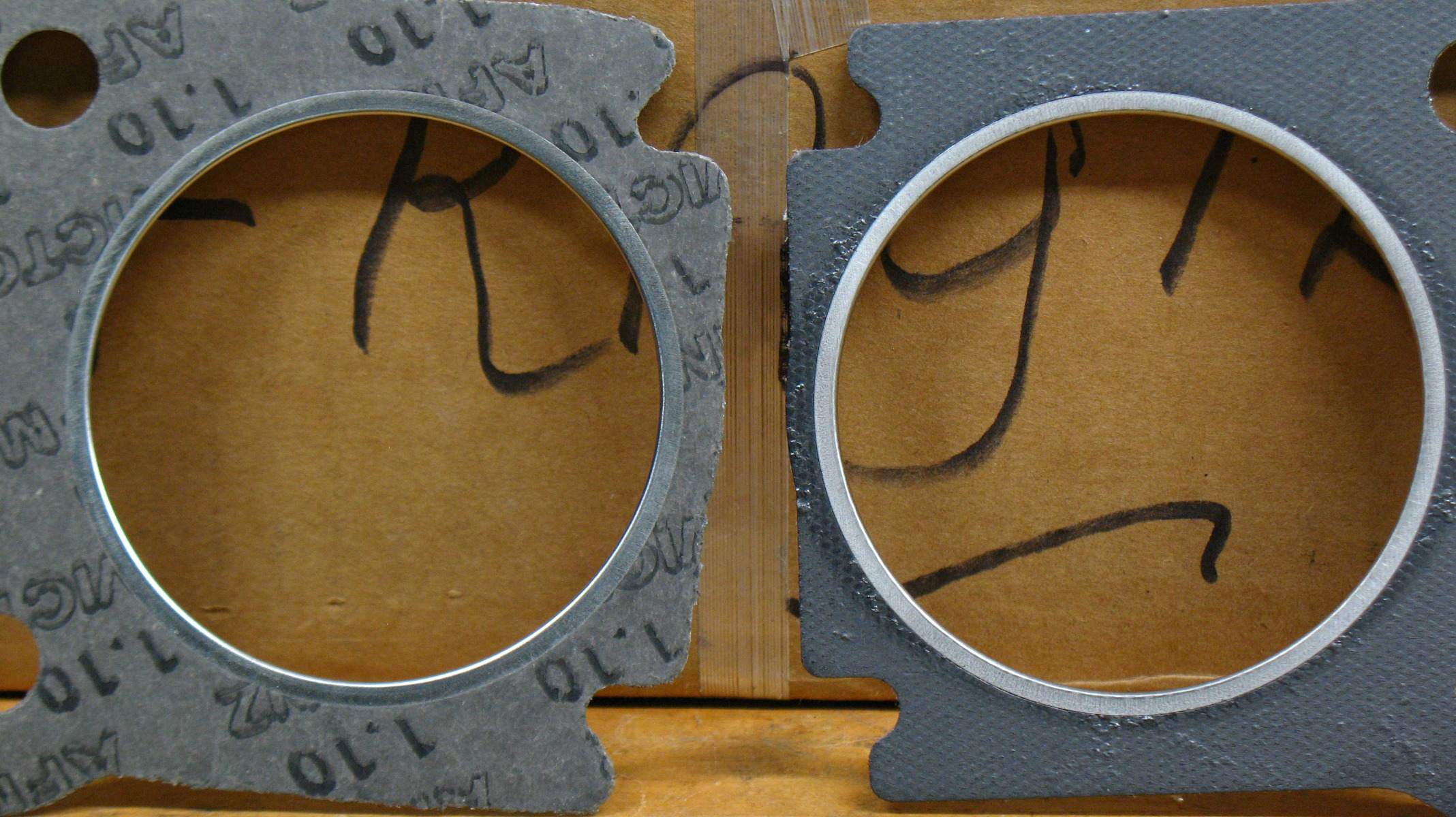

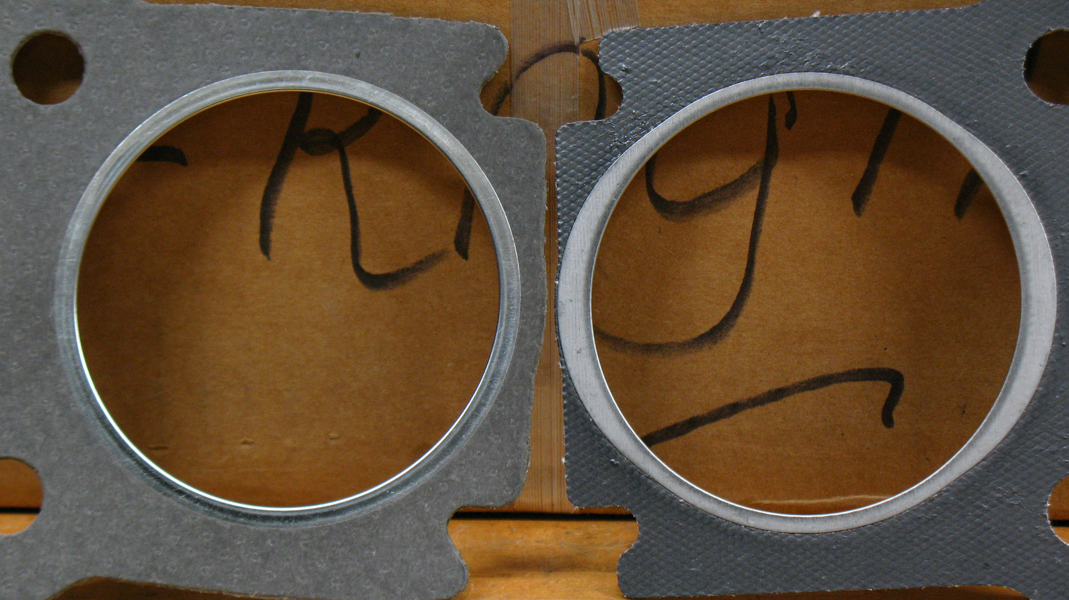

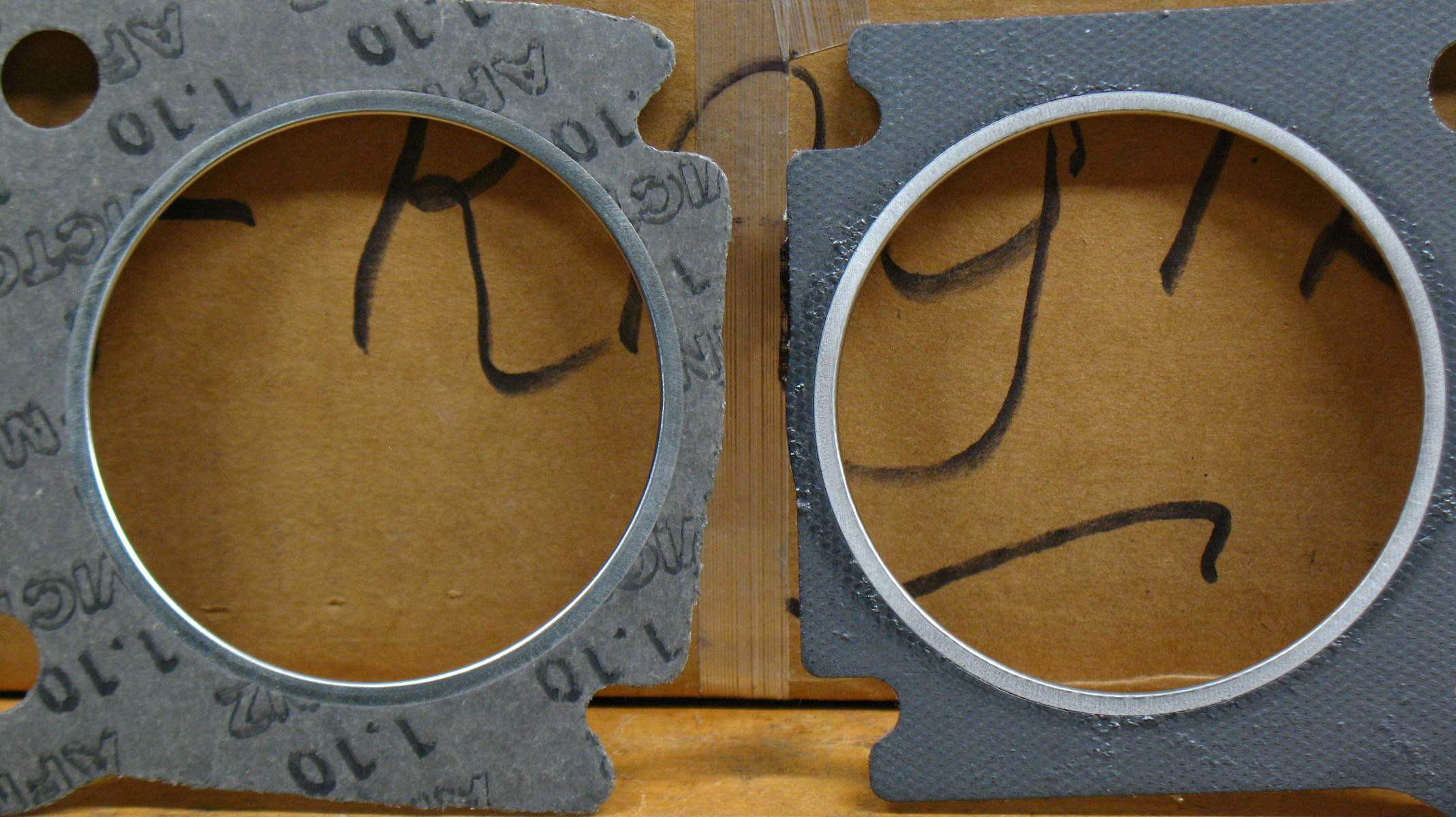

Head Gasket Comparison. Cometic and Genuine Kawasaki

Cometic Technical Service today put a halt to using either one of these gaskets. Said to "definitely use set having 74mm + bore opening for certain, and this set must have been improperly stamped when manufactured."
So, thank you again Dave for pointing this out. I prefer to err on the side of caution.
