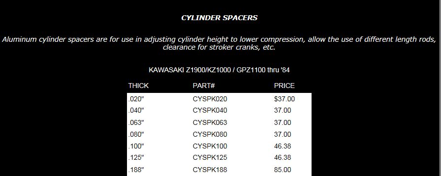

13 Aug 2019 12:41 - 13 Aug 2019 12:55ItΒ΄s easier to use a spacer under the cylinder block to lower the compressin. APE offfers spacers with different thickness.daveo wrote:
I received advice that having 1mm additional material removed from each piston crown during the manufacturing process would lower the compression ratio by some amount, and yield approximately 155lb. cranking compression pressure. This sounds reasonable to me, but I am no engine expert. I wonder what the new compression ratio would be, and whether it would enable regular gas use.
If you want to run regular fuel on 10.5:1 piston you can reduce the ignition advance timing 3-5 degrees .

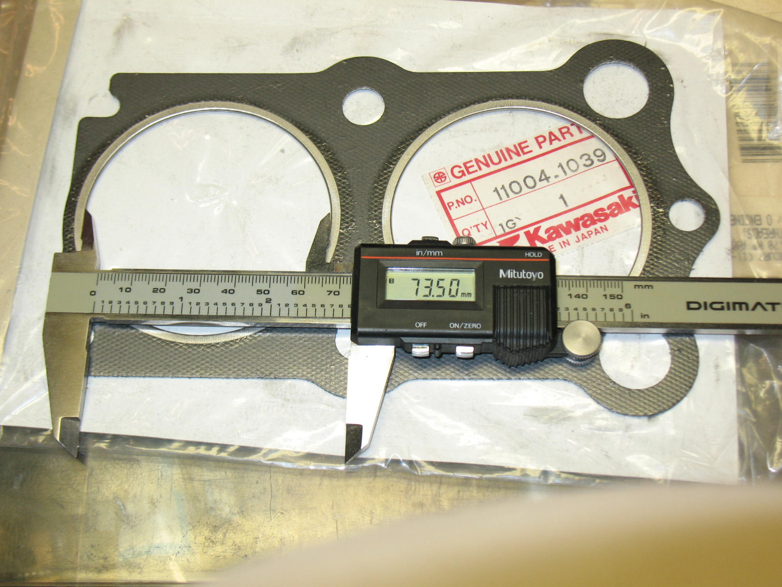

Will the OEM two-piece head gasket work properly with the MTC 1135 piston kit, for which I believe the bore size is 74mm?

My KZ cylinder block has recesses for o-rings at the four corner stud holes, whereas the ZX cylinder block this MTC kit is made for does not . Considering that, will a special head gasket be required for my application?
