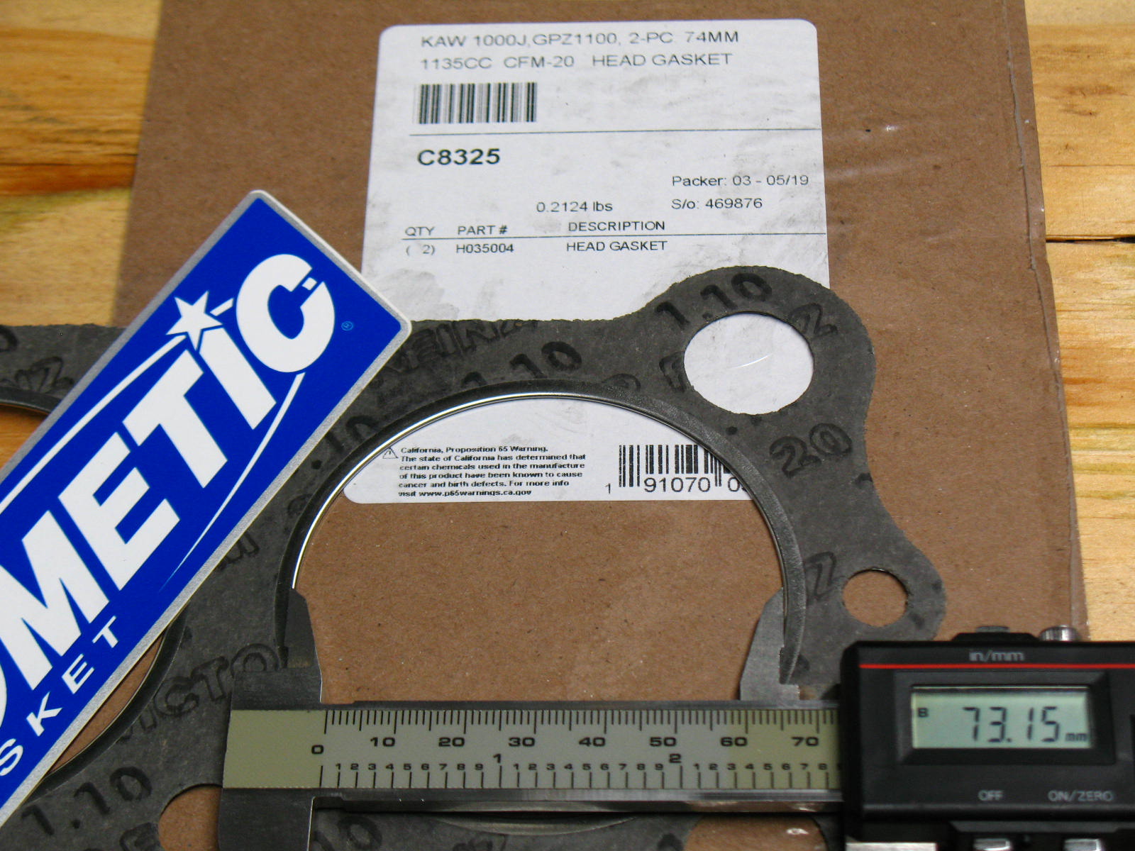

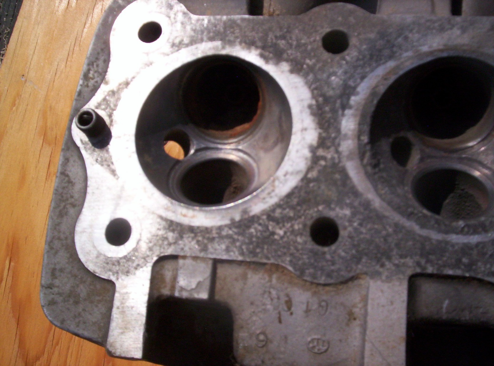

05 Oct 2019 18:27Street Fighter LTD wrote:
If your head gasket hangs into the cylinder by even a small amount as your mic shows the gasket metal surround wont be
in the proper space to be clamped down for a proper seal. Next the gasket will be more exposed to combustion heat and premature failure.
Next the gasket will be exposed to carbon buildup which cant be good, for detonation
:blink:

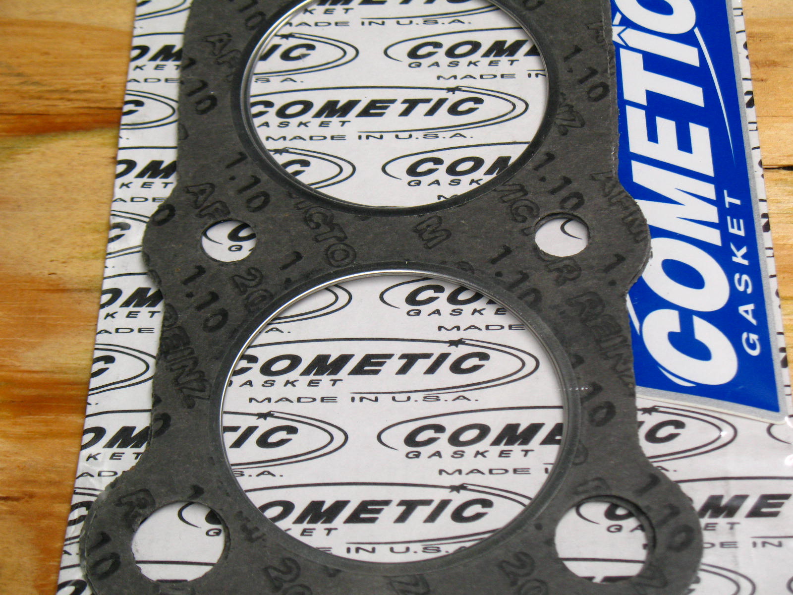

The Cometic head gasket pictured below arrived with the MTC G1135-3 piston kit received from Pit Stop Performance.
Note the measurement compared with the image above, and...please advise.
