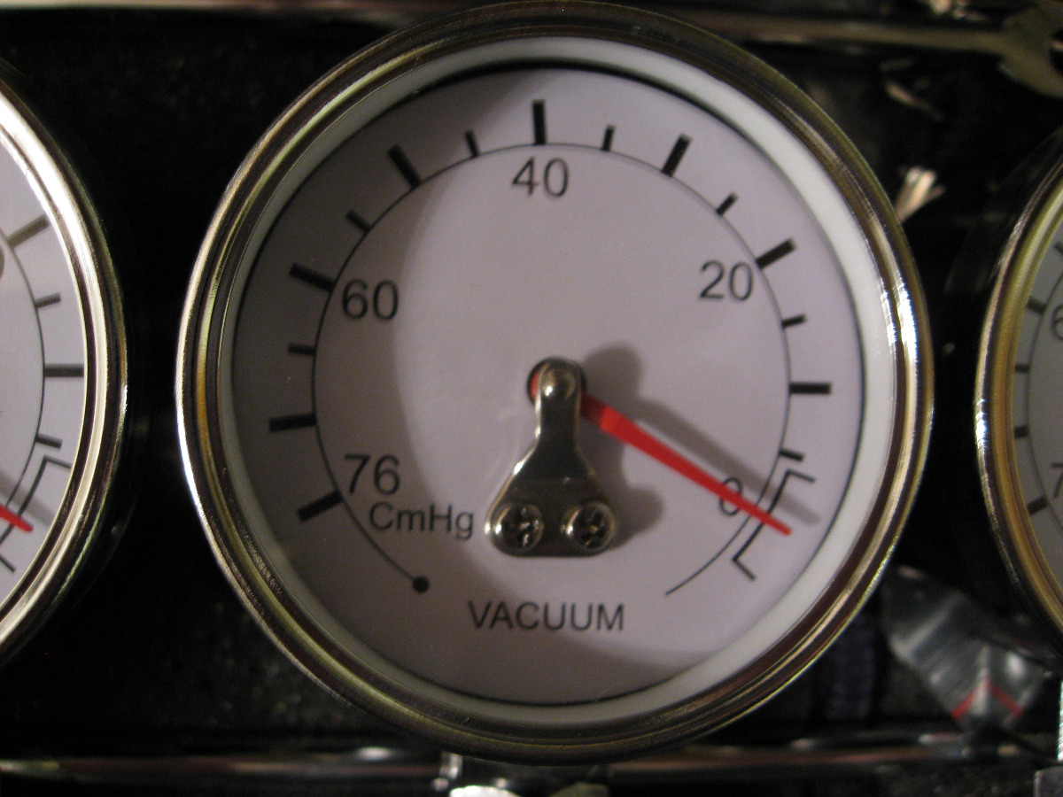

Vacuum gauges generally are calibrated in inches, cm, or mm or mercury (Hg) or sometimes water. That measure shows the height mercury would be drawn up a column for a given amount of vacuum. Because water is lighter than mercury gauges calibrated for water show higher numbers than those calibrated for mercury.
Some gauges may be calibrated in millibar; or mbar although those units of measure usually are used when measuring pressure rather than vacuum. Can you post a closeup pictures of the front and rear of one of your gauges? They should be marked. Below is a picture of one of my gauges; it's calibrated in centimeters of mercury (Cm/Hg). Ed

Mine are just regular carb sync vacuum gauges. Here's the picture.
Last edit: 07 Aug 2017 19:30 by jenningsjesse. Reason: Picture didn't add

What does it say on the bottom line?
Re: Gpz 750 head is bowed slightly
07 Aug 2017 20:18jenningsjesse wrote: My vacuum gauges
If you look at the lower half of the gauge you will notice on the outside of the calibration ring there are calibrations for inches that range from 0 – 30 and on the inside of the ring there are calibrations for mm that range from 0 -760. Those are the vacuum measurements in inches / mm of mercury. Ed
