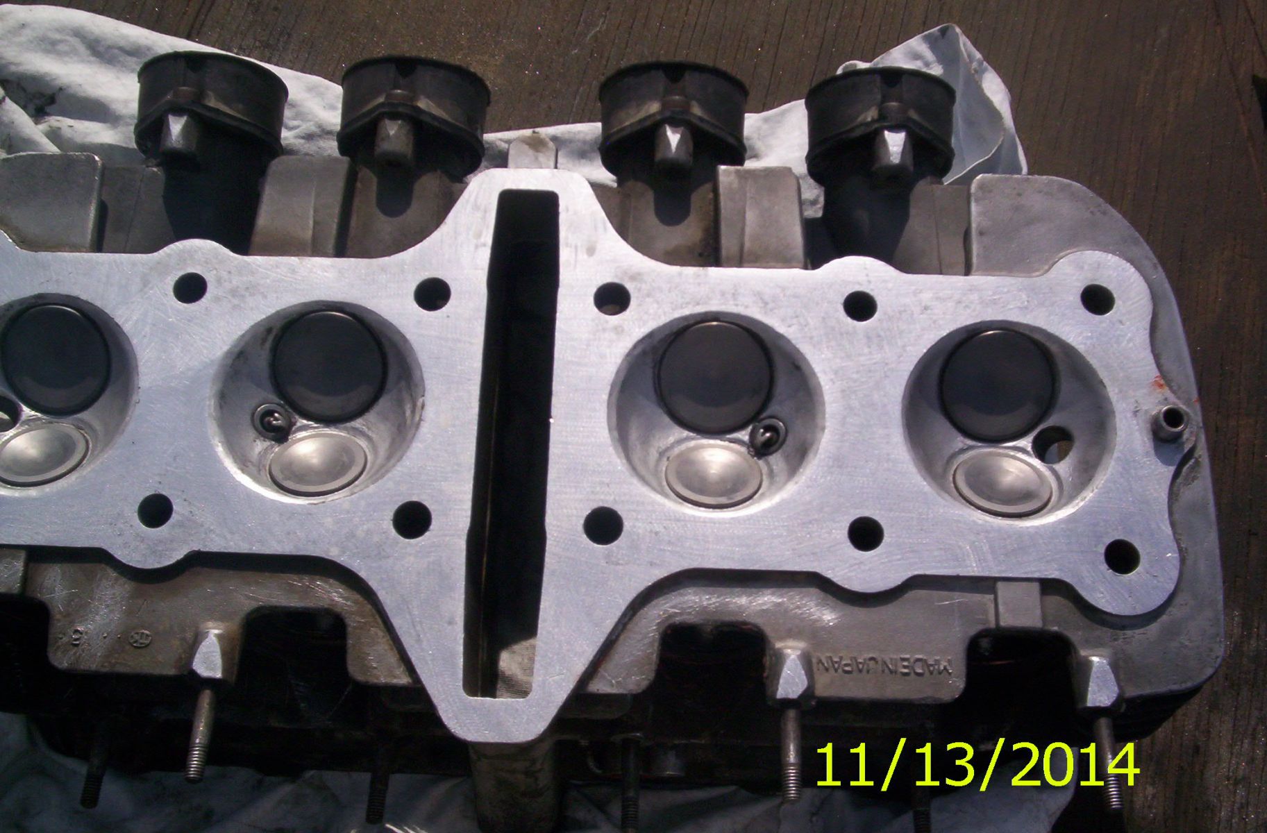

Pics?

09 Sep 2015 16:06swest wrote: Pics?
I tryed posting some but idk how.....are you callin BS?

Lmao that time it work lol what pics do you want to see
