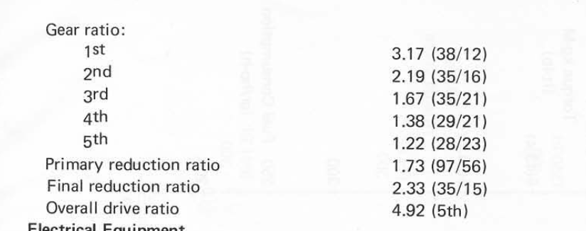

- Posts: 23759
- Thanks: 3023
Re: Z2 750 crank (Bossie the Kaw)
16 Jul 2020 18:58
Is there a difference between 73-78?
- Posts: 3150
- Thanks: 1248
17 Jul 2020 05:21
Not that I'm aware of, but there is an optional transmission with different gearing. But I just realized you pulled your kickshaft when you were dismantling the engine. The optional transmission doesn't allow use of a kickshaft so your tranny must be the standard model.
- Posts: 23759
- Thanks: 3023
17 Jul 2020 06:41
It was the shifting forks but I don't see what caused it.
