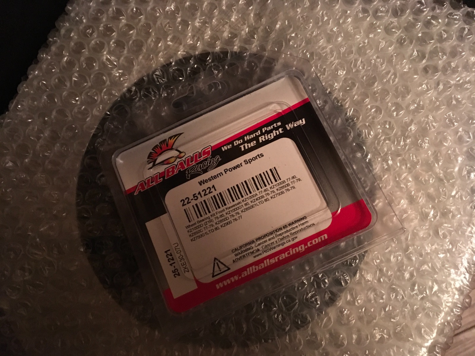

Steve I have only purchased a half dozen “All Balls” items but every sealed bearing has had blue dust seals and all items have come in hard plastic packaging. I’m sure All Balls would like to hear about shady sellers.
Last edit: 31 May 2020 19:49 by Mikaw. Reason: Spelling

02 Jun 2020 14:50
Bait and switch by eBay. As always buyer beware. They do have their uses though.
