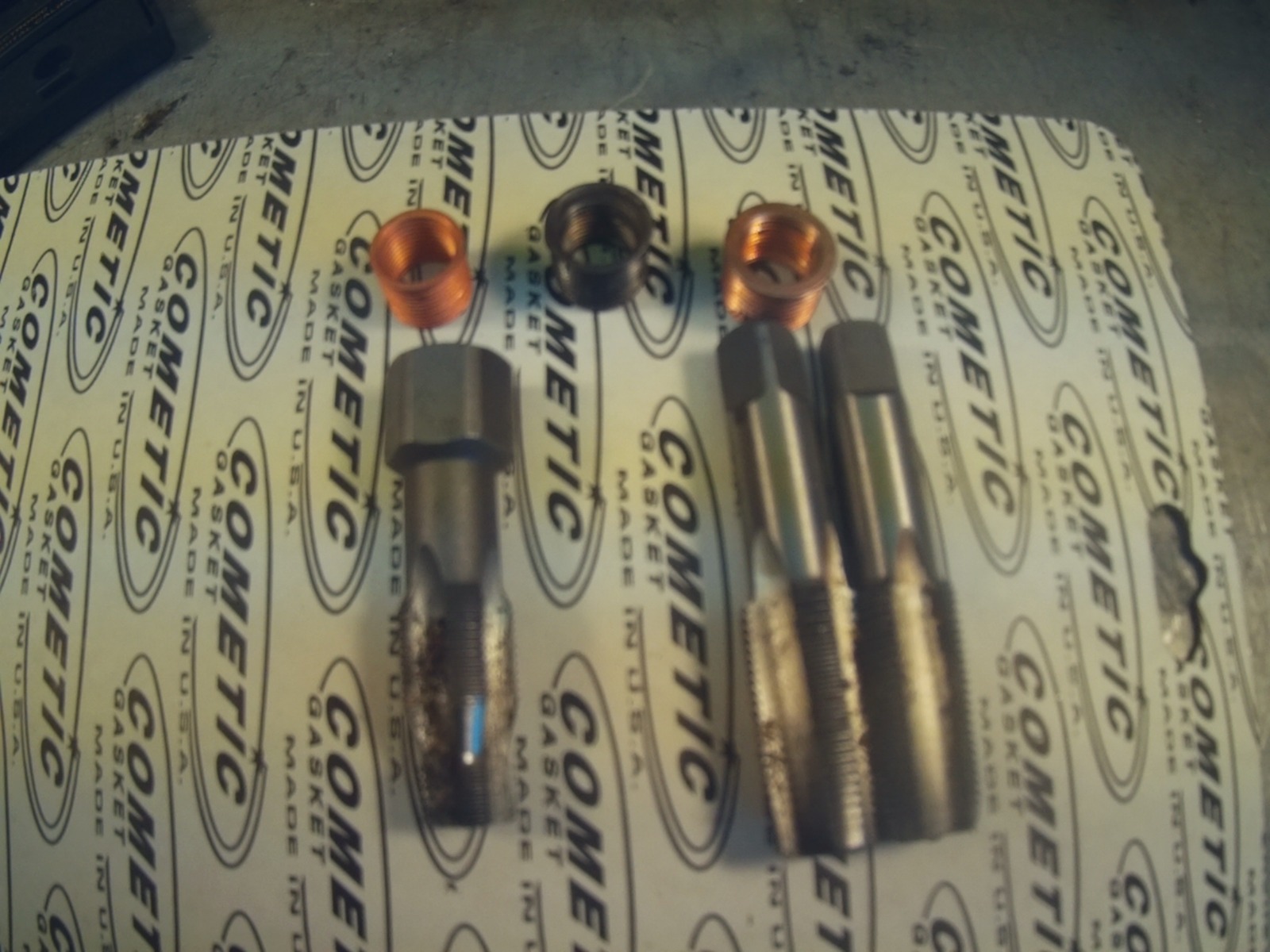

This is what I bought to make it work.

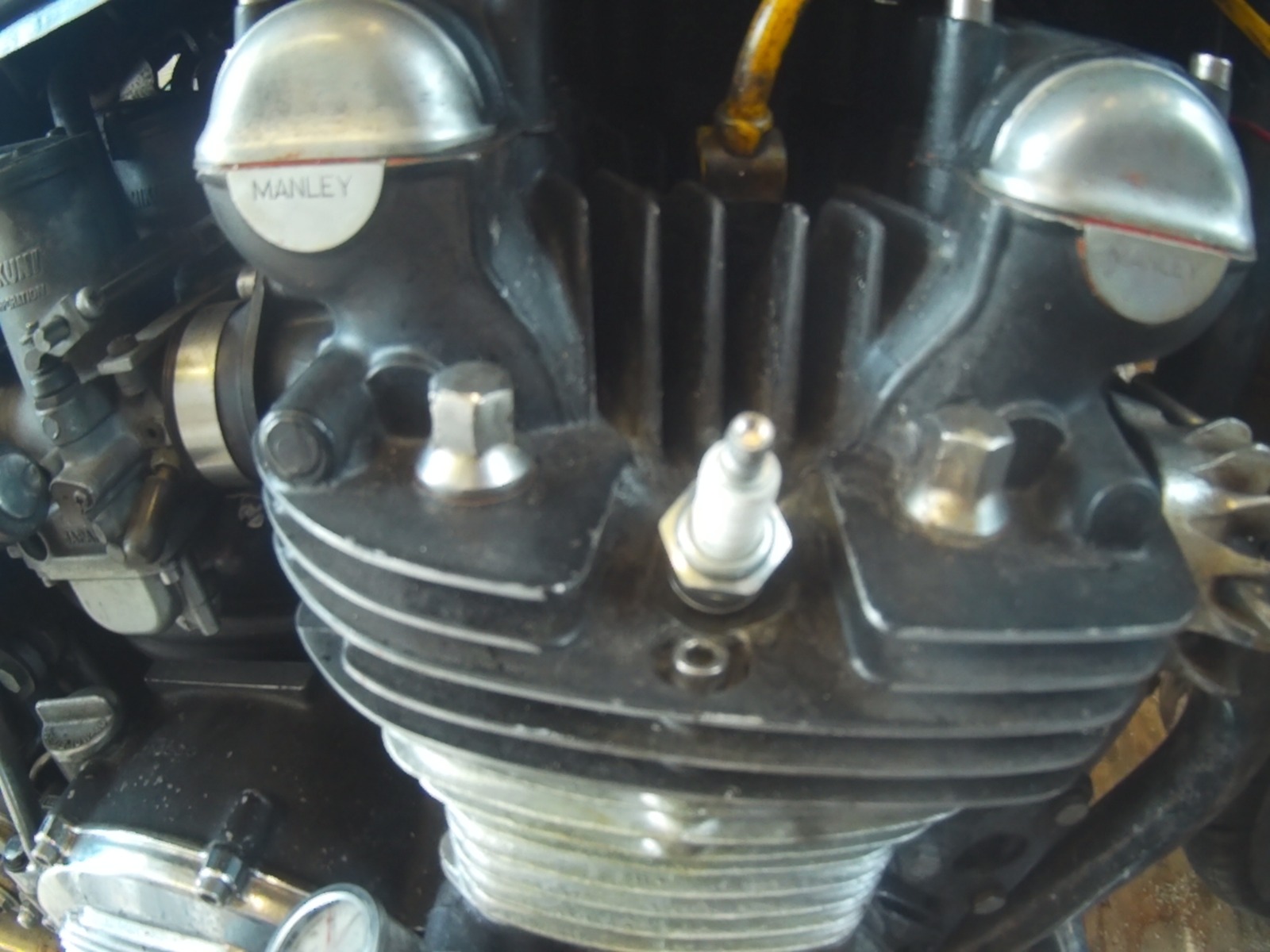

To summarize what I've learned in this multitude of errors is this.
I should have fixed the spark plug threads while the head was on the bench. :blush:
( My reply to Dave's PM)
"After what I went through I can only say this.
I should have gone Helicoil.
The Time Sert would have been better but for one plug it wouldn't have been worth the $2/300 just for the tool. All four maybe.
The Save A Thread would have worked being the tap would have followed the threads and been straight. I wouldn't recommend it due to it being so large it exposed the cast in seat thus a shorter insert was needed. Sealing it was another problem and after three fails the only thing left was the Big Sert.
The Big Sert is big enough to fill the hole using a M 18 1.5 tap. Using the tapered tap first allowed me to correct the bad angle caused by the first CHEAP tool and no instructions.
Steve"
My next mistake was not doing my research before I bought anything. That led me down a path I'd wish on no one. Though none of the kits had instructions there is the web and I could have saved myself time and money.
The Helicoil would have worked but if it failed the Time Sert wouldn't have been an option. It's one or the other.
The Save A Thread could have worked but the cast in valve seats are too close so grinding it shorter to 15mm was the only option for it to fit flush so the gasket would seal on the head.
The Big Sert is large enough so the hole could be tapped to fit.

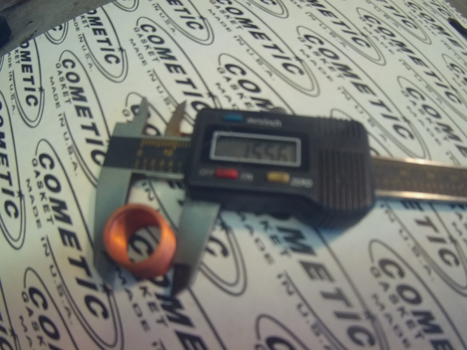

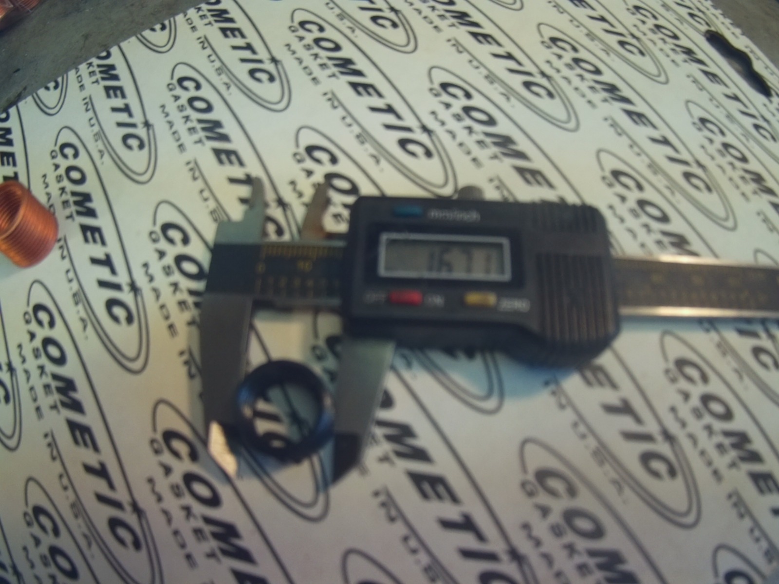

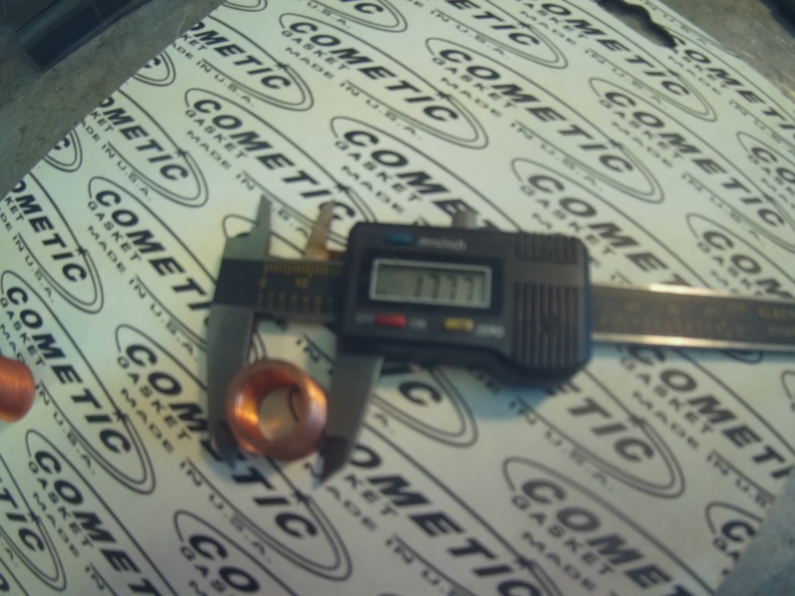

Here's a break down on the sizes.
Time Sert 15.56mm
Save A thread 16.71mm
Big Sert 17.77mm
The good thing about all this is the plug seals on the Big Sert and you can't tell it's been repaired with the plug in. :whistle:
I consider myself lucky it could be done.
Steve"
Time Sert 15.56mm
Big Sert 17.77mm

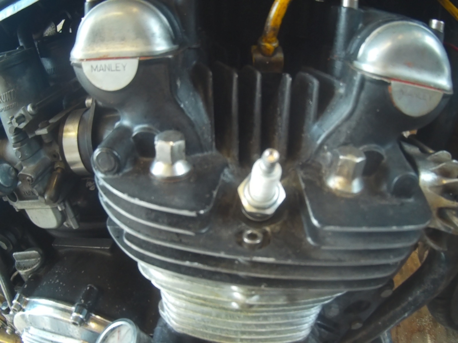

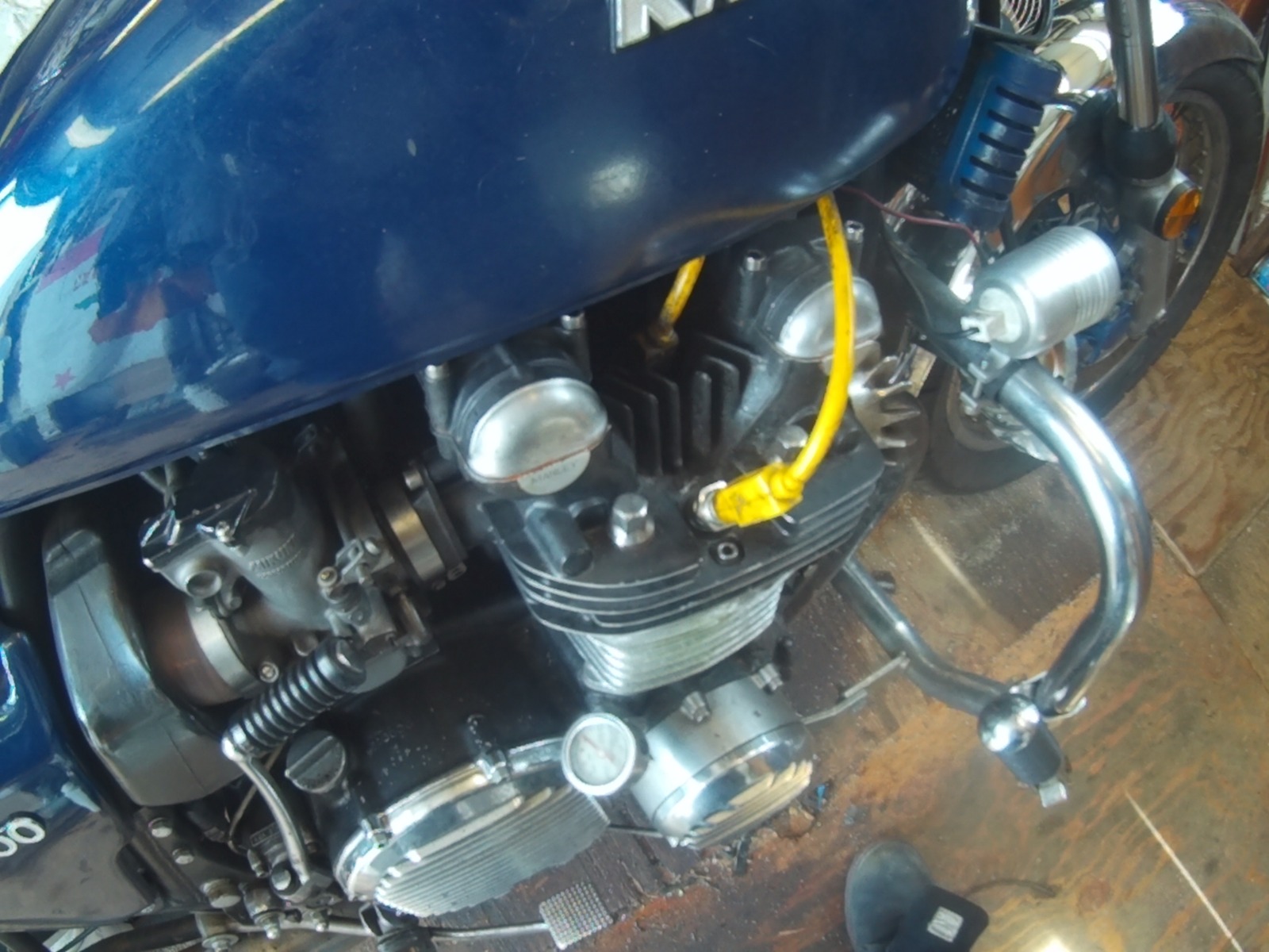

Plugs look good but i won't be getting any long rides in for a while. California has a stay at home order now.

The head is worth keeping so repairing the plug threads was a must. The light porting made a big difference. I can tell when I get to 6000 RPM it starts to pull stronger and wants to dive into the redline. I pulled onto the highway and wrung it out in three gears. It wanted more but I was already at a ton so I backed off. Third was pulling like the first two gears and I'll bet 4th and 5th will do the same. I'd better beef up the frame before I get myself in trouble.
I was trying to point out the depth needed for the inserts. I'll pullout the other head and measure the depth of the holes. 15mm might be the longest insert that can be used. 16.8mm is the common size and may be too long. We'll see. :whistle:
