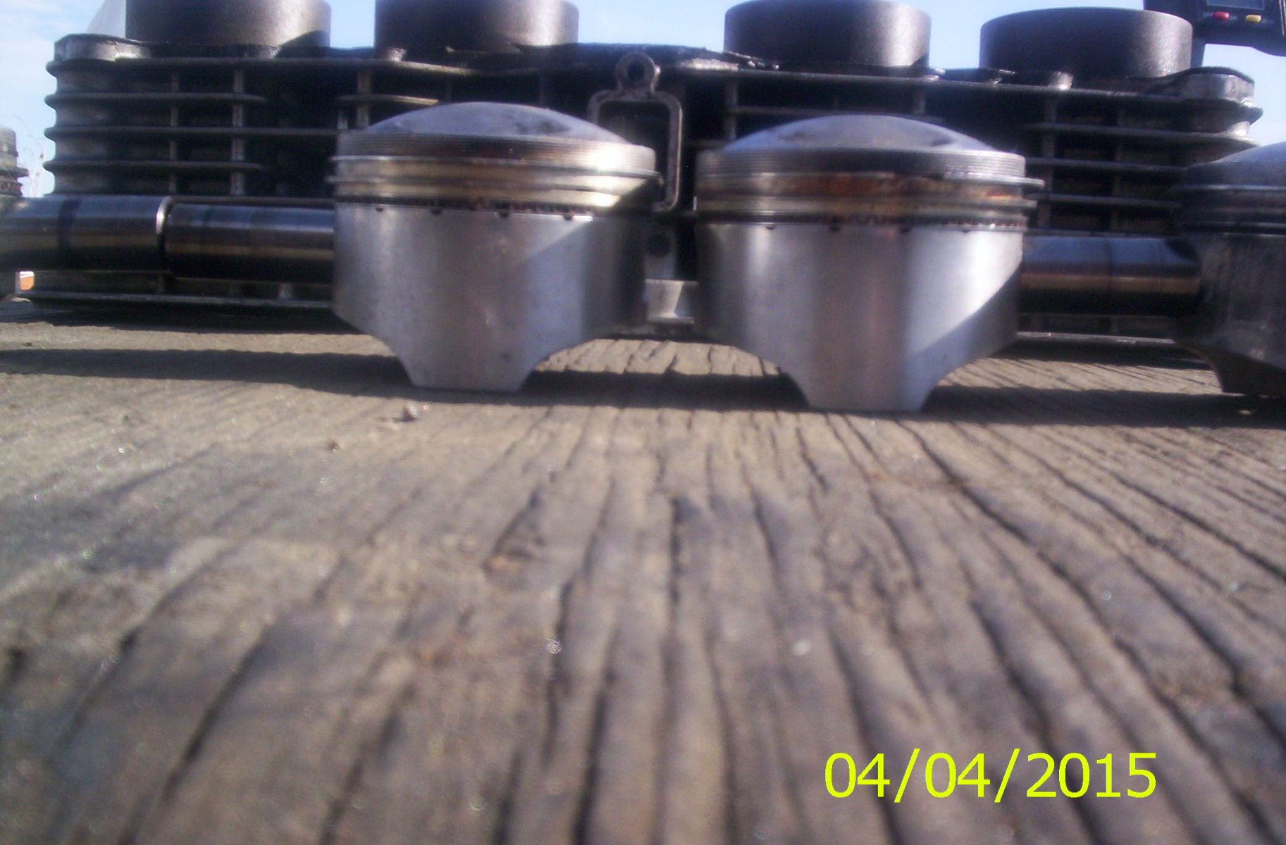

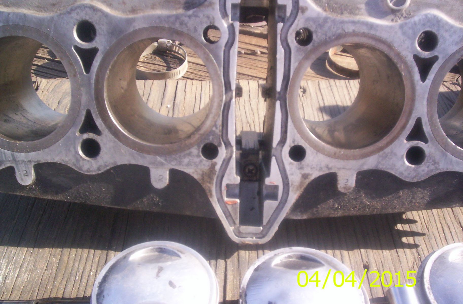

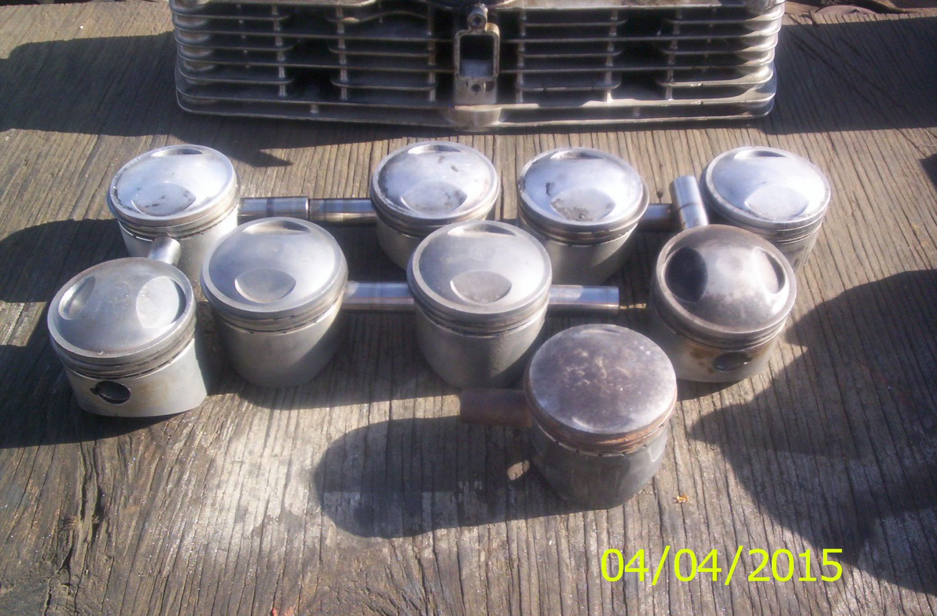

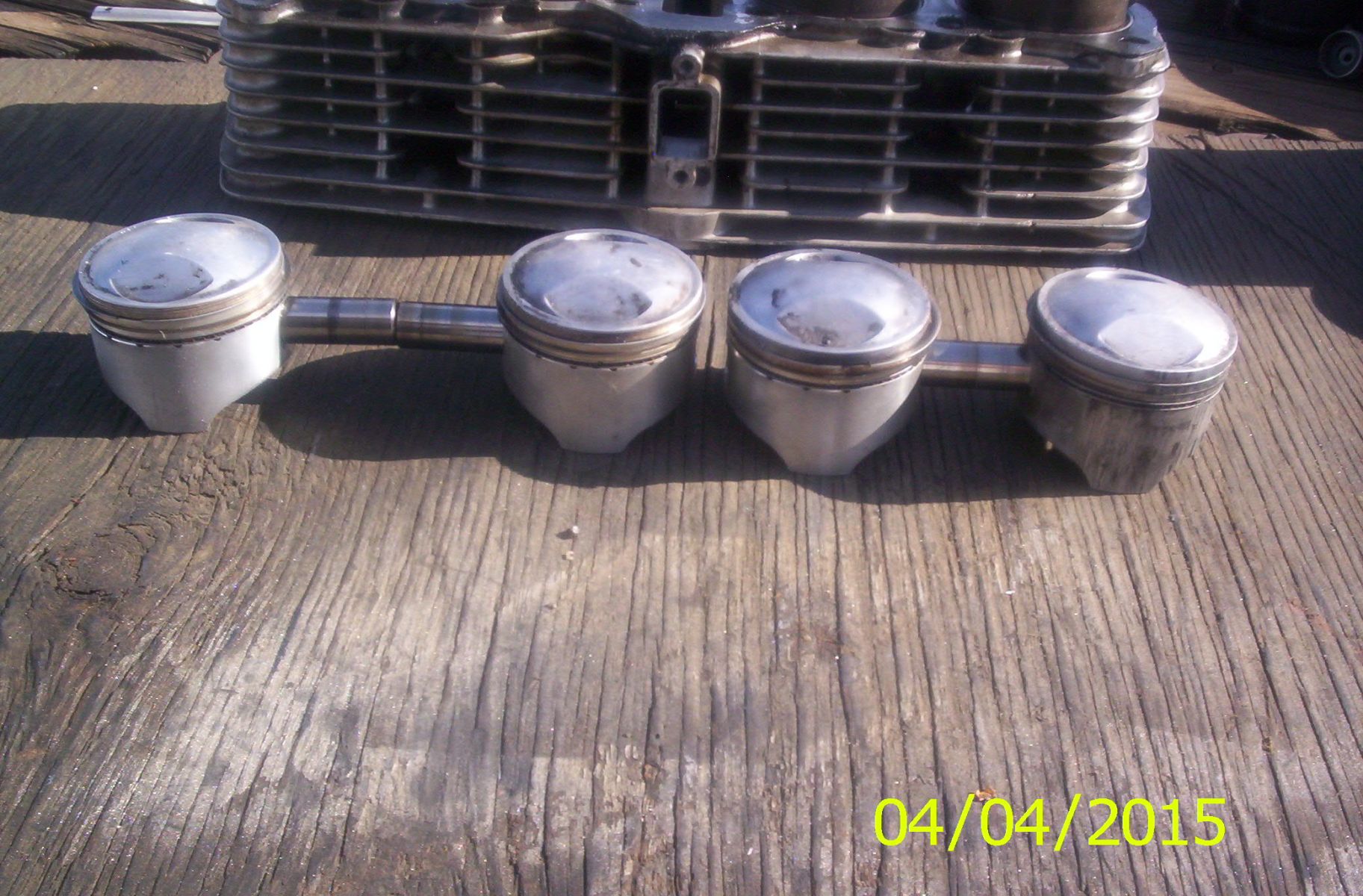

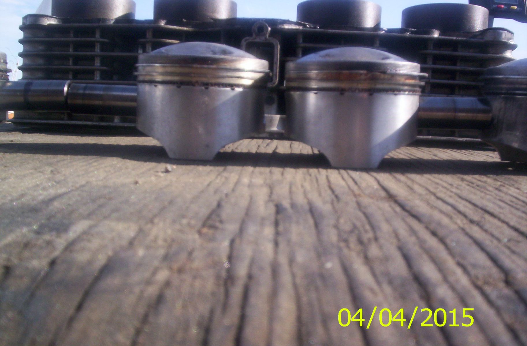

One of the members has accused me of not being truthful of my build. Being I will be going back into my engine in the near future, I will photo document it.
The sleeves were out of the 750 motor. The bore was still good when I replaced the cast pistons. They were damaged when I lunched the one piston. Notice there is no groove at the bottom of the sleeve as there would be if they were bored out 900 sleeves. Not much but it would still be there.
The billit pistons are shorter and lighter than the cast ones.
Here they are for compareson.
The one in the front is a 903 piston
The jugs are just under 2 mm. The bores are scored but the problem was they are pitted as well.

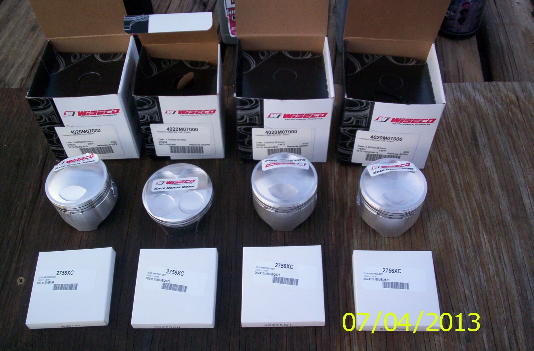

That's why I bought the 1015 block and pistons. Good thing too, I'm running them now. Light hone and back on the road.
