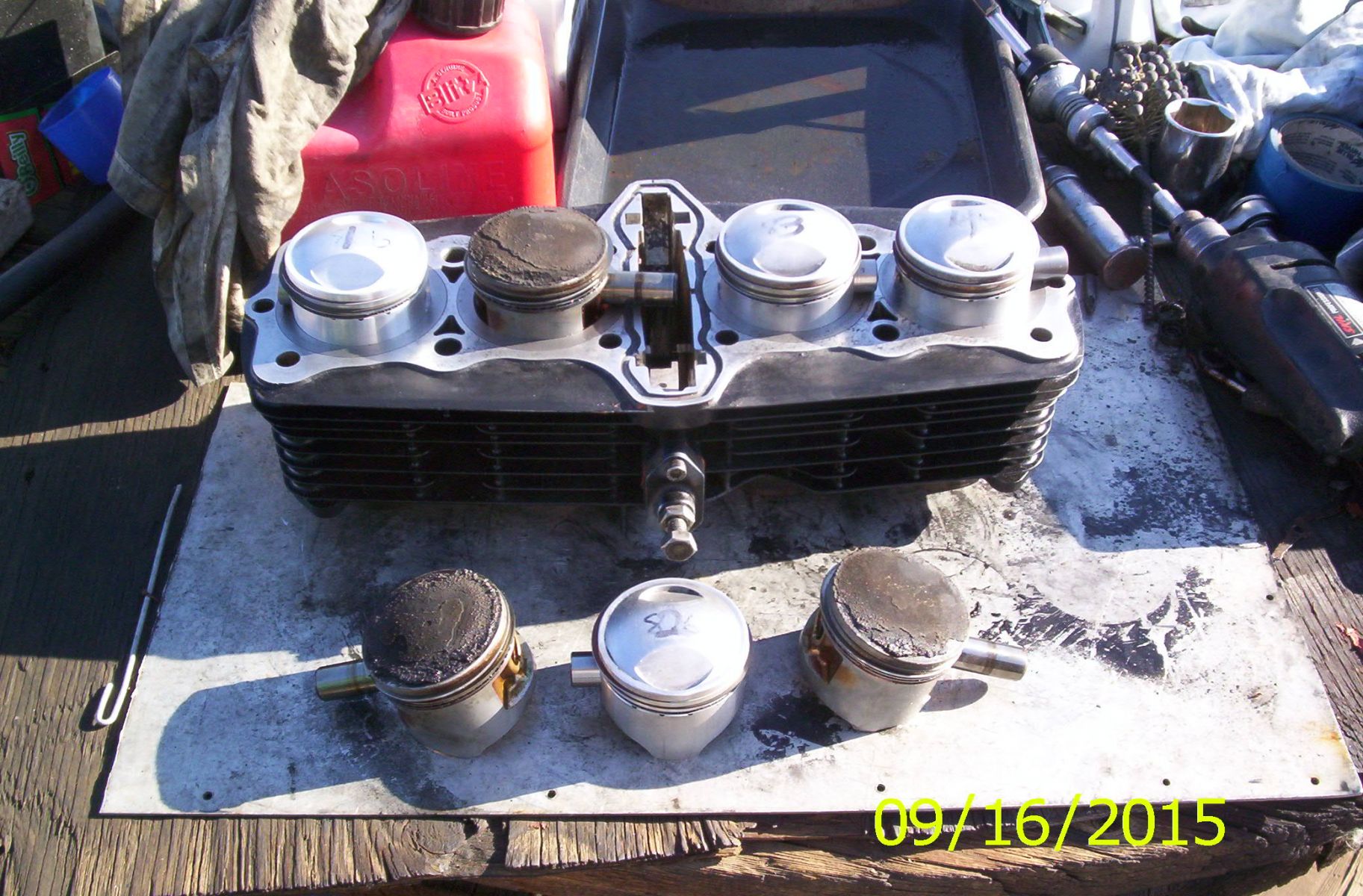

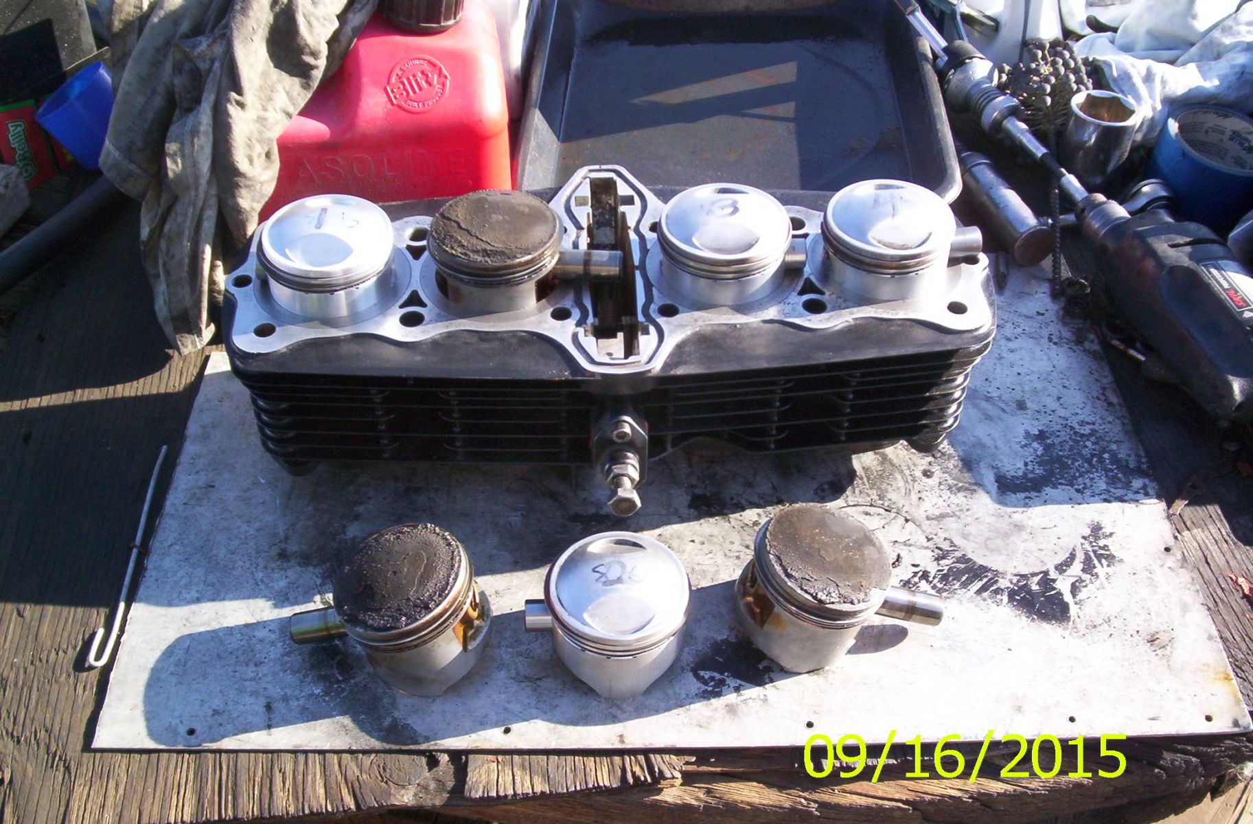

It was a used set I got on eBay. Great shape, wasn't planning on using the pistons, that's when I found I lunched one of my good ones. I put them in used rings and all with a light hone. The bores have light scratches in them now. I honed them and they will work. I see a 1075 or 1105 in my future.

These are used pistons and rings going into a different block? Done that myself too. Just hope your rings bed in.
I cant find nos old design wiseco rings for my GPz615 so I'm going to have to risk it and use 'quick seat' lube from total seal and some running-in oil.
Maybe check your installed ring gap to match the pistons to the bores as best you can, there is often a measureable difference - 4 thou on my last used set.

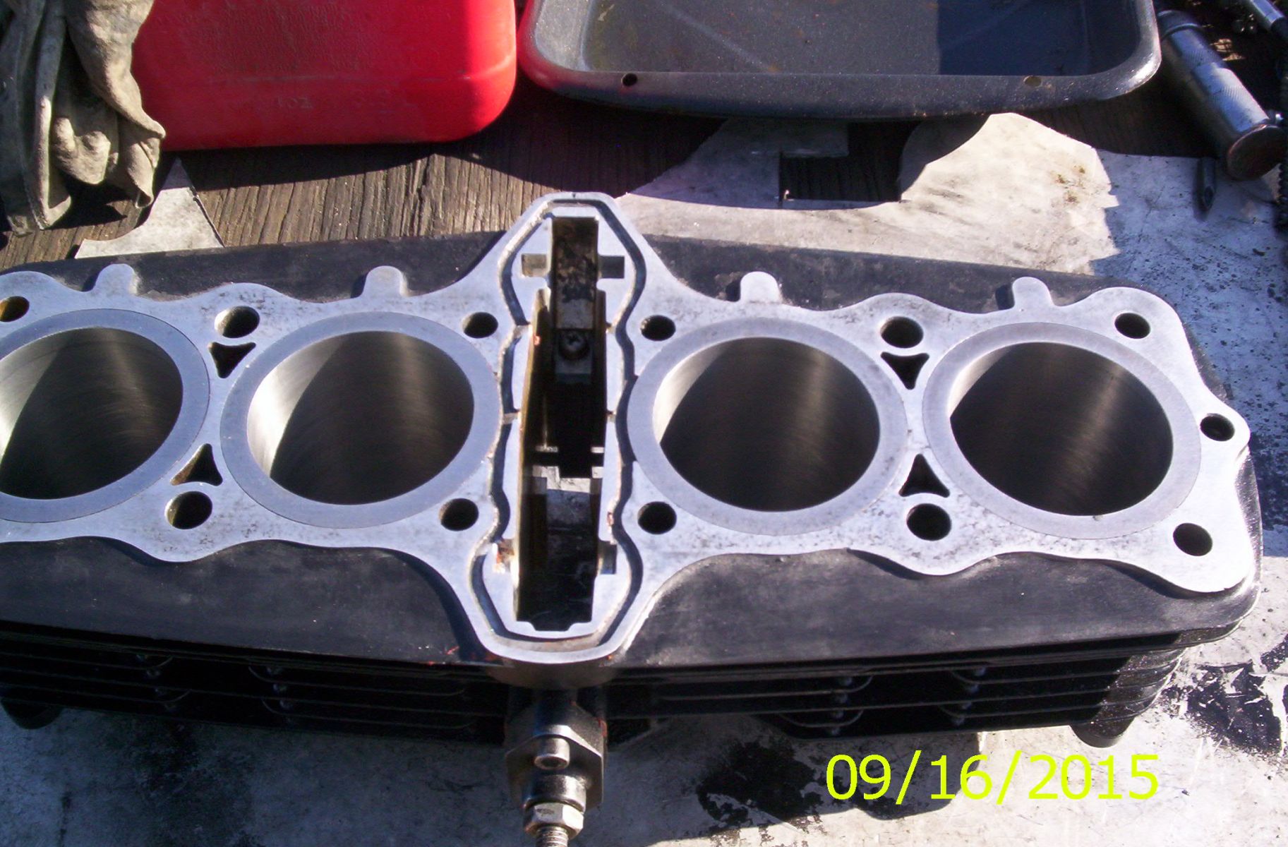

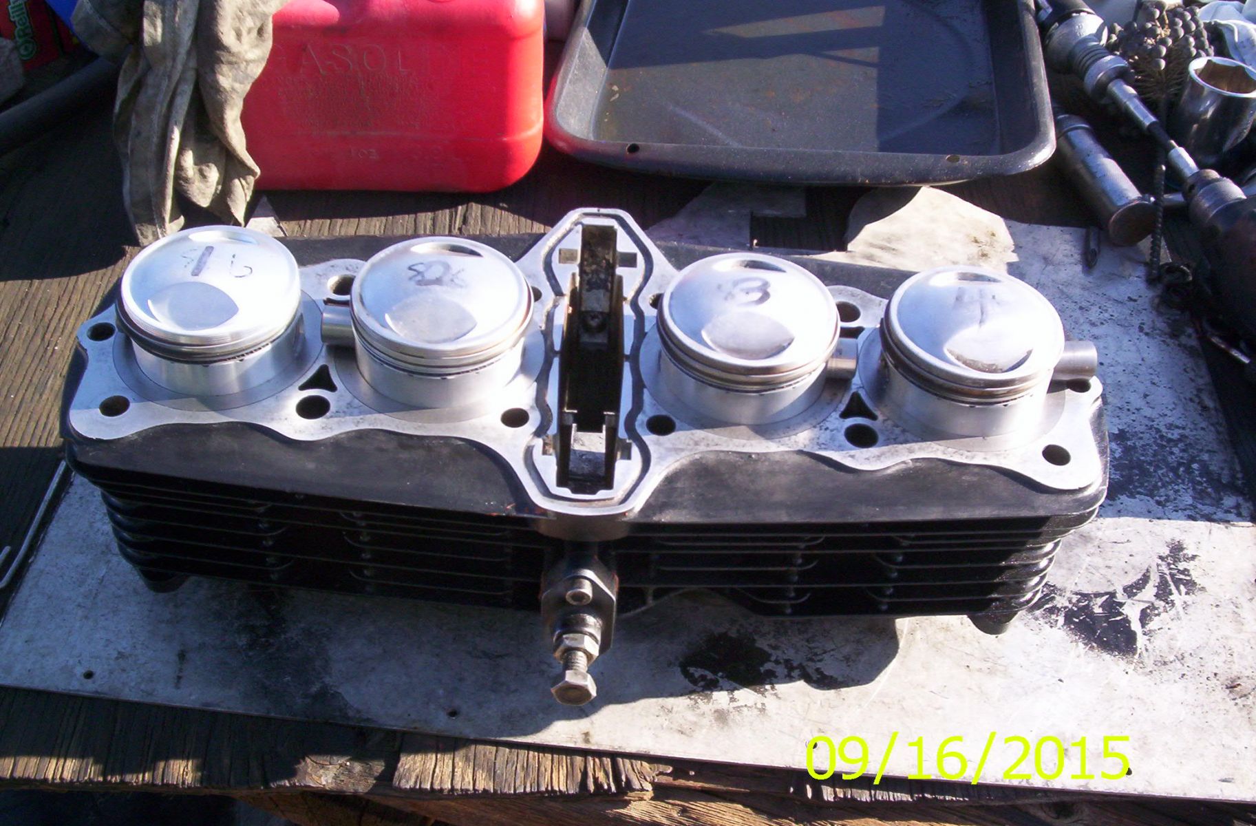

Those were the stock pistons for a KZ 1000. I just fitted the new rings to the bores. Didn't have to shave any of them. New piston clearance is .002 so I can hone more to get the marks out or at least most of them. Got some room to play with. These are Wiseco 10.25/1 pistons. Taking my time and they should be fine. :whistle:
I'm using Rotilla oil.
I didn't want to use the old rings that came with the stock pistons but had no choice. The oil on the pistons is after two years of running. The bike ran like a scalded cat even tho it did have low compression. I figure with the 2.5mm drop, I was running at 7/7.5/1 compression. With these new pistons, I should be at around 9/9.5. Good enough for now.

Got the bores looking pretty good. My stones were loaded up so I sanded them and kept going. Still a tight .002. The block and pistons were brand new. It had two chips out of the fins so I got them for $100 delivered. I'll do a little more when I'm fresh in the morning. I'm not getting the 45* cross hatch I'm looking for. I knew I should've picked up some course stones. My old bottle brush is useless.

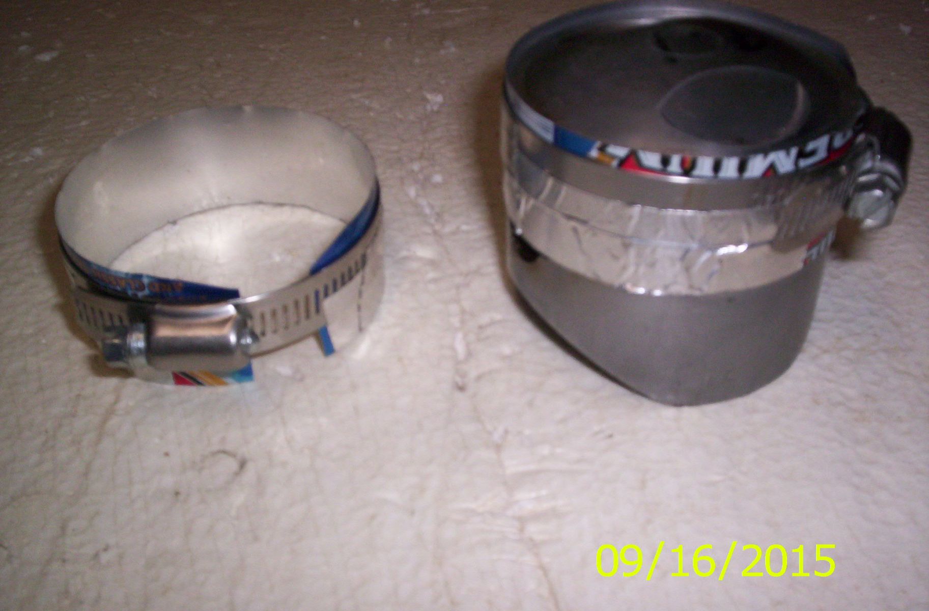

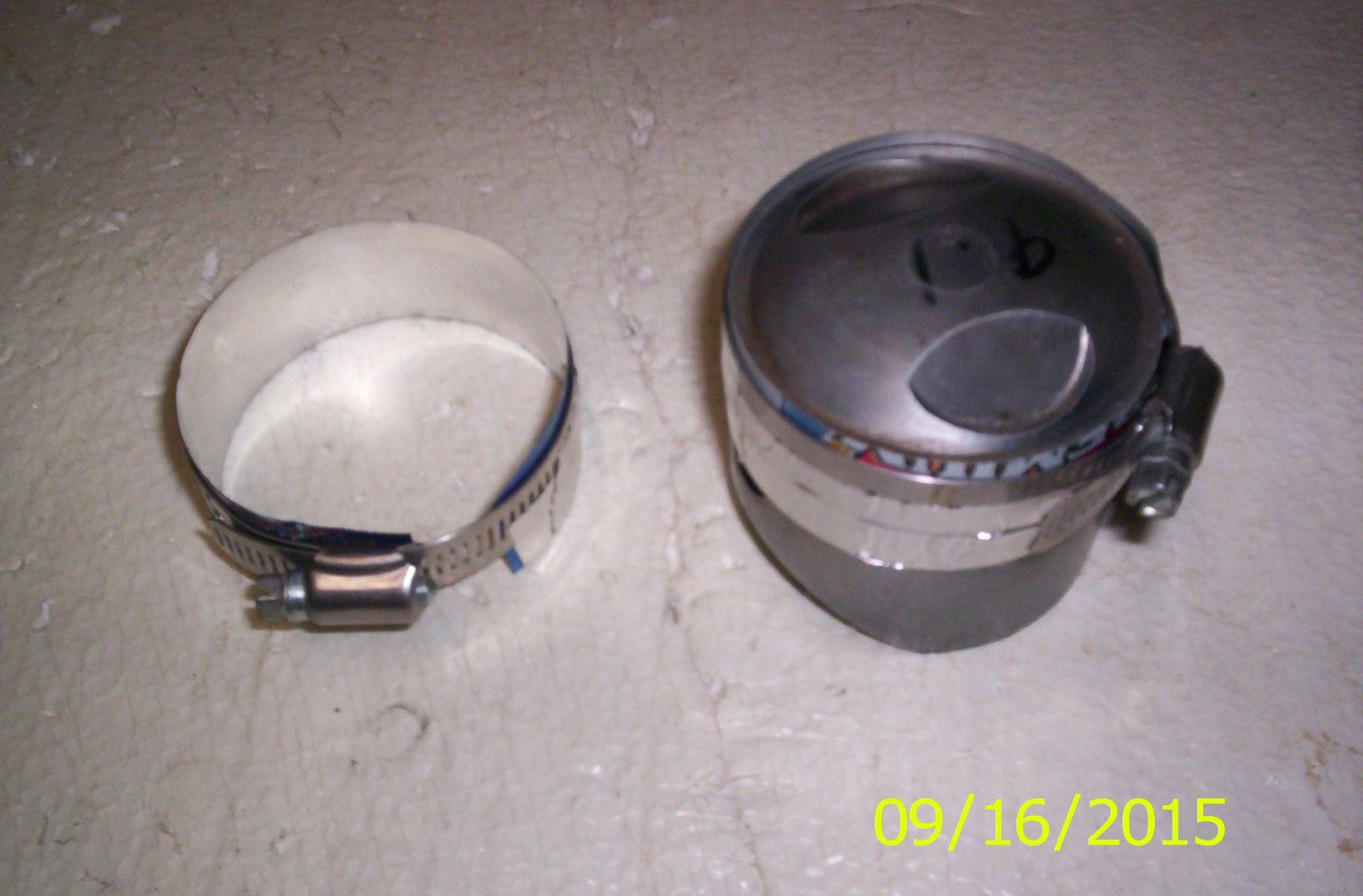

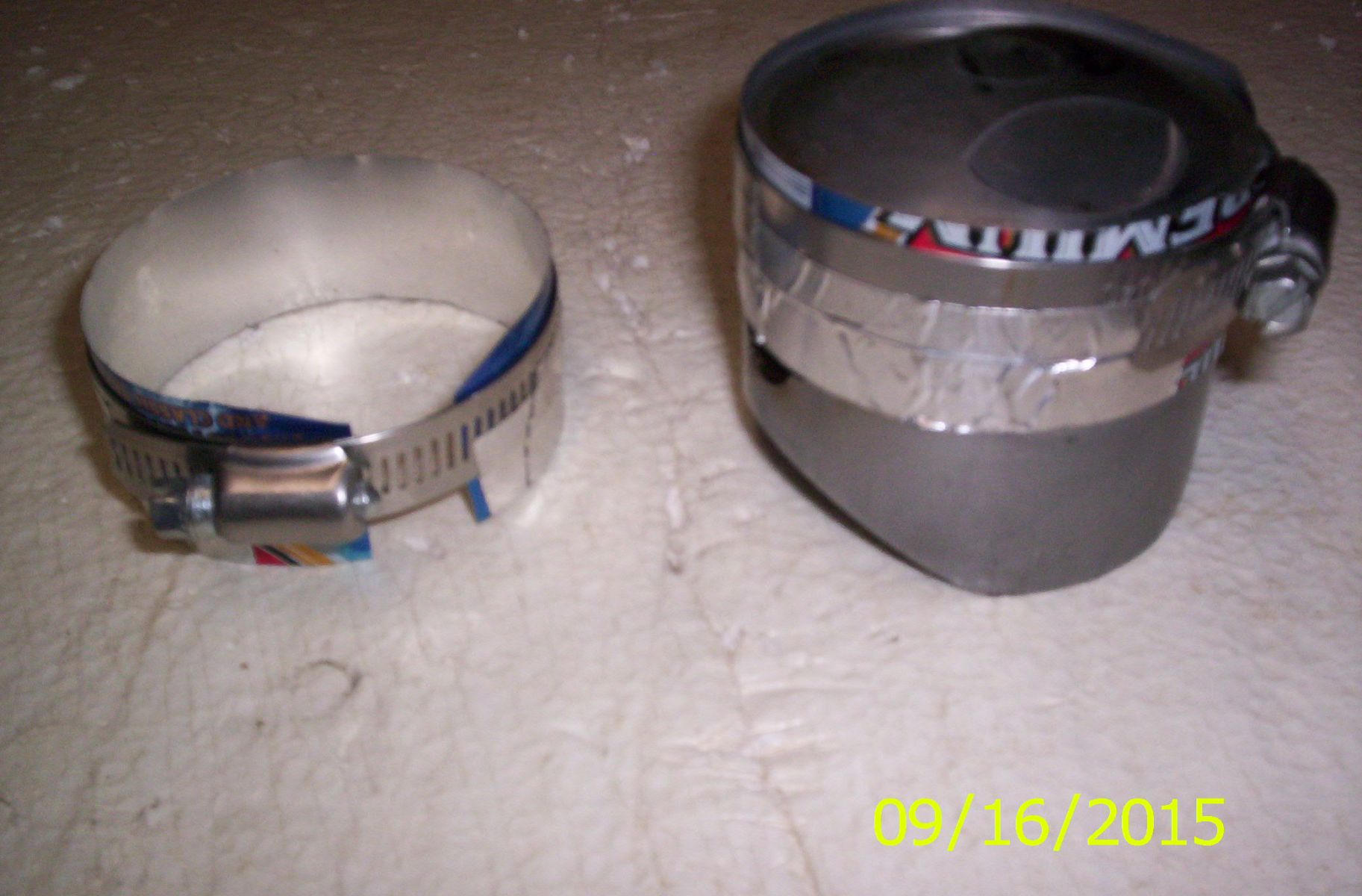

I'm making up some better ring compressors this evening.

Similar story here, I bought an unseen 'gpz550' motor that turned out to be a kz550 on the inside, but the lower compression pistons (9 instead of 10 to one) ran really nice..
Good squish and combustion chamber design is worth a point in compression ratio all day imo. I think flatter top pistons have some advantages in an old- school design.

Worked up some ring compressors. Used metal tape to keep them together. We'll see how well they work or not.

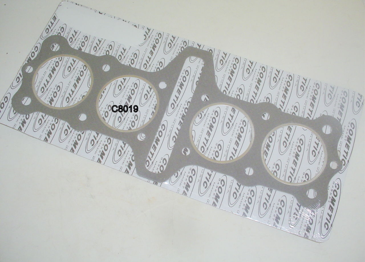

Have you ever had problems using that much RTV silicone?

I never use that much. Going one piece head gasket you have to fill the groove where the O ring sits. I will never use a two piece gasket with a O ring that WILL leak ever again. :whistle:
