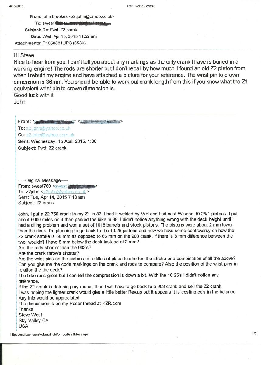

I just sent a e-mail to z2john@yahoo.co.uk. It came back. I'll try again using the web site too.
I asked about the crank, rods and wrist pin position. I invited he visit this site and provide any info he has. Maybe I typed it wrong and will keep trying.
In any event, it appears I detuned my motor by using this crank. If this is true, then I will have to get a 903 crank to get back to where I started. That just means there will be a Z2 crank for sale at some point. Meanwhile the bike runs like a scalded cat and if I get my new piston, it will even be better. Like I said, no hurry. :whistle:

Hmmm, he states the connecting rods are shorter on the Z2. I was expecting them to be longer. Not the first time I've been wrong.

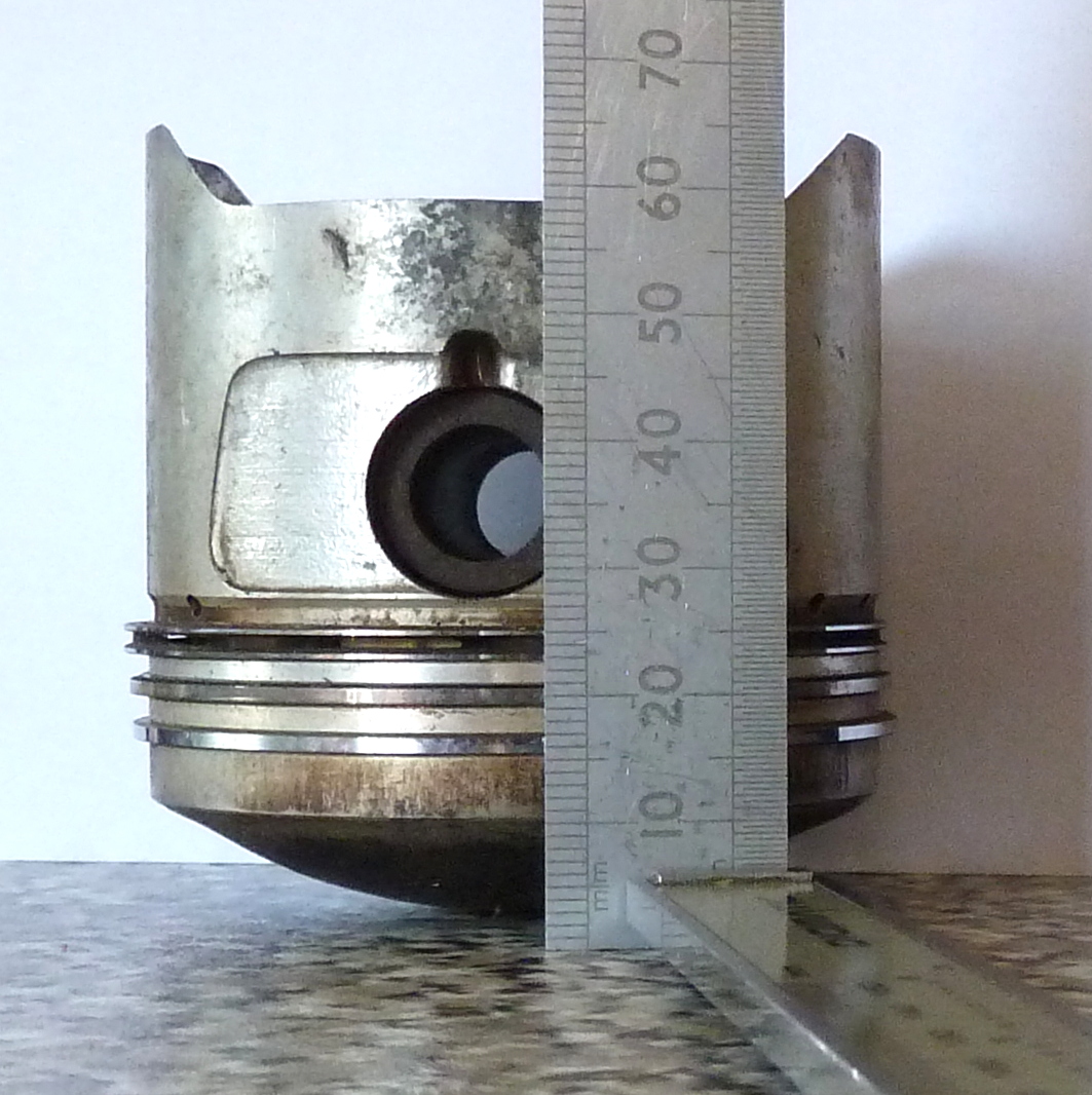

I was checking the sizes of the 903,1015 pistons cast and billet against the 750 piston. I just came up with more questions. I applied to the Z2 site, we'll see if I'm accepted. Maybe then I can get info from some of their members. I'll post pics of the pistons and my measurements with my caliper later today.

19 Apr 2015 18:09
No arguement. I have a 903 piston and two different Wiseco 10.25/1 70mm pistons. I've measured them and will put up the comparisons to the 750 soon. The blocks are the same. It appears The pistons and crank are different. I'm in no hurry.
