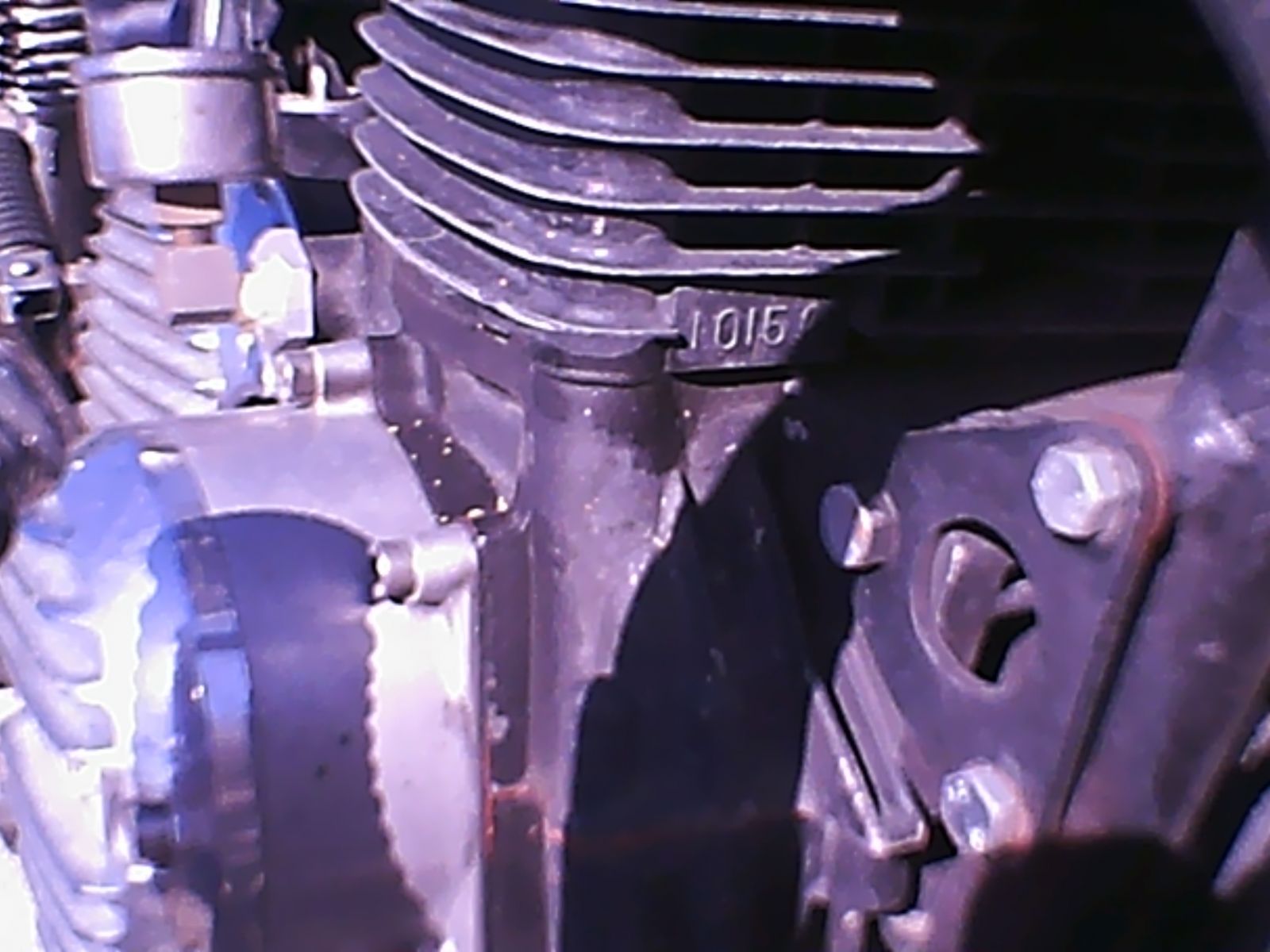

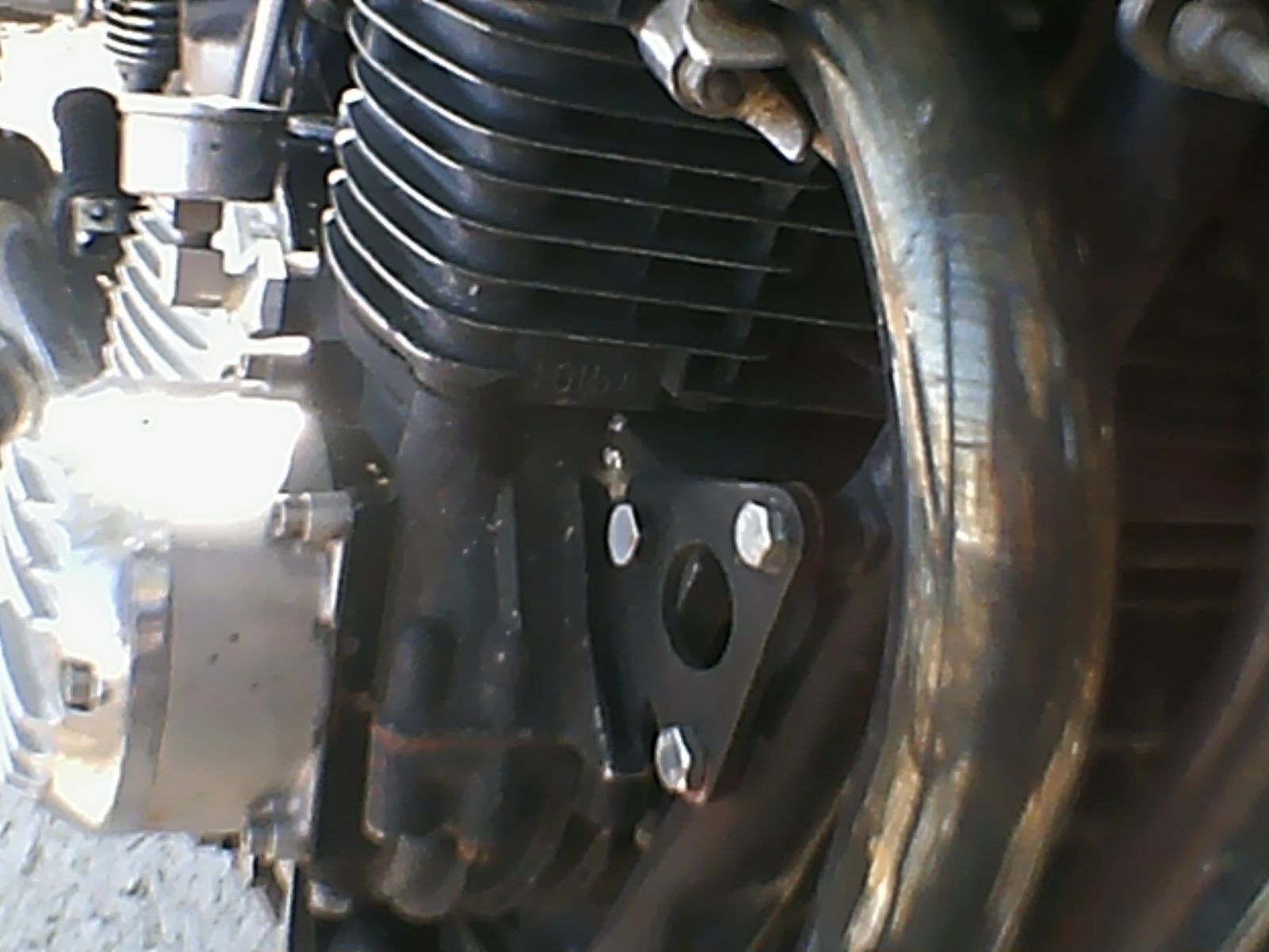

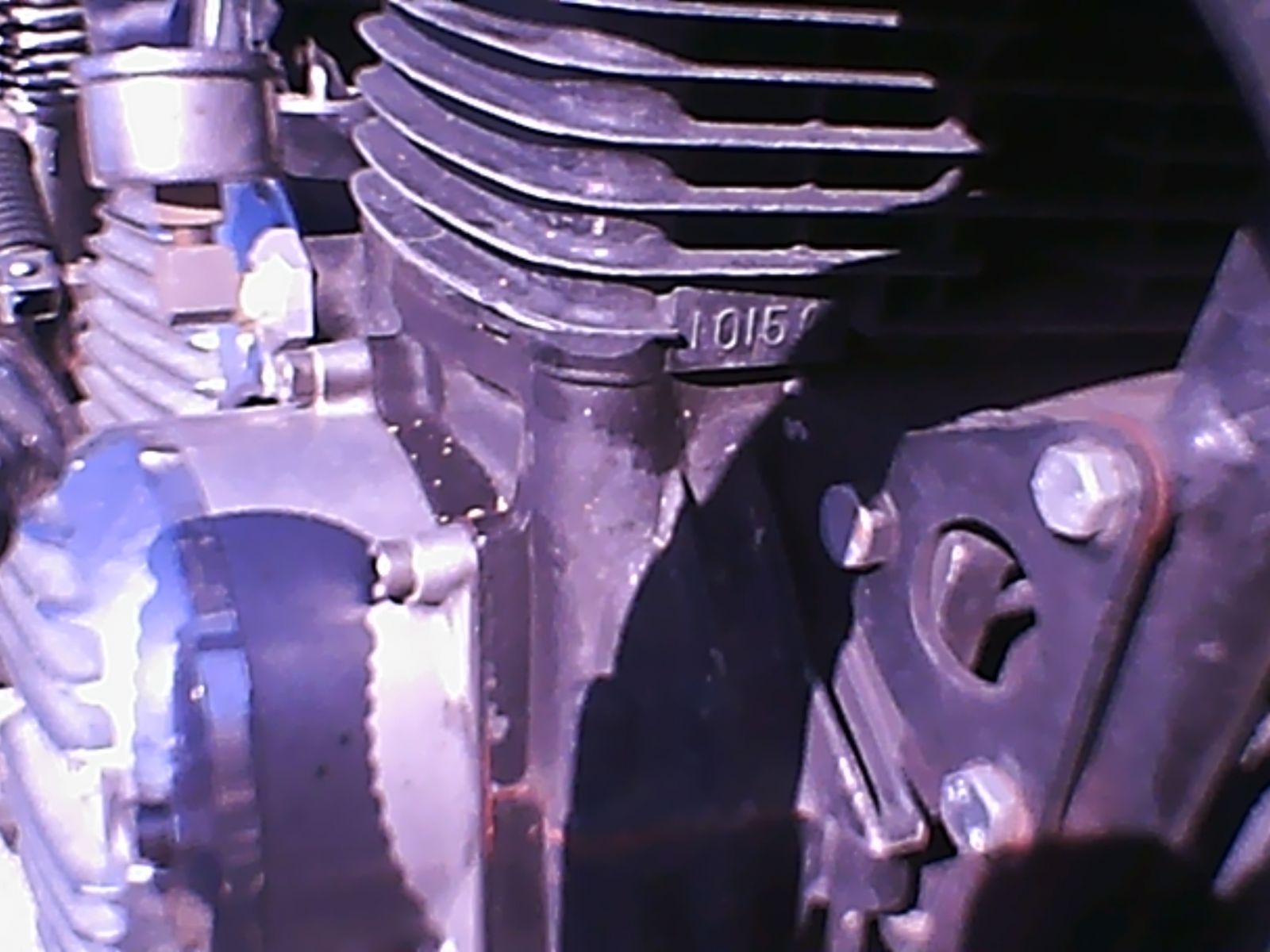

My camera is a battery hog. I tried to take some pics of the blocks with my bike cam.
Attachment not found
- Posts: 23771
- Thanks: 3038
Re: Z2 750 crank (Bossie the Kaw)
12 Apr 2015 15:30 - 12 Apr 2015 16:08
The one on the bike says 1015. I'm charging the cam. I'll get another on in the sun in a few minutes.

Thanks for the offer. I have a set of stock 1015's in the bike now. I will buy another 10.25/1 piston as I said in time. I'm in no hurry.
