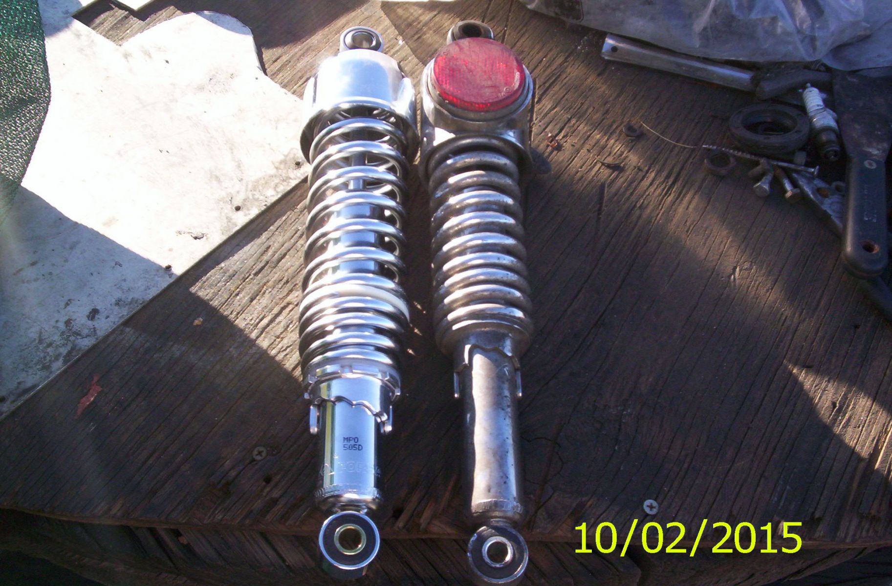

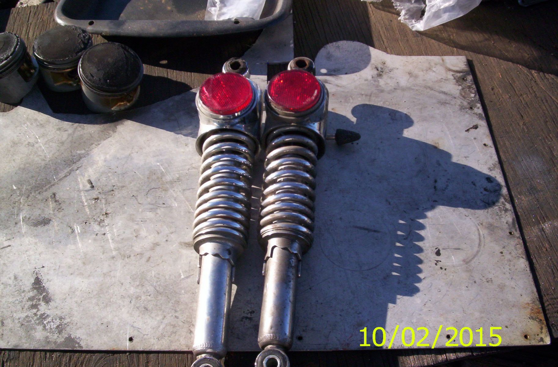

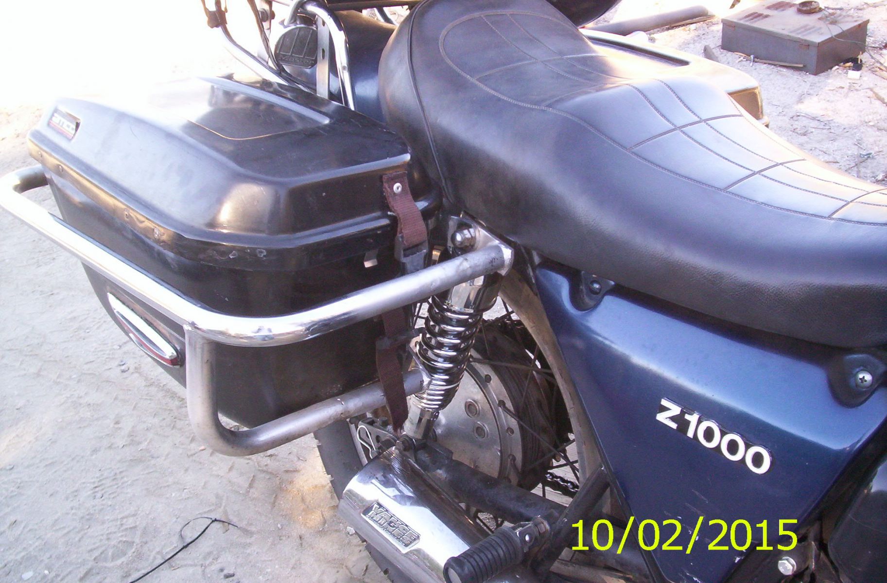

No eBay APP ID and/or Cert ID defined in Kunena configurationPut the new shocks on. I didn't set the preload to see how they did. They're 3/8" shorter than the stock ones but when I sat on the bike, it didn't crouch like with the other ones. I'm dressing out at around 230/40 so the stock style shocks were dealing with the weight. There's a sharp high speed turn with a rough spot in the middle and when I'd go through it, the bike would heave a little. With these shocks, it held firm all the way through. Two stage progressive rate springs and the shock is bigger. I think I'll clean the old ones up and list them for $50. If I don't sell them, maybe I'll switch the cool looking red reflector covers to the new shocks. It would be a shame to destroy them just for that.
They're two years old and don't leak. We'll see. :dry:
The Tach/Speedo should come today and a new cable. 16 tooth sprocket too. I also should have my new stater come with the Tach/Speedo, so I will change both of them at one time. :woohoo: Been waiting a long time for this.
