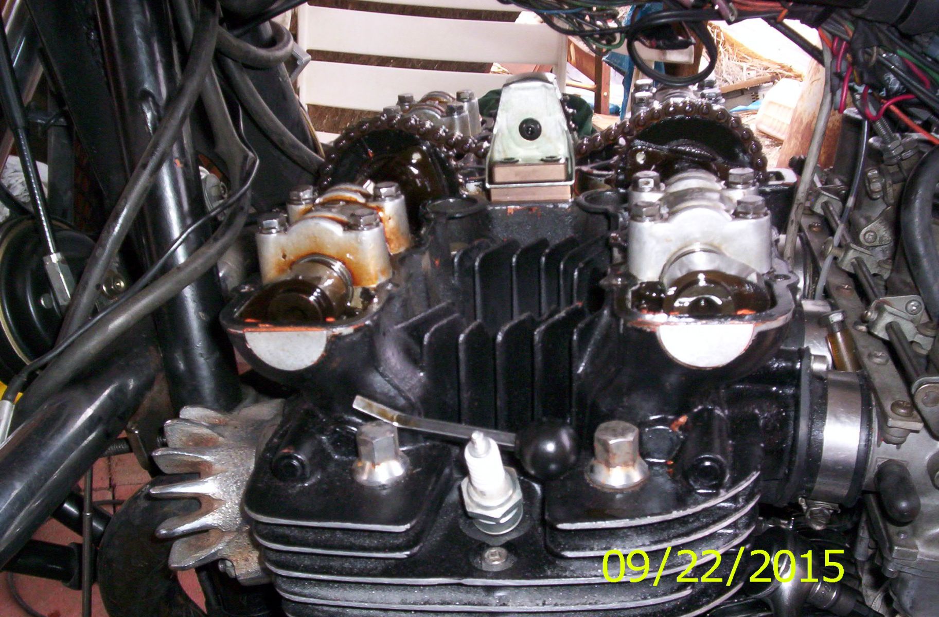

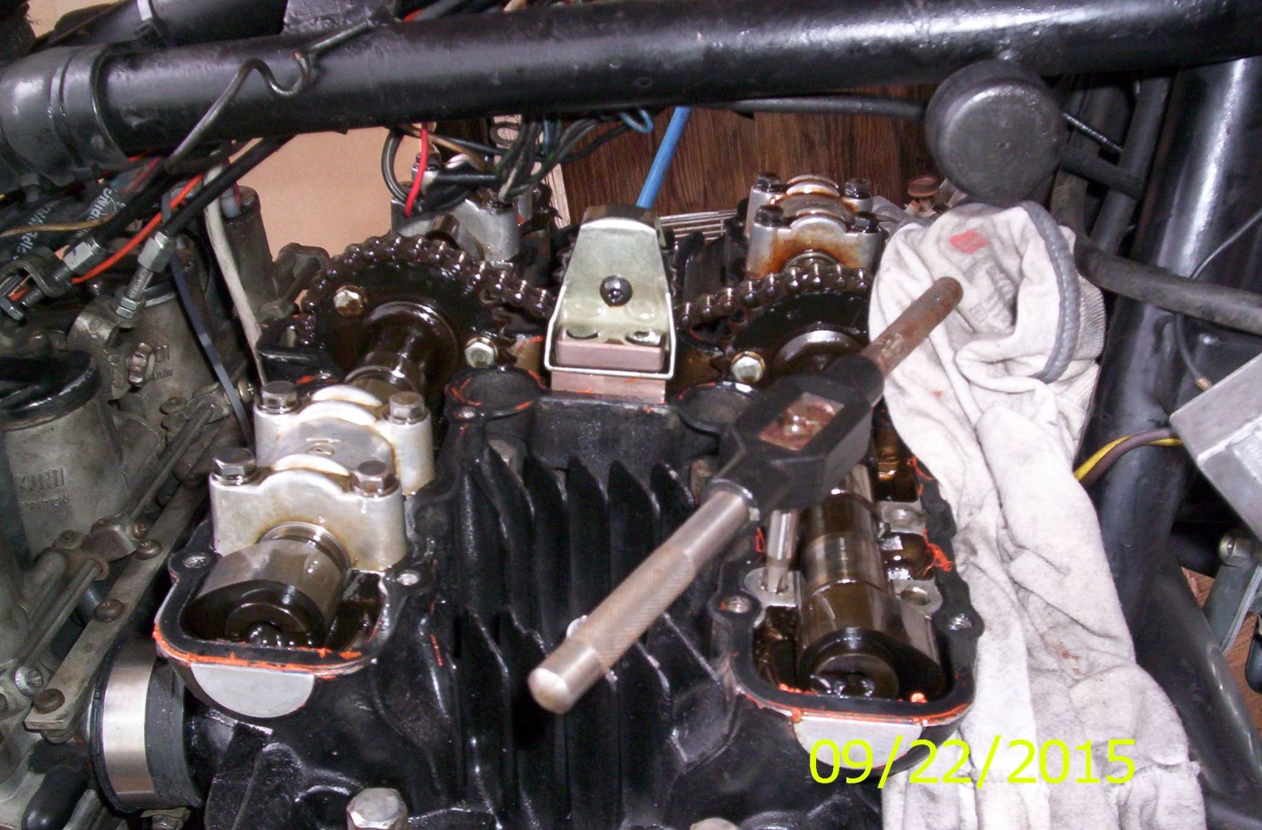

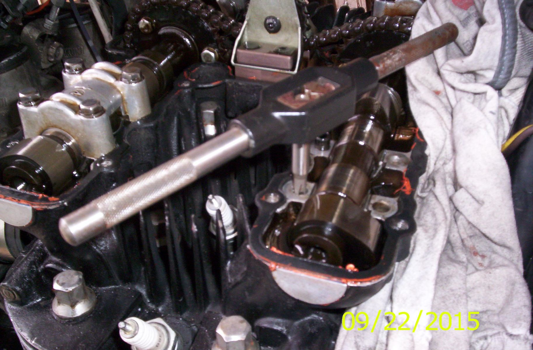

I decided to do my valve adjustments again. When I put it together the other day I noticed one cam tower bolt was stripping out so I put in a Heli Coil at the same time. Two valves were too loose and I went down one size. They are all in the .003-4 range.
I tried to do a compression test last night. The gauge doesn't work for SHT. It was left in a tool box in the rain by my son years ago. I have another gauge I will try to adapt to the fitting. From what I could tell, I'm in the 120 range. Can't hold my thumb over it so it's runable but not where it should be.

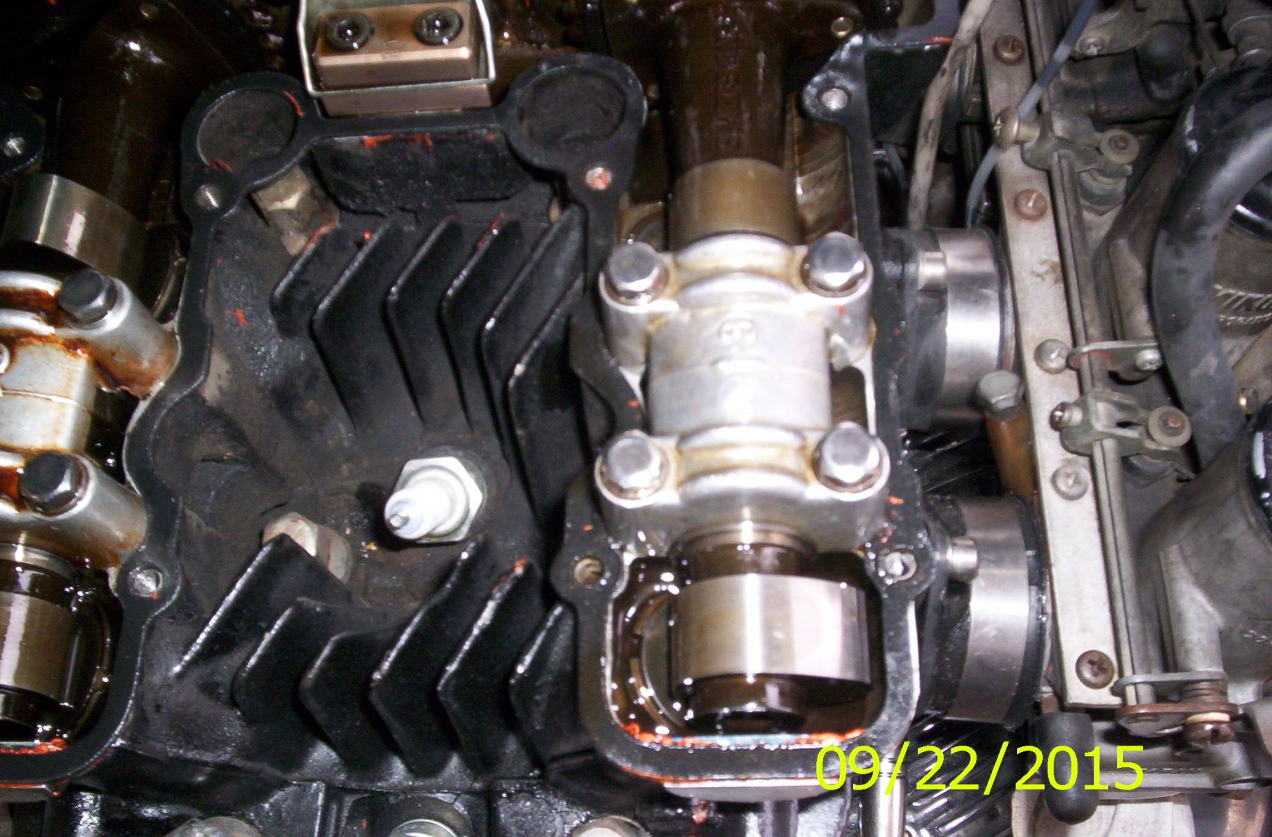

This isn't a very good pic but you can see a ring on the cam caused by too large a clearence. It was slapping the bucket. You can hear it when it's happening.
I corrected it the other day so the mark is wearing away.
