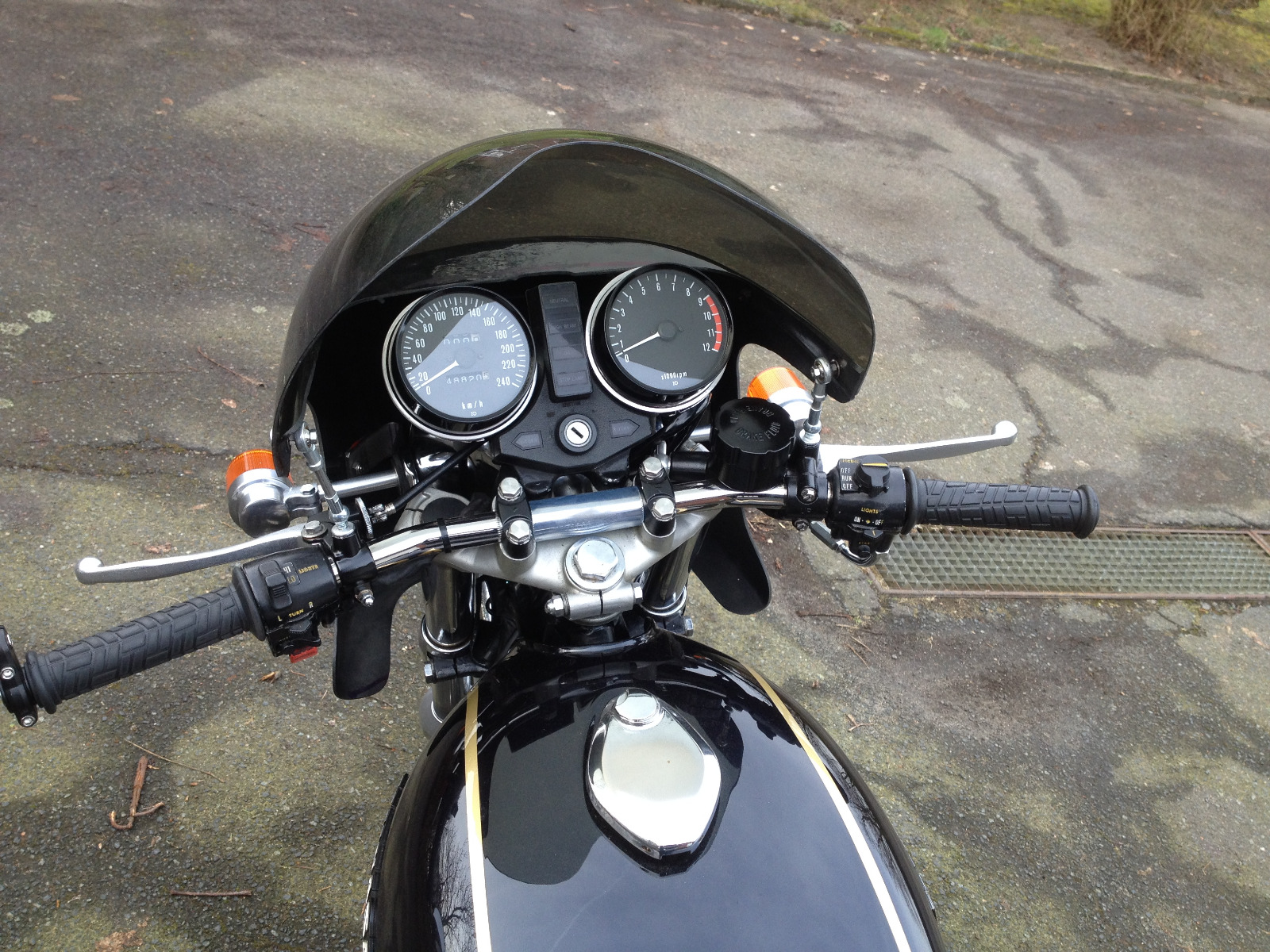

On my bike it wouldn't cross the instruments either, but due to the narrow handlebars, definitely with the master cylinder..
But you gave me an idea: I'll equip the rods with ball joints at both ends, then I'll be flexible in the angles and length!
I must just made another 2 adapters from M10 x 1,25 with an M5 inside, and than i will made the rods from stainless 5mm diameter, with 1 ankle-ball-joint, and 1 axial-ball-joint,..full adjustable, and that it was, ( i think

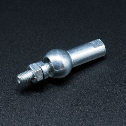

Straight uniball joint, with inner thread for upper, and axial-joint for lower end.. Just ordered, and next week or so, i will take the bike out of the back of my garage, to be able for work on it with more space around..

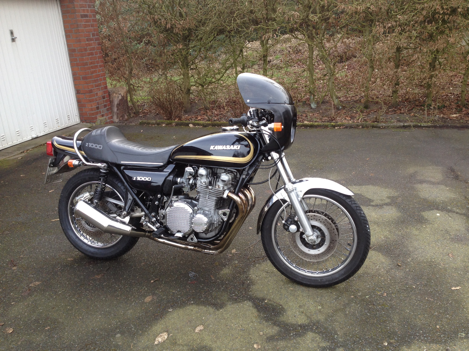

Got the "Black Lady " out today, for some little more adjustments on the fairing, tomorrow i will turn the upper adjustment-studs on my lathe, and then i can fix it finally,..but now we can see, how it will be when it´s finished...And then, beginning on 1st of march, it´s again allowed for me, to hit the road with this bike

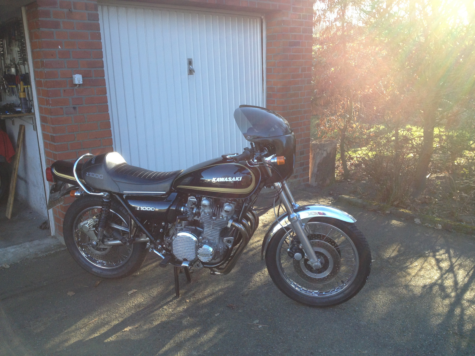

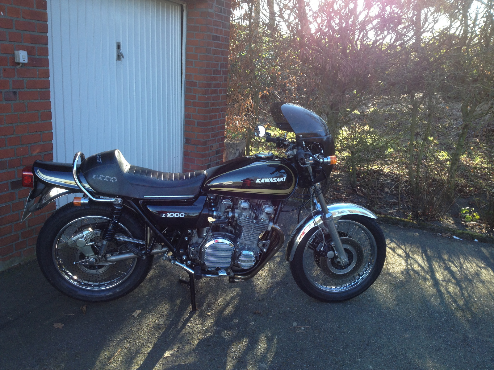

So i´ve done the rest of the work for the upper mounting on fairing,....fixed well,...and done some little doings on the bike, like departing the centerstand, ( i have it only for off-season, or wheels change-jobs), and re-installed the exhaust,...SO,... it is ready now for the next bike-season, starting 1st. of march,..Yeeehaaarrr !

A superb solution to use the mirror mounts to secure the faring.
