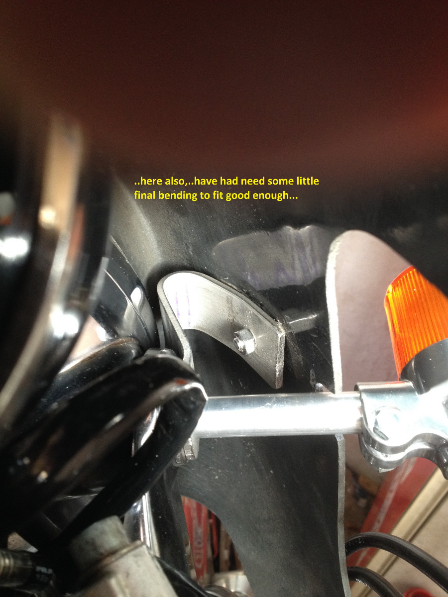

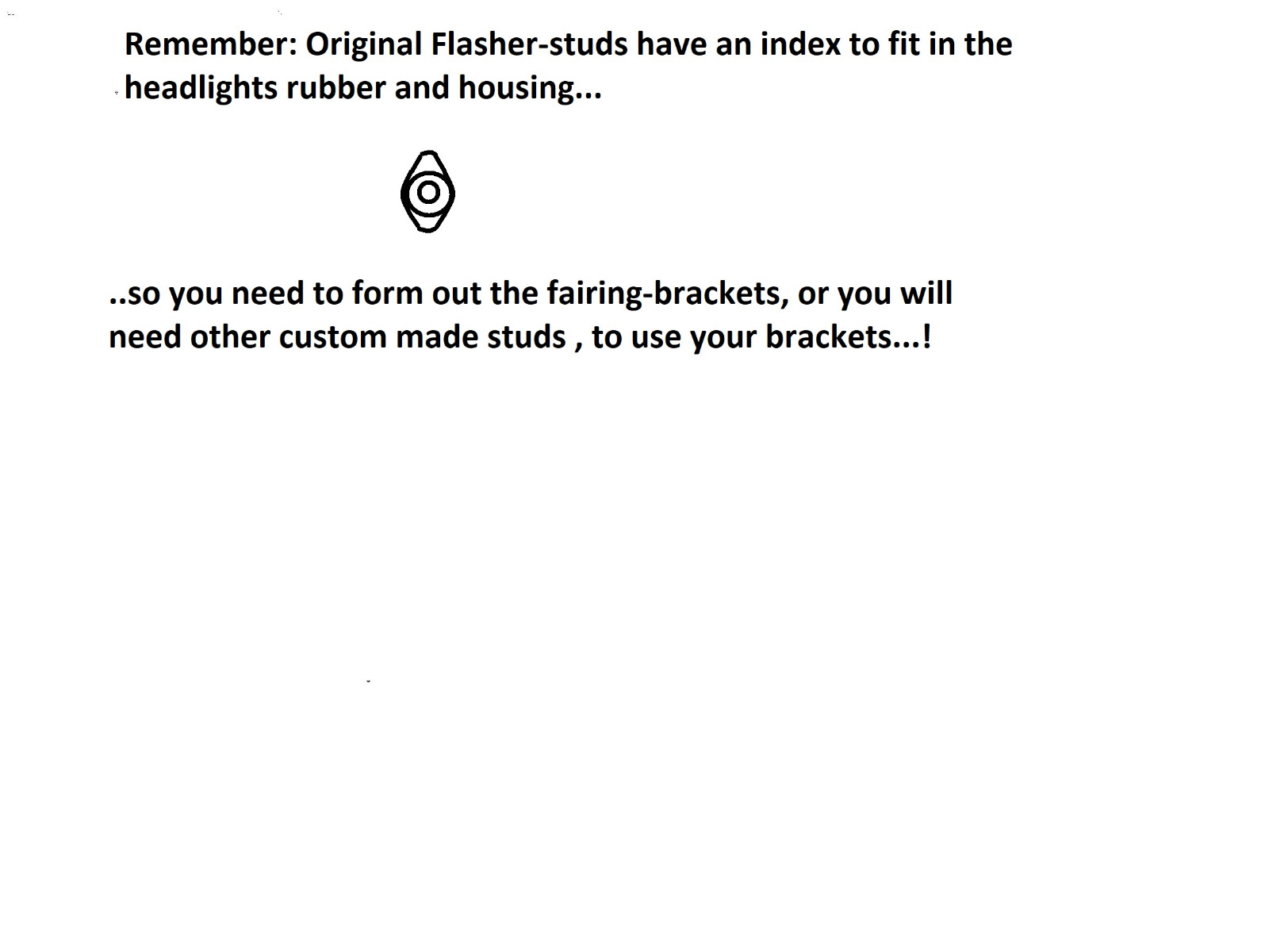

Very, very nice bike ya have, Rolf!!!
and, by the way.
If you want to have the blinkers / flasher at the same position as original, you ´ve better some ideas to solve it!
I had to cut out a little on both side of the fairing, to fit around the flascher studs,...and i use the "only-round made myself studs", with M10 threads throught the headlight / holders and brackets...
But you can use only screws, and positioning your flashers on an other point ,..maybe on the fork, or frame, handlebar...whatever...Just to think about

Okay thanks Joe ! thanks for good tips i will try to figure out something

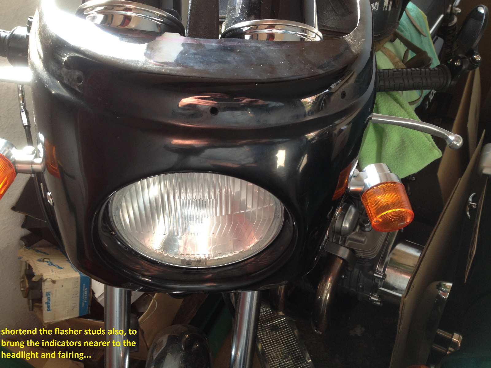

And maybe, think about other indicators on front in play with the fairing:
/ To my opinion, these big original Blinkers looks pretty well on an original bike,..but on some customized bikes, like in the neighbourhood of a fairing, they look to big and displaced.....
( You know, opinions are like a***holes, everybody have on, and not everybody want´s to hear them, or smell a fart from it
Whenever i planned a special custom option, i take a picture of my bike, and after that than on PC, i cut out, or draw, or move some part and items, to image, how would look it , or can it be...
Just ideas....You will find the right decision !

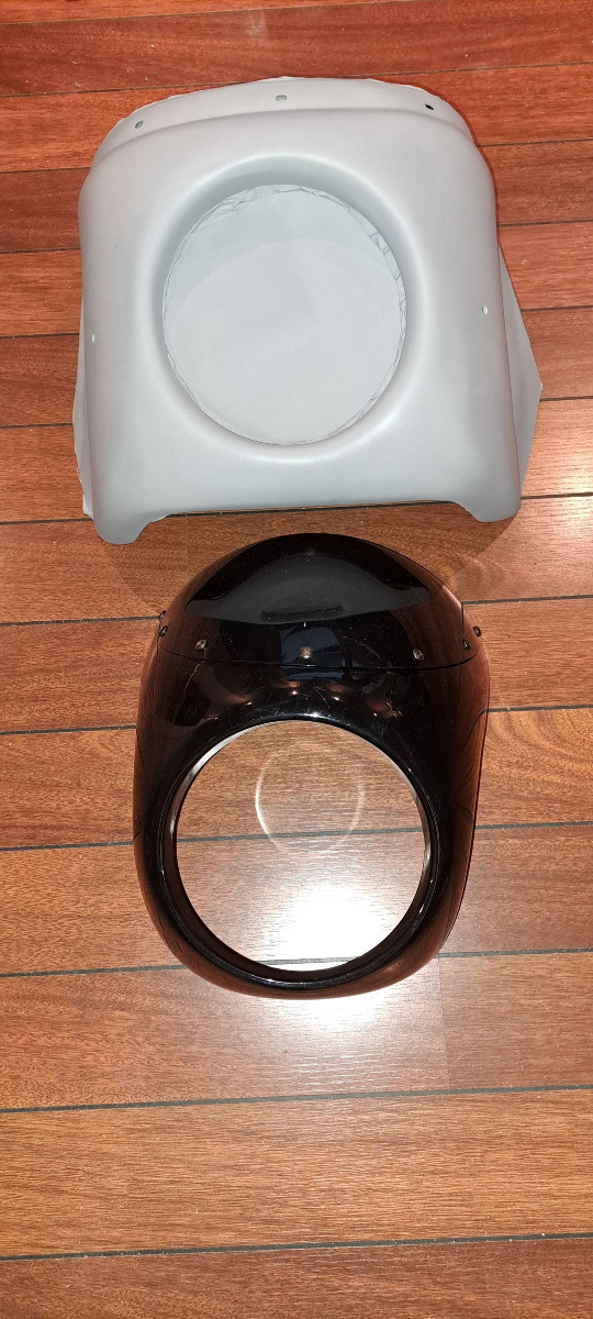

Haha here in Norway we say the taste is like the ass its split in 2. I think i have a set of led blinkers i could use ,but i like the look of the kz1000 i posted on page 1 and that is why i bought the fairing and a guliari seat.so i will try to make it like that bike. I also recent got another cowling for 10 USD ! it is smaller and also the diameter on the headlight hole is smaller maybe i will fit that,but that will not give much protection from 2 pound norwegian mosxitos flying around.

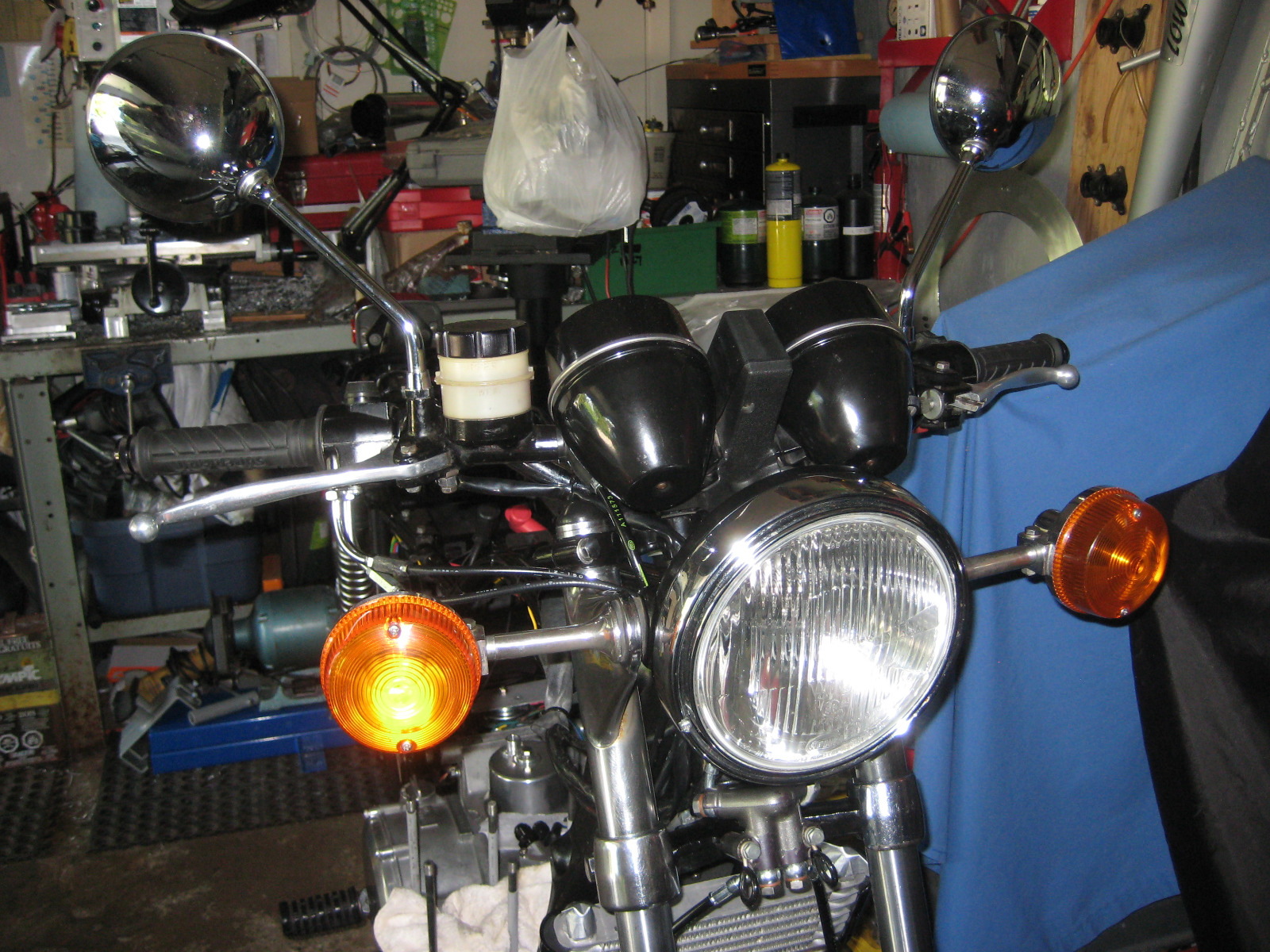

07 Feb 2025 12:01I have some indicator stalks off a '74 Z1 on my KZ650, they are shorter than those used on the stock 650. The bulb ends are the same size/design as the 650. Those stalks are 75mm long, the C-C on the bulbs is 18" and the overall width about 22".MFP-Joe post=908707 userid=24810
i dunno about the original lengths of the Kawasaki indicator studs, but remember, the original Kawa-flashers have a big diameter, maybe, you will need longer studs..best way to know about, is to hold the fairing in front of your headlight, than you will see, how many space ya will have between both sides...
I´ve made my blinker studs from Ø 15 mm aluminum, reduced the diameter to 13,98mm to match the Honda blinkers,..the first ones (without the fairing), haven´t been to short with their 50mm outside, now they are 90mm long ( from headlight mounting point), and that a little to long, i think, i will short them about 20 mm each. for a better look.
I used these indicators because they had "good" chrome on them and they were slightly shorter than the rusty longer ones the bike came to me with. They also have a nice radius on the end that mounts to the headlamp ears
This is not the bike I am putting the Viper on, its just another example of stock parts from another model.

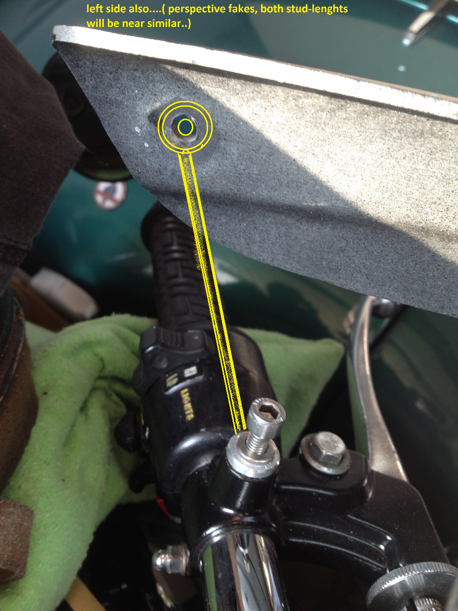

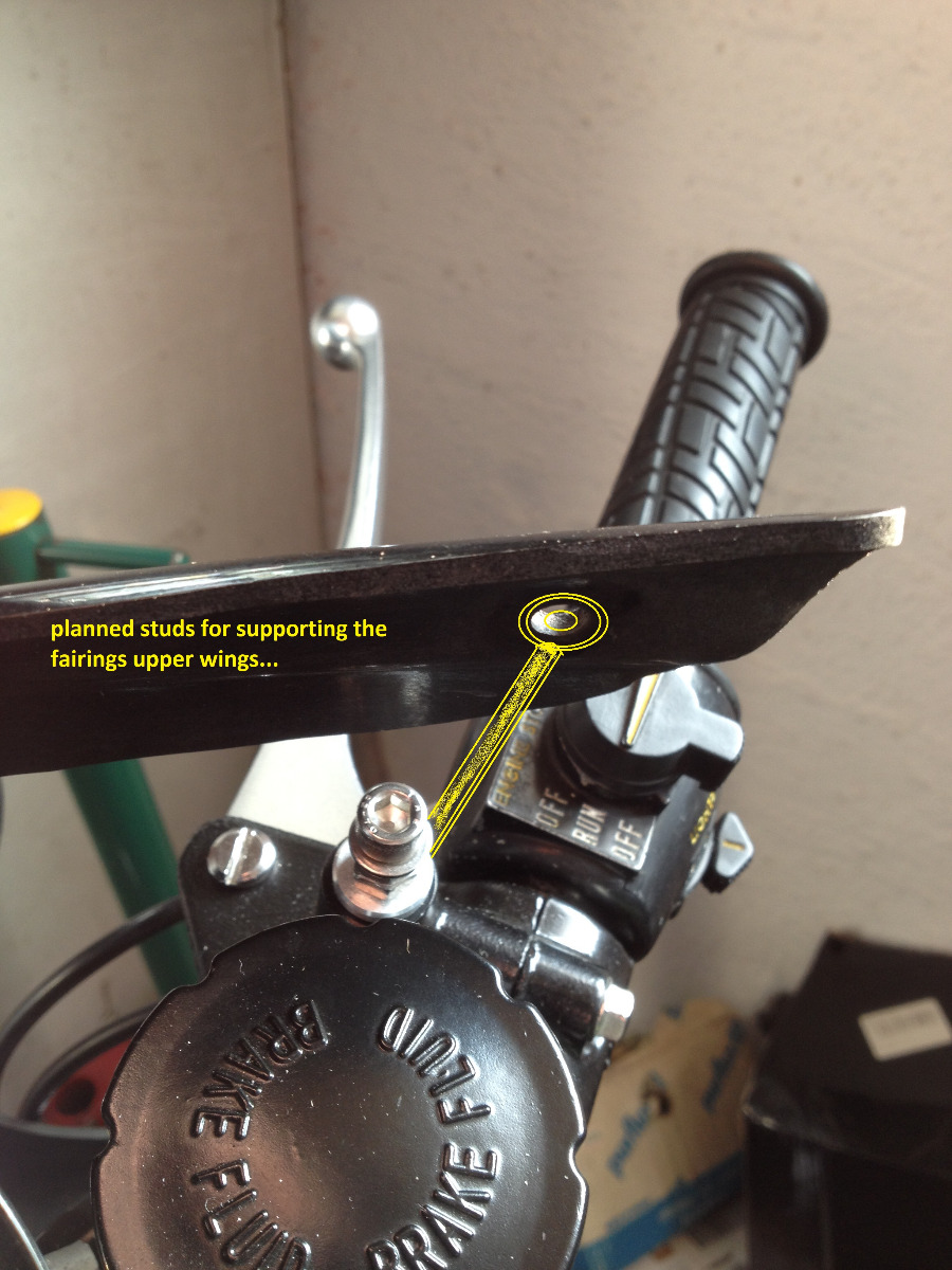

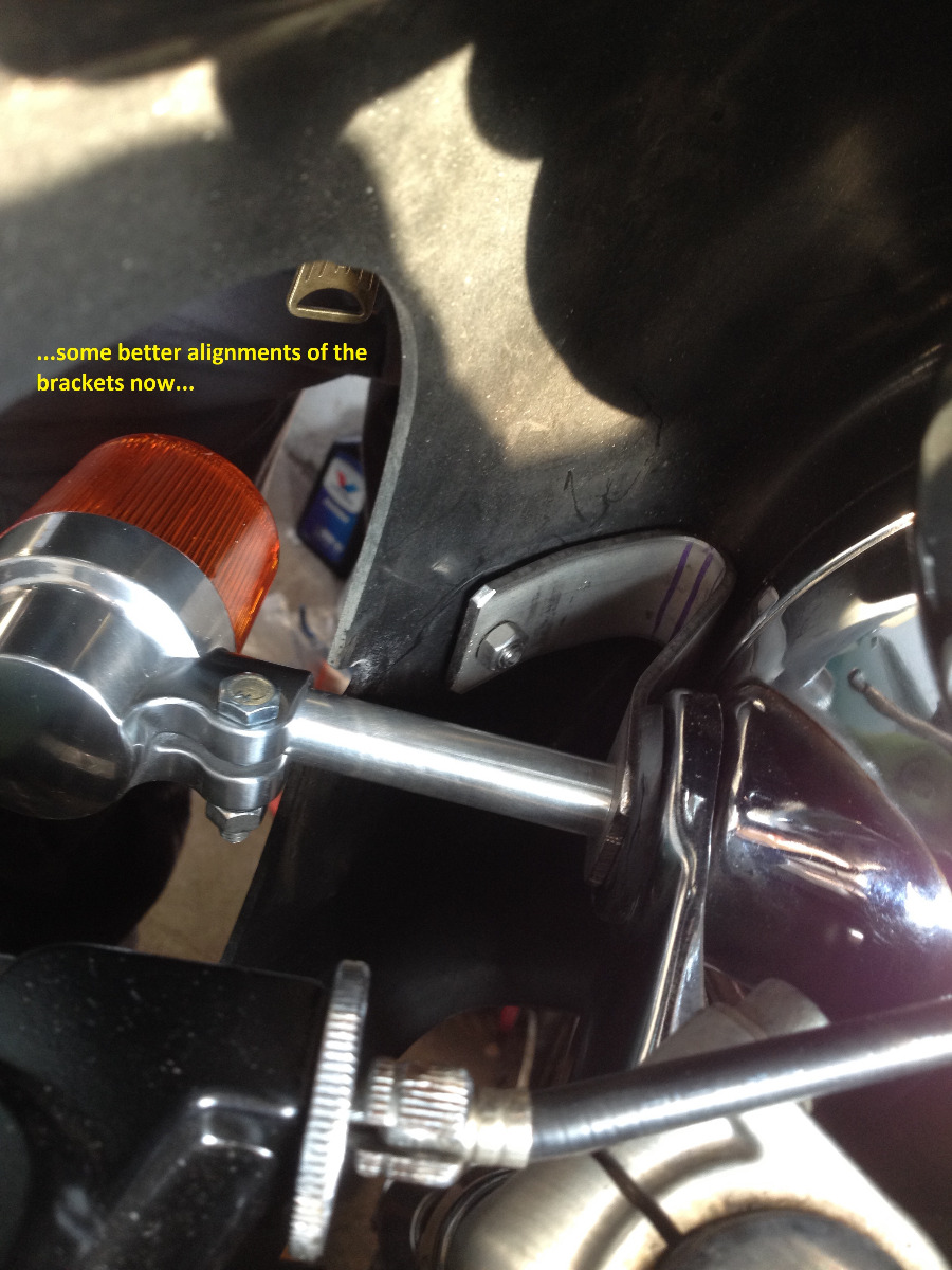

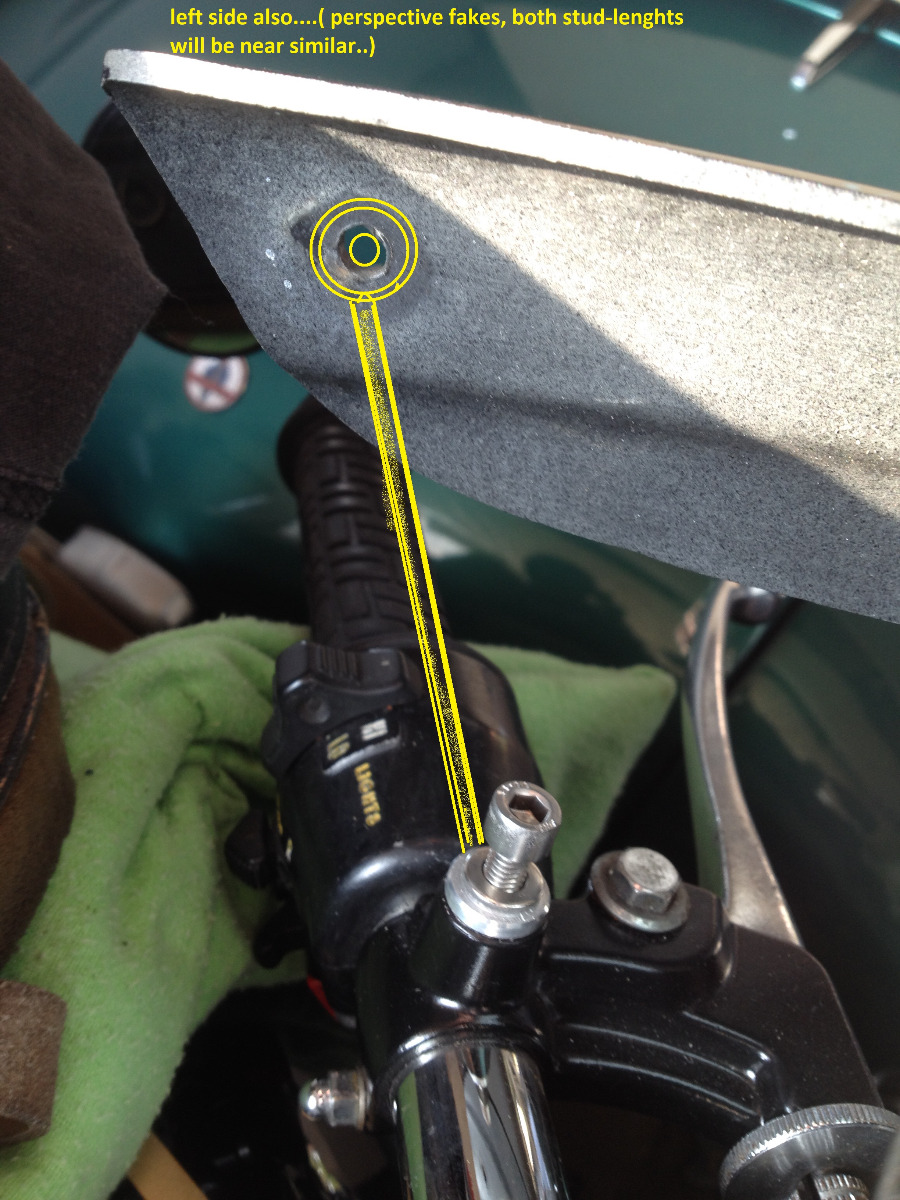

Today´s sunny, but about 0°C, also in the garages,..but i´ve done some little corrections on fairing alignment, by bending the brackets a little more , shorten the indicator studs, and measure out what i will need for the upper supporting studs,...now it´s close enough for me with the fitment about, i can live withit
...unsure about paint job, but it´s to close to season opening, and my painter needs alway a lot of time to fix it, but no prob, it´s black, like the bikes body-parts...

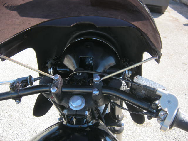

I´ve seen this kind of a solution also somewhere, but for me it was no option, at first don´t like the crossing in my view to the instruments, and maybe, the rods come in diagonal contact with the speedo / tach ???
But anyway: Many different roads will reach Rome...Sometimes it will give only one solution, depends on the bike oder custom made style,..or personal taste.

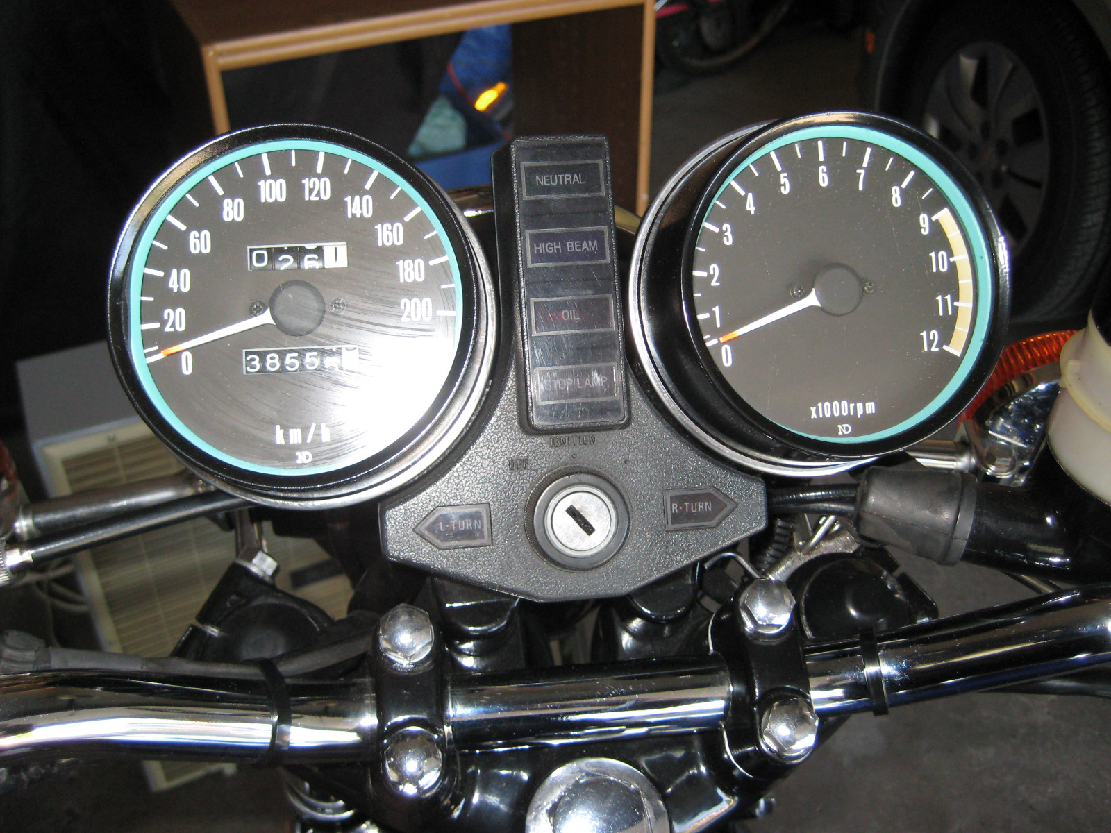

I am no where near close to mounting my Viper fairing on the project bike it is slated for.
Here is a picture of the gauges on my bike (KZ650) the same gauges that are on KZ900. You can see here those "cross" rod would probably clear the gauges but foul on the master cylinder (Daytona touring bar) There may also be a opportunity to mount on the top bolt of the upper triple clamp as previously mentioned.
The only slight issue I see on mounting at the mirror perches is if you need to adjust them.
Personally I keep those clamps a bit on the loose side in case there is ever a tip over (learned that trick working on mountain bikes)
