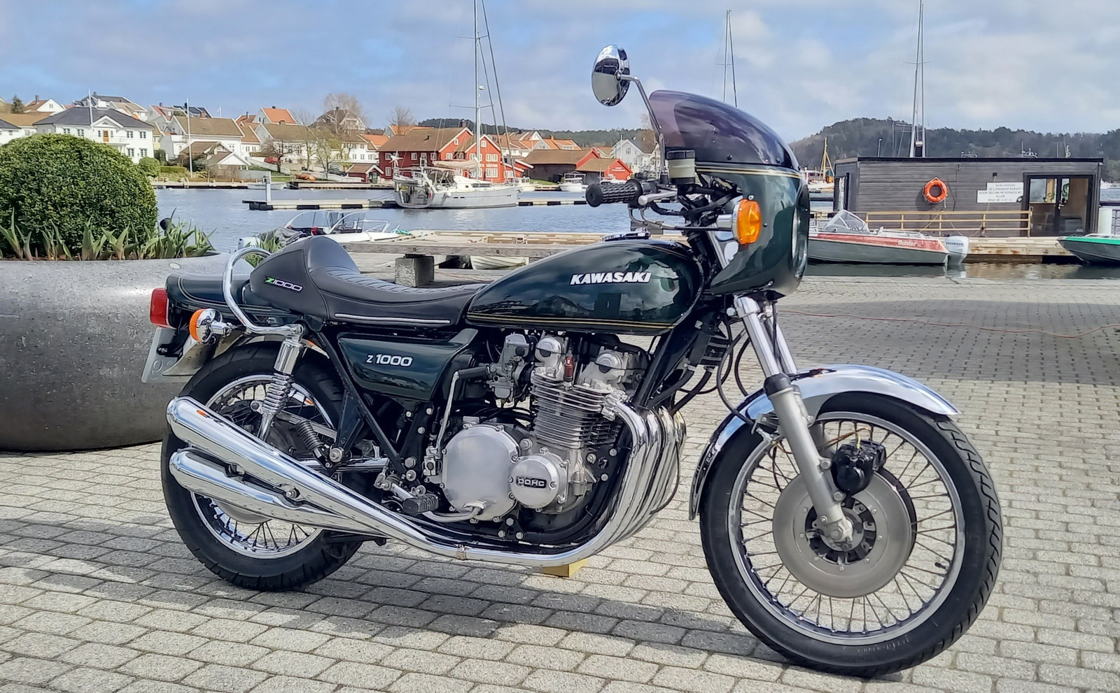

HA !!!....got this viper fairing today, bought it second hand + used from a fine guy who have send it to me, i will it mount on my A2 next weeks,...like this "Stone-Bike-Style" with bikini-fairings on a "Z"...
have had an little similar BMW R90S -Cockpit-fairing for about 10 years on my Z1B...
I will show the result here, when it´s ready mounted.

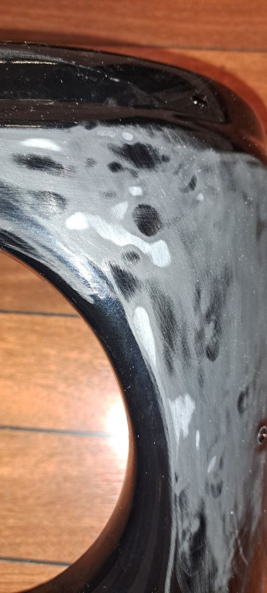

im also a fan i bought one from a dealer here in Norway after i found pictures of a bike for sale here i Norway that looks real nice.I post a pick of that bike here . i have also bough a gulliari seat ,but will have to replace the seatcover.

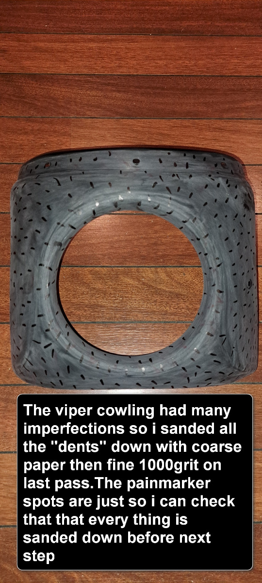

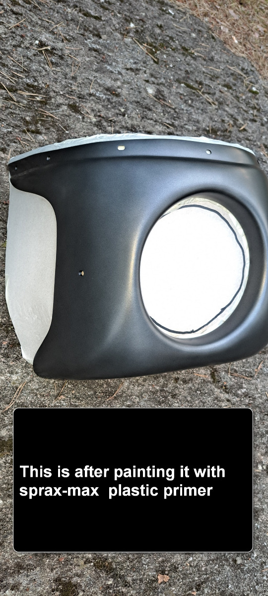

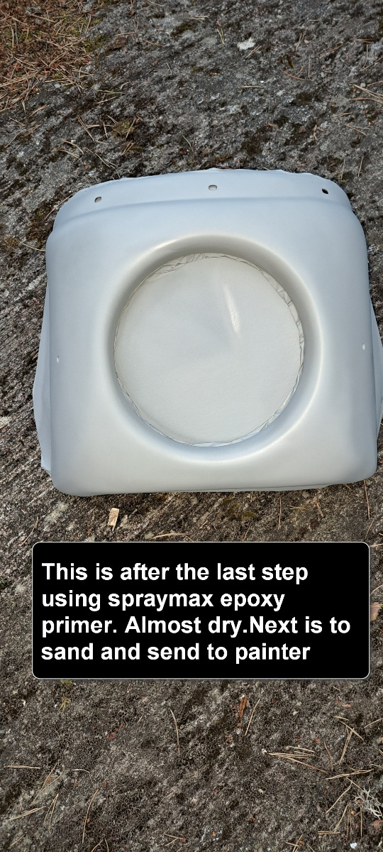

The viper cowling i recieved was not top quality it had lots of dents in the gelcoat/plastic so i had to do some work on it.Also the screen was hased on one side so i will try to polish that clear again.I first sanded the plastic with coarse paper and a sandingblock then used finer and finer grit paper. Then primed it with plastic primer and then grey primer for plastic. The plan was to paint it the kz900 diamond green myself ,but after a lot of testing mixing paints i can not match the paint so is going to send it to a painter that has painted many kawas kz900 in diamond green

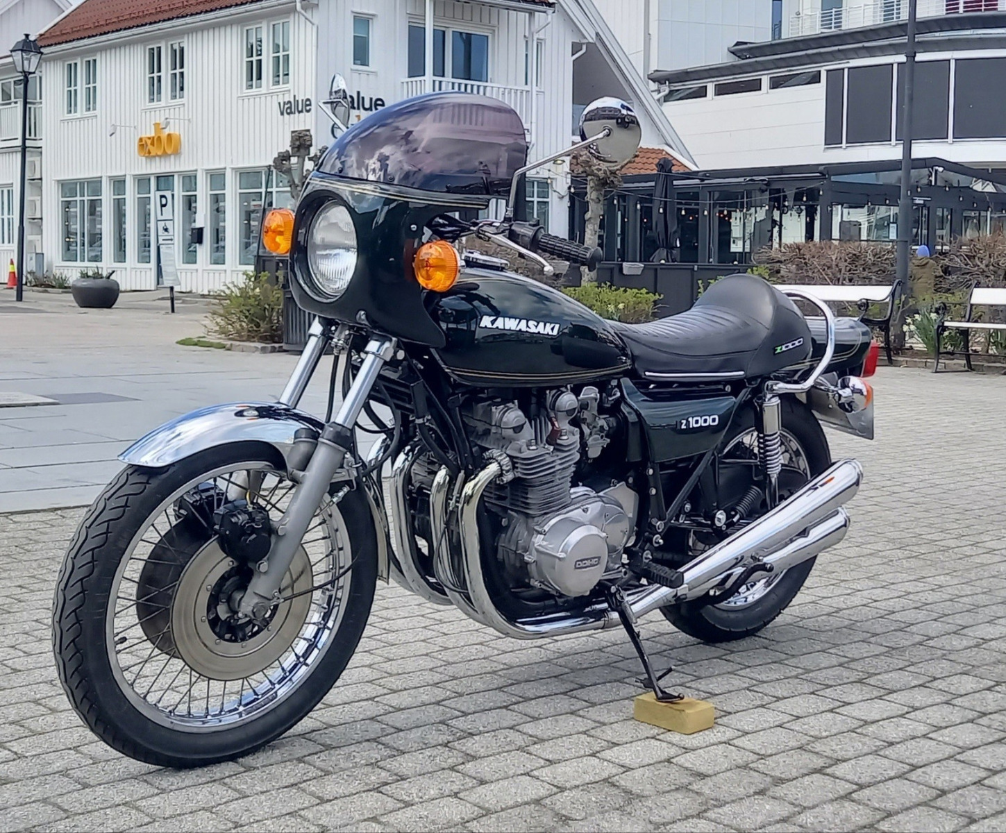

The plan is to make the bike look like the one in the last picture ,but will have to buy a lower handlebar too i think.
This mod is easy and fast to restore back to original look too

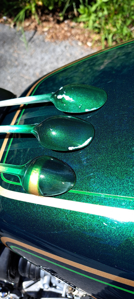

good job you`ve done on your fairing,..and of course, very nice paint on your tank and spoons !!!

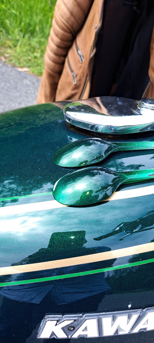

The plastic spoons in the picture is from when trying to mix paint to match the original paint on the gastank. I mixed 3 different colors from spraycans ,but it does not look like same color so i will send it to a professional painter.
