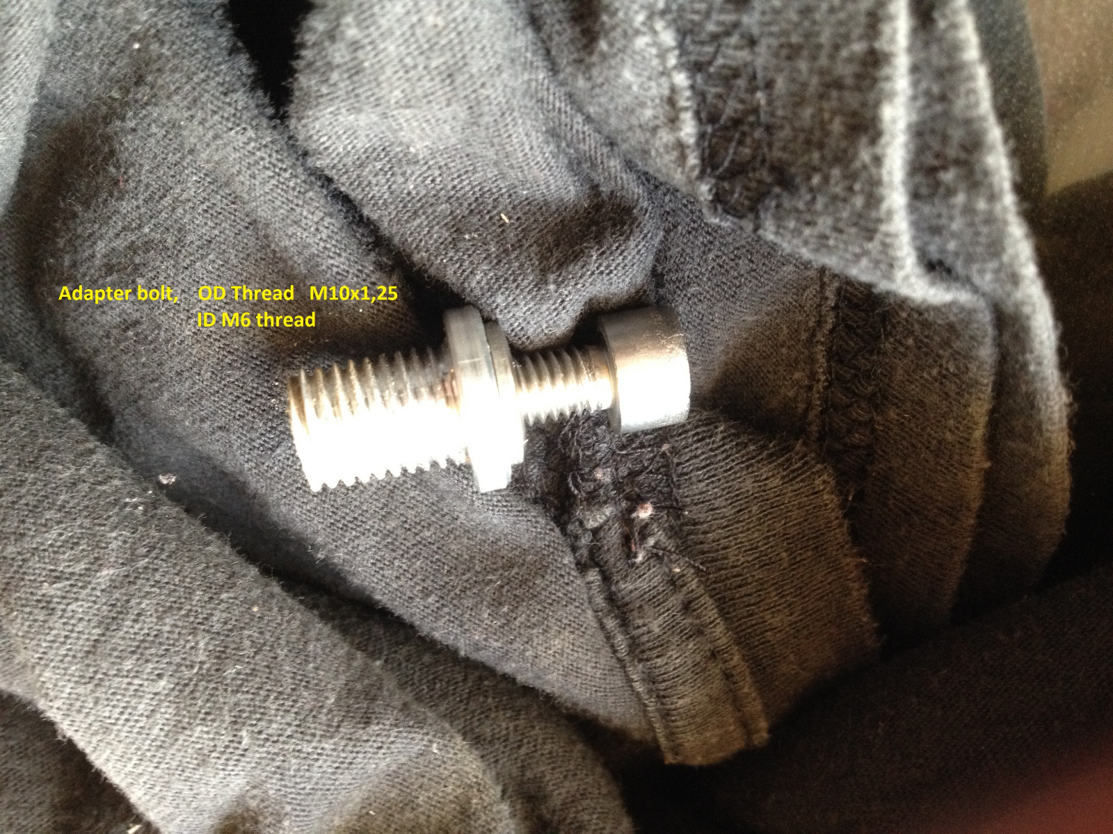

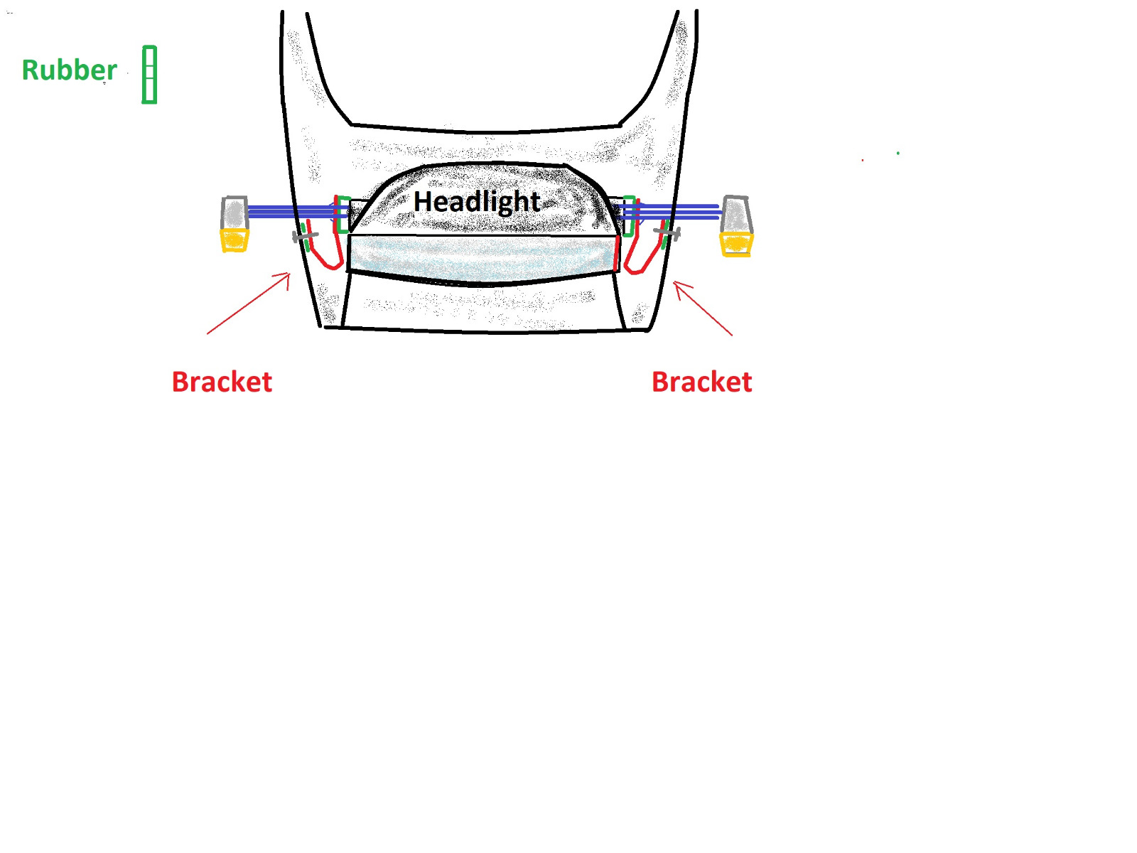

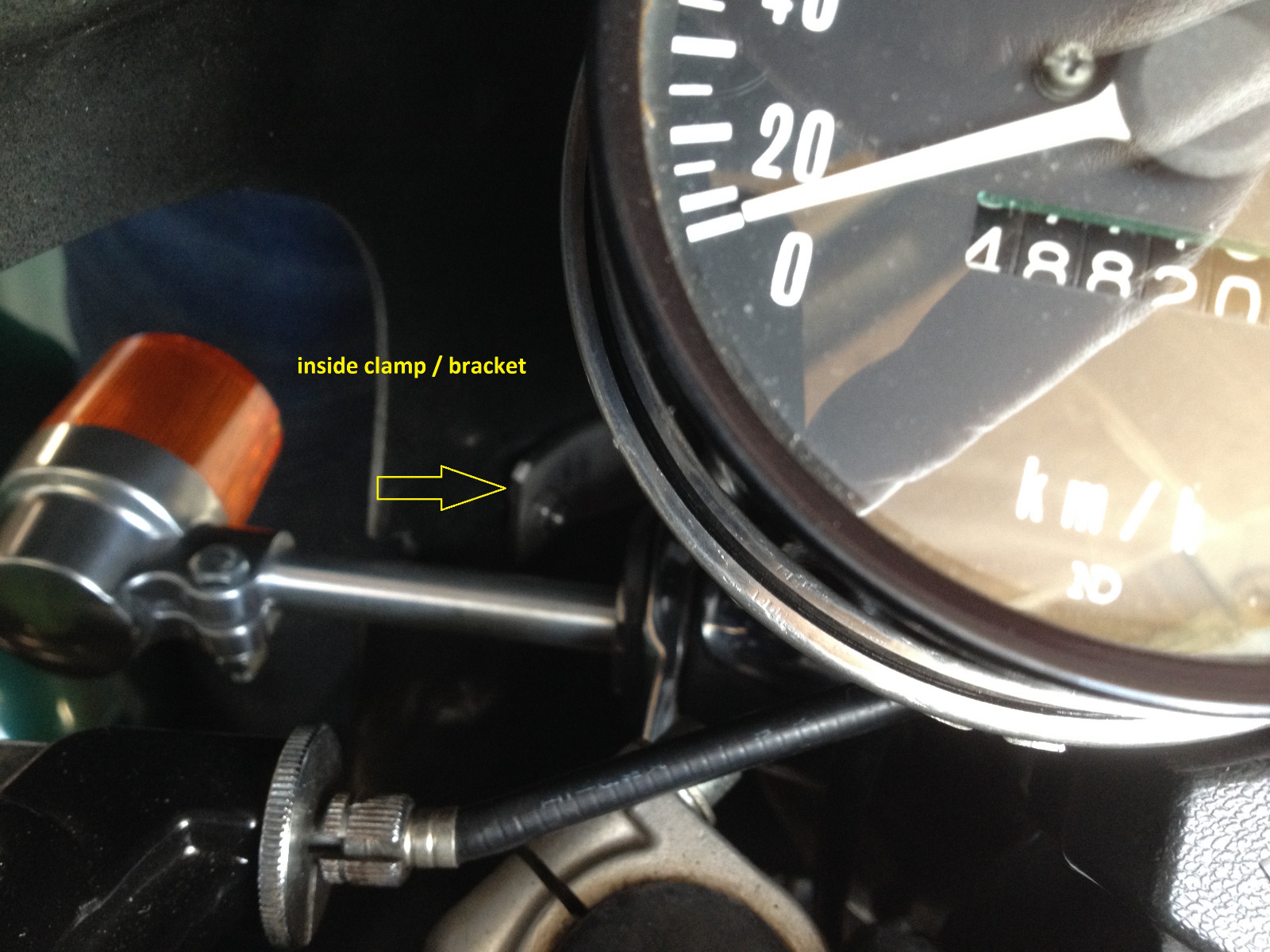

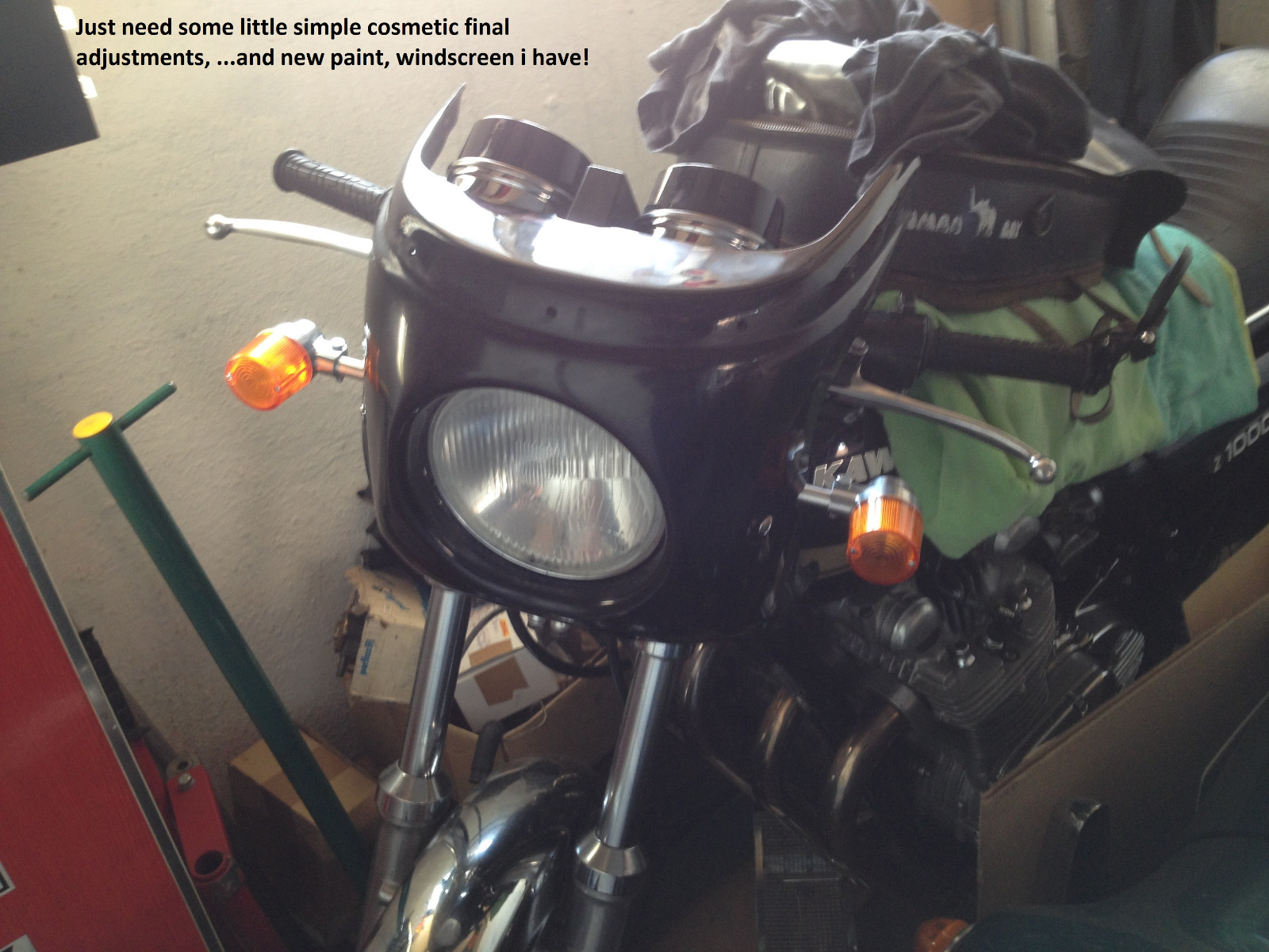

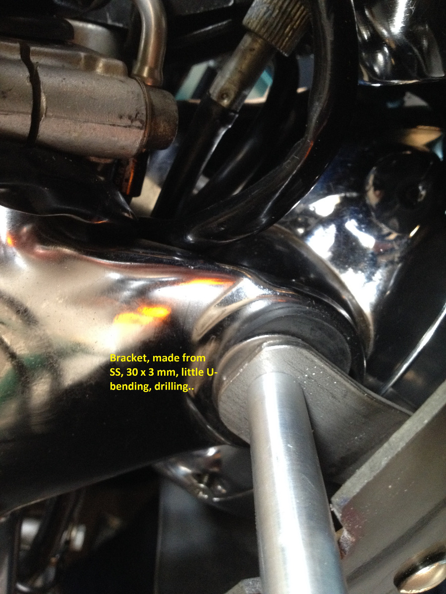

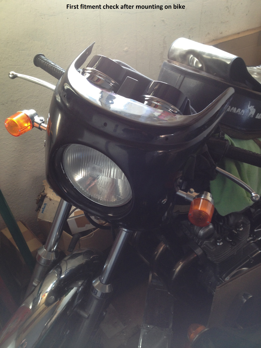

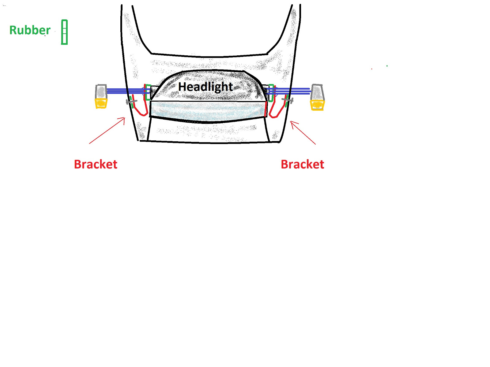

Today the day was a bit brighter and sunnier, so I put the fairing on the bike. To do this it was necessary to make a few longer indicator rods, as well as the actual brackets. I´ve mad the brackets from 30 x 3 mm flat stainless, bend the to an "U" like, they fitted under the flasher studs...

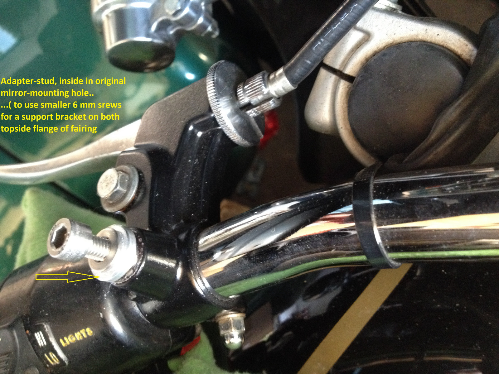

Just need a little mini correcting, but at all, the fairing fits ok for me. Finally, i will support the fairing on both top-side-flanges, with little supporting bracket, mount on the original mirror fixes, than the fairing is "storm-resistant" i think
Here a simple drawing about the brackets, view from top

06 Feb 2025 08:58 - 06 Feb 2025 09:00Thanks for posting your progress. Any pics of the top brackets?Finally, i will support the fairing on both top-side-flanges, with little supporting bracket, mount on the original mirror fixes

Thanx,
still not,... they are under construction

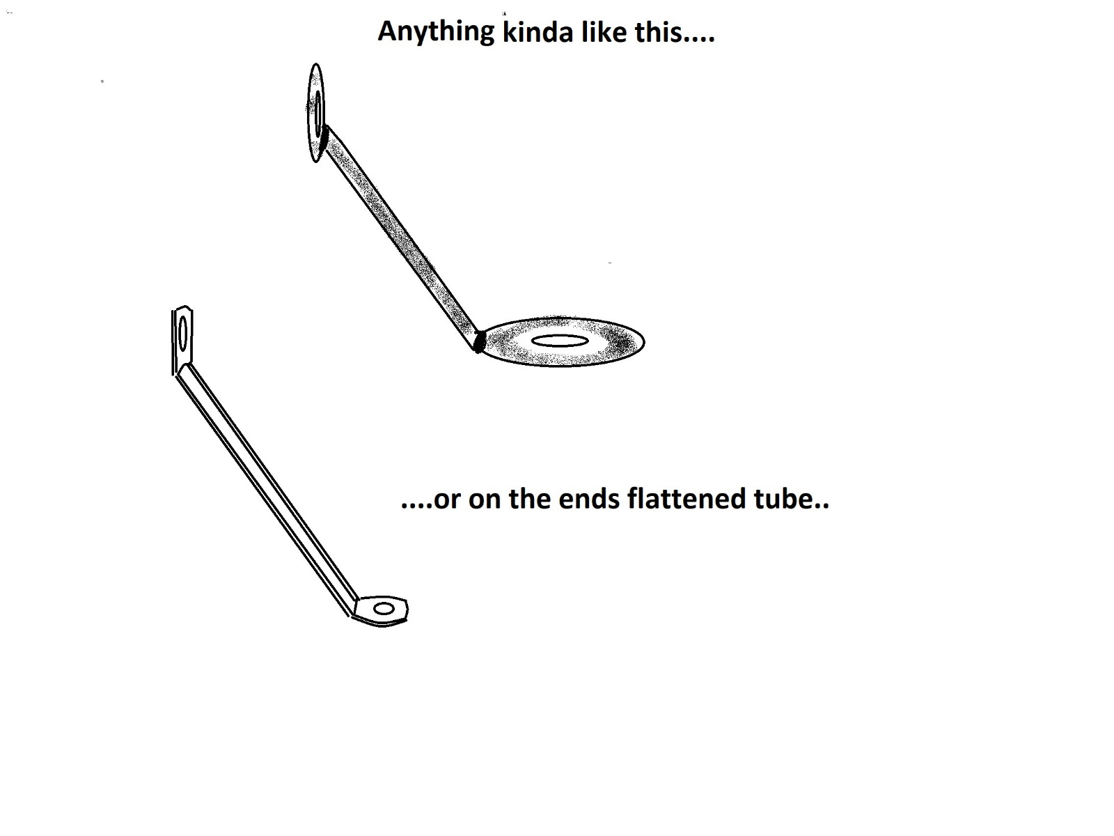

Planed is a tube or rod, about 5-6 mm OD, with weldet on washers on both ends, or made from tube...I´ll keep you informed

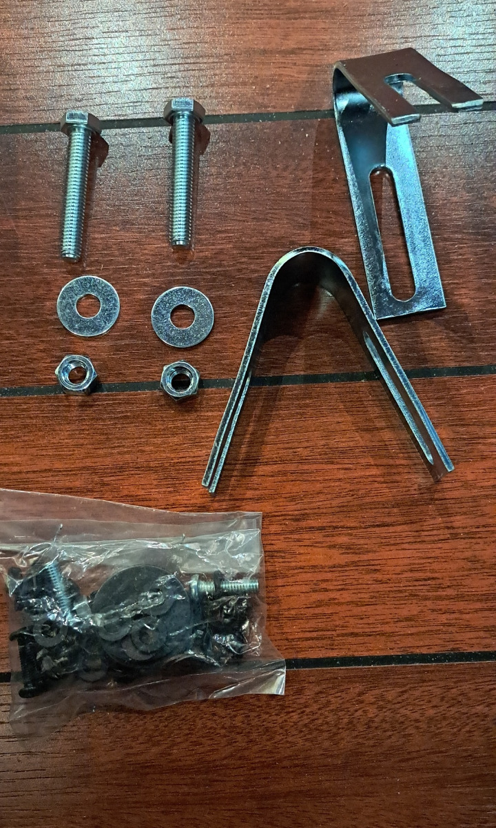

here is a pic of the brackets the came with the fairing i bought.
And did you lower the headlight and fairing ?

i dunno about the original lenghts of the Kawasaki indicator studs, but remember, the original Kawa-flashers have a big diameter, maybe, you will nett longer studs..best way to know about, is to hold the fairing in front of your headlight, than you will see, how many space ya will have between both sides...
No, i´ve used the original headlight mount, in correct fix, ( NO upside downs), cause it matches so perfect with my handlebar and the resulting level of the master cylinder,..nothing disturbs, overall good clearance.
So i can live with the installed heights...

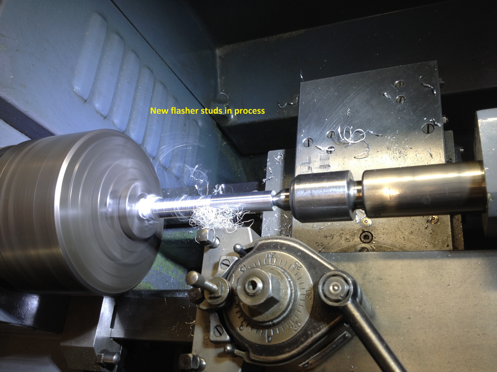

( I´ve made my blinker studs from Ø 15 mm aluminum, reduced the diameter to 13,98mm to match the Honda blinkers,..the first ones (without the fairing), haven´t been to short with their 50mm outside, now they are 90mm long ( from headlight monting point), and that a little to long, i think, i will short them about 20 mm each. for a better. look...)

Ok thanks Joe. to bad i dont have access to my bike now it is in a winterstorage at the dealer. I just had ha look at one pick now and it looks like the blinkers is to close to headlight. I will find out in a month when i get the bike out.
