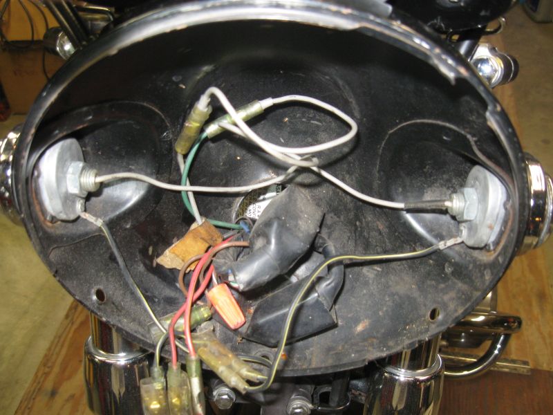

11 Dec 2021 12:41The orange wire nut is capping off the BR/W European 'city light' wire that's unused on U.S.-spec Z1's. The lower small pin connector is from the guage cluster. The large pin connector is from the main harness. The three headlight wires disappear from the pic at the bottom. The headlight is resting on the front fender.Does anyone have a photo of how the wiring harness gets bunched up around the headlamp? Is it all inside the can? It’s a lot of stuff and of course I didn’t adequately photograph it when I took it apart. I never take enough photos.

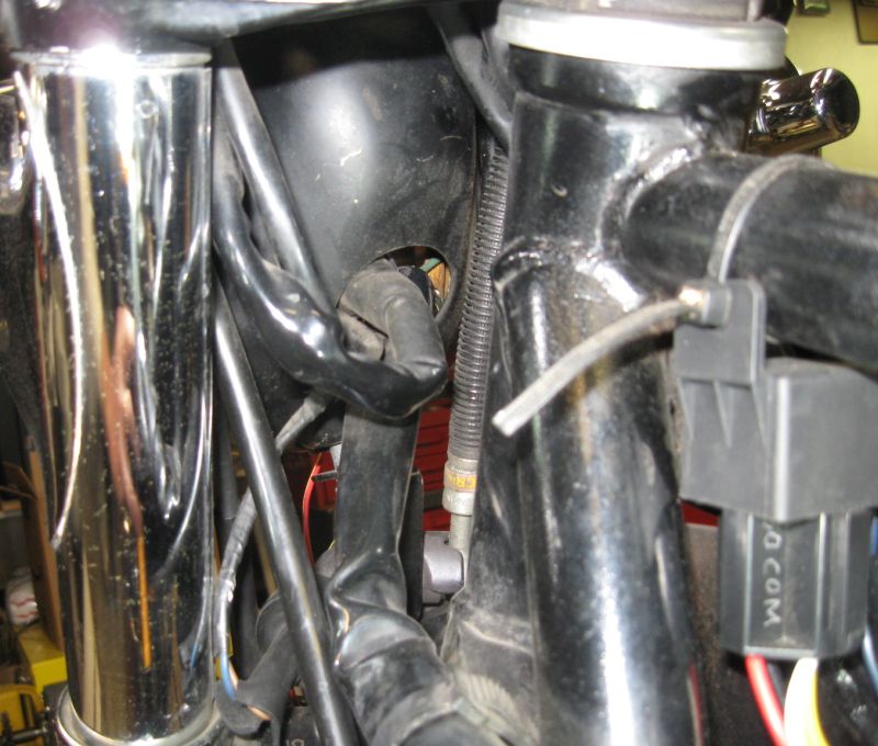

View forward from the left. Routing is factory. Ignore the relay under the top frame tube; it's the coil power bypass relay. That's just a handy, protected place to mount it.

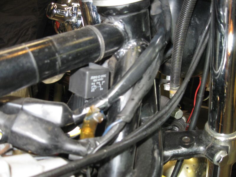

View forward from the right.

What is the relay for the coils for? Does it keep the current from going through the handlebar controls?

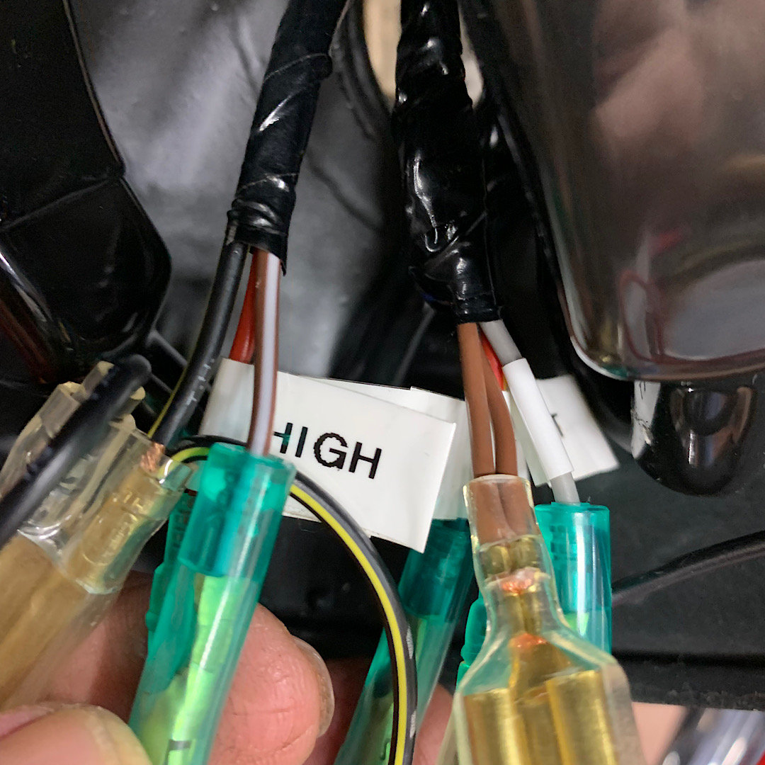

I'm getting the wiring back together and I have everything working. In the headlight can I'm left with two things. A single switched power brown/white which I assume is the Euro park light. There is another dual connector that is brown, also switched power. Since everything is working I'm wondering what this connector would be for.
