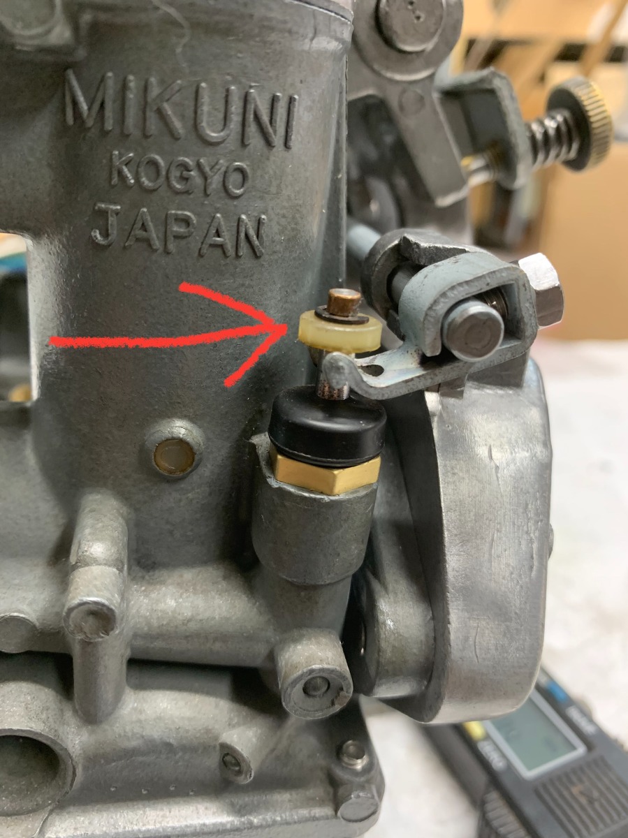

Yes, these are different than later models, mine are ok but worn so I'm wanting to get some fresh ones.
  • MauiZ1
  • MauiZ1's Avatar Topic Author
  • Posts: 235
  • Thanks: 25
Re: 1973 Z1 Maui
17 Dec 2021 07:46
#859204
Yes, the double ended type nylon lifter was for the later 217 type carbs. The simple one, which I need, is for the 147 early carbs. They sure made lots of little changes along the way. I think maybe more than the early Honda CB750's
I'm anxious to see how my refurbished plungers work.
  • hardrockminer
  • hardrockminer's Avatar
  • Posts: 3158
  • Thanks: 1252
Re: 1973 Z1 Maui
17 Dec 2021 18:40
#859242
I think your plungers are the same as later carb models so the 2170 ones would work in a pinch.  But no sense switching them out if yours still work.  If it's just the yellow colour bothering you that can be fixed.  Try ultra sonic to clean them up and if that isn't good enough then a little soda or bead blasting will do the trick.

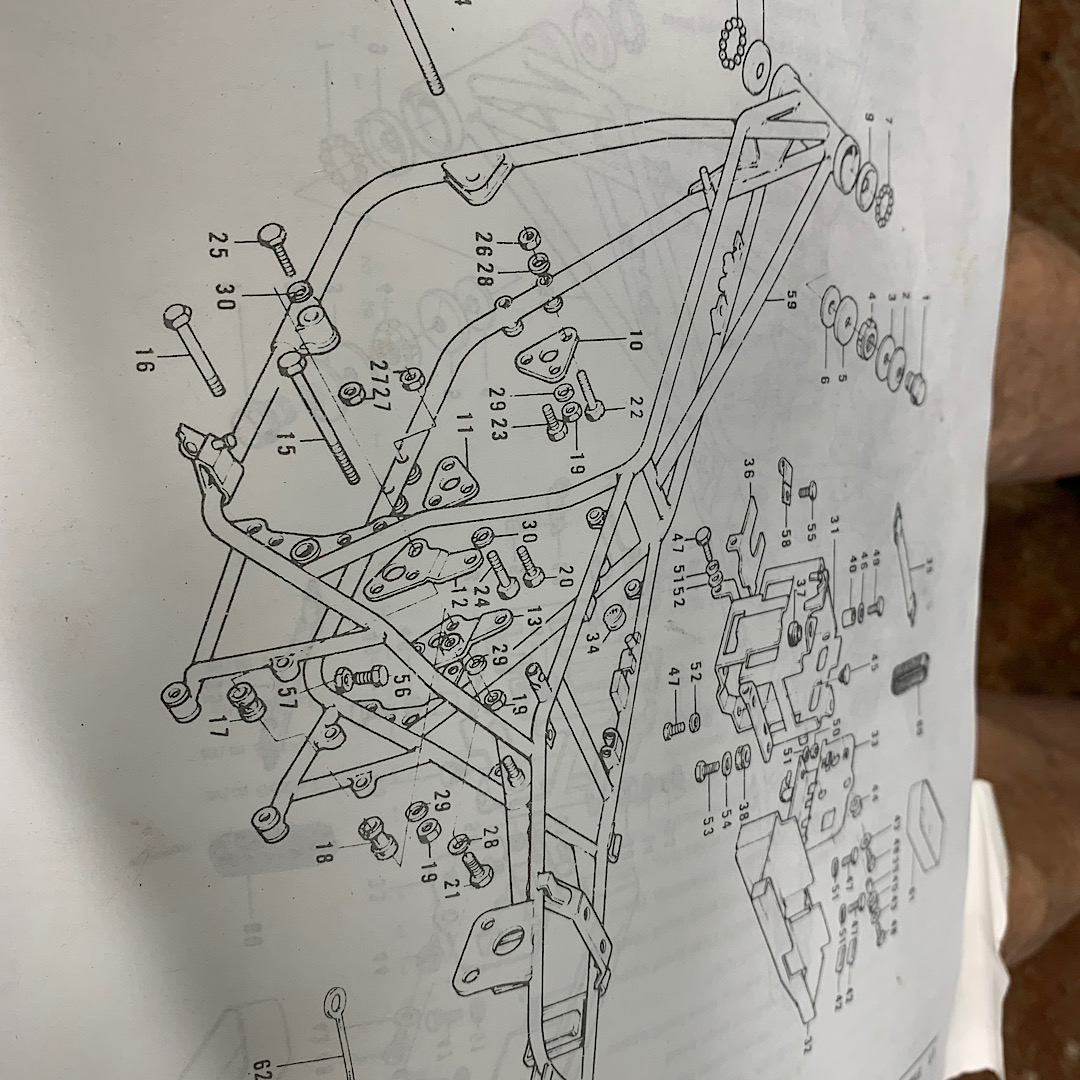

Re: 1973 Z1 Maui
19 Dec 2021 13:51
#859315

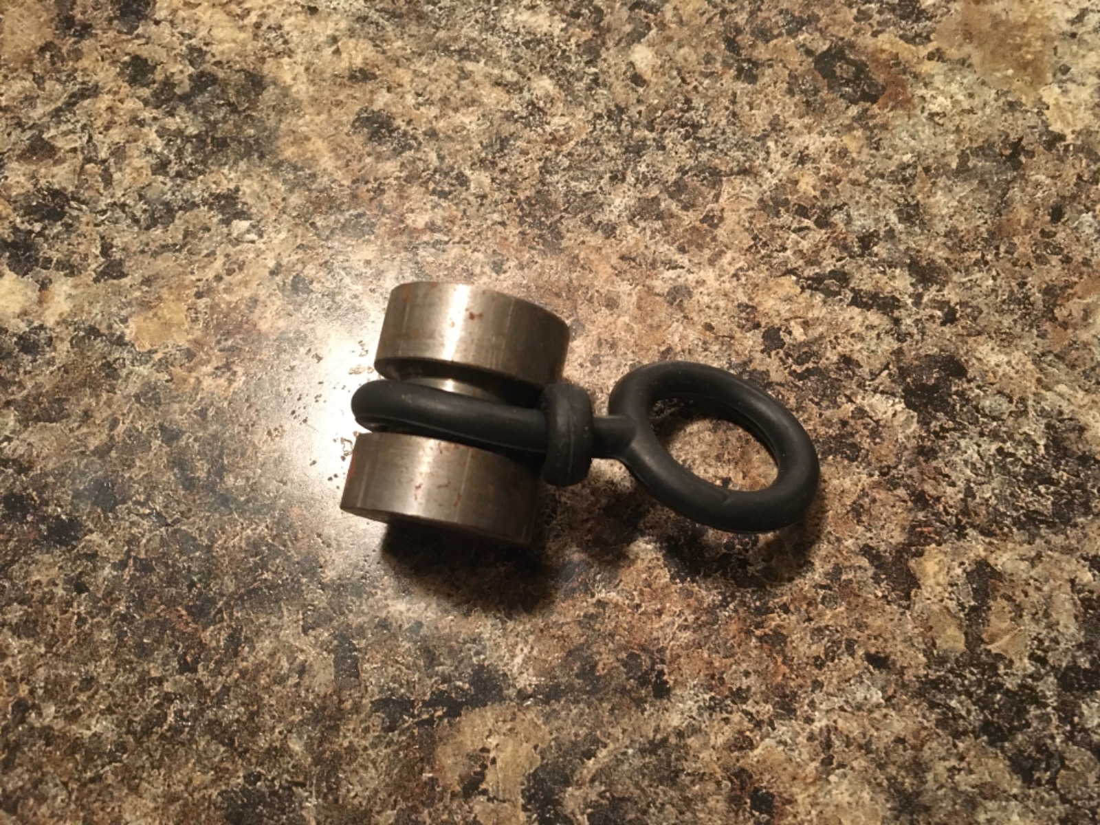

In the photo, piece 62 is listed as overflow clamp. It’s a rubber bungee with a round end and an oblong end. Does anyone know how it mounts? The parts book doesn’t really illustrate it location.
  • Mikaw
  • Mikaw's Avatar
  • Posts: 4825
  • Thanks: 1852
Re: 1973 Z1 Maui
19 Dec 2021 14:16 - 19 Dec 2021 14:22
#859316
It goes around #18 upper rear engine bolt spacer?
this is #17 spacer but for example
Last edit: 19 Dec 2021 14:22 by Mikaw.
  • MauiZ1
  • Posts: 235
  • Thanks: 25
Re: 1973 Z1 Maui
19 Dec 2021 19:09
#859329
Ok, I see now,thank you and Merry Christmas

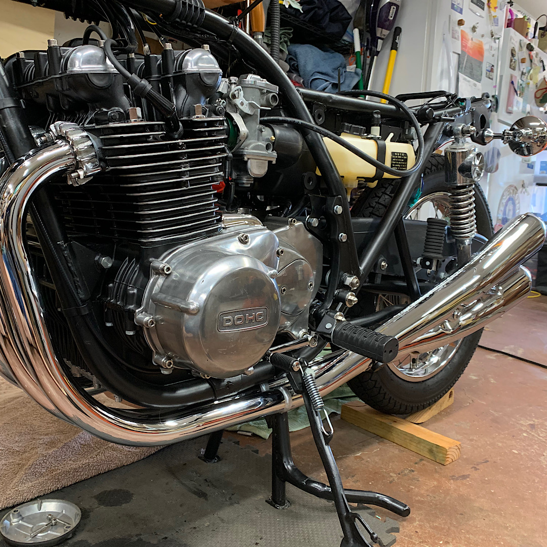

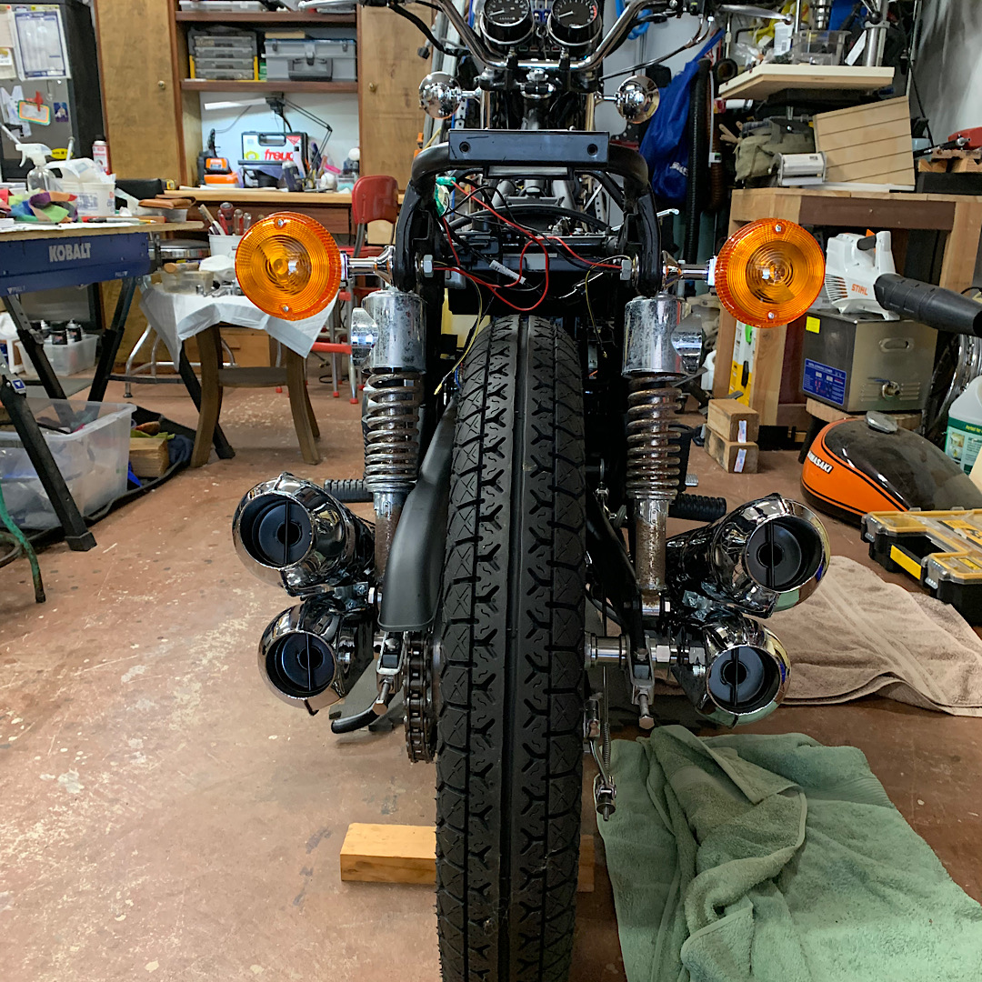

Exhaust went on yesterday, fairly smooth. I had the rear axle in backwards, had to swap that so the nut wasn't in the way. Getting closer to test running the engine.
  • Skidmark
  • Skidmark's Avatar
  • Posts: 1087
  • Thanks: 312
Re: 1973 Z1 Maui
21 Dec 2021 07:45
#859408
Beautiful work, but those rear shocks have got to go!!!  I know those are on just to hold the bike up at the moment.
