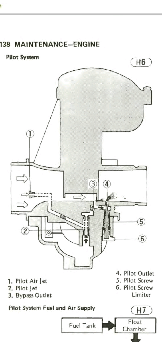

Fuel mixture screws. Try

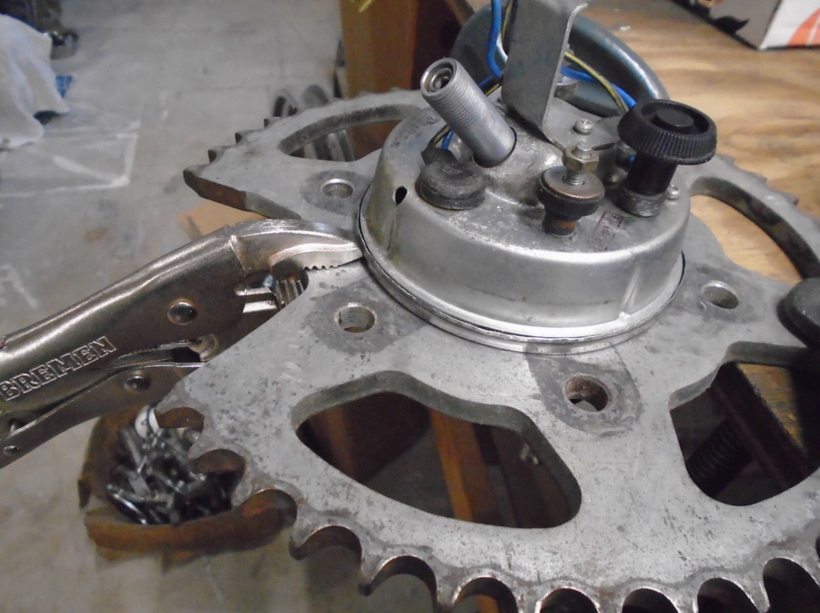

Kaylinator: I am not sure anymore, but sometime back I thought I saw someone using an old rear sprocket hub hole to hold a speedometer with in order to put the rings on. You may want to do a bit of searching on that one or may be someone that knows can chime in. I sent my gauges out to be refurbished so I didn't have to mess with it. You are quite lucky you found that broken needle in your carb by the way. Good luck!

30 Dec 2020 17:07 - 30 Dec 2020 17:07Rick H. wrote: Kaylinator: I am not sure anymore, but sometime back I thought I saw someone using an old rear sprocket hub hole to hold a speedometer with in order to put the rings on. You may want to do a bit of searching on that one or may be someone that knows can chime in. I sent my gauges out to be refurbished so I didn't have to mess with it. You are quite lucky you found that broken needle in your carb by the way. Good luck!
Rick H.

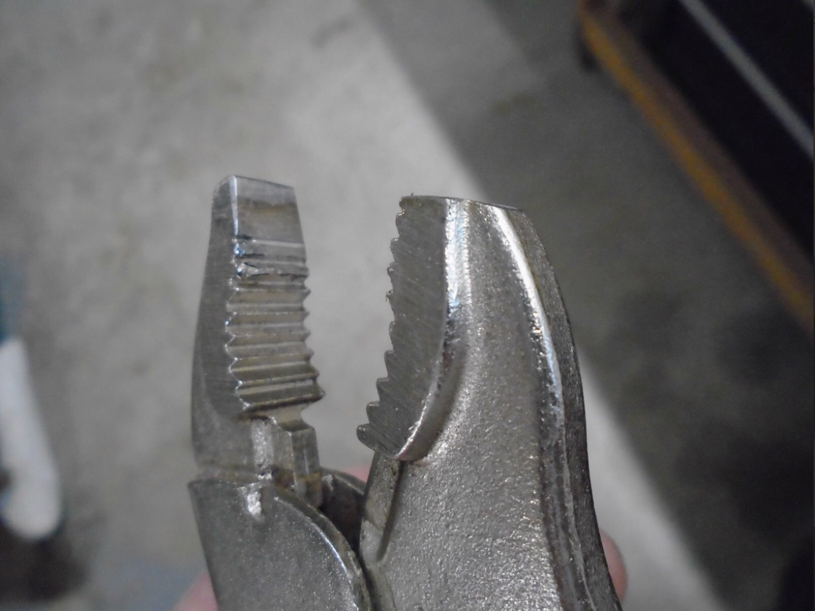

Here Rick. Asphalt900’s jig

30 Dec 2020 20:04SWest wrote: Fuel mixture screws. Try
jetsrus.com/carb_rebuild_kit/carb_rebuil..._kit_1selection.html
I prefer to stick with the nomenclature Kawasaki uses in their FSM. It helps to avoid confusion for noobs like myself.

30 Dec 2020 20:13Rick H. wrote: Kaylinator: I am not sure anymore, but sometime back I thought I saw someone using an old rear sprocket hub hole to hold a speedometer with in order to put the rings on. You may want to do a bit of searching on that one or may be someone that knows can chime in. I sent my gauges out to be refurbished so I didn't have to mess with it. You are quite lucky you found that broken needle in your carb by the way. Good luck!
Rick H.
I had actually seen Asphalt900's setup, and made something similar out of scrap steel. Even went out and bought some cheap pliers to sacrifice. Just wasn't having any luck. I thought to try searching for some crimp rings made of a slightly softer material, but eventually decided this was good enough for now.

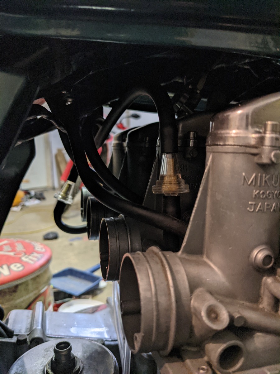

I went to the shop on the weekend and reinstalled the carbs. Partly to get them off the kitchen counter, partly to get fuel lines figured out. I'm pretty happy with the way the fuel lines looks for 3/4, but I think I may have to get a 90° fuel filter for 1/2?

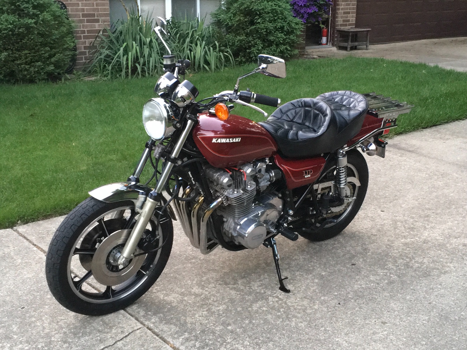

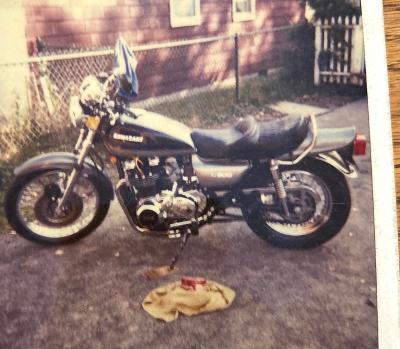

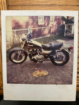

Hi Matt, this was the seat we used to buy in late 70's - 80 who remembers "Beck Arnley" catalog?? $49 dollars! They held our ass in place doing hole shots on the street! Hog wheel with lowered shocks. My 1st. customed up KZ. And the same bike 30 years later after a couple of us selling it and rebuying it. I always painted silver black. O f course I liked the 73 Z1 paint scheme. I found an old polaroid pic.
