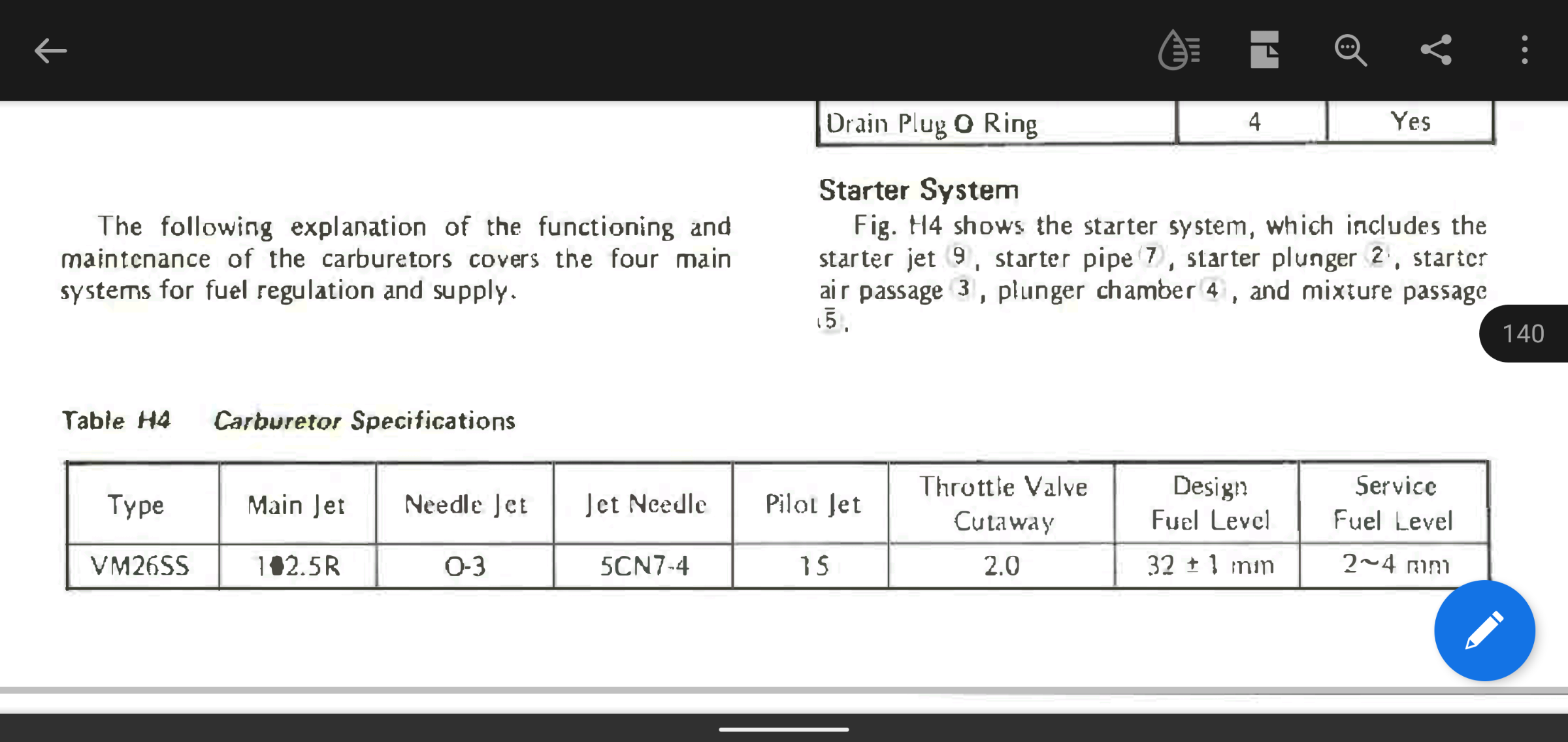

Okay guys, I need your help.
I could swear these carburetors had never been opened. There was still factory paint marker on them.
However, these seem to have 105 main jets.
The FSM says that it is to have 102.5 mains, and so that's what I had ordered.
This bike has the stock airbox and still had the factory exhaust when it was parked.
A Google search seems to come up with conflicting information.
So what's the correct answer here? Should I just keep the 105s in there? Swap them for the 102.5s and see what happens, knowing I can swap them back later if needed?

Re: 1978 KZ1000-A2 "Barn find"
12 Jan 2021 16:01
Can’t hurt anything being a tad rich. On the other hand if the 102.5’s were to make it lean then that could cause damage. Easy swap if you find your rich. I have been told error on the rich side and correct from there
12 Jan 2021 16:03
105 was standard for the A2. 102.5 was standard in the LTD.
12 Jan 2021 20:36hardrockminer wrote: 105 was standard for the A2. 102.5 was standard in the LTD.
Well that's just ridiculous. The cover of the FSM even has an A2 on it.
Thank you for clarifying that.
13 Jan 2021 05:05
If it's an A2 your frame serial number should have an "A" in it. If it has a "B" then you have an LTD.
13 Jan 2021 06:44 - 13 Jan 2021 06:47Kaylinator wrote:
Well that's just ridiculous. The cover of the FSM even has an A2 on it. .
The fsm often covers more than one model. There should be a notation about the different jetting, or perhaps it is covered in a supplementary section at the back of the manual.

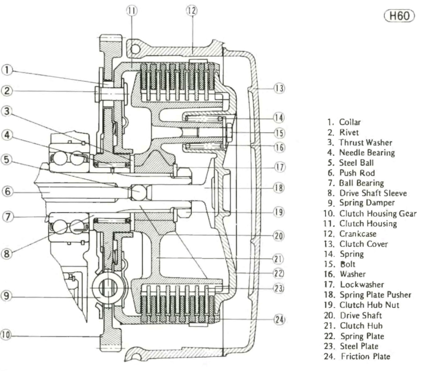

Question for the experts here.
My clutch lever has always been harder to pull than it should be. The cable moves freely, and it does not seem to be an issue with the clutch release mechanism either. It seems to me like whatever the push rod is supposed to push on is sticky?
Has anyone every experienced something similar? How'd you fix it? I did a search of this forum and Google and it seems most people's issue is with the clutch release mechanism itself.
