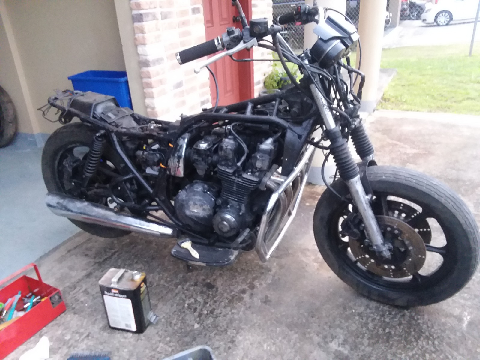

ThatGPzGuy wrote: Soda blasting is an option. Cheaper than a sand blaster but not as effective as or fast.
To speed things up you can use some aircraft paint stripper. It loosens up the paint and once dry the blaster finishes the job. Just don't get it on stuff you don't want to repaint.
That gallon jug in the picture is industrial paint stripper. It's working well.

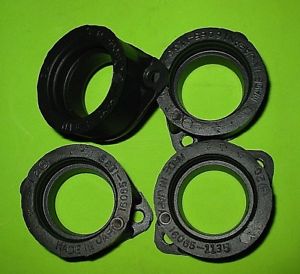

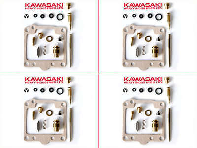

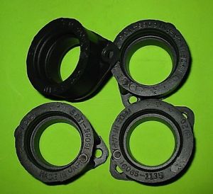

Ive ordered a few parts, most importantly a 81-82 kz1000 carb kit, intake boots and a factory air filter.
The pilot jets seem to have an issue and my intakes are cracking , so this should cure those issues.

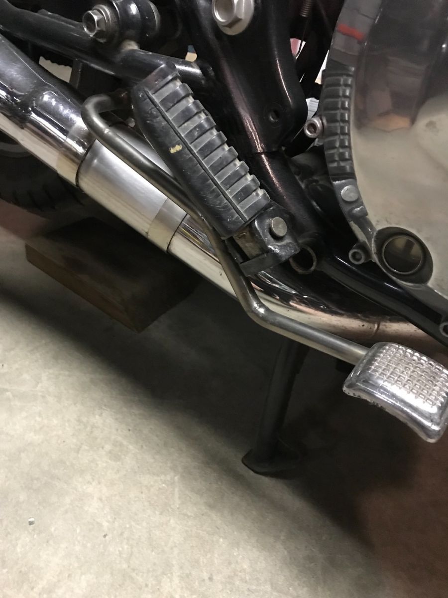

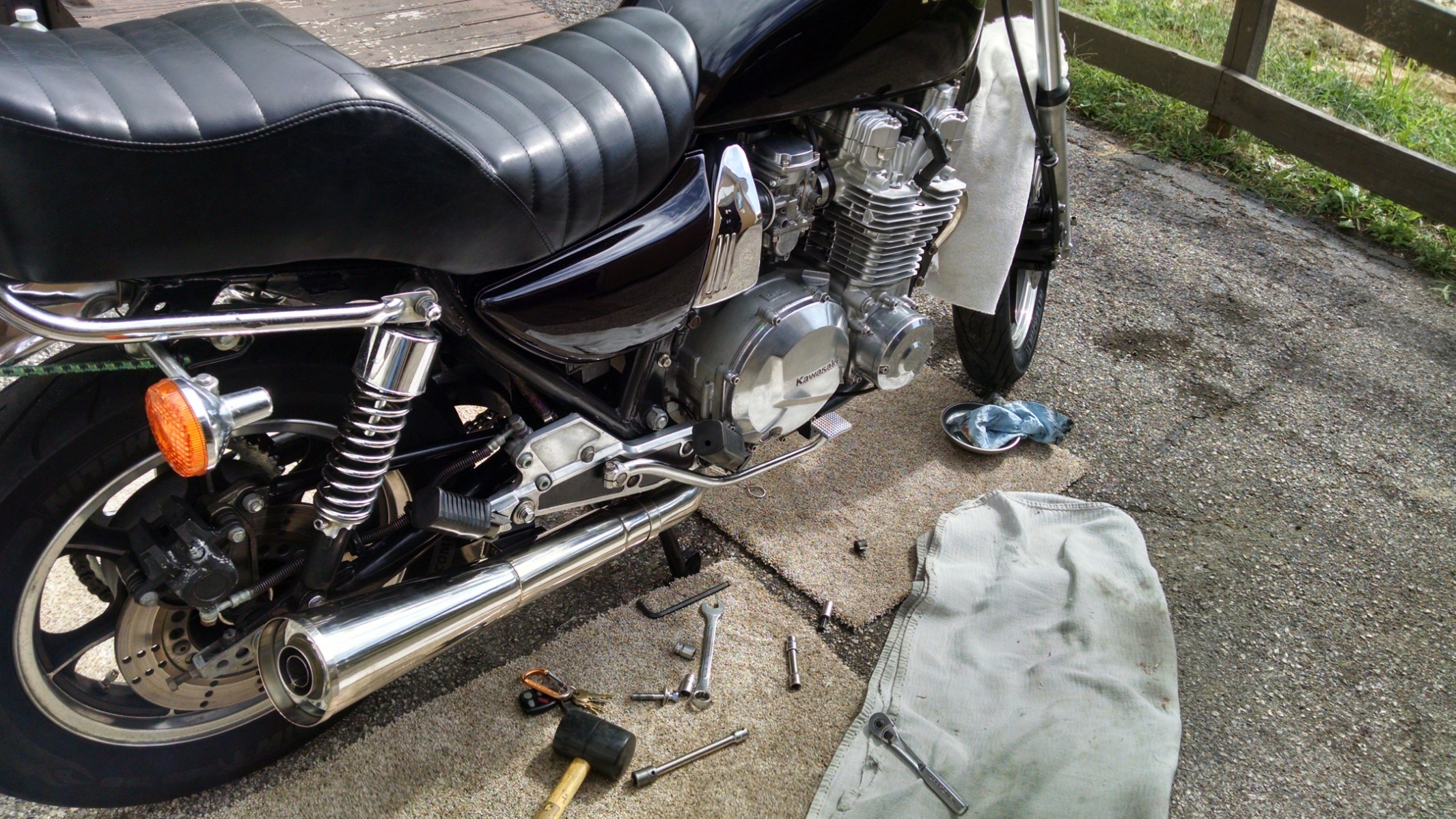

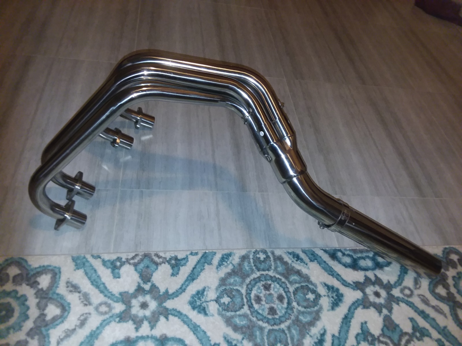

I had to stretch my exhaust out about 4-5 inches because the Kerker bracket ends up on that frame loop that the rear master cylinder mounts to. I went to an auto parts store and purchased an off the shelf pipe extension and cut it fit. No big deal. I could have modified the frame but that would have started a whole other project with the rear brakes. I just want to keep it simple .

2.5” x 18” I think was the piece I bought. Also I made a lever for the rear brake lever out of 1/2” cold rolled and just welded it to the bell crank from the master cylinder. Not very complicated, maybe some day I’ll engineer a Rube Goldberg linkage for it but for today we just ride.

Great info and picture, thank you. That is a real help seeing that setup. Nice work on the brake as well.

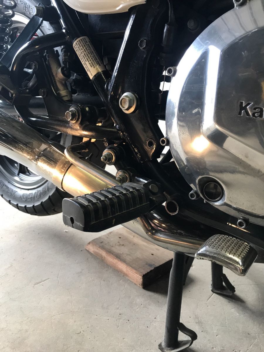

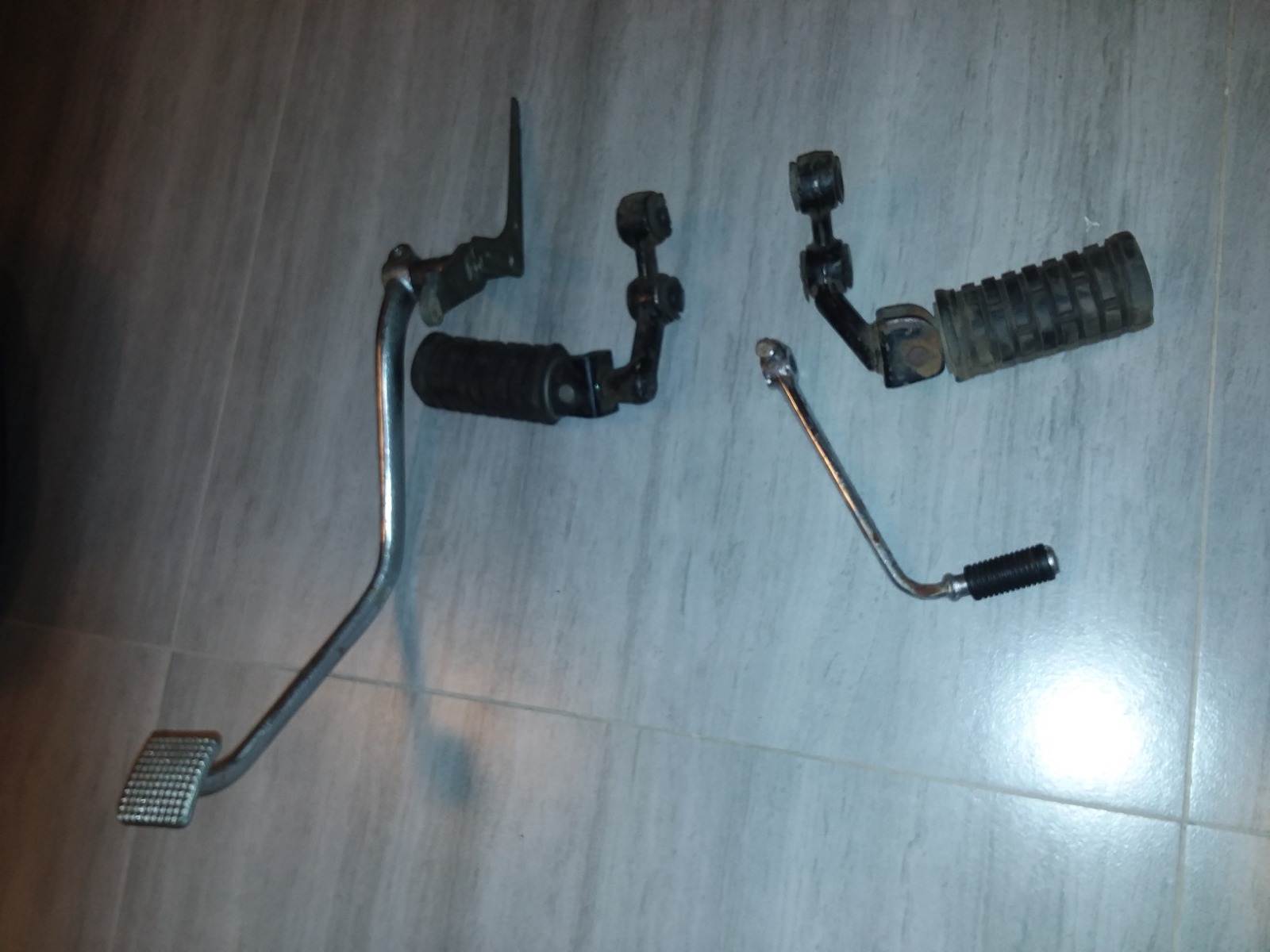

Foot controls came in, might be able to get to those this weekend.

The pipes are Delkavic. They look nice.

I have a cheapo sandblaster ordered to finish the paint cleanup. The second bath in stripper didn't do as much as the first so I've been using a wire brush, but I think it needs the bead blast to get where I want.

Jimbo302 wrote: Foot controls came in, might be able to get to those this weekend.
These foot pegs look ok, if they fit properly. It seems the floorboards are one of the more difficult things to eliminate. All in all, I think you are on the right track. from what I see you ordering with the carb kits and rubber carb holders etc, The bike should respond nicely.
I have the Dlekevic exhaust on my bike, and it sounds pretty knarly. lol
There is a 82 Kz1000P for sale on this site, located in western mo. Check this one out. I think it looks pretty nice.
www.kzrider.com/forum/23-for-sale/609652-1982-kz1000p#794176
your bike looks great!
I'm hoping I can make these pieces work.
