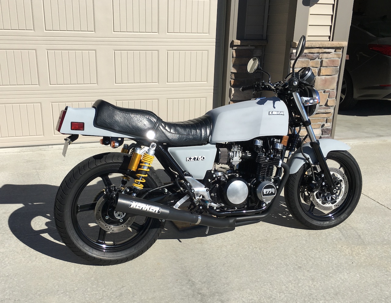

So I finally have my engine back together with a new oil ring expander for #3 piston. Thankfully it runs just as it should and now with no oil smoke! So I can finally post a video of it running to show my progress.
I have been riding around the subdivision because I have no insurance and expired plates, but I snuck it out on the rural road next to my neighborhood just to see how it shifts and to check my carb jetting. It has surpassed my expectations so far. It shifts through all six gears like butter and doesn't sputter or bog at any point on acceleration. It does seem to stutter very very subtly when cruising at 70mph. But there was a 25mph wind blowing the whole day I did my road test, so it could have been that. So before I make and carb adjustments I will need to get more miles on it.
Now I have the winter to reposition my exhaust into a more aesthetic spot. As it is now, it is designed to bolt up to the pillion rear support and because I no longer have that, the megaphone points straight backwards in a odd way. Not to mention my support bracket for it is about 20" long. So I "intend" to come up with a mid-pipe to ad more upsweep to the megaphone like the vintage race bikes exhausts.
The next issue is that my Zephyr 750 carbs I got on ebay had looked to be used as a hammer at one point. I thought that the damage was limited to the cracked float bowl and caved in diaphragm lid. But after several heat cycles on the bike, I noticed that there is a long fracture in the intake side throat of the carb as well. ( I of course only noticed this just as I was finished syncing the carbs, so It means I get to do that all over again.) So I have a set of cvk32's from a zx600c on the way to replace the Zephyr ones. I tried to find a replacement carb body to replace the cracked one, but I could find every one but the one I needed.
I cannibalized my spare set of zr550 cvk30's for parts so I will end up with a complete set of 32's and 30's when I have everything sorted anyways.
The speedo is +5mph just like the one on my Zephyr. Its because the Bridgestone tires are smaller in circumference than the stock Bridgestone's of the exact same size. So when I was at 4000rpm's I should have been going 65 mph but my speedo was at a optimistic 70mph. I knew I should have bought the slightly wider and taller Battlax tire instead of the stock size. Fudge!
My kick stand is so short that it looks like the bike has fallen over. So its off to the salvage yard to find a longer replacement.
And of course paint. I simply cannot afford to have a quality job done at this point, so it looks like I am stuck with primer for the foreseeable future. Unless some one wants my basement of gpz550, zr550 and kz750 parts in exchange for a paint job?

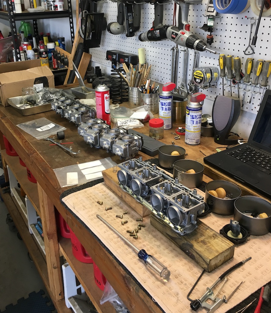

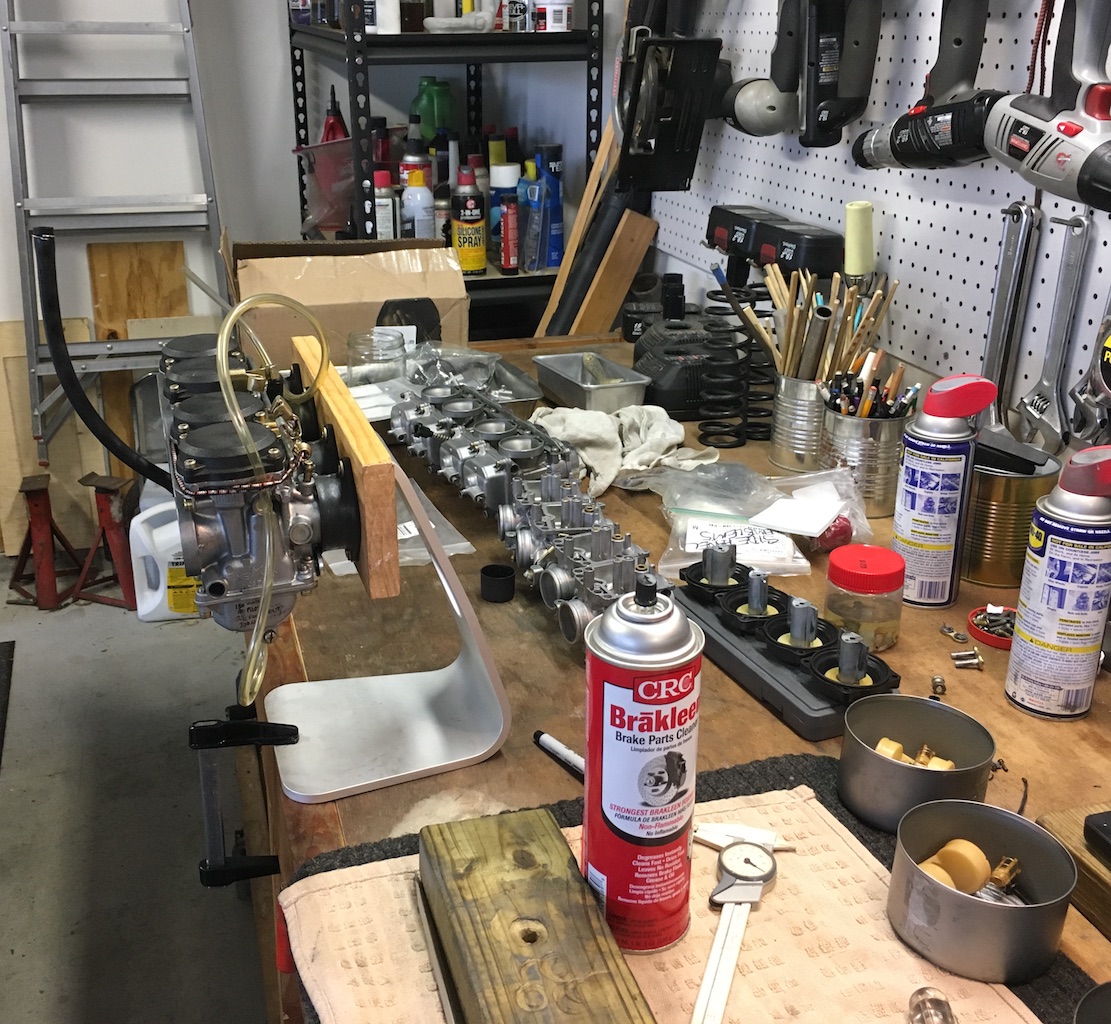

I got my 1994 zx600c carbs in the mail and proceeded to make two good sets of carbs from three.
Thankfully my research was correct and the Ninja cvk32 carbs are identical in all the important ways to the zr750 cvk's.
The pressed in air jets are both exactly the same sizes.
Main Air Jet - 100
Pilot Air Jet - 150
The needle jets were also the same, but obviously the needles, main and pilot jets were all the wrong sizes but that was all replaced with the correct sizes from my Factory Pro jet kit.
The idle adjustment knob was slightly different and two of the fuel pipe extensions that split the fuel between the carbs were plastic instead of aluminum like my older carbs, but that was all easily swapped over to the proper ones.
But once I stripped them down, soda blasted, carefully removed a snapped off pilot jet, and reassembled them, I had a perfect working set of carbs with no cracks.
It was a beautiful day today, so I synced the carbs and snuck it out into the country for a 15 mile test flight. As it is, I will not make any changes to the carb settings as it seems as close to perfect as I dare to get.
In sixth gear it cruises at:
55mph @ 3500rpm
60mph @ 4000rpm
70mph @ 4500rpm
77mph @ 5000rpm
Sixth gear is really a highway gear only, as it gets down in the lower torque range at 55mph. Which is what I was kind of expecting.
Fun with carbs
iMac computer stand repurposed into a float level checking stand.
All one color of primer finally
