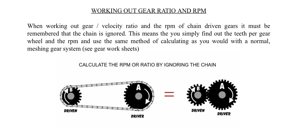

I also noticed that the chain pitch is not changing the ratios like it should.
I swore that two years ago when I was really spending a lot of time on gearing commander trying to figure my gearing, I kept forgetting to change the pitch to 530 and it was seriously changing the final numbers and speeds. Last week I went back and was trying to figure out if my calculations were wrong or if my speedo was really off, when I noticed the chain pitch glitch.
**EDIT***
( I accidentally hit submit before I was done)
So it must be calculating them differently.
I had to research this further so I could understand it better.
Turns out that when calculating sprockets you ignore the chain....just like gearing commander is doing
So no matter the circumference difference between a 17-tooth 630 sprocket and a 17-tooth 530 sprocket, (the 630 has a much larger circumference) you are only calculating tooth counts to get the ratios and not the circumference like I had for some reason thought.
I'm an idiot. I imagined the sprockets as pulleys and changing pulley size changes the ratio. Wrong!
So I ended up with a 2.29 final drive ratio compared to the stock 2.54 after switching from 13/33 630 sprockets to 17/39 530 sprockets.
