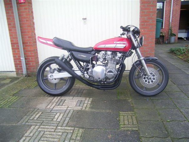

Yeah, that bike is pretty much perfect! The Kerker on my 750fx is low and tucked under the peg too. The one on the 550 that I built (avatar pic) sweeps upward quite a bit. I want to buy a set of those wheels just to have them. I like the PMC Dymag copies. I'm thinking of doing a GPz1100 project, and I'll use them if I do. Too many ideas for too many projects....

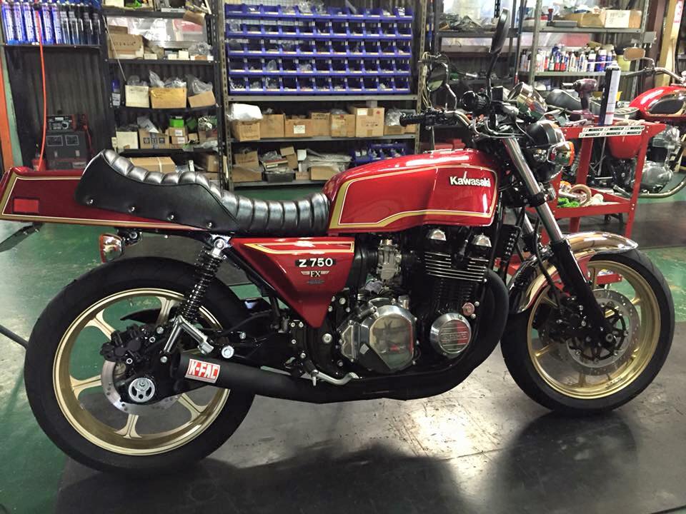

Found this one somewhere too.....
If you look closely, you'll notice that it's a modded Zephyr 750 rep of a Z750fx. Seems to be common in Japan.

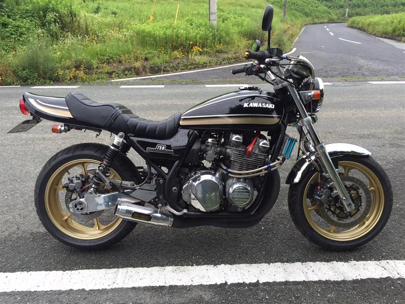

mjg15- I have also seen the mkII clone kit for the Japanese market Zephyrs. I think they are Doremi Collection FX1 kits.
server44.joeswebhosting.net/~do21762/sho...age=index&cPath=2_76
I have seen them them for the Zephyr 400, 750 and 1100. (the 400 version looks absolutely terrible.) I have a picture of a zephyr with the body kit on my computer that I was using as inspiration for what I wanted my bike to look like when it was done. I frankly google images of the Japanese market bikes, because there are so many cool products and ideas to see.
