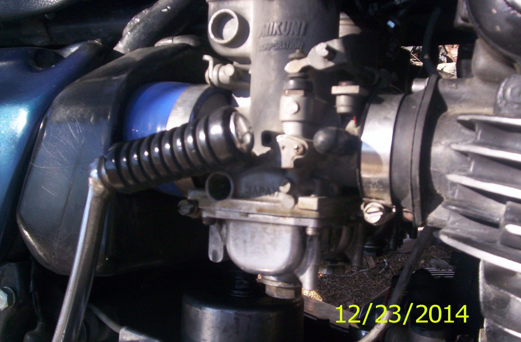

I suspect they be 32-34's. I hope so. The 26's are good carbs whether they're popular or not. Get some late model boots if they are. Better to go up (within reason) than stay put and spend money doing it.

As for the cam sprockets, Not if you have the early style cam chain. That's why they are called drop ins. If you have the Hi Vo, you might have a problem.

The Keihin CR carbs come in odd numbered sizes (29, 31, 33, 35 etc...) and the size is stamped on each carb body. The stamps come off sometimes though.
On the cam sprockets, you can go with slotted sprockets if you want to degree them. There is supposed to be a performance difference but it's a lot of work for something you might never notice. As long as you have the correct number of teeth you should be good. 15 tooth crank=30 tooth cam sprockets, 16t crank=32t sprockets. Good luck!

Did you find out what size the carbs are?

No they won't be here until after Christmas. It was a salvage yard that sold them, they don't always know what they are looking at. As soon as I get them I will post a pick and size.
