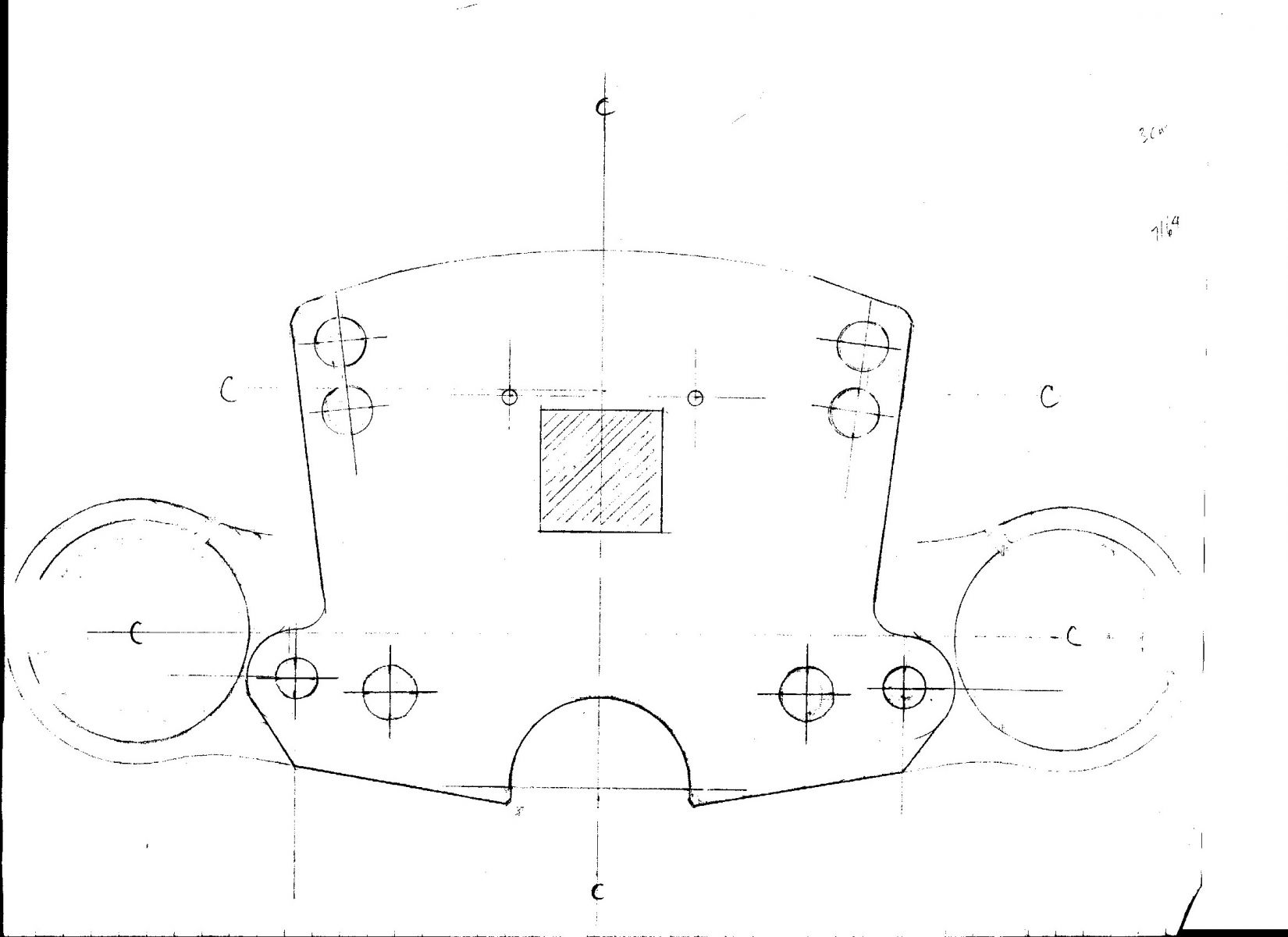

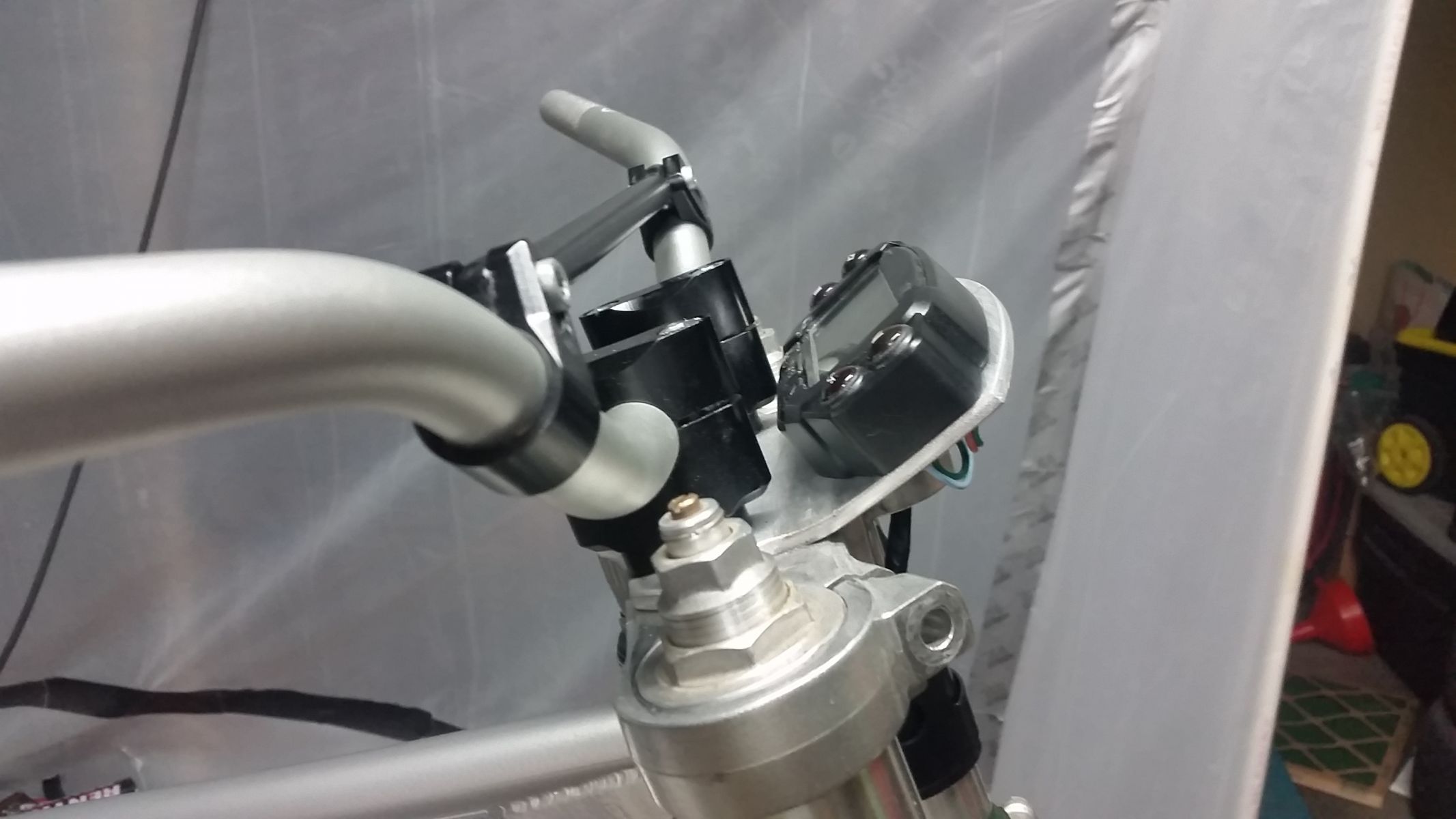

Here is the concept drawing for mounting my Trail Tech Dashboard to the new triple tree. Its no wonder the bike isn't done I keep adding stuff i did't know I would need.

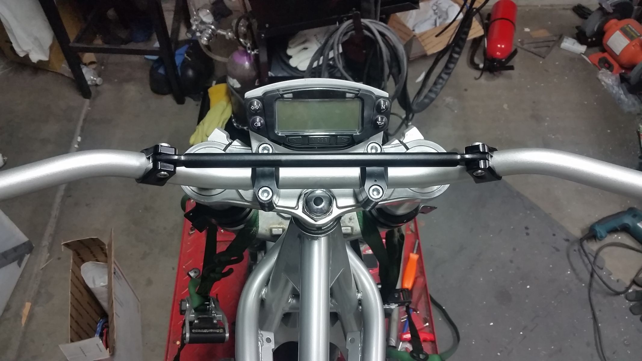

This is what I am mounting to it.

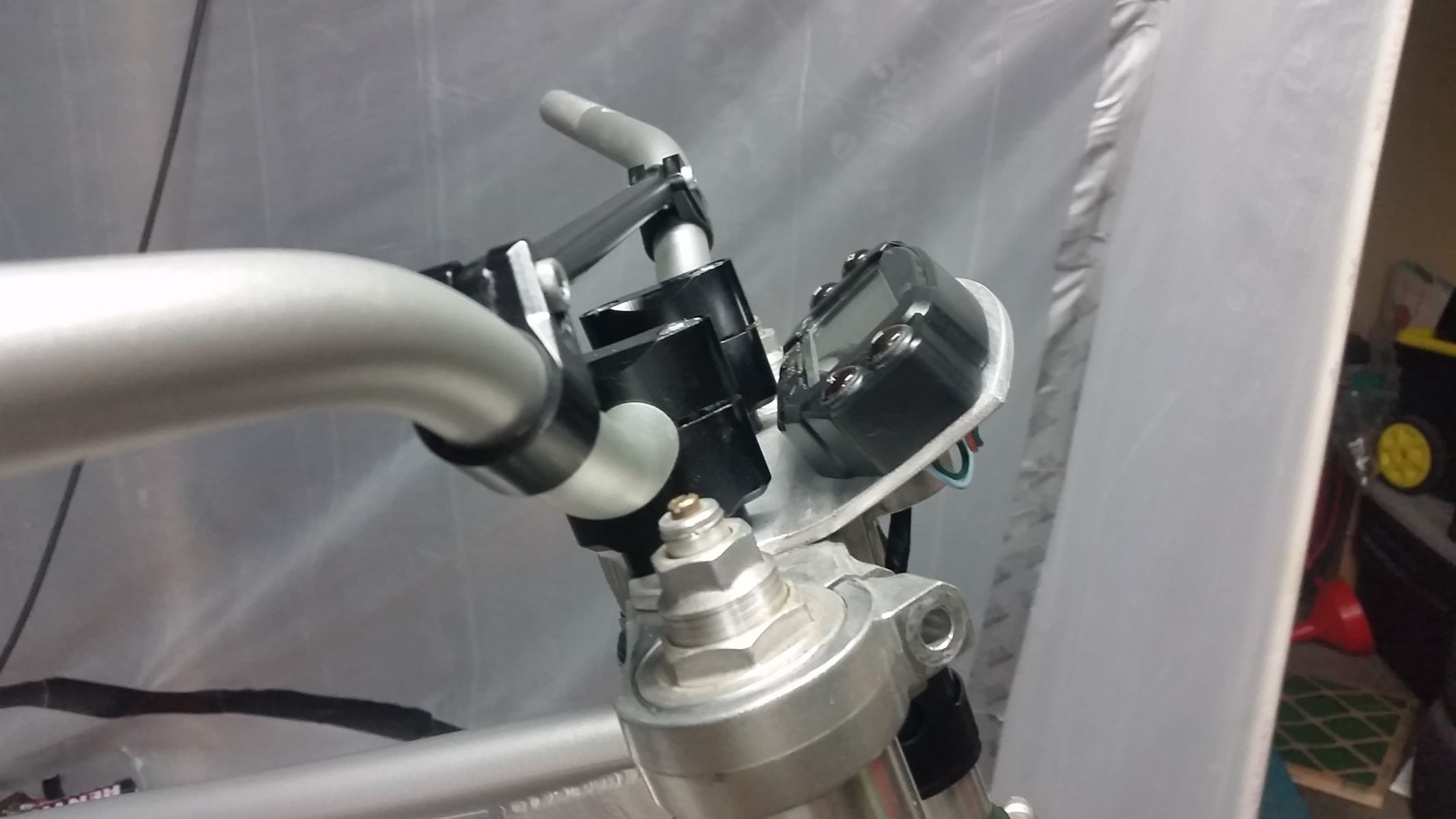

I removed the guts to the OEM pressure sensor drilled it out to 5/16" and tapped it for 1/8" BSPP. Here is the finished modification, looks like its stock to me.
The sensor I am using connects to my existing Trail Tech Vapor.
I do not recommend this mod without installing a pressure gauge. I am using the port above the points cover to connect an oil pressure gauge. Knowing you have oil pressure is much more important that know oil temp.

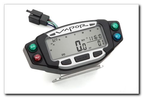

The Trail Tech Vapor, I have been using for 2 years. It works good for what costs. The RPM feed back can be a bit tempermental. It has an induction wire but it did work well wrapped around the spark plug wire. I have mine connected to the + side of the coil. I need to insulate it some how so it doesn't pic up signal from the other coil and it may be more consistent.

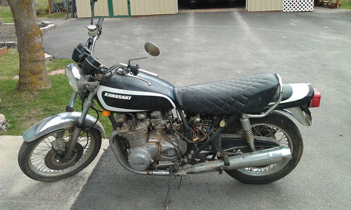

It certainly has. $300 was a great deal. It started with fresh gas and a battery. I felt bad for the guy I bought it from, his wife made him sell the 3 bikes he had. The KZ was in the roughest shape. Had been sitting in the corner of the garage since 1986.
