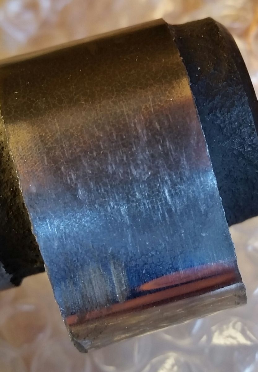

Found a scuff on my intake cam. Take a look at pic and tell me what you guys think. I am on the fence as to whether or not I should use this cam. I looked at it under a magnifying glass and it has been run this way but that does not mean it should have.
More bad news, my cylinders also have scratches in them that I will have to deal with. I may have to just have my old cylinder punched out. The good new is that the pistons are in great shape and are forged not cast. Upon closer inspection there are no casting marks on the underside of the piston, (something my brother pointed out to me). Anyway please look at the cam under give me you opinion, GO or NO GO.
Thanks in advance you guys are awesome as usual.
Its on the releasing side of the lobe if that makes a difference.

It will only wear against the shim, shims are of course replaceable. I can't see it being an issue as long as it doesn't wear badly or fail on that lobe. A bit of polishing with some fine wet paper using light oil, just to smooth it. Run good oil, and a magnetic drain plug. You can recheck that lobe at valve adjustment intervals.
As far as the cylinder scuffing, have you got a hone? Or take it to a machine shop to have it checked and honed.
I'm wondering what sort of oil was used in that motor?

Is that on your Andrews cam? Show pics of the cylinder scratches. Might be able to run a hone through them.

Yes Steve, that is the Andrews cam
I ran a hone through the cylinder already and got rid of most everything but this one short scratch. Unfortunately its in the compression area of the cylinder so it has to be dealt with. After the hone I can easily get my finger nail in it. I need to take it to the machine shop and see if they can get it out and what the bore size would change to. It may end up to big for service limits.

Are they the same sleeves as your stock ones? You might be able to have one of them bored to fit. The gaskets can be re used with a smear of grease to seal them. I got Allens for mine.
I'd use the cam.
I'd use the cam.
