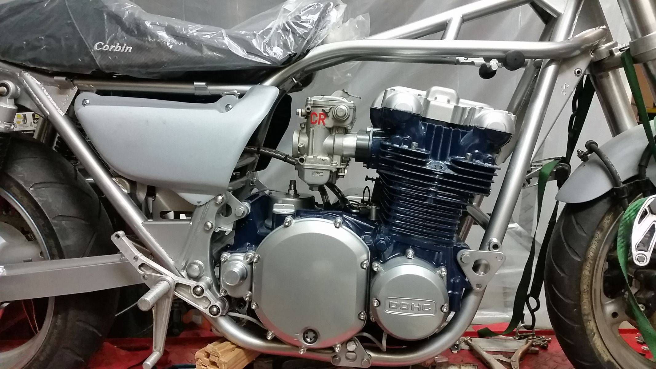

Thought I would post a sneak peek. Its just a rough in so I could get some measurements for my custom air intake.
Hope you guys like it, still need to clean the carbs up a bit.

03 Jan 2015 15:40Air box?

bike looking good...coming along.
what kind of rear sets are those?
and i would make some kind of bracket from carbs to frame so to hold the carbs straight. rubber boots over time hang with the heat of the engine and weight .

Re: Phoenix Fighter
03 Jan 2015 17:04 - 03 Jan 2015 17:05spdygon wrote: bike looking good...coming along.
Yes, that is what I had to do with my VM26s. This will be a different situation. The idea is to use the trapezoid shaped area ,between engine area and under seat area, to frame in a filter between to pieces of aluminum. The engine side will have 4 holes the with header pipe that goes to each carb inlet. The under seat side will be open but with mesh material to hold the filter element in place. So basically a intake header? Why? Why not? I don't have a an air box. The problem with pods is that the outside ones lean out the faster you go down the road. I figured if I have intake runners to the carbs I can ensure constant velocity to each carb.
As for the rear sets those are Les Holt prototypes. They work very well and look nice. Currently he has been away from his machining equipment so production is slow. He is a member here and you can send him a PM. Not sure how often he checks in these days. I talked to him via email before Christmas if he does not respond to PM let me send me a PM with your email address in it and I will forward him your contact info.
