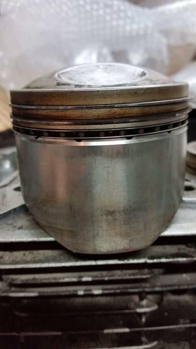

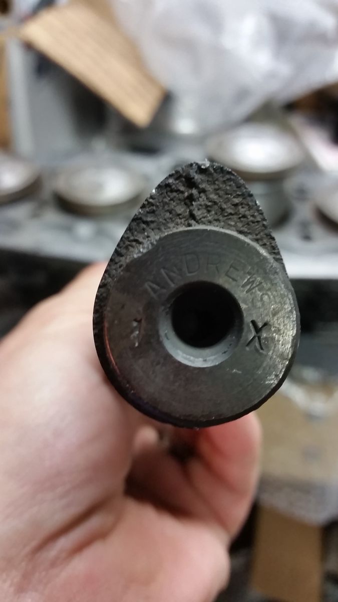

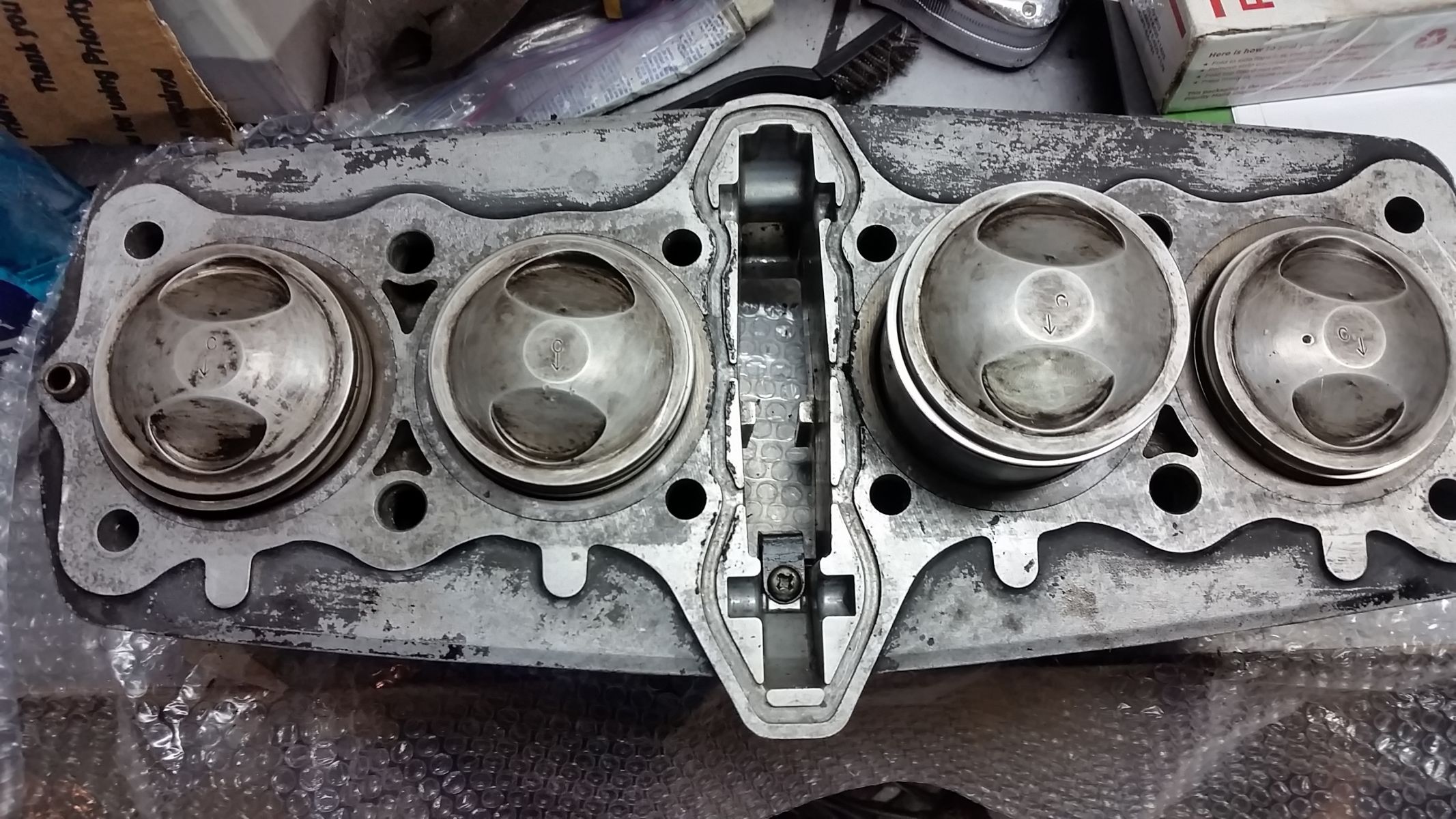

Merry Christmas to me. Bought a 1075 kit used off of eBay along with some Andrews 1X cams. Cylinder walls look good. I have not put a mic in them yet. The pistons are marked with the Wisco stamp on the bottom but there is nothing on top to tell me what the compression will be. I still think that they are 10.25s. Should I buy new rings or just check the gap on the ones that the pistons came with? The cams will need a tiny clean up were they sit in bearings but everything else is good. Do I need adjustable timing gears on them or let them ride the way they are?

Those look like the early cast pistons. I'll post some pics in the morning of the forged billet and cast pistons. By the look of them, they might be 10.5/1 or better. TTYL.

22 Dec 2014 21:06Thanks Steve, your a fountain of information. I believe you are right about them being cast, they look like it. They will work for now. I can upgrade them later if needed.swest wrote: Those look like the early cast pistons. I'll post some pics in the morning of the forged billet and cast pistons. By the look of them, they might be 10.5/1 or better. TTYL.

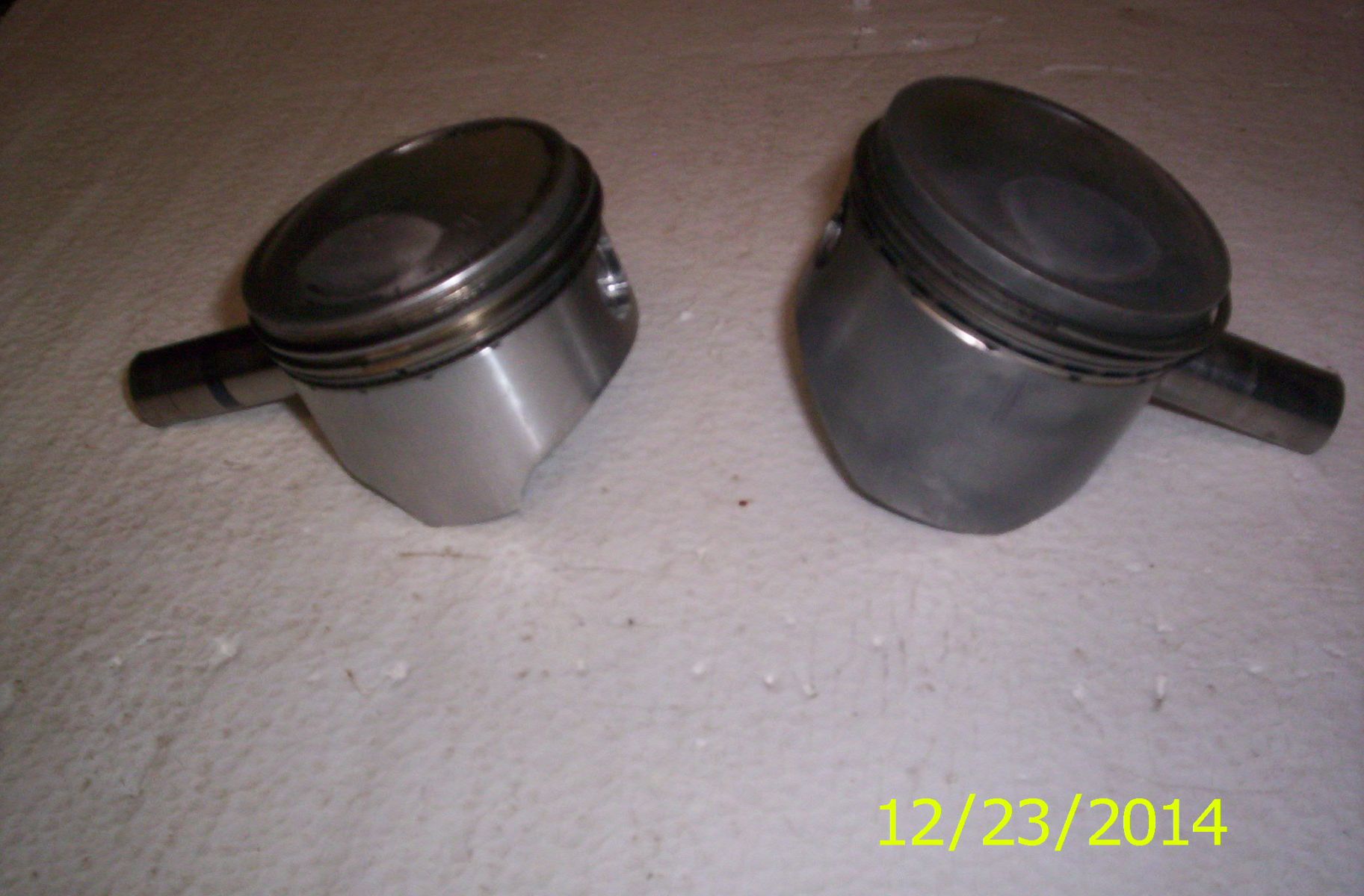

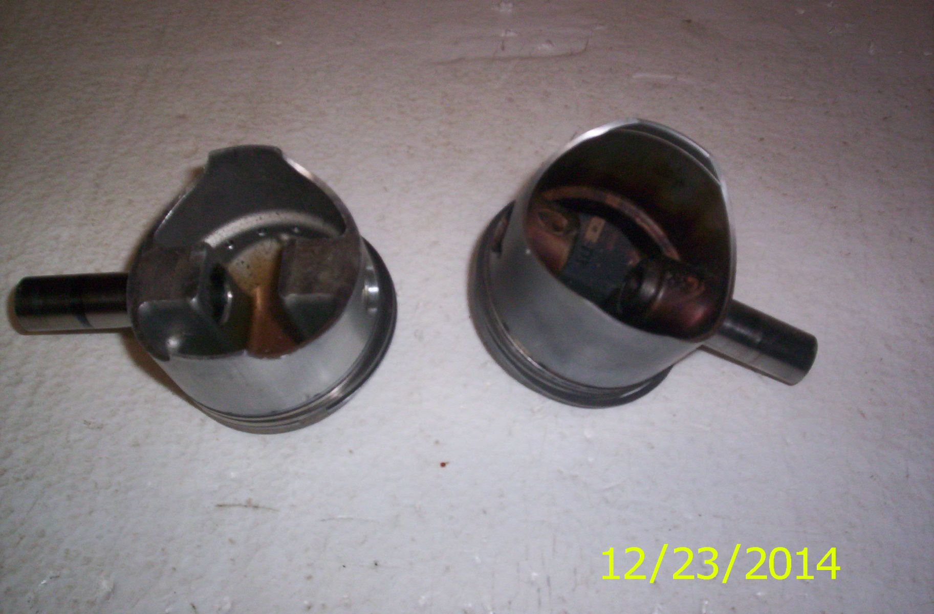

23 Dec 2014 06:48kaw-a-holic wrote:Thanks Steve, your a fountain of information. I believe you are right about them being cast, they look like it. They will work for now. I can upgrade them later if needed.swest wrote: Those look like the early cast pistons. I'll post some pics in the morning of the forged billet and cast pistons. By the look of them, they might be 10.5/1 or better. TTYL.
These are the Wiseco 10.25/1 pistons. The one on the left is the forged billet type and the other is a cast one. I know the rings are the same. I suggest checking with Z1 or wiseco to verify the compression. The rings for mine were $11 and change. I'd buy new rings and forget it. The cast piston was bought in 78. They just don't make them anymore so I had to but the billet ones at $125 a pop.
The following user(s) said Thank You: kaw-a-holic
Re: Phoenix Fighter
23 Dec 2014 07:00
You'll notice the billet pistons are lighter that the forged. That makes a big difference on vibration and some on rev. Kawasaki made the KZ 1000 crank heavier to compensate for the bore size and weight of the pistons. In theory the 900 crank should spin up faster on acceleration but the vibration is more as well. I have a Z2 750 crank so I was expecting even more acceleration. That hasn't been proven but I did notice less vibration with the billet pistons.

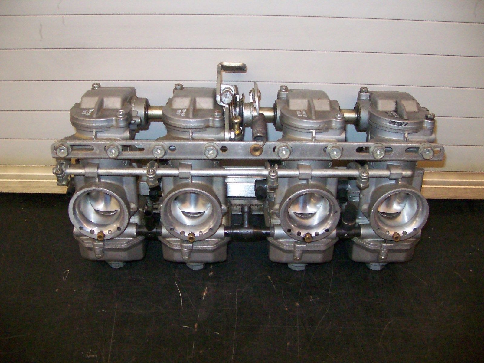

23 Dec 2014 08:13I don't know guys might think i'm crazy for buying them and not knowing but many people were submitten offer and I did not want to loose them so I bought them. I figured to scenerios, 1 they are 26s same as I have but still a better carb or 2 they are to big and I have to sell them. Either way I got them @ $450 which is close to half price. Guys on my Facebook forum seem to think they are 29s.531blackbanshee wrote: congrats on the cylinder and cam score.

They didn't say? I think they are bigger than that. Nice carbs.

Those are "drop in" cams. You can use the stock sprockets as long as the cam chain set up is the same.

23 Dec 2014 09:04no I think that is the only reason someone didn't beat me to them. I'm hoping for 29's or 31's.swest wrote: They didn't say? I think they are bigger than that. Nice carbs.
As for the cams, is there any benefit to adding adjustable timing gears?
