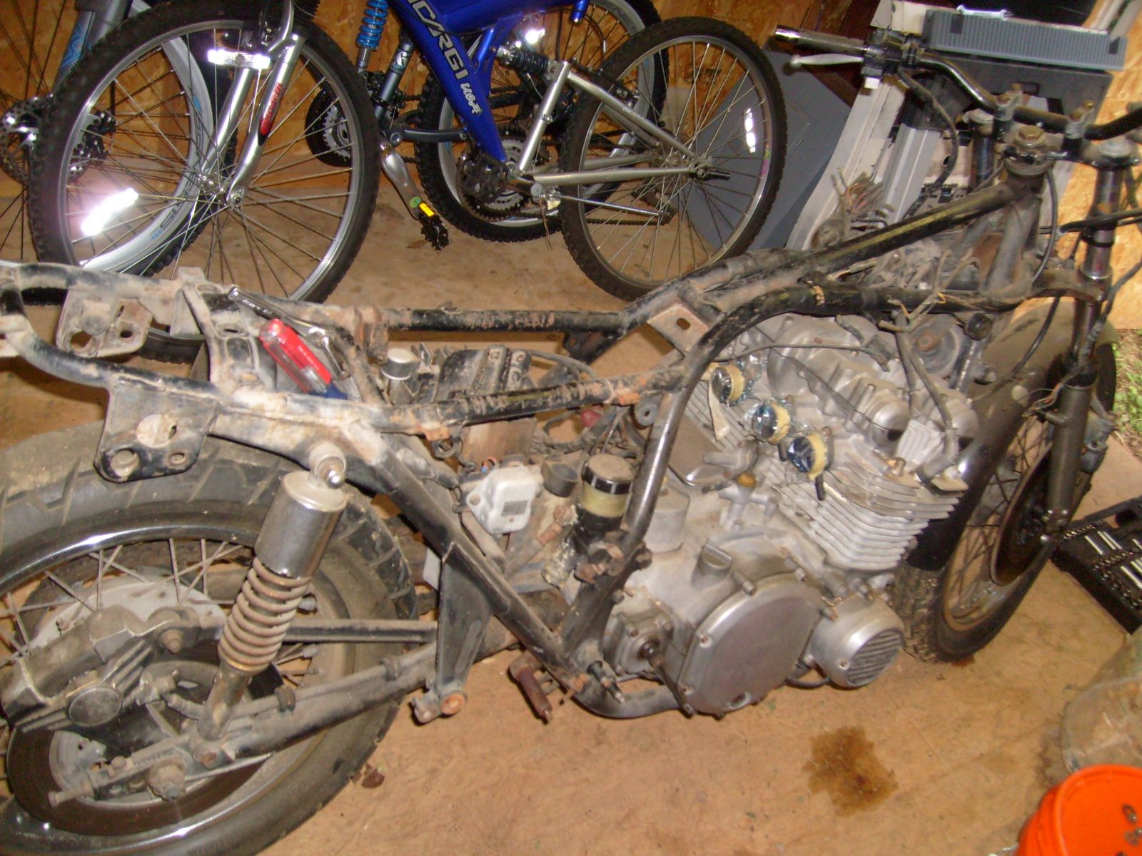

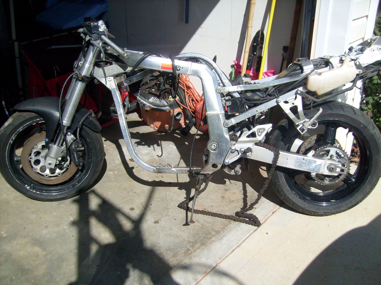

I had started a post over at Chassis section because I had questions. But now I have a 93 GSXR 1100 rolling chassis.
Will be swapping front and rear to my 1977 KZ1000A. GSXR Is apart now and started on the Kz.
Was hoping to do a bearing swap for the front end but found the
bottom bearing on the gsxr stem rusted weld to it.

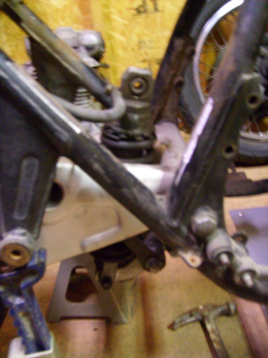

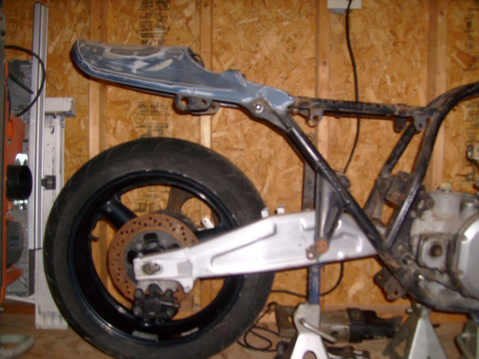

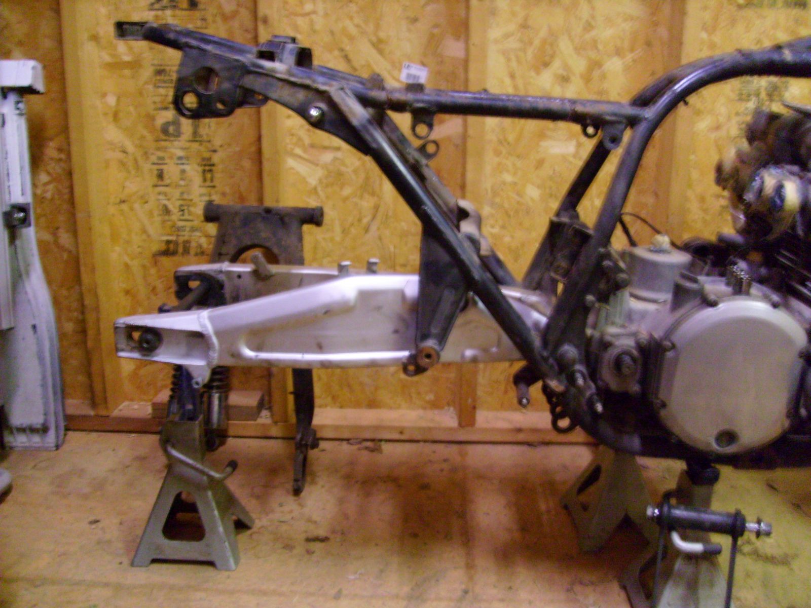

work a little on the bike.
banana style...is that what its called....3'' longer then stock
as you can see......arm,wheel,etc on
all I need now are the gs bushings and some washer to make up the free play
I need to gain about 3/16 in washers to center arm.
If anyone has some ideas please let me now.

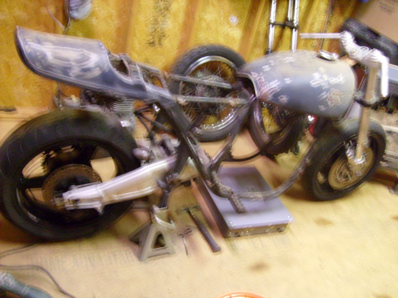

so work on the bike a little.......
pic of bike with rear installed and front end....waiting on the bearings
pic of the shock.......dont really like it.....going to see if a friend can weld some mounts for due shocks on the aluminum arm.
thanks everyone for the help
