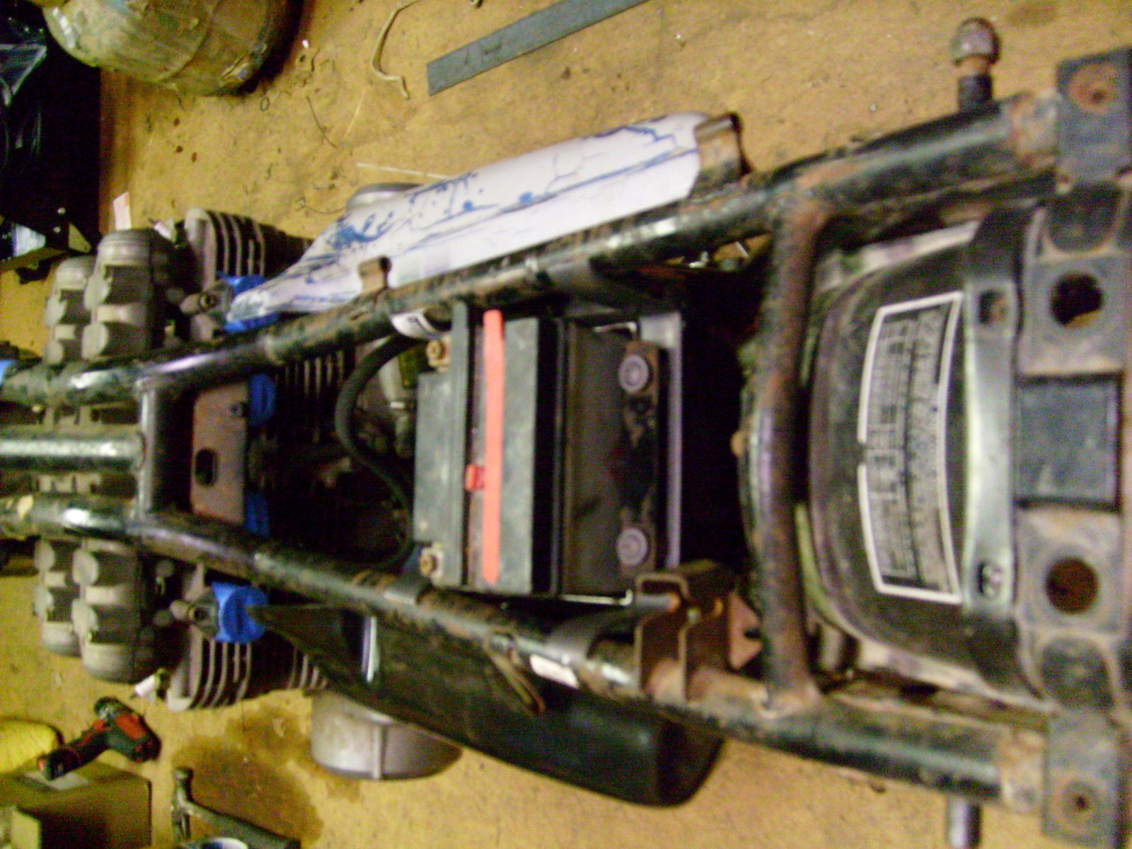

20 Dec 2013 15:16spdygon wrote: working on battery location since shock will be a mono shock.
so beside the original battery....is there any other that may be smaller in size?
Yes but they won't be cheap. "gel" batteries can be mounted in any position. Here is some info I found on them. www.batterystuff.com/kb/articles/battery...cles/gel-vs-agm.html
Hope this helps.
Jon

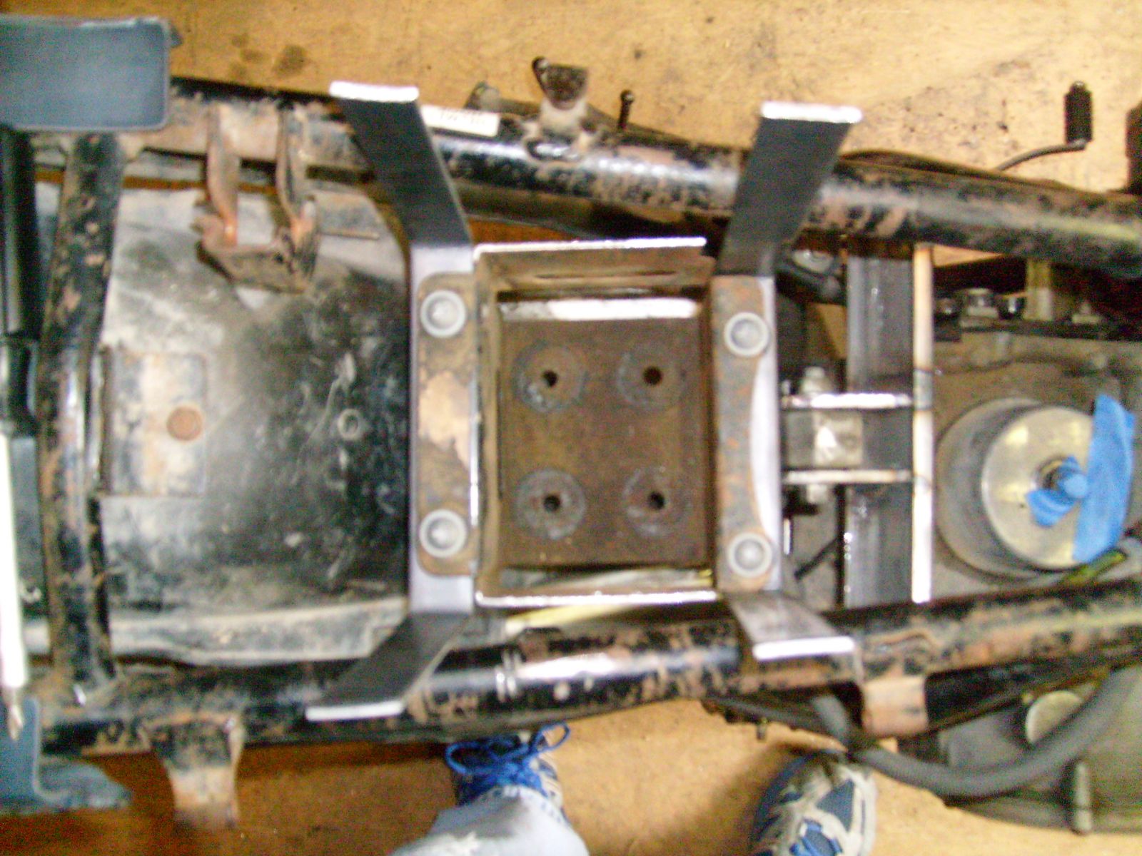

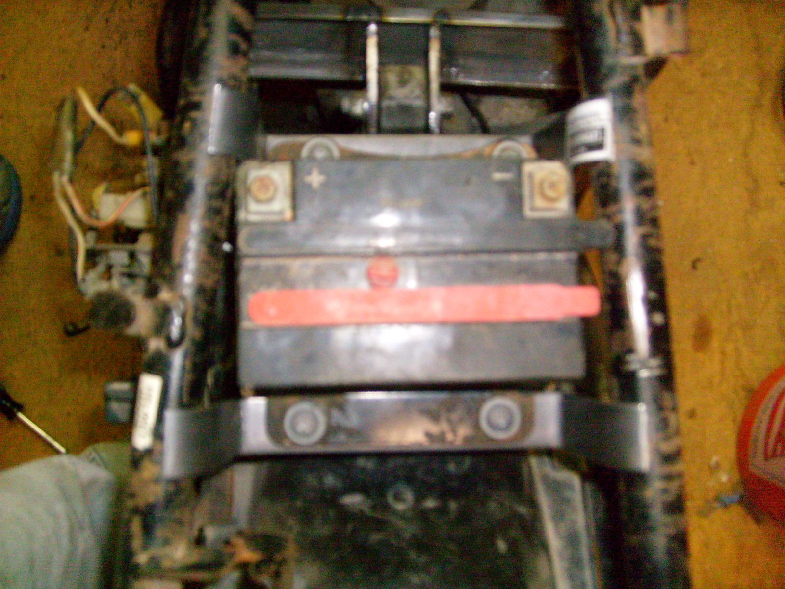

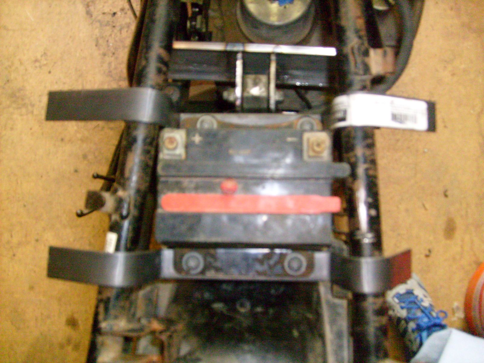

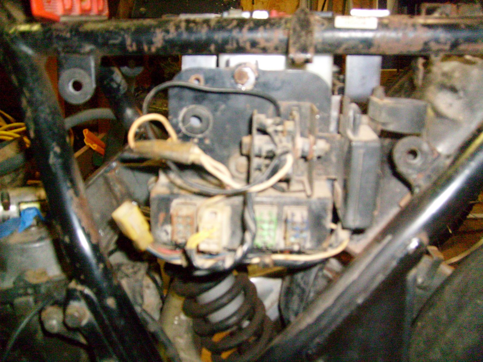

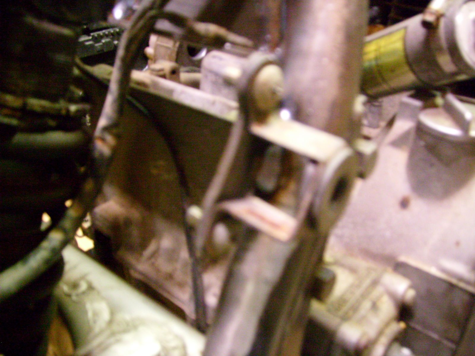

01 Feb 2014 19:06 - 01 Feb 2014 19:17on the one pic u can see were the battery bracket is only hanging from frame....im thinking of drilling throught bracket and frame so to bolt it and be able to remove......thoughts?
so better weather here.....go in the shed for several hours today.
so did flip the rear spocket and now i need a 1/2" front spocket....cool
also work on the battery location...done
