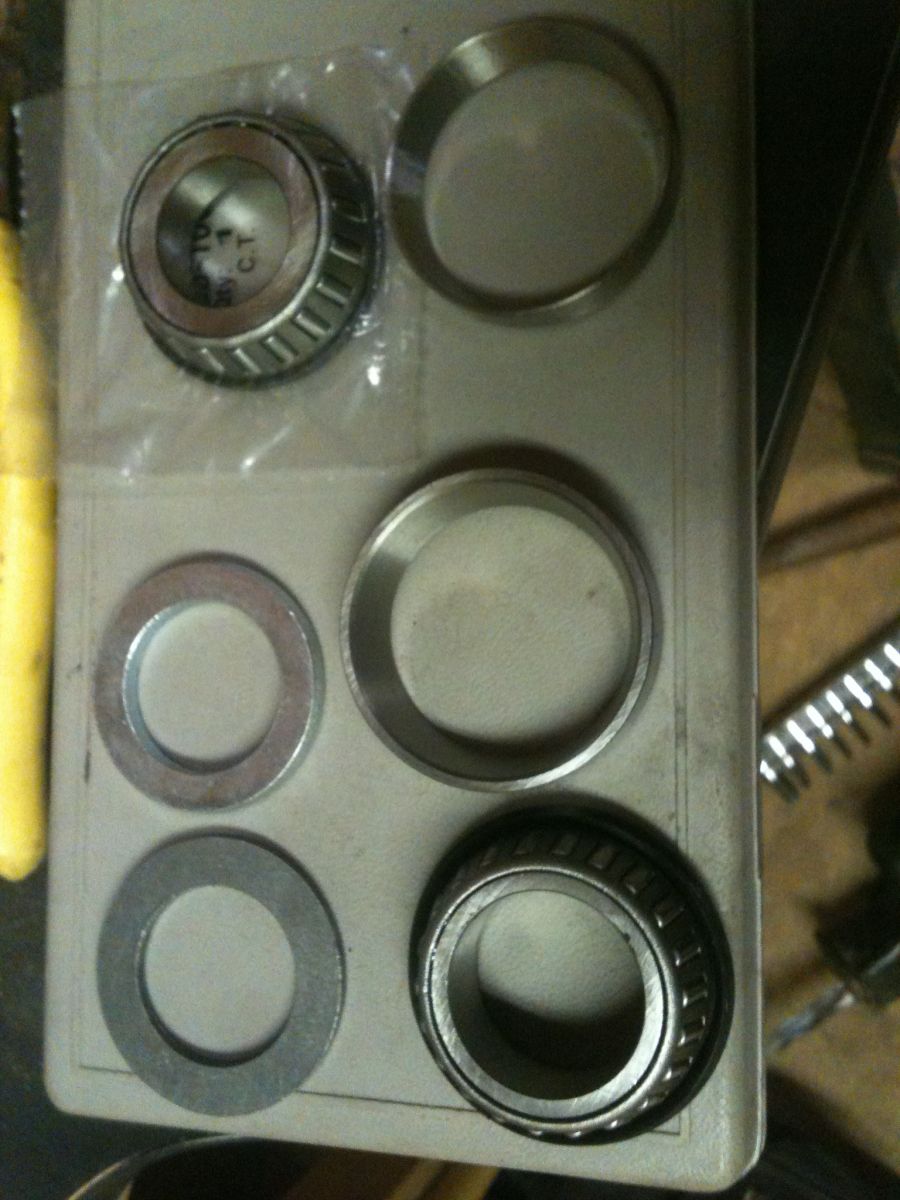

04 Dec 2013 17:15
So the Have not done much with the bike still need a welder.
But I have been buying parts....alot from z1enterprize.
Have anyone bout the footpeg from American classix? They are $269.00 if someone has them please show pics. Will they be able to connect to any rear master cylinder or just to the original KZ one?
Also how do I remove the bolts that hold the front foot peg on my kz1k?
Thx
Thx
