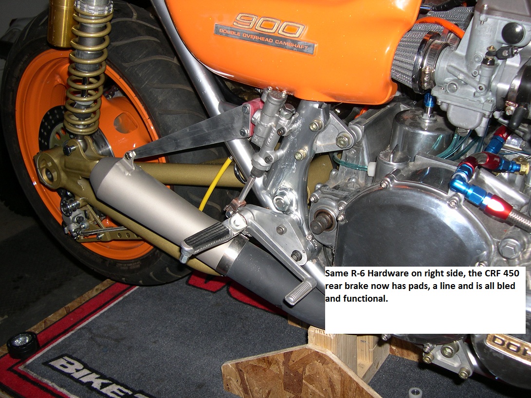

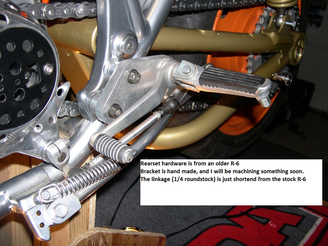

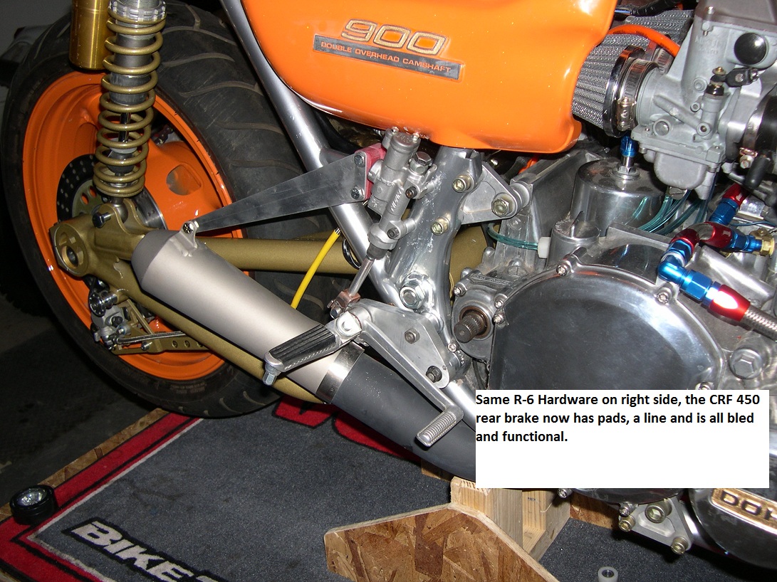

I built a set of rear-sets that mount directly to the KZ studs. I used 1/2 inch aluminum plate. the are not pretty (yet). but will be satisfactory
. There is some stuff about them on my page:

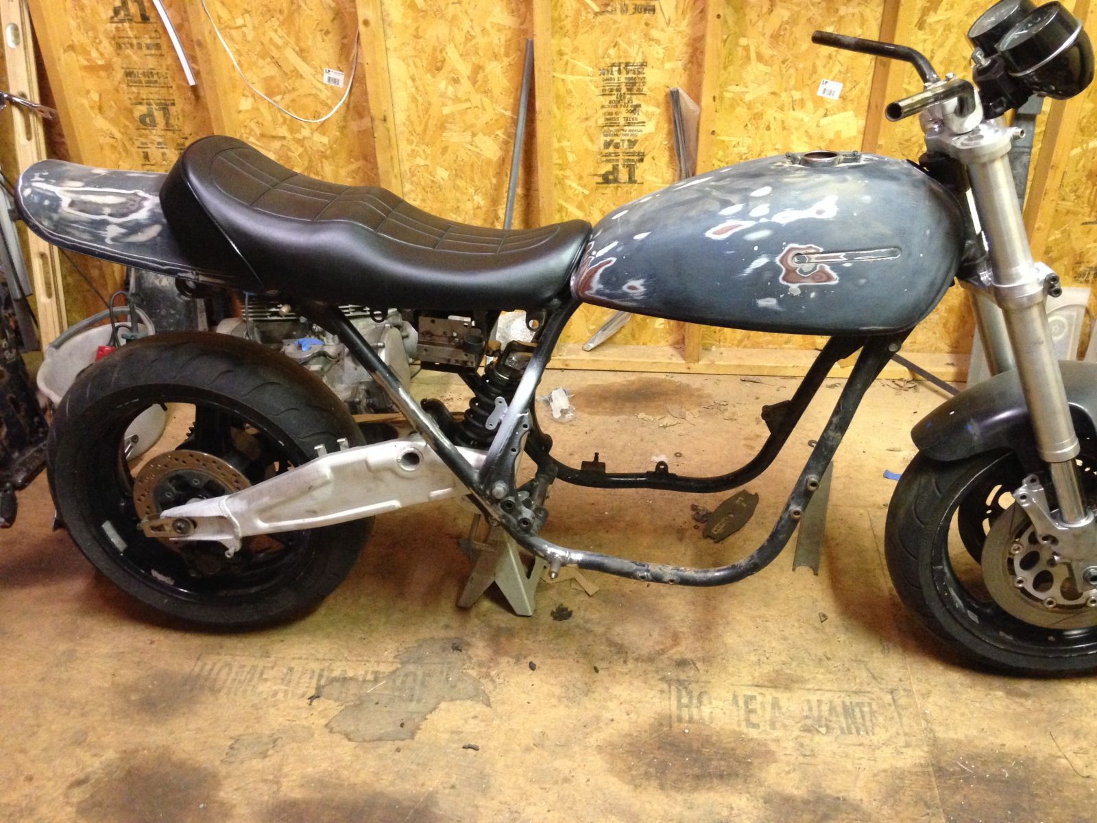

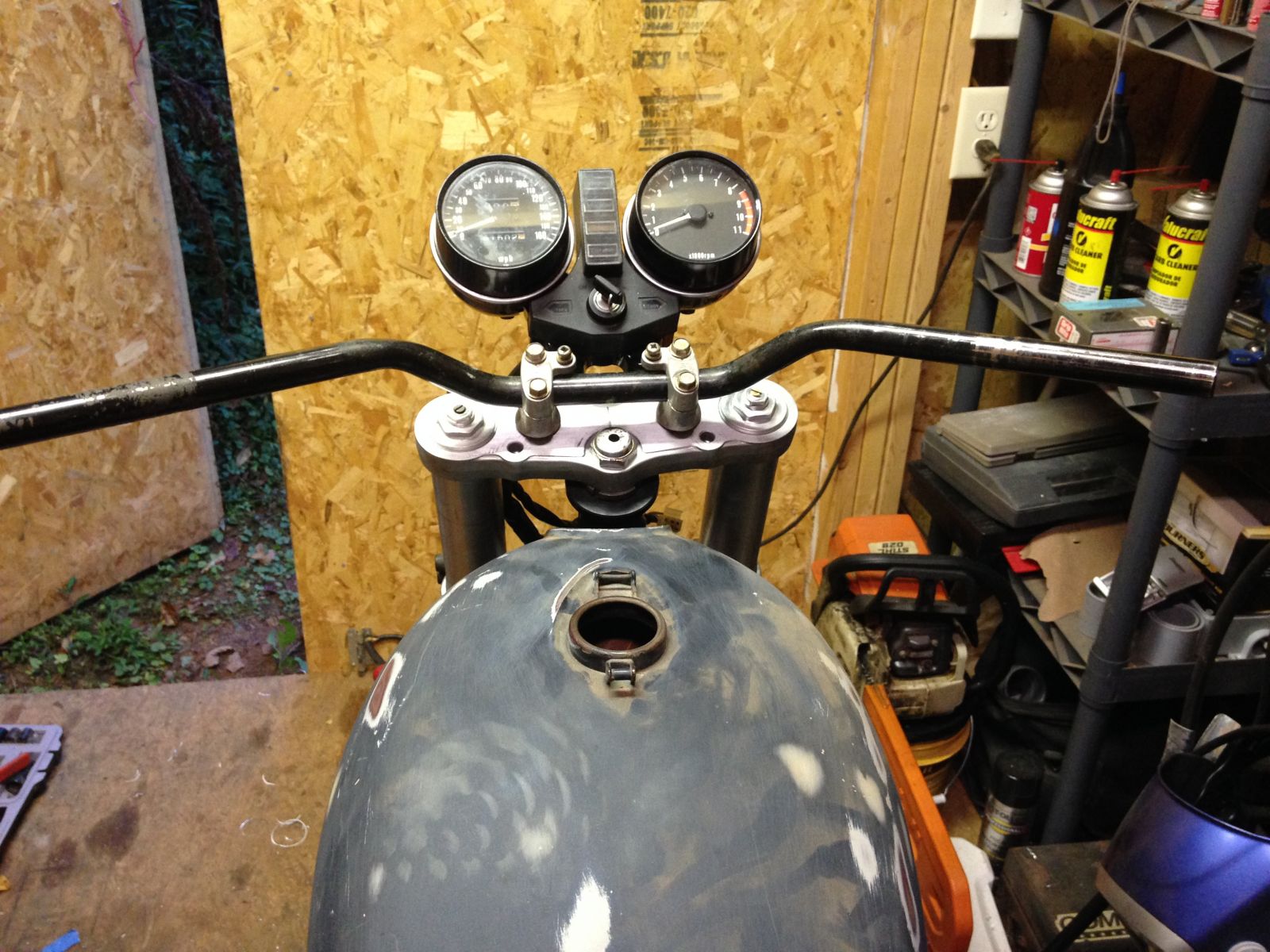

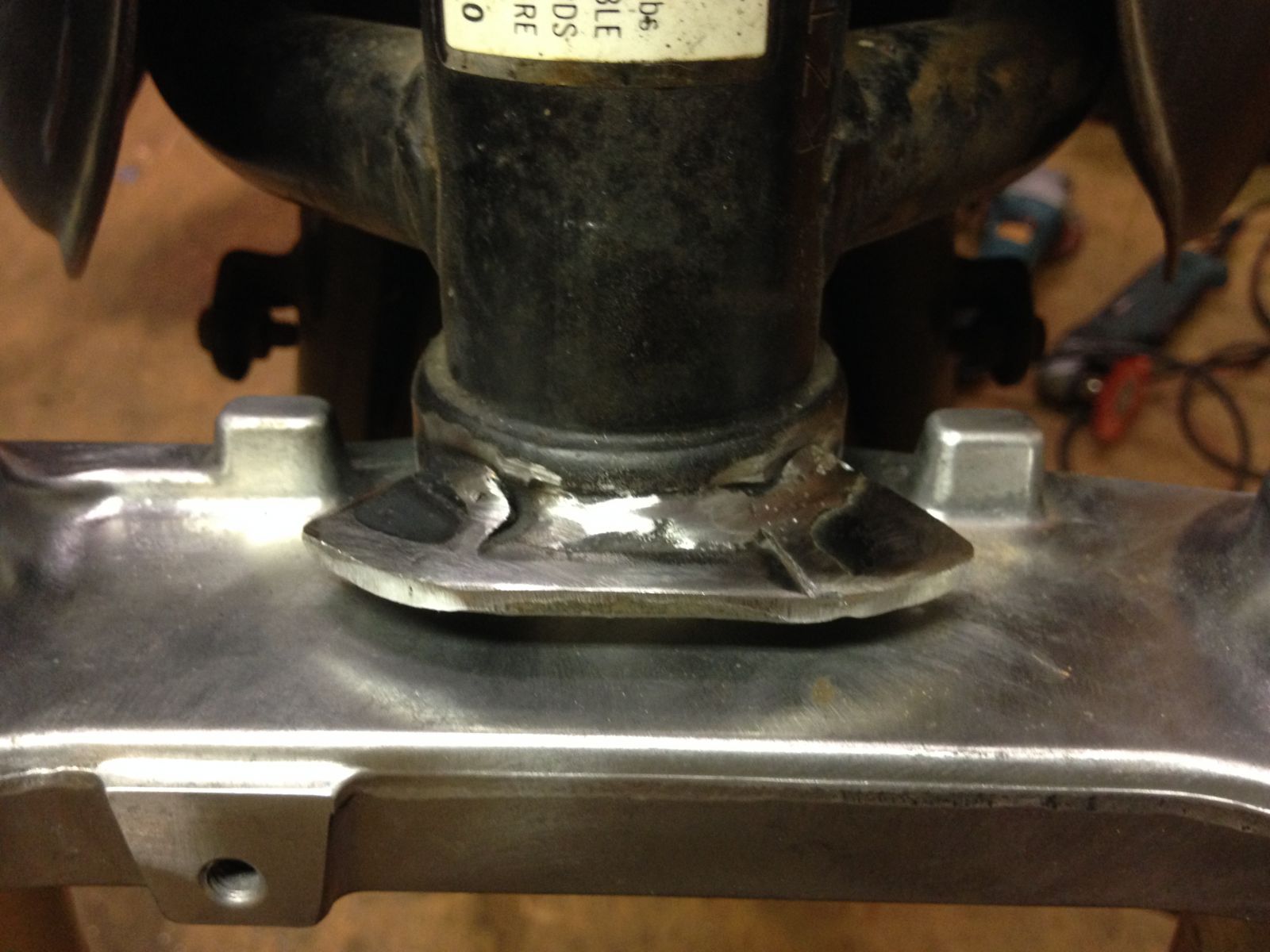

few pics of where im at with my bike....
ditch the clip on for the regular bars
fork stop welded
i still need ideas on passengers rear pegs...had to cut off originals due to rust damage
fork stop welded

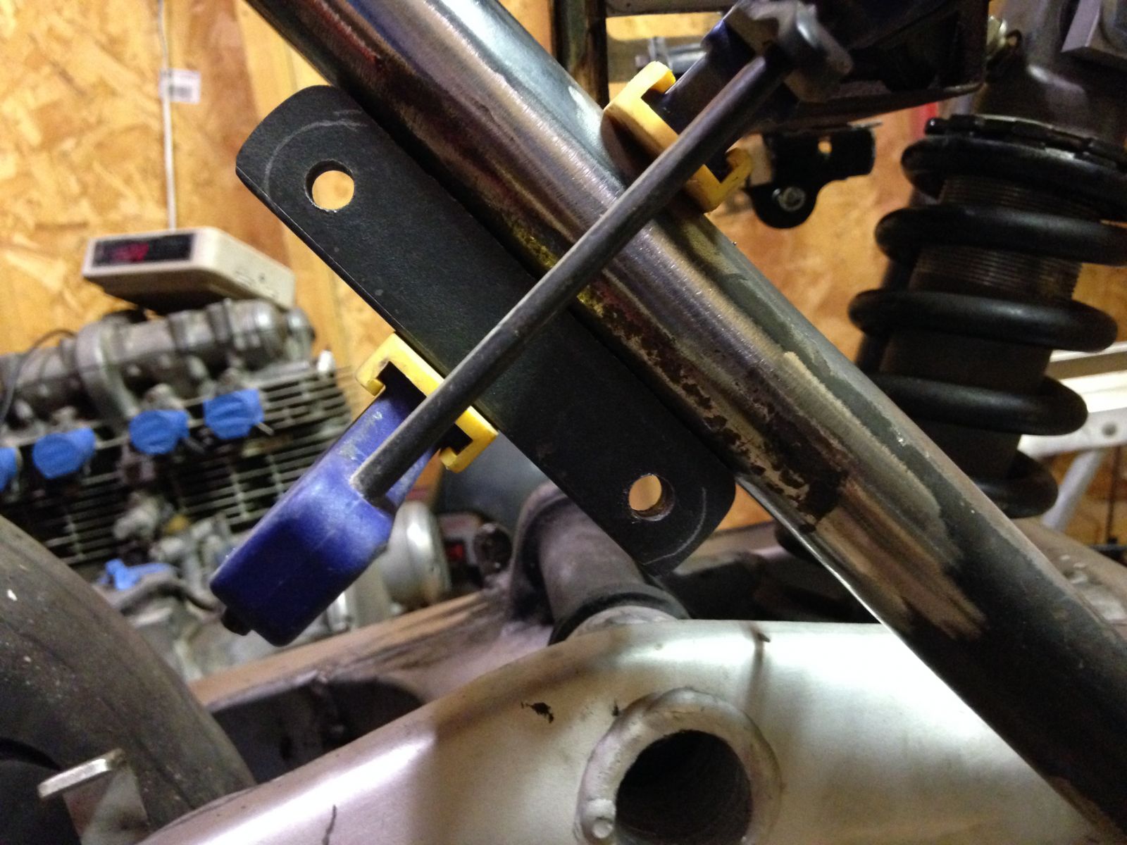

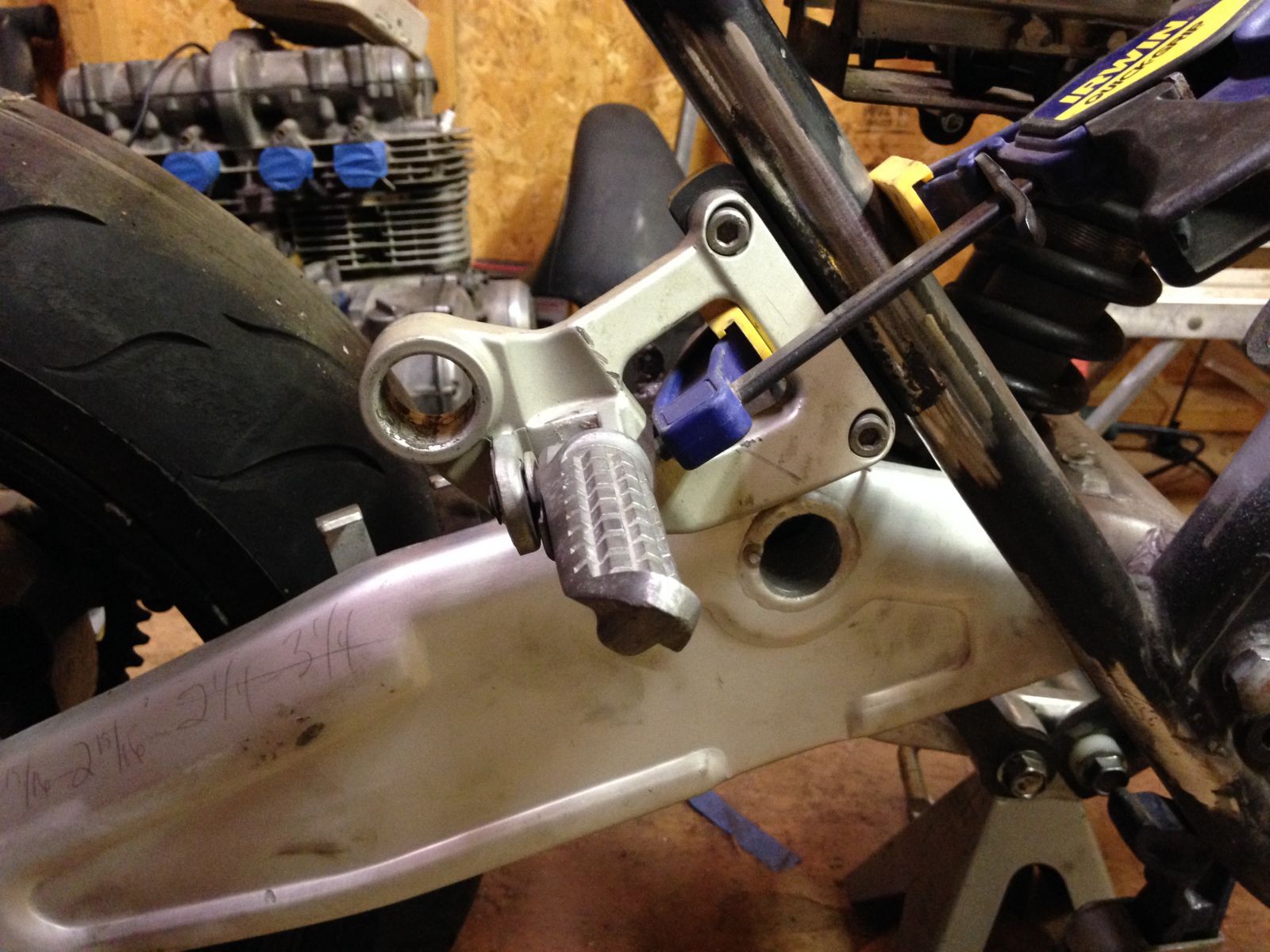

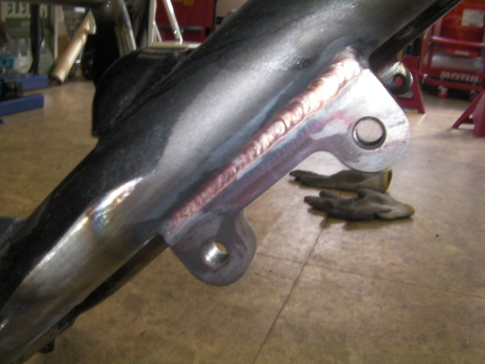

well...finally decided on the passanger pegs....93-97 zx6
need advice on the weld....would like to make one complete weld from one end to the other.
can i do that without worry of the frame bending out of shape?

- Posts: 7442
Re: Another modern swap
26 Aug 2014 06:05
i would tack it in four places.
each end both sides and then sew it up .
you shouldn't have any problem.
- kaw-a-holic
- Posts: 1808
- Thanks: 249
26 Aug 2014 09:50
Correct me if I'm wrong here Leon. You always run the risk of having a crack next to the weld if it is MIG welded in due to the heat the MIG uses. Typically, it would depend on the amount of stress in the area of the weld. I MIG a few tabs here and there where I know that the stress/vibration will not effect them. Sooo, for a frame brace kit I would say no, for your application, could go either way.
