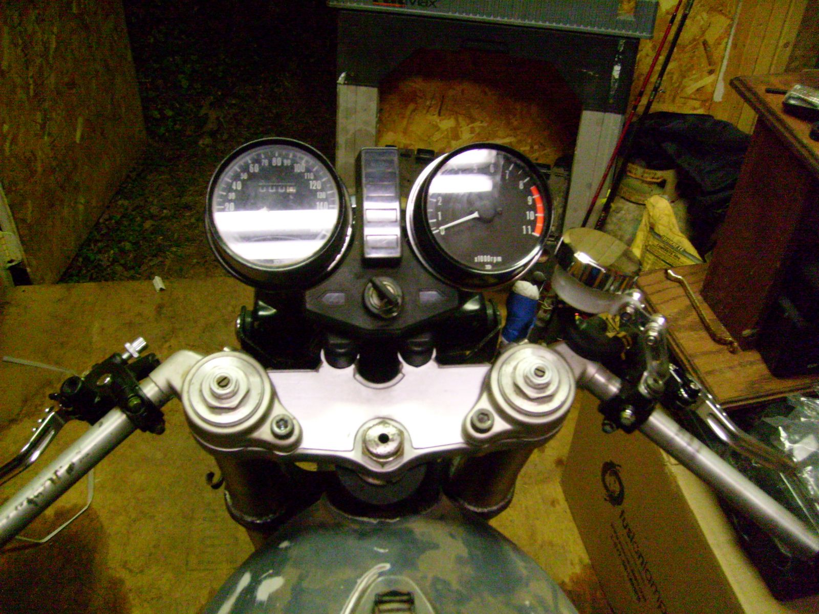

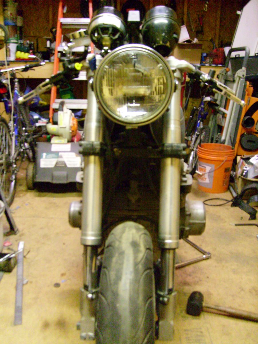

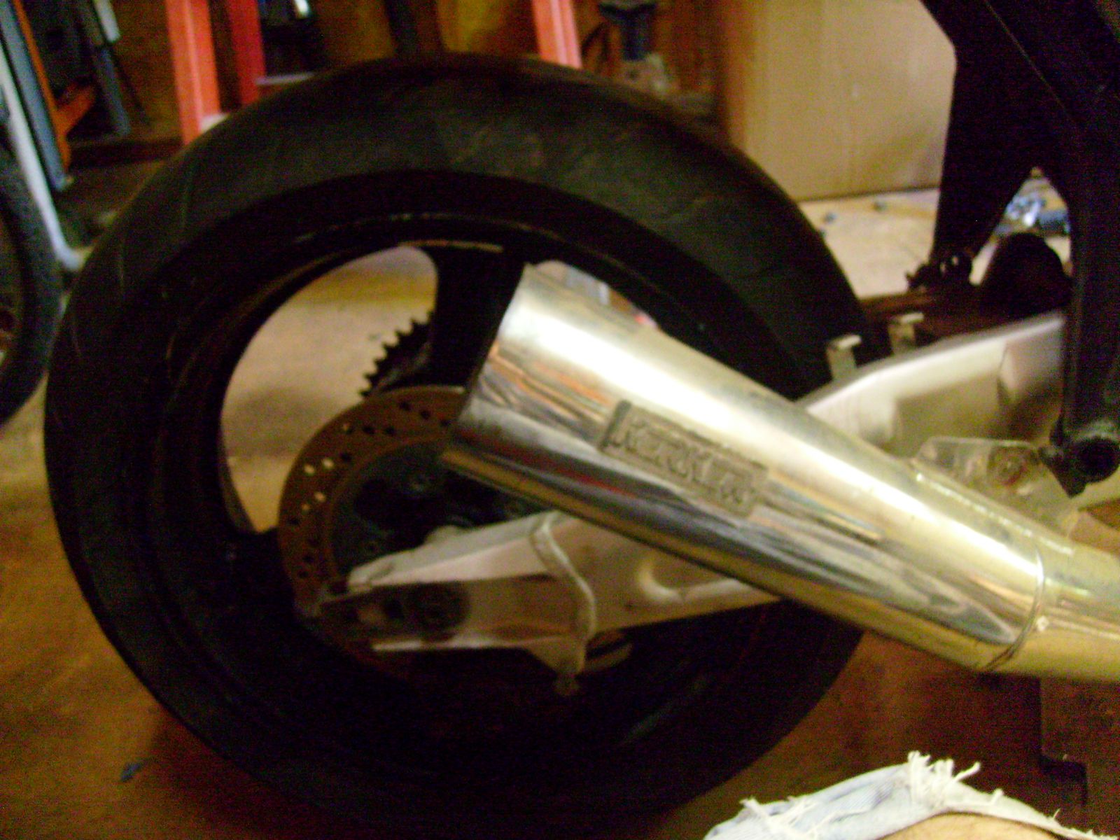

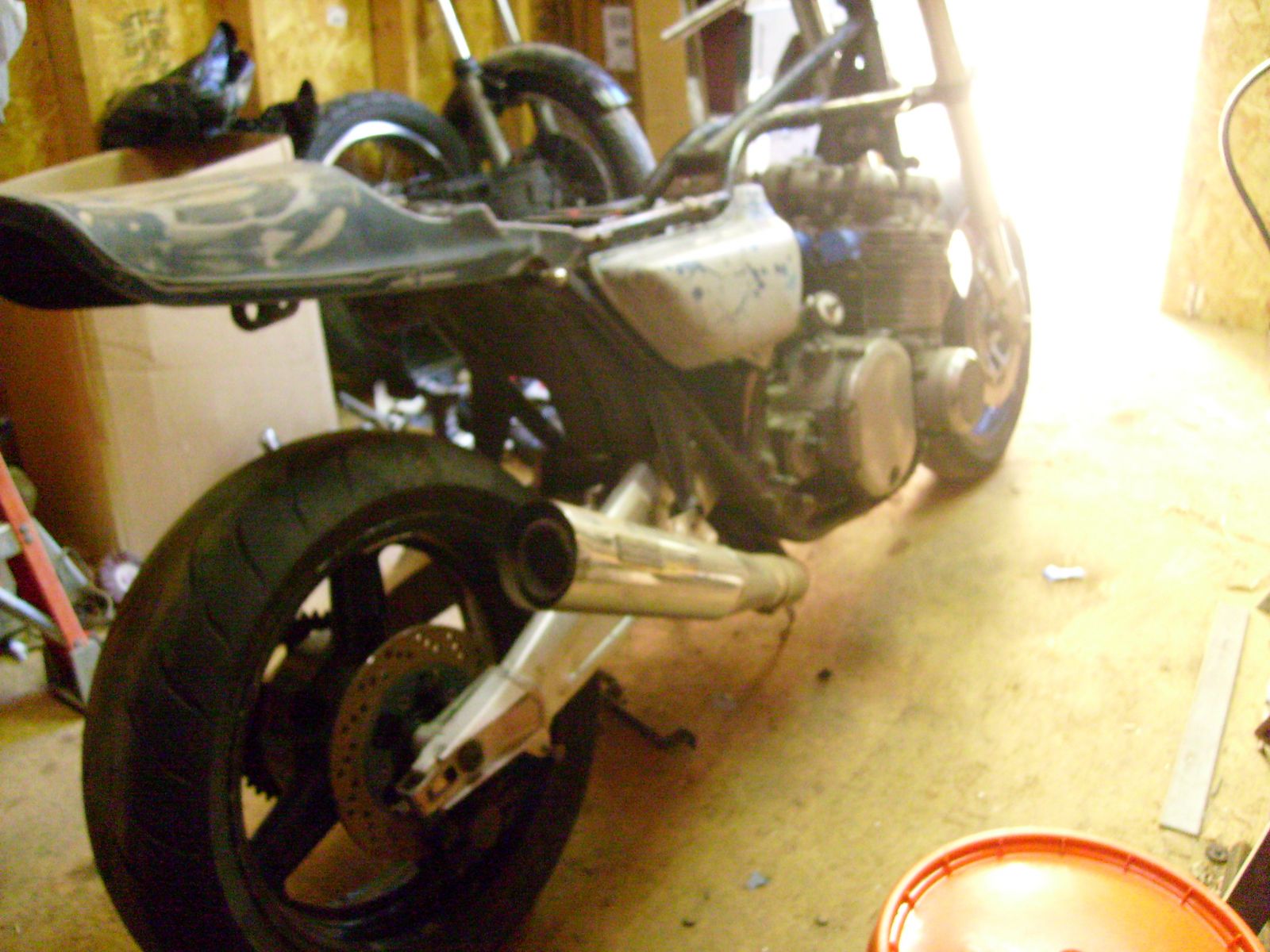

so its time to post some pics.....
got the top triple from Leon today so i did what everyone would do...install it

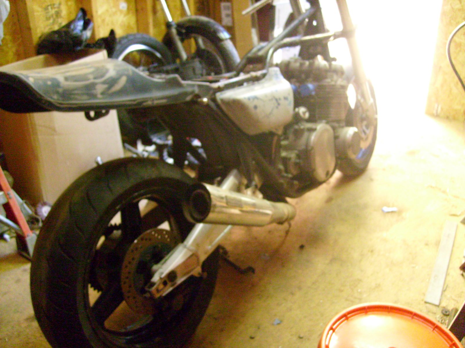

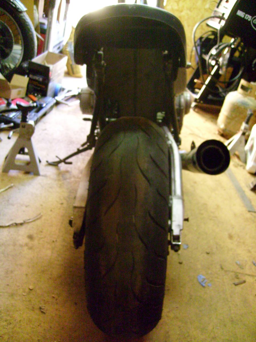

pic of the exhaust
and as for the front sprocket...i got a 5/8 offset and had a friend cut it down to 1/2" now i need about 10 links of 530 chain to do a test fit.
next up is make sure all will button up......dry fit...move and start on painting.
till then
pic of the exhaust
till then

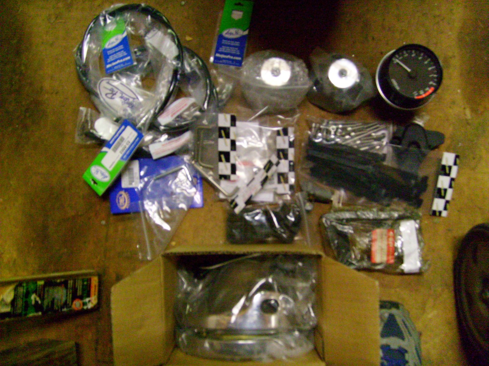

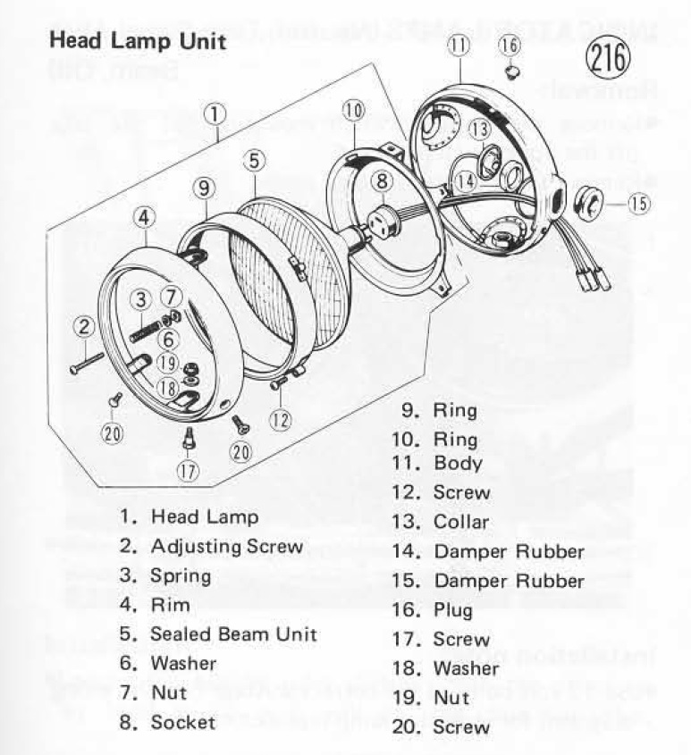

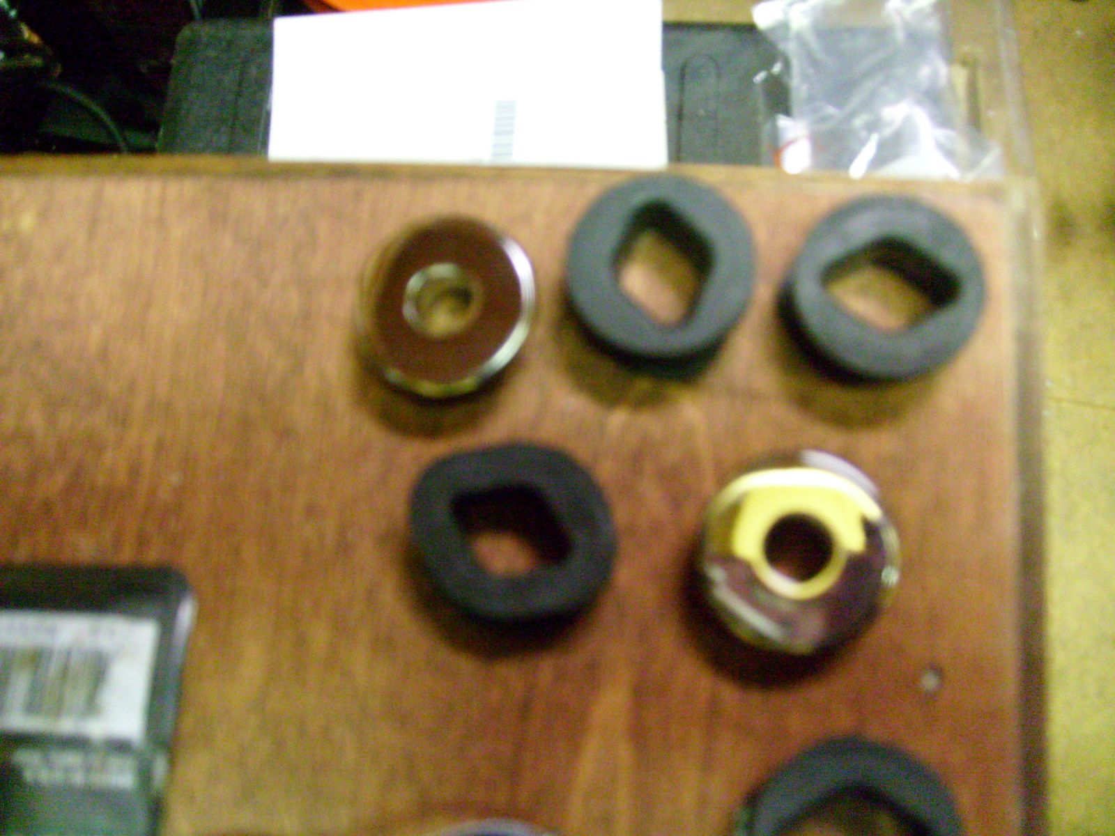

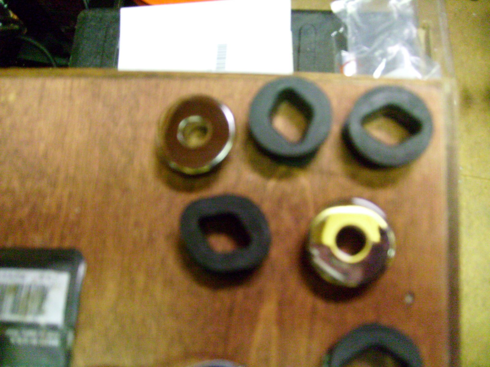

more pics with questions...
parts list

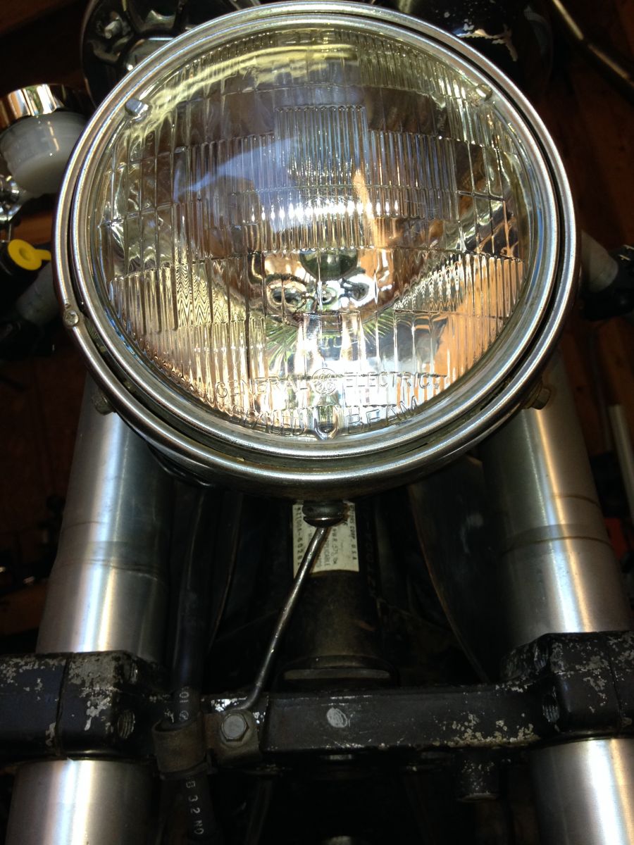

parts for head light....do not know where all parts go...can someone show a pic of the head lightwith no light bulb.
parts list

- Posts: 18564
- Thanks: 2103
Re: Another modern swap
25 Feb 2014 18:57 - 25 Feb 2014 18:57
Here's a link to download the FSM provided in KZR's filebase:
www.kzrider.com/filebase/search/finish/1...asaki-service-manual
Check out page 57.
Check out page 57.
Last edit: 25 Feb 2014 18:57 by Patton.

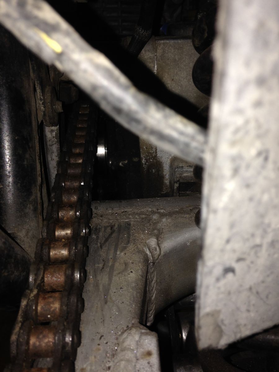

ok......so got the chain line up 1/2" offset and flip the rear sprocket.....but now the front sprocket cover hits the chain.
whats being done to avoid the chain heating the cover.
i have found some members make custom covers but really would like to avoid that as it will take me for ever to come up with one.
i will load a pic later
Help
26 Feb 2014 16:39
pic of the cover hitting the chain......in the pic u can see the alumimun from the cover between the frame and the chain....sprocket is not hitting the inside of cover i check.

- Posts: 7442
27 Feb 2014 06:33
if it is just the rear lip of the cover you can grind,mill,sand it out of the way.
if it is more you may want to look into some more severe modifications :evil: .
