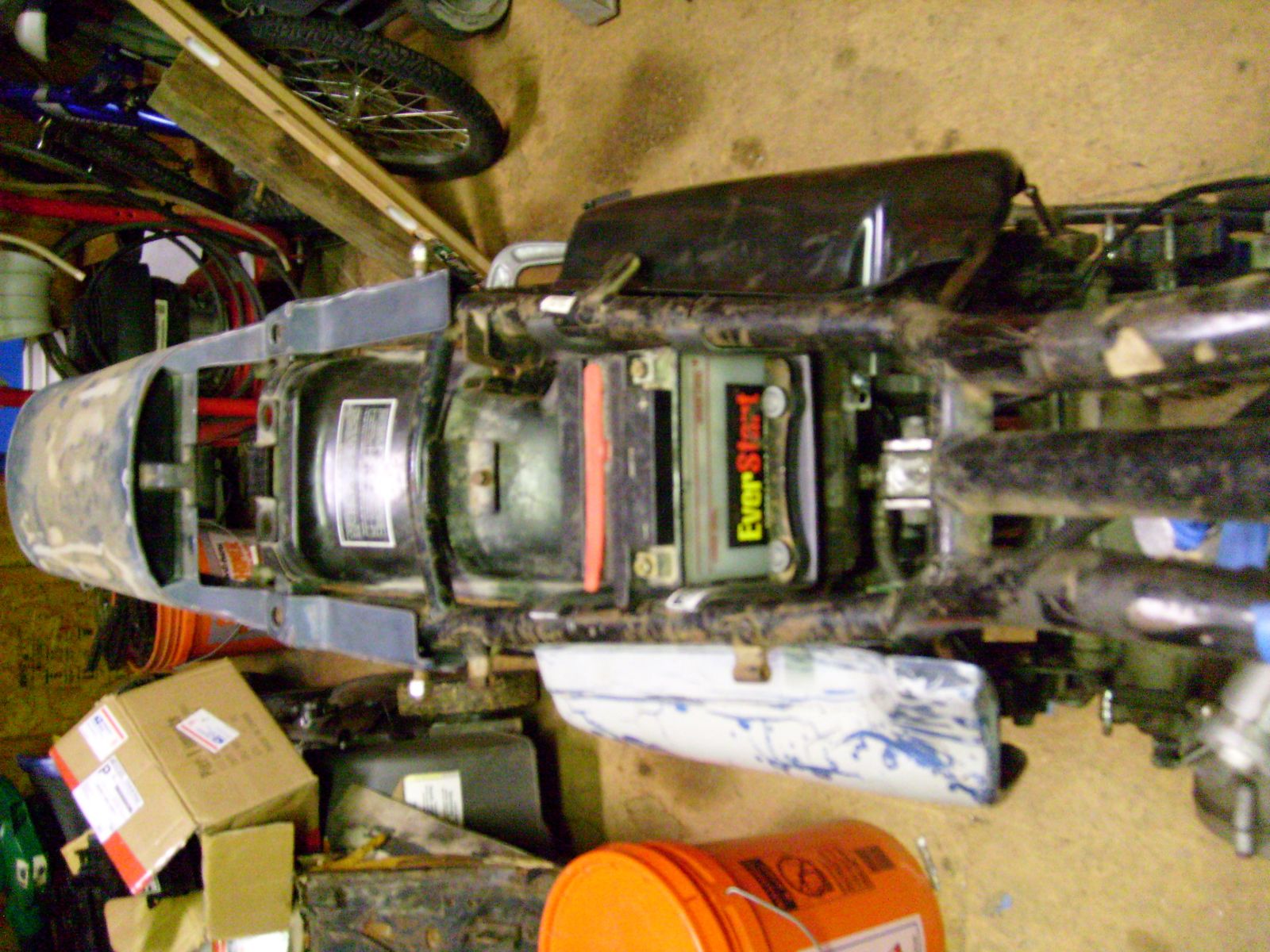

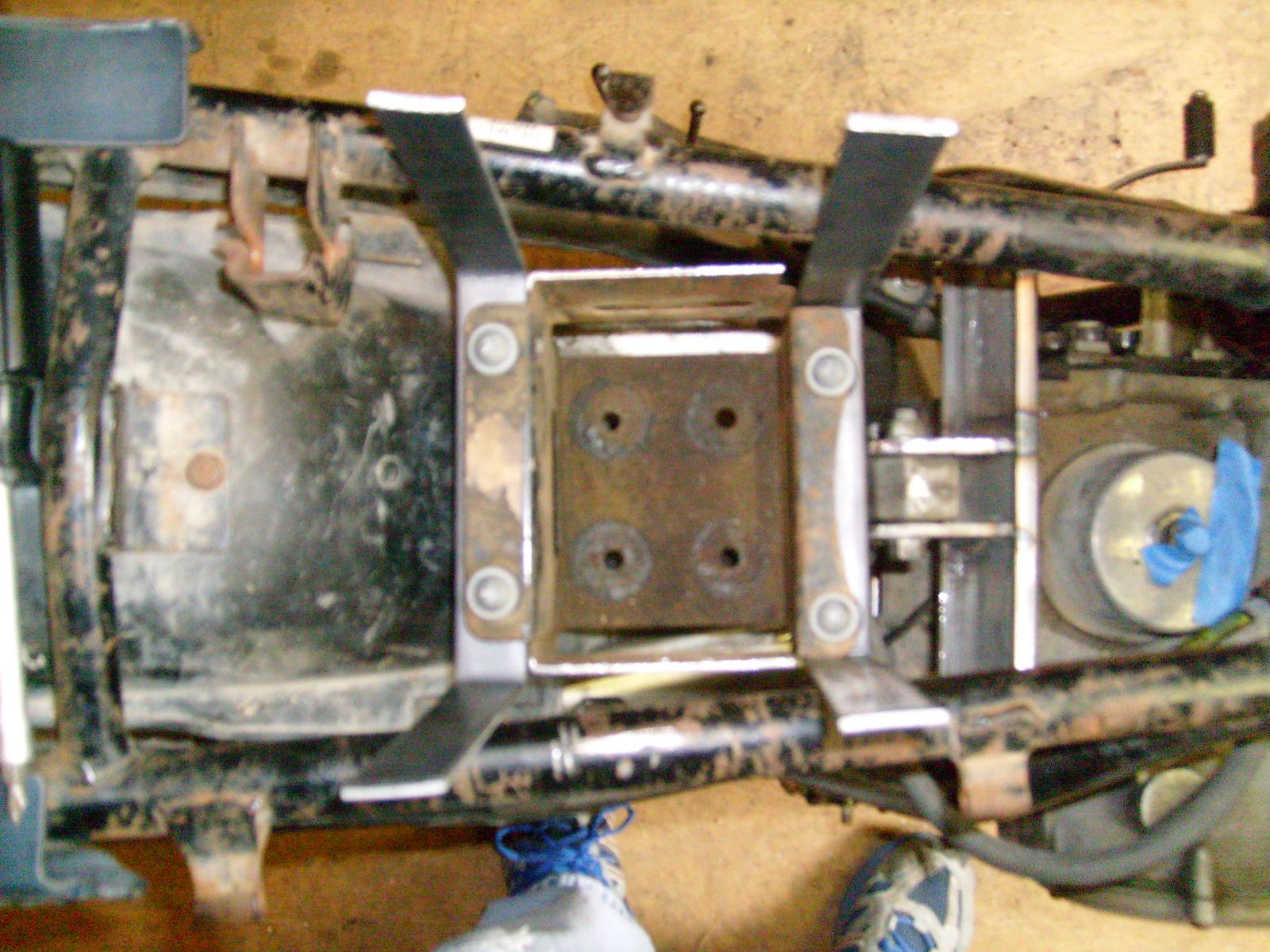

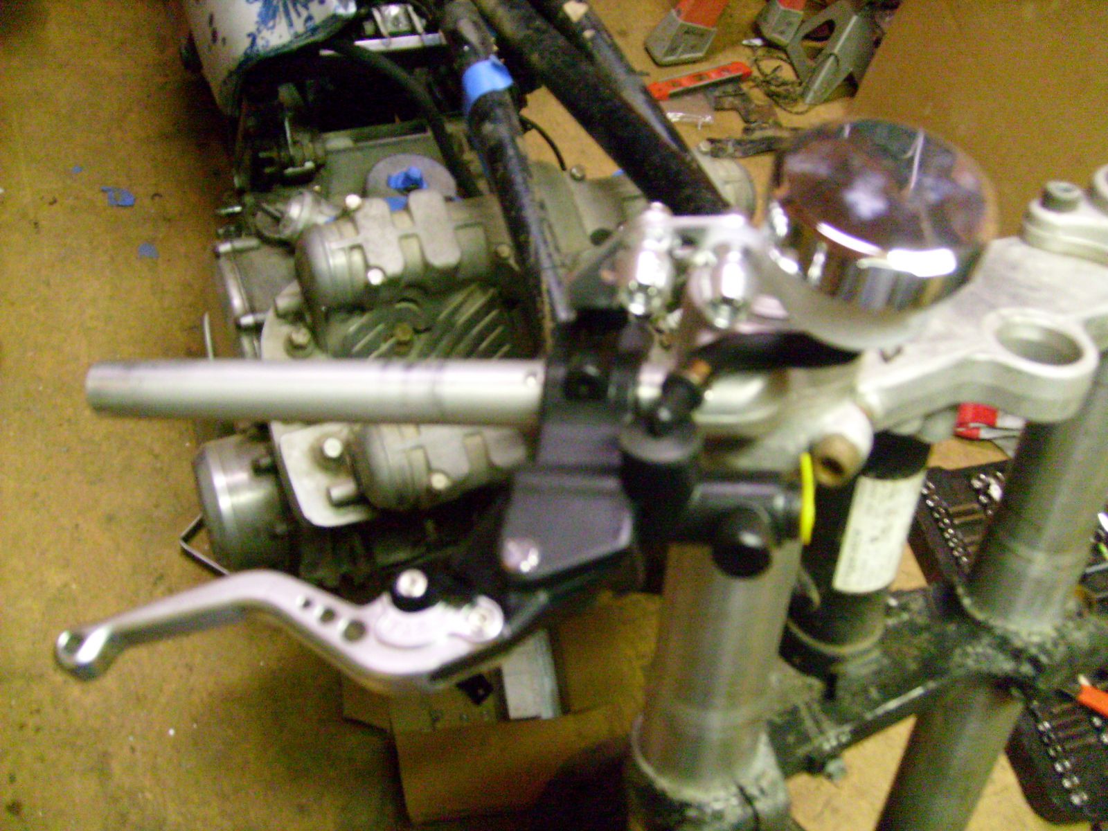

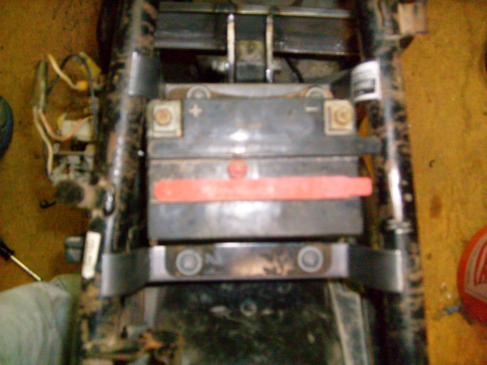

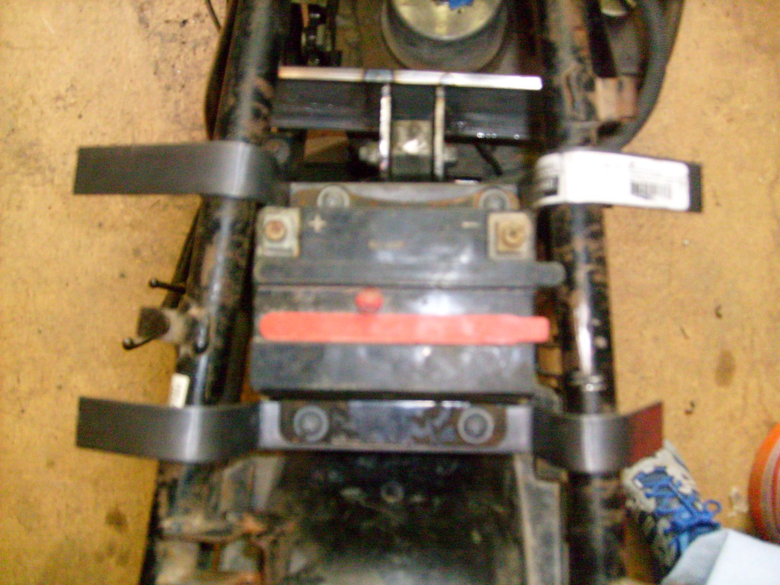

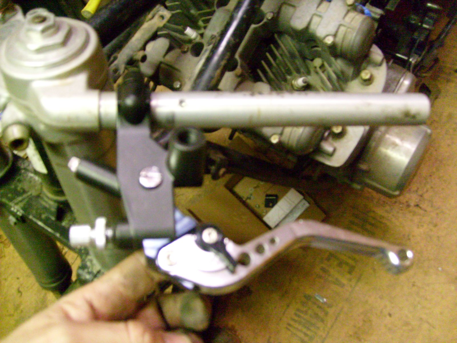

second take.......
work on the battery mount.
pis of finish mount with electrical components mounted
front brake master , lever and left side lever from china....cnc cut nice componenets will see how they hold up
