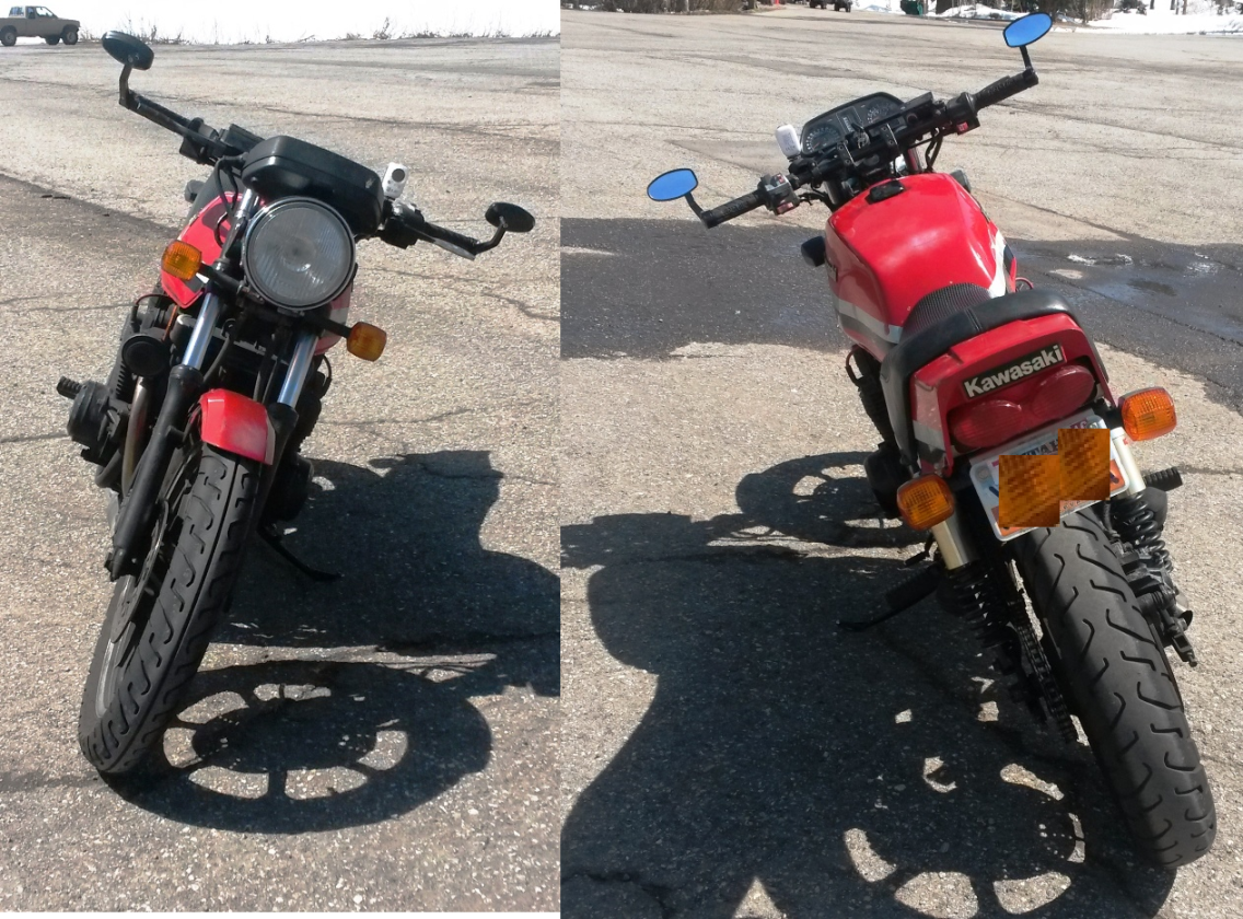

So since the look of the bike has changed a little with the shorter headlight stems and the mini windshield over the light, I figured it was time to update some pictures. That windshield makes a huge difference, even being just a 7". I also changed the ride height of the rear suspension around a bit (lifted) to clear my collector from meeting the highway so much. Adjustable dog bones make this nice and easy
With the more aggressive steering angle, she eats corners even more now, and is really responsive in that sense.

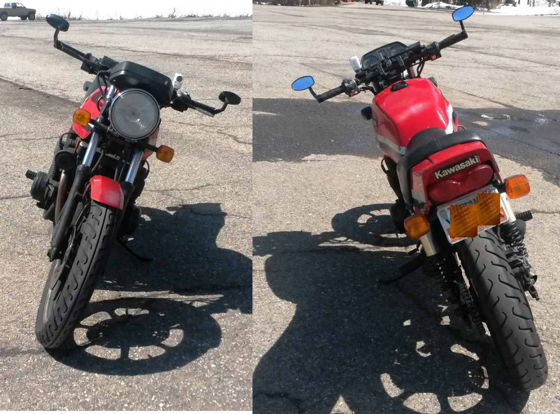

These are the mirrors I have.
www.amazon.com/gp/product/B0083SL82A?psc...i_detailpage_o02_s00
I see them on ebay all the time too.
The reason I first got them was because I'm so tall and broad shouldered, my shoulder armor doesn't help any, about the only thing I could see with original mirrors while I was riding was my upper arms and shoulders. I was constantly surprised by drivers coming up to close then pulling around me. Once I got them installed i realized that it was much quieter and my helmet wasn't acting like an ultrasonic cleaner for my head. Not to mention that they are about 6" further out on each side and I can more easily see anyone trying to get up close and personal. Now that I've changed over to drag bars there is no way i could see anything with the factory mirrors. The only thing I wish is that they were just tiny bit taller, otherwise I've been more than happy with them.
I'm going to be modifying them a bit soon. I'm going to be replacing the rubber inserts that retain them in the bars to split bushings since I'm going to mount a second set of dual element signals on the stems. This will help keep them from sagging down with the additional weight and allow me to cut a pathway for the wires that wont crush them.
