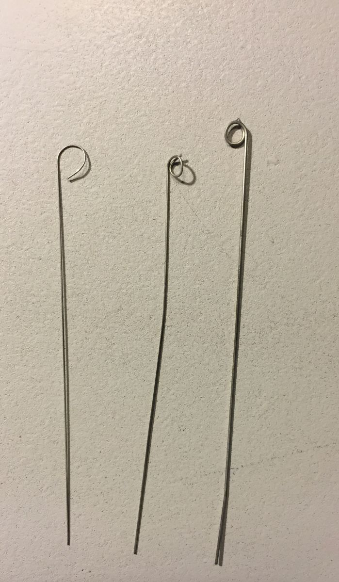

Did you push the little .009", .012" and .016: diameter wires through the relevant passage ways? If not, you have not cleaned the carbs...
To be honest, I don't care what any naysayers have to comment on... if you have not rodded the passage ways in these old carbs, especially if they have been sitting for months to years with gas.... you will regret it.
LOL!!
My tools below:
www.kzrider.com/media/kunena/attachments/4138/Carbwire.jpg
My tools below:
