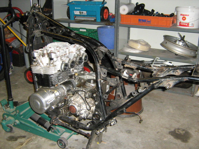

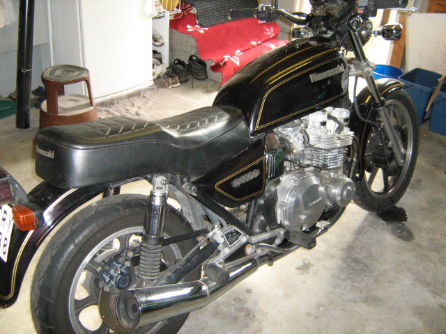

The victim:

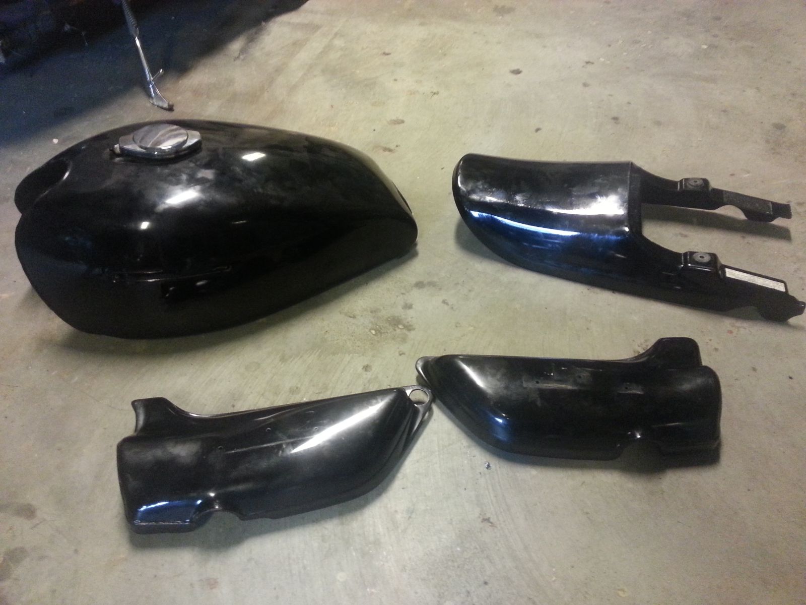

Parts to use:

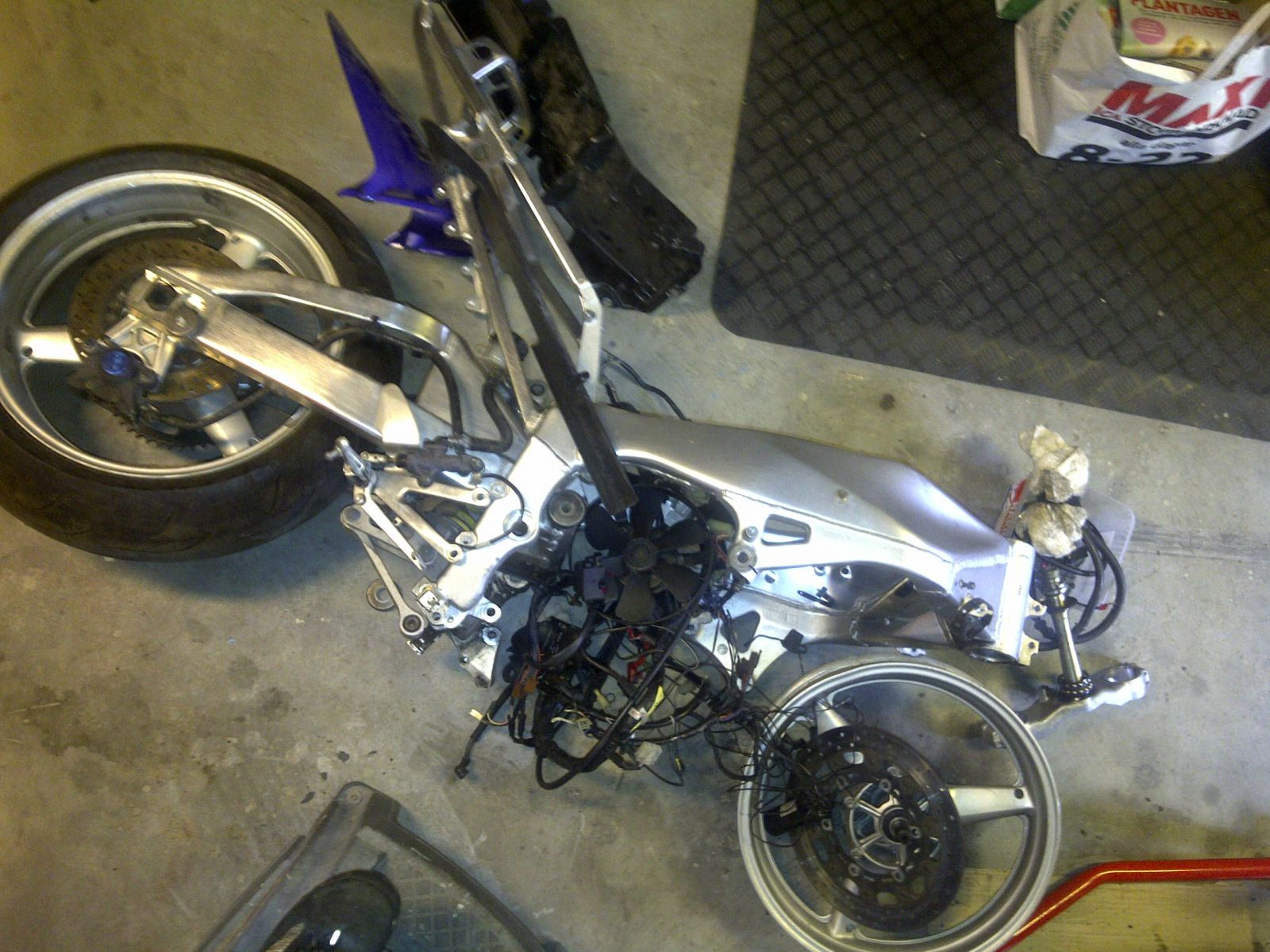

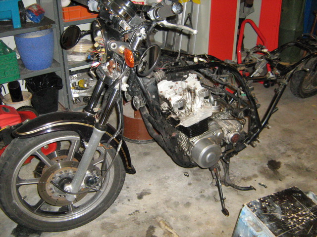

The tear down:

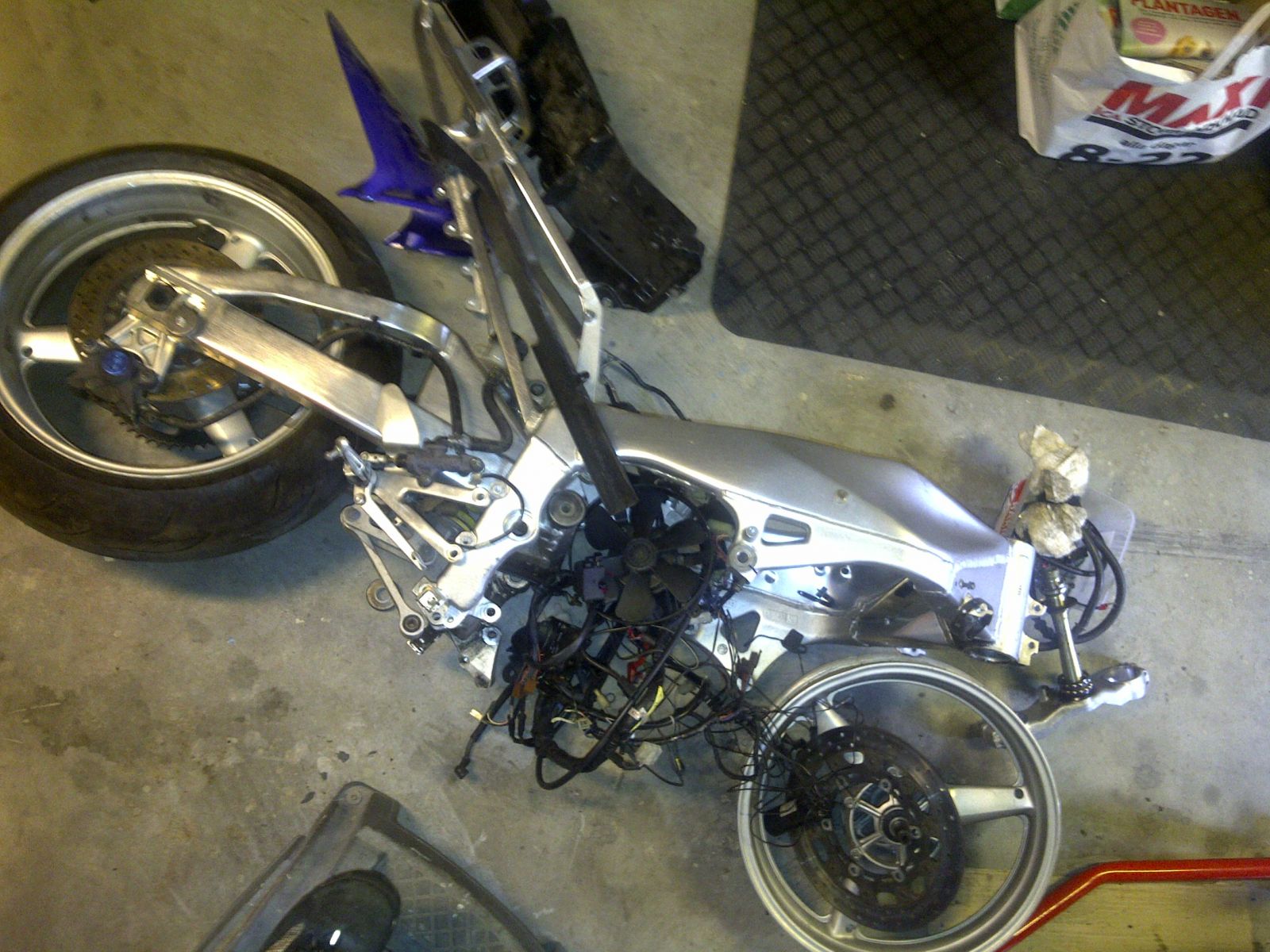

The Segway:

The victim:
Parts to use:
The tear down:

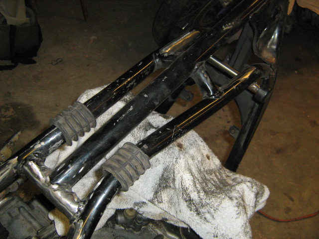

Update: First job
Some cutting:

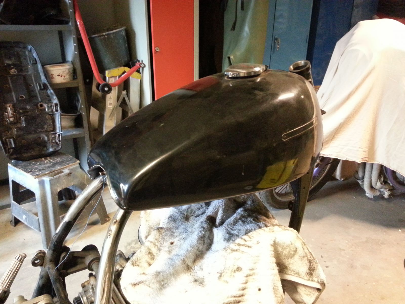

Z1 tank wont fall into KZ 1100 frame
Narrow the frame so the tank falls in:
Tank mounts:
Tank falls in:
Ohh...forgot to type this: I will do a shaft to chain conversion ! Ohh yes...you heard me :woohoo:
Some cutting:
Tank mounts:
Tank falls in:

Lol...haven´t looked at the "segway" pic like that, but the jack handle is NOT where you think :woohoo:
Yepp...I did the paint job myself. Had to redo it after the first respray due to bad primer.

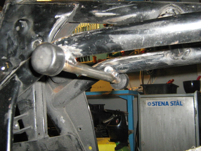

Had some sleepless nights over the shaft conversion but it all went away when "Bill" from a different forum gave me all the info I needed. More about that later on...but that part of the build will look something like this: (with focus on output shaft of course)

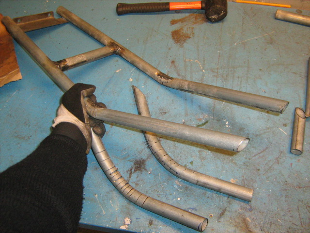

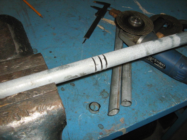

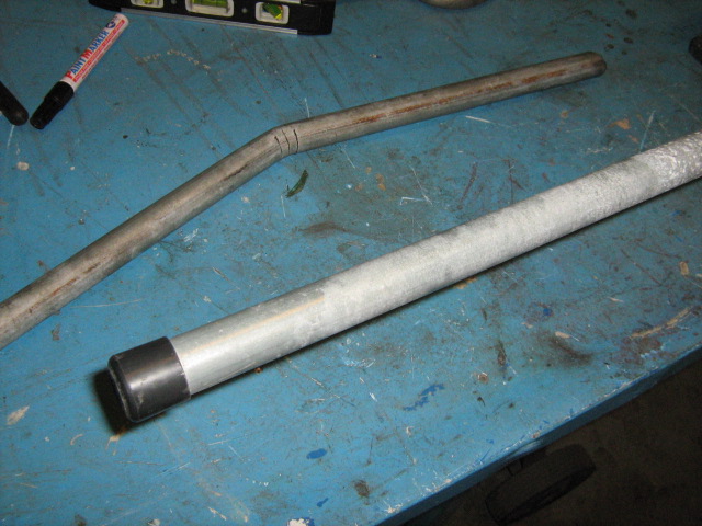

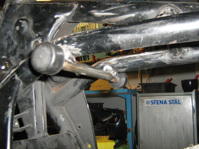

Update Sub frame:
Okej...this might be a bit controversial so dont give me a hard time about it.
Started manufacturing the sub frame and I want it to follow the lines of the side overs.
So the method I use is to make cuts in the pipe and bend into shape and then weld it up again.
It´s not machine bent and it´s not pretty but it gets the job done.
First cut:
Used material from the kids trampoline:
Top structure done:
Sub frame starts taking shape:
First cut:
Top structure done:

Ive seen pipes bent that way on many occasions,lots of grinding /welding though.
Is that threaded galvanized pipe your using?that stuff is going to way a ton ,not sure about the strengh compared to tubing
