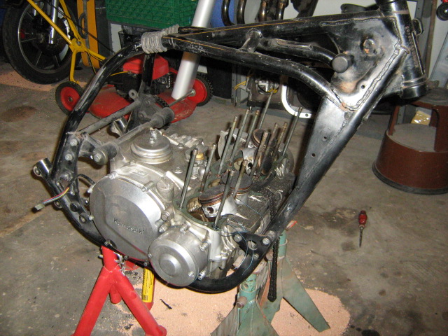

The victim:

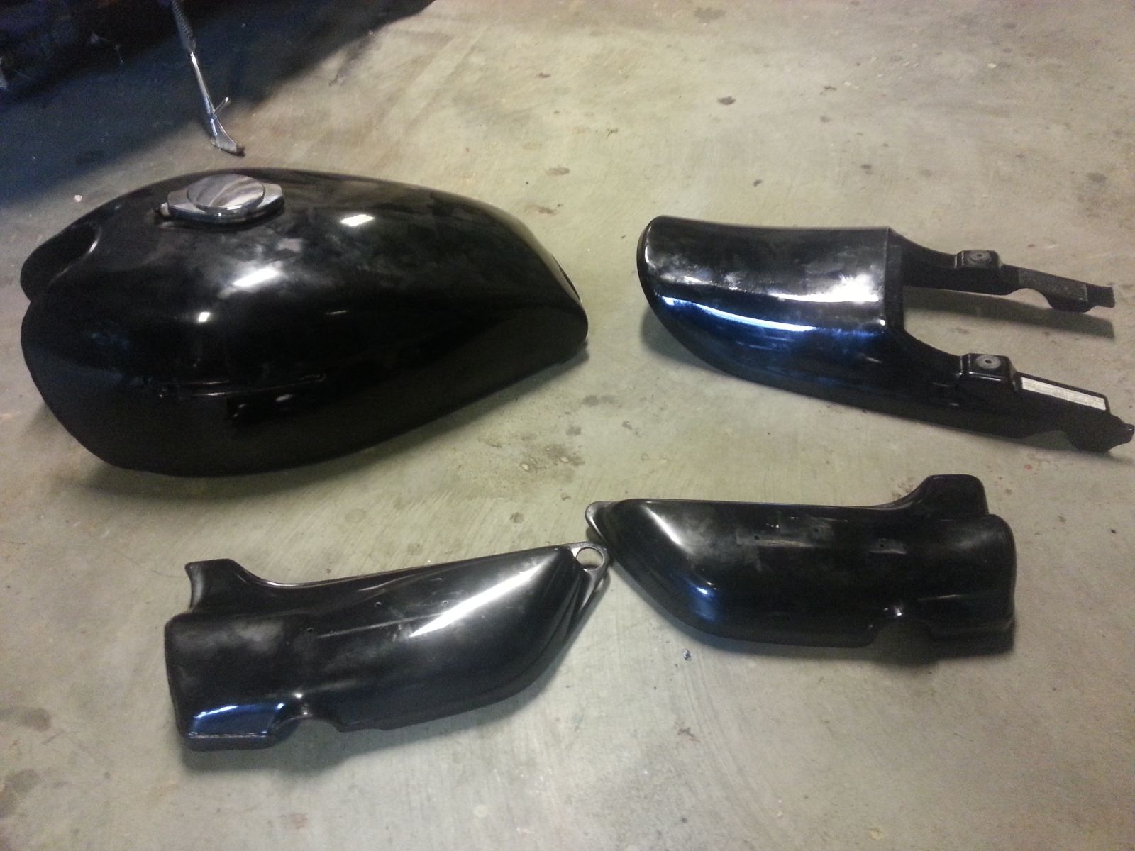

Parts to use:

The victim:
Parts to use:

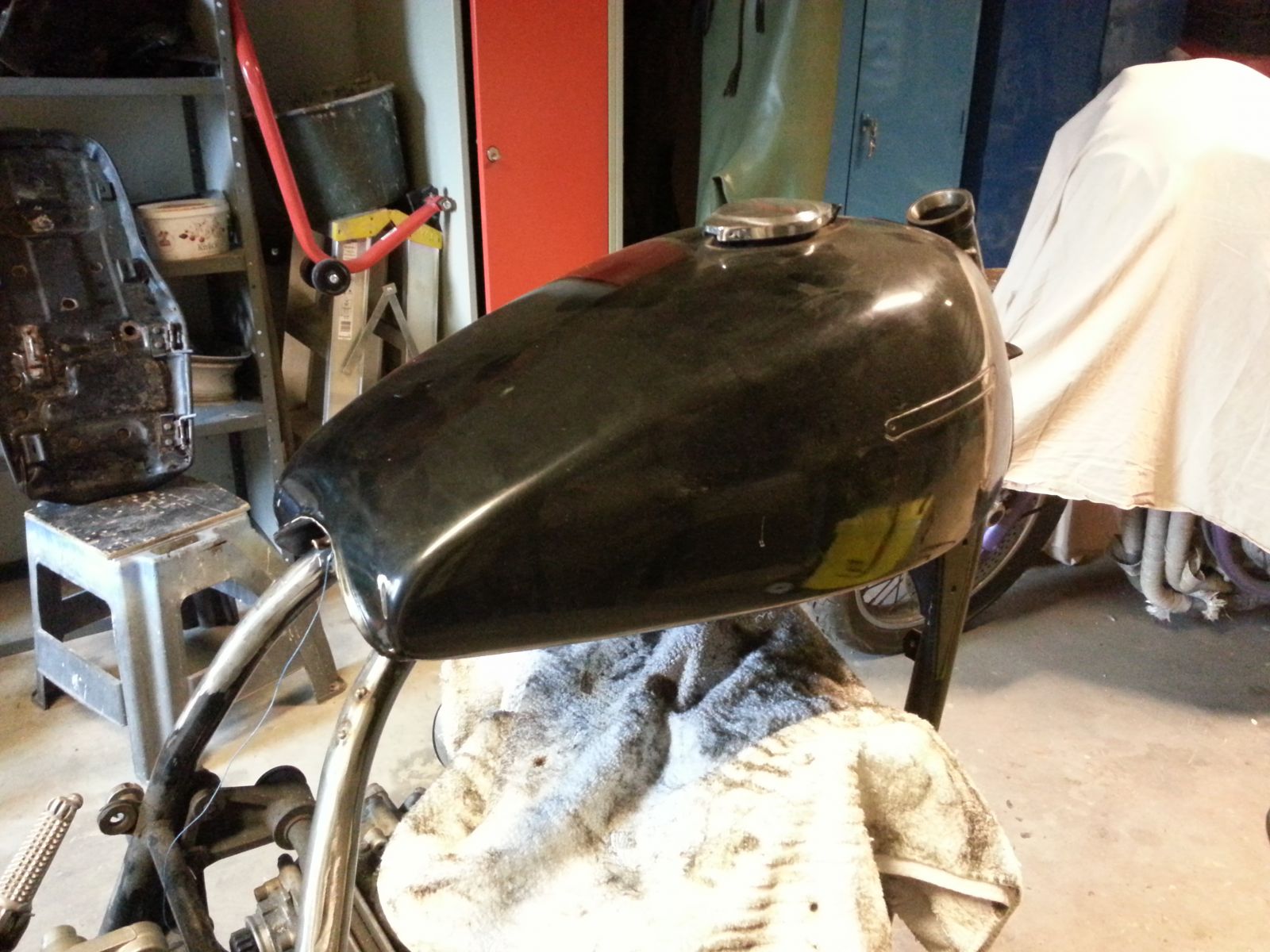

Update: First job
Some cutting:

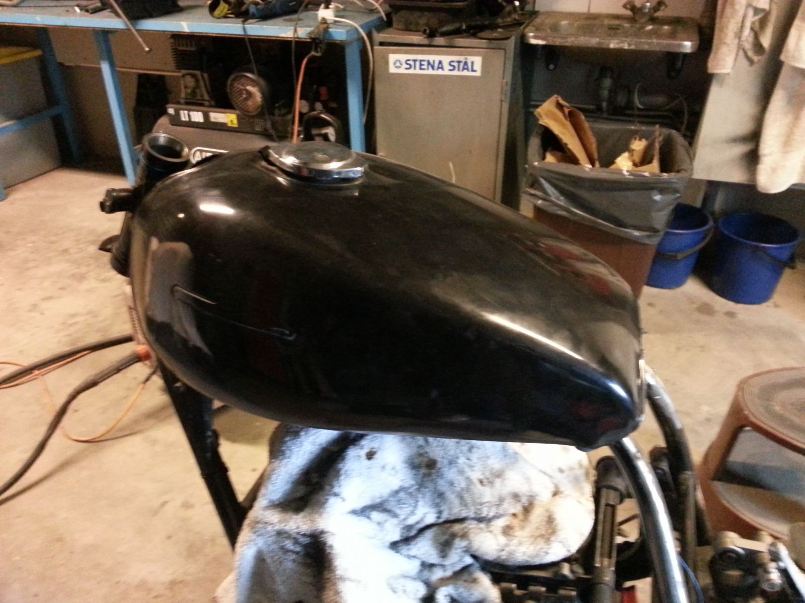

Z1 tank wont fall into KZ 1100 frame

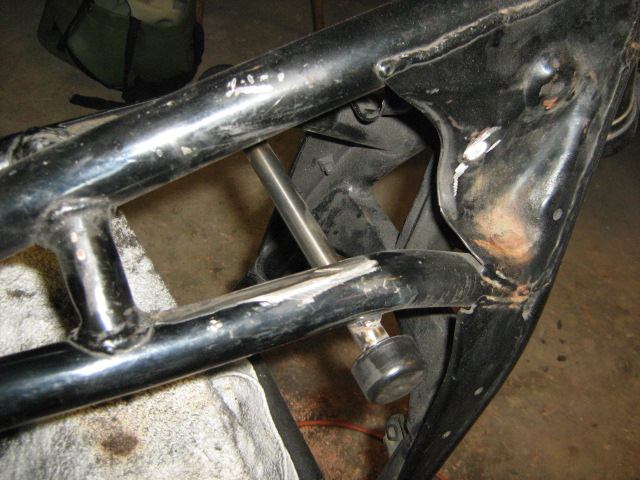

Narrow the frame so the tank falls in:
Tank mounts:
Tank falls in:
Ohh...forgot to type this: I will do a shaft to chain conversion ! Ohh yes...you heard me :woohoo:
Tank mounts:
Tank falls in:

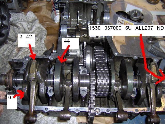

Had some sleepless nights over the shaft conversion but it all went away when "Bill" from a different forum gave me all the info I needed. More about that later on...but that part of the build will look something like this: (with focus on output shaft of course)

Update Sub frame:
Okej...this might be a bit controversial so dont give me a hard time about it.
Started manufacturing the sub frame and I want it to follow the lines of the side overs.
So the method I use is to make cuts in the pipe and bend into shape and then weld it up again.
It´s not machine bent and it´s not pretty but it gets the job done.
First cut:
Used material from the kids trampoline:
Top structure done:
Sub frame starts taking shape:
First cut:
Top structure done:

Ive seen pipes bent that way on many occasions,lots of grinding /welding though.
Is that threaded galvanized pipe your using?that stuff is going to way a ton ,not sure about the strengh compared to tubing
