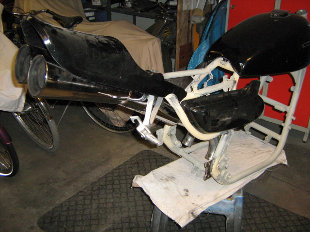

but have you checked that your tire will not hit the pipes in full bump?

Have thought about the wheel hitting the pipes but have not yet figured out a fail safe sloution.
Might rise the rear a bit to get more clearense or mounting a rubber damper. Guess we have to wait and see what happens

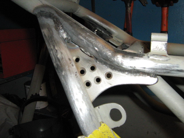

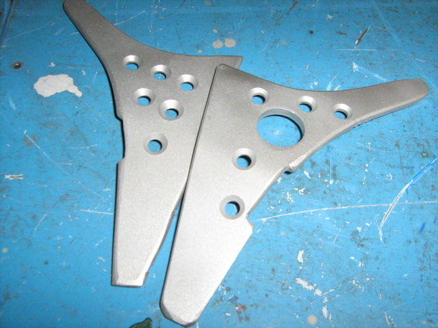

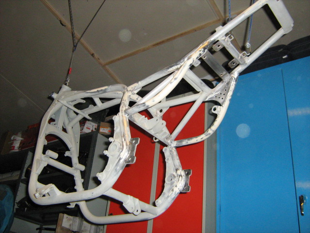

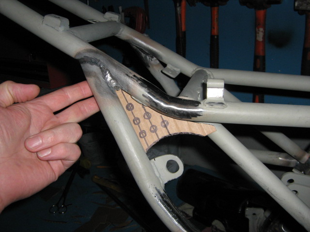

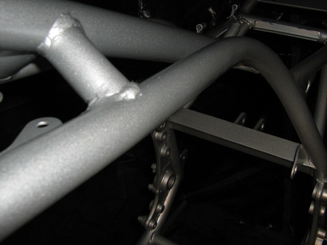

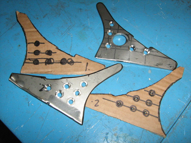

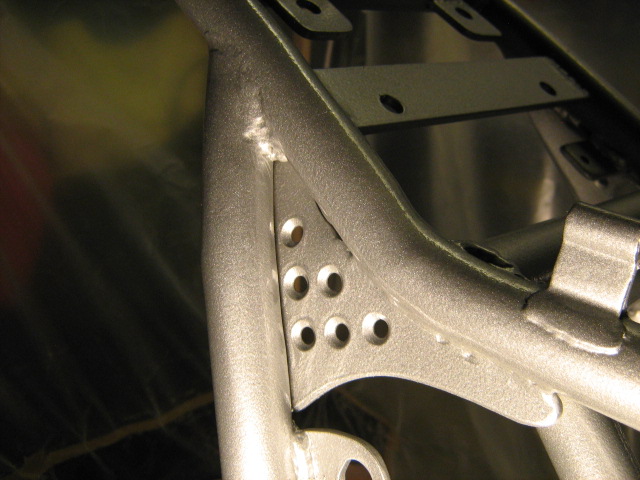

Made some more reinforcement on the sub frame:
Template:
Cut and drill out parts:
Glass blaster:
Welded in:
Now I just need two brackets for the passanger foot pegs and then I´m ready for paint.

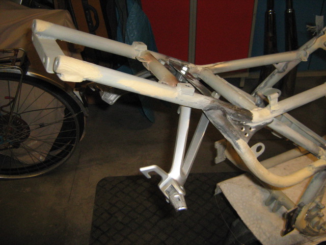

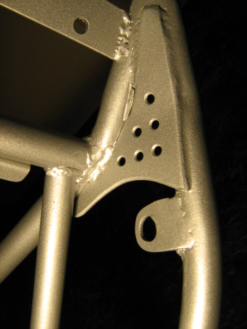

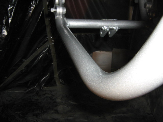

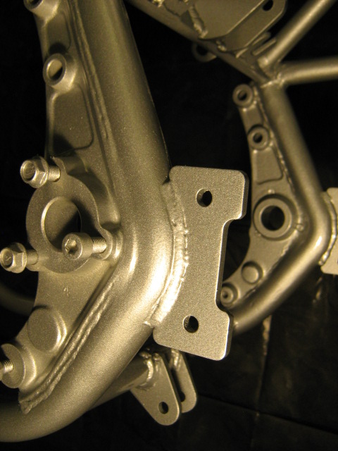

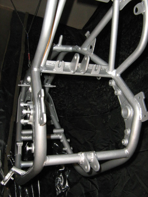

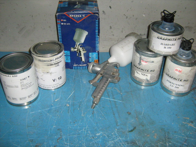

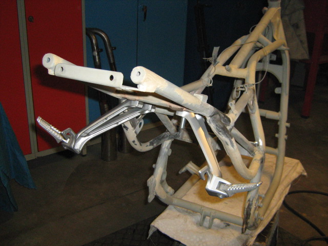

Forgot to weld on foot pegs for passanger: Mock up
Made some brackets for them:

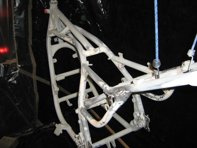

Hung the frame up in the roof:

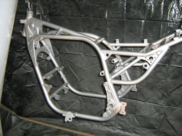

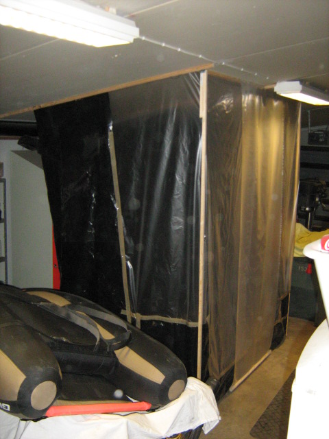

Made a tent or spray booth in the garage (The IKEA tent is out of this league

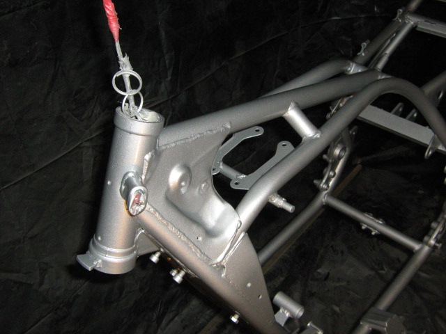

Frame cleaned up for paint:
Tomorrow the paint comes on:
Safety first...a WW2 gas mask is recomended :woohoo:

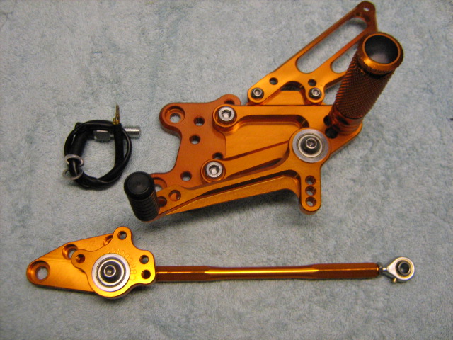

Have to show my X-mas presents:
