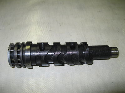

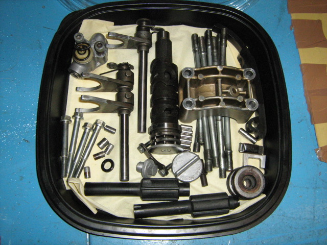

The shift drum pins are clocked slightly diffrently and the holder (or front plate) of the shift drum differ in diameter. But the shift drum seem to position itself in the exact same position while shifting with the two set ups. Guess...same same but different !
Need to investigate some more...
*3 hours later*
Yepp...swapped the gear shifter drum to be on the safe side.
Thanks Etbike for making me aware of this ! :silly:
*3 hours later*

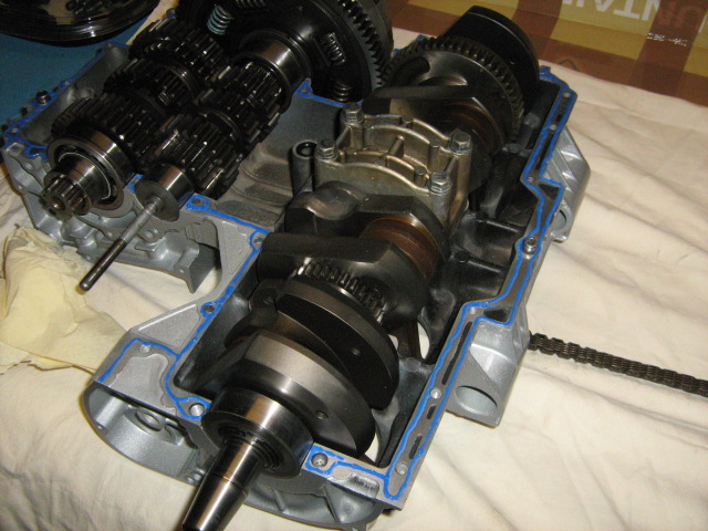

T.guzzi, jepp...tested the gearbox and it´s all systems go !
(and then took the gearbox all out again :laugh: )

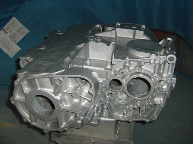

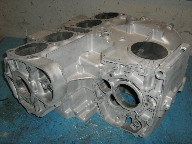

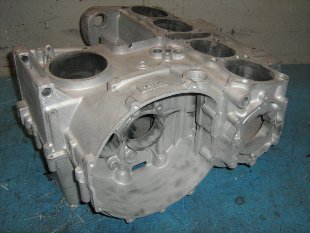

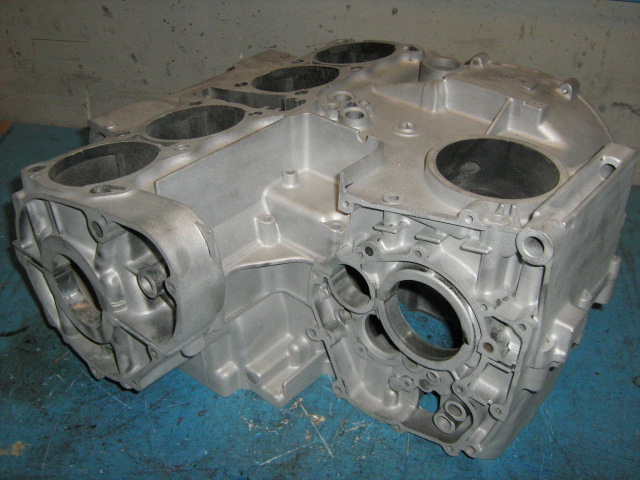

Uppdate: Removing old gaskets and glasblasting the case
Spent some time removing old gaskets and glasblasting the case. It´s now getting ready for paint.

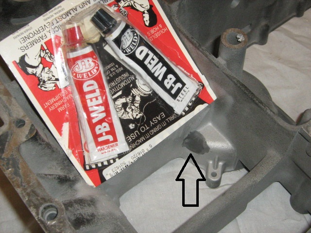

Found that somebody messed with the case and ginded inside the case. Had to reinforce with some JB weld.

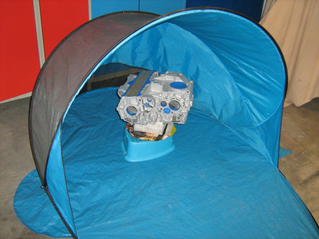

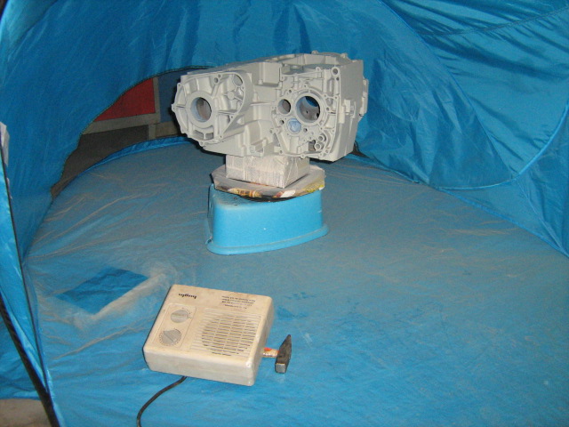

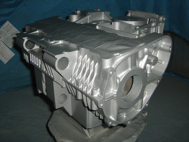

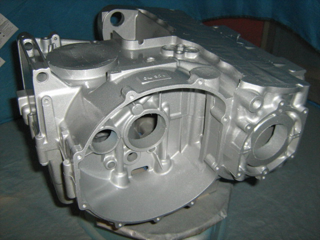

Got the case painted today. As a Swede I have to promote IKEA that sell this perfect little spray booth. Mounted the engine on a turn plate and off I went..

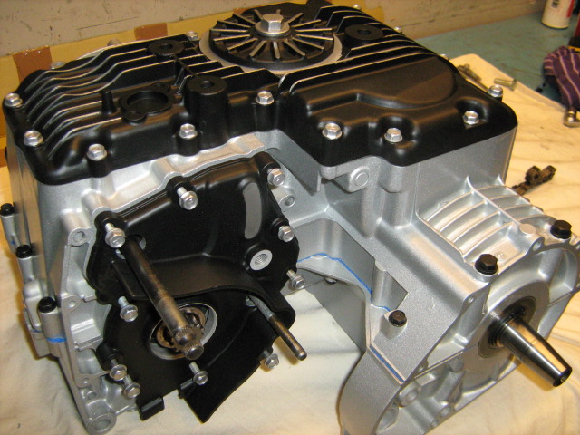

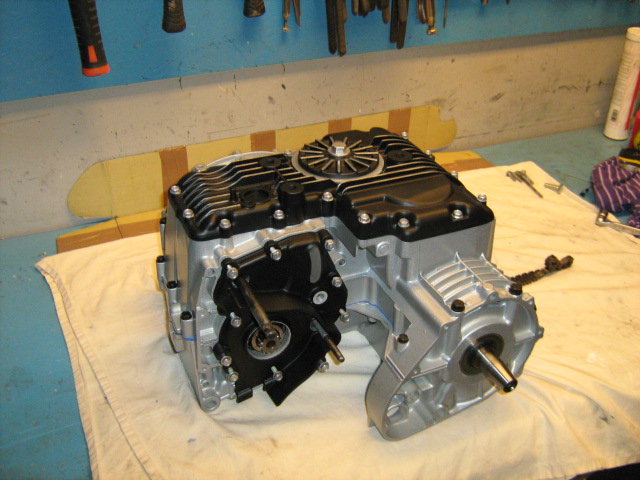

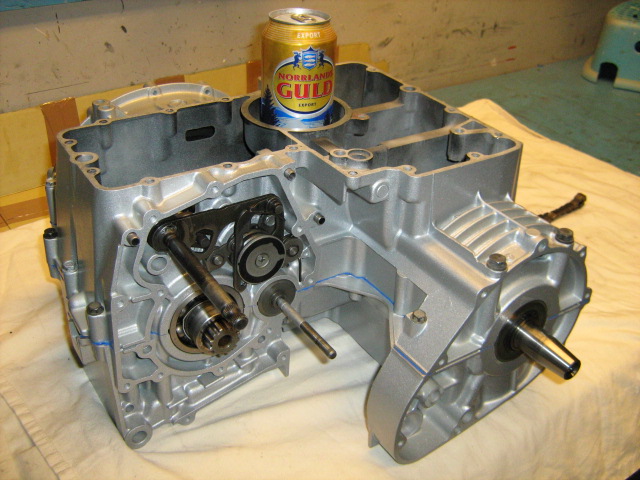

Update: Mounted some engine covers
Black on silver and silver on black will be the mantra
Nice view if you ever get run over by the bike
